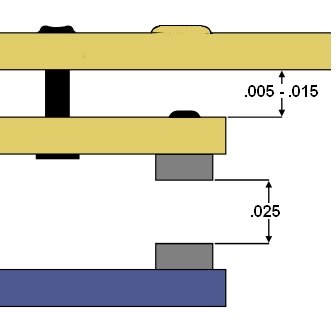

Cushion spring Gap is adjusted by the rivet that limits travel. Changing cushion spring tension does exactly that it adjusts the tension. What condition are your points?..worn & old ?....dirty, gummy ? .... What does the cushion spring gap measure out to?.......... Attached photo from previous Forum posting gives a good approximation of starting measurements before adjustment procedure results.
Previously posted on Forum, submission unknown

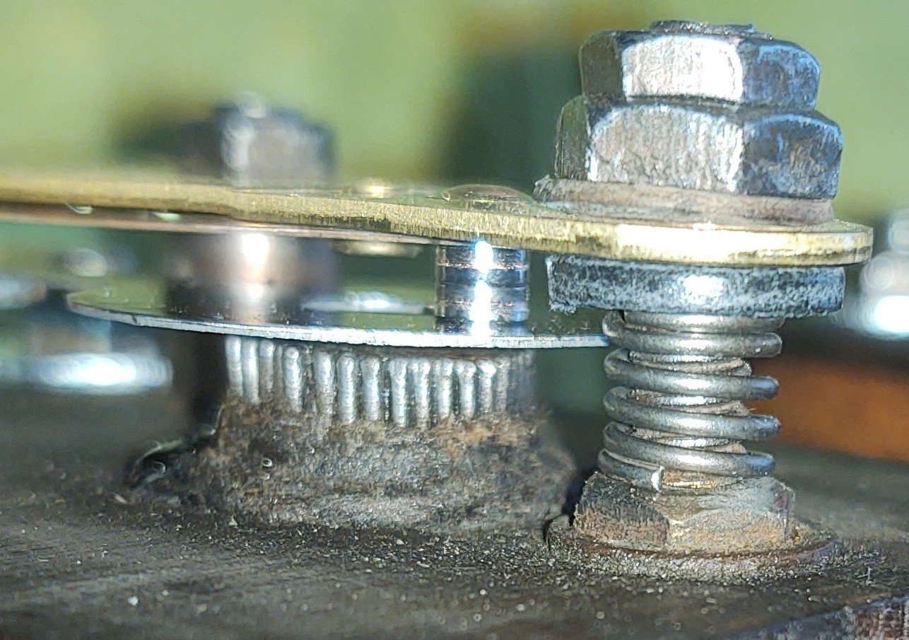

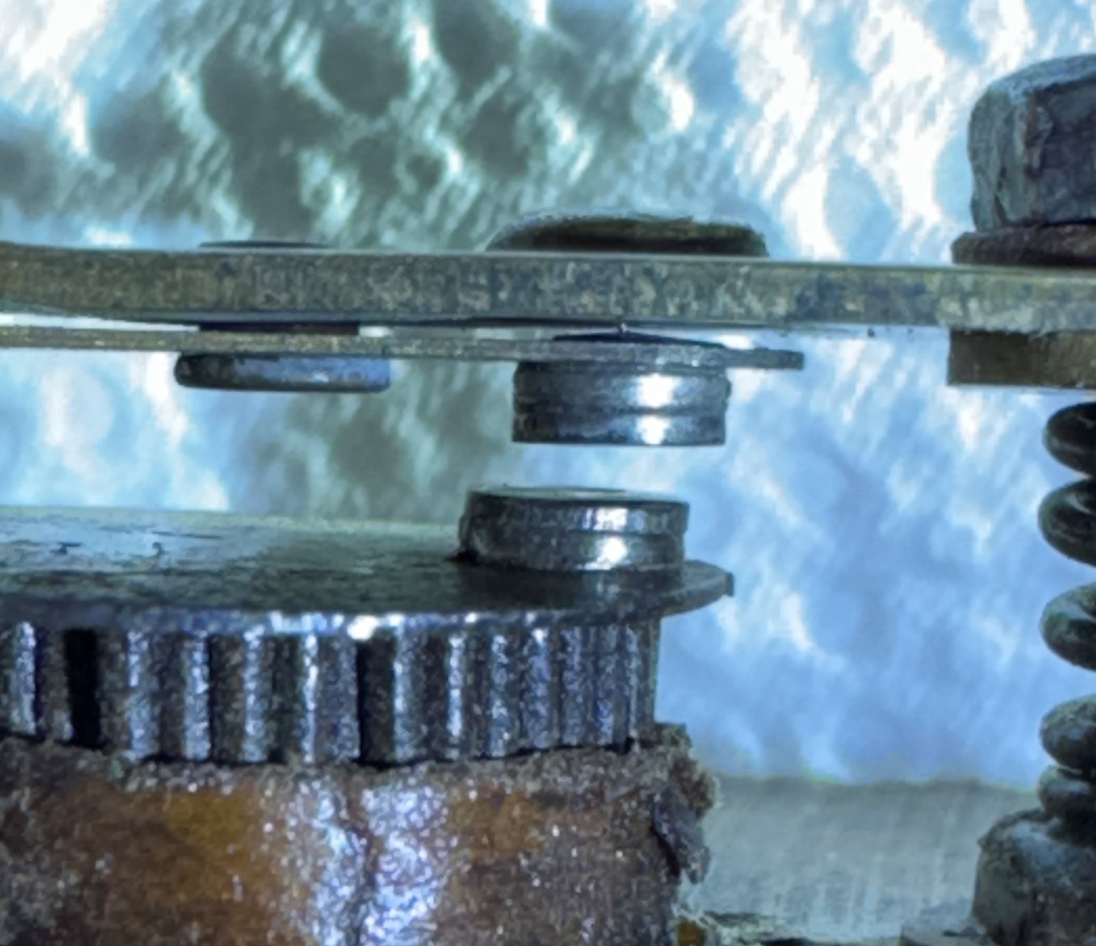

Gary .. Possible to post close up picture of your installed coil points ?

Points open. Note the gap between cushion spring and upper bridge

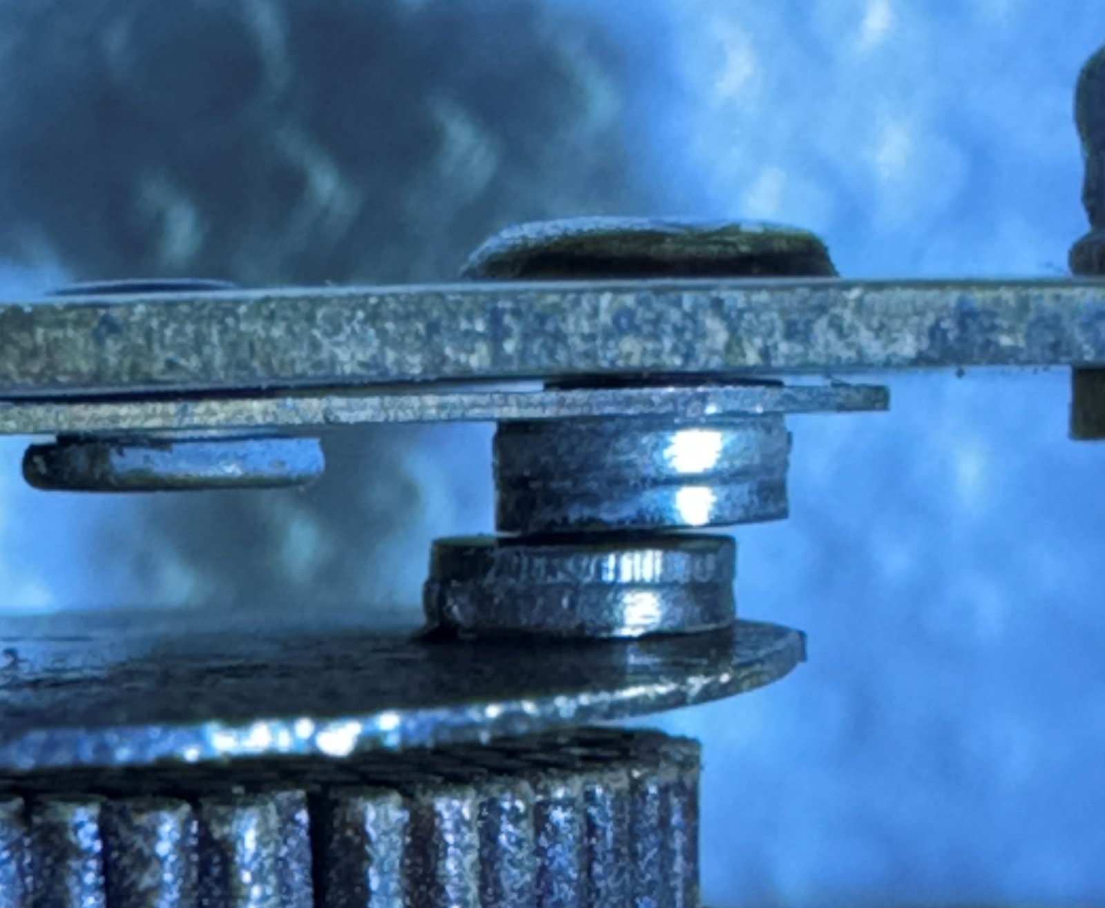

Polished out the pits, and will go back to file to flat, matching contact surfaces

Loosen the two nuts that hold the lower vibrator and have the points position squarely, then tighten . To correct your double sparking, the cushion spring tension may have to be increased , along with your vibrator spring tension according to the test system that you use......... Looking at your pictures, looks like some dirt and oil.... Using some brake cleaner spray to clean out under the cushion spring and top of the coil will help to give more accurate electrical coil settings.
