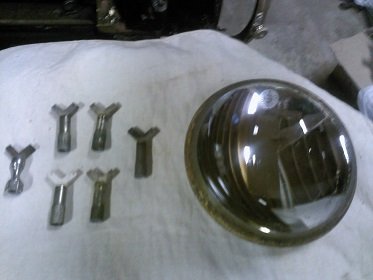

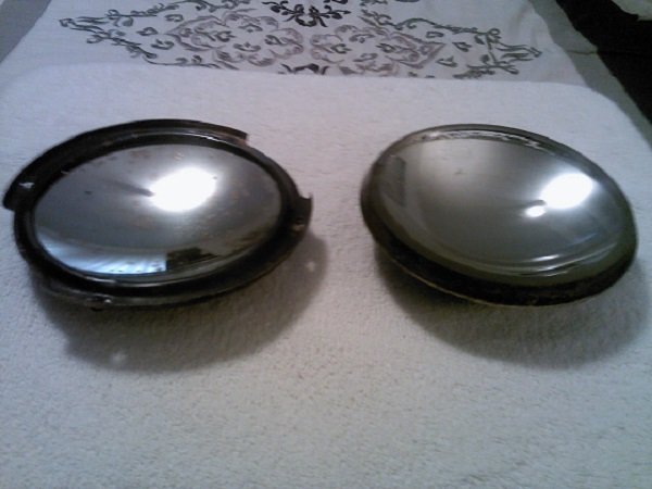

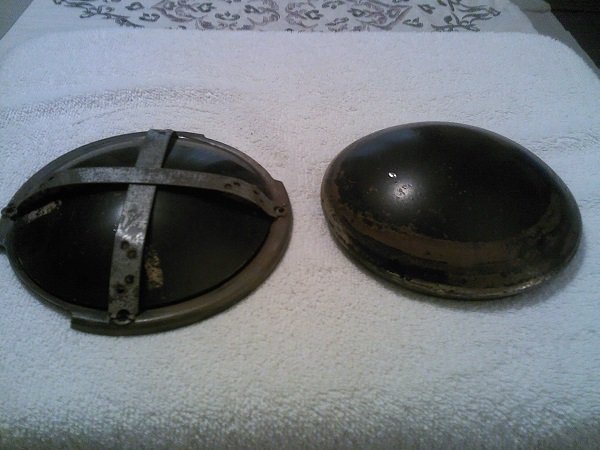

Re: Glass concave mirror, would it work?
I haven't used those (the link you posted) as I found some Lancaster Mangins
that snug up to the shape of the rear of the headlight buckets properly.
I believe you will have mounting difficulties and possible problems as Dan notes.
There are "plate" mirrors in some late Victor acetylene lamps and are mounted
in steel straps. I believe they were directed mostly at the truck market.
The one on the left below is out of a 6" Victor type driving lamp I have mounted on
my running board. The plate mirror seems to work as well as the Mangins. There
is quite a bit of vibration while driving so I haven't tried to mount a "plate" in
my John Brown 16's. The plate type might fit an E&J but I don't have one to try.
I find gas lights very reliable for ten years since I set them up
with a Prest-O-Lite "B" tank.

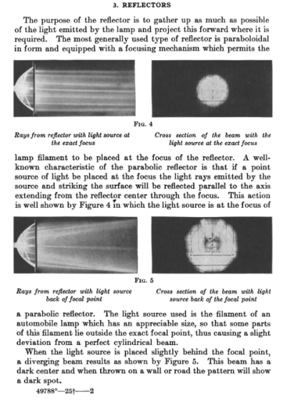

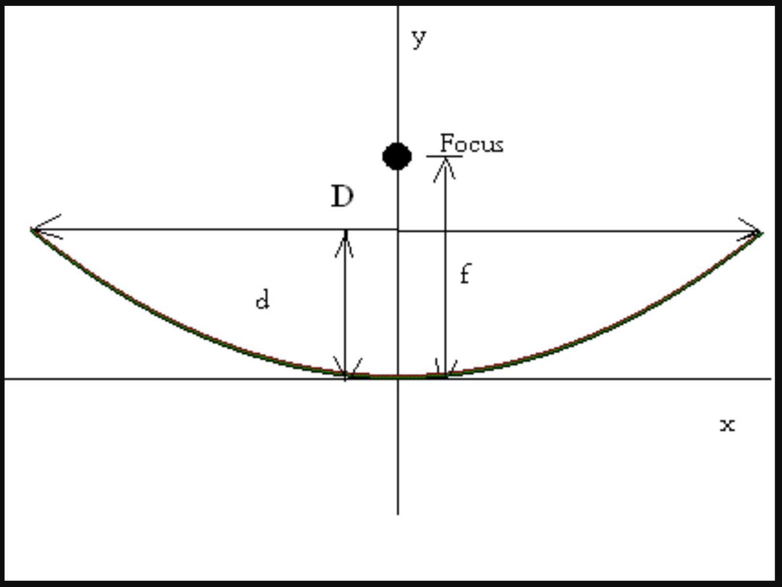

The focal point of a mirror is the point at which light rays from an object converge or diverge after reflecting off the mirror. The "object", burner, of an acetylene headlight is similar to a headlight filament with respect to proper aiming. If the "object" is at the focal point the reflector will project the maximum about of concentrated light forward. If it is offset, the light projected will be scattered. So the question is what does the focal point of the reflector need to be capture the maximum amount of light from the burner?
- Posts: 4454
Do you mean where does the focal point of the reflector need to be?
If so, then the real question is, where does the burner need to be with respect to the reflector's focal point. Since the burner position is adjustable, but the reflector's focal point is not.

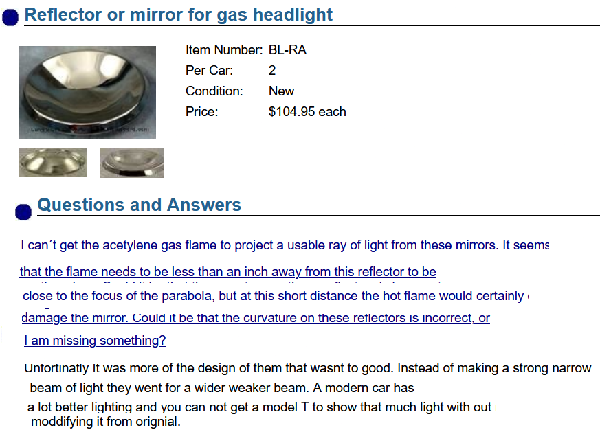

A friend of mine recently purchased some of these:
https://www.ebay.com/itm/283428097530?_ ... R4LJk8ubZQ
-Keith

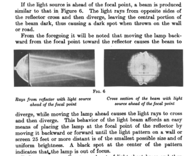

The focal point of the mirror needs to be within the adjustment points of the burner. Same method used for adjusting electrical headlightsJerry VanOoteghem wrote: ↑Thu Feb 06, 2025 2:17 pmDo you mean where does the focal point of the reflector need to be?

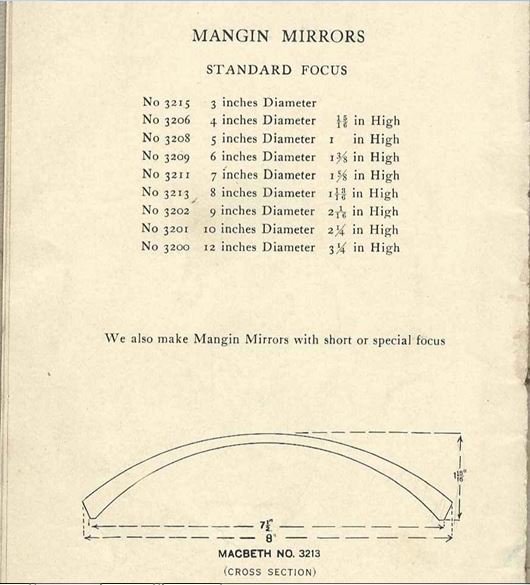

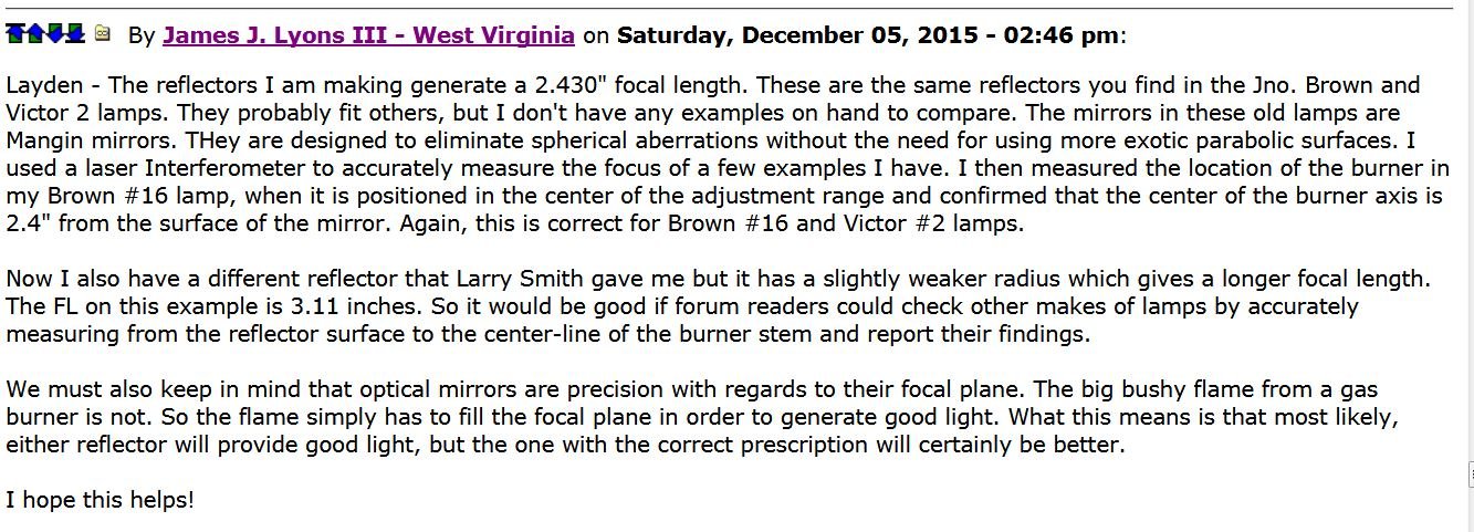

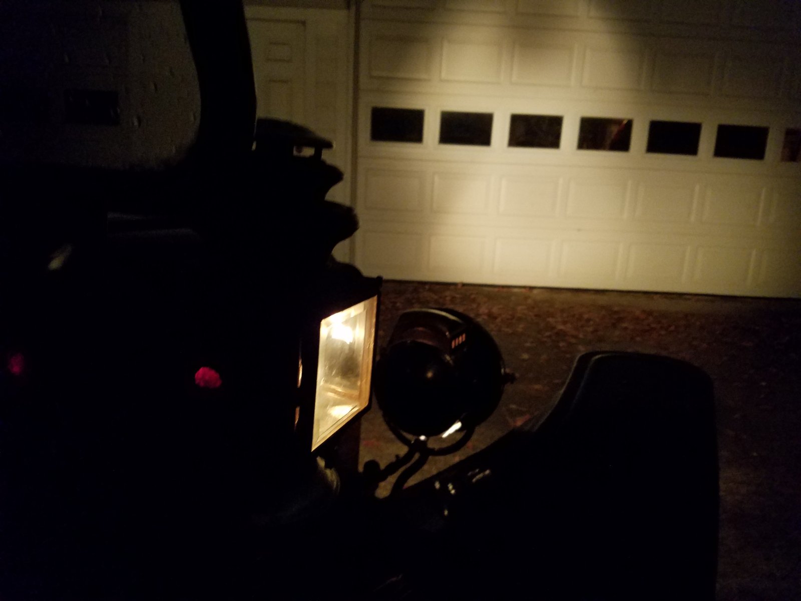

You set the burner pipe center ( the flame) at the focal point of the Mangin.
The standard focal point is 2-7/16" from the mirror back and the dimension "F"
in the chart below.
"D" is the 1-3/8" dimension of a 6" #3209 Mangin in the chart already posted above.
That leaves the burner center one-inch in front of the Mangin rim and centered, more
or less, in the burner adjustment slots in the John Brown gas headlights.

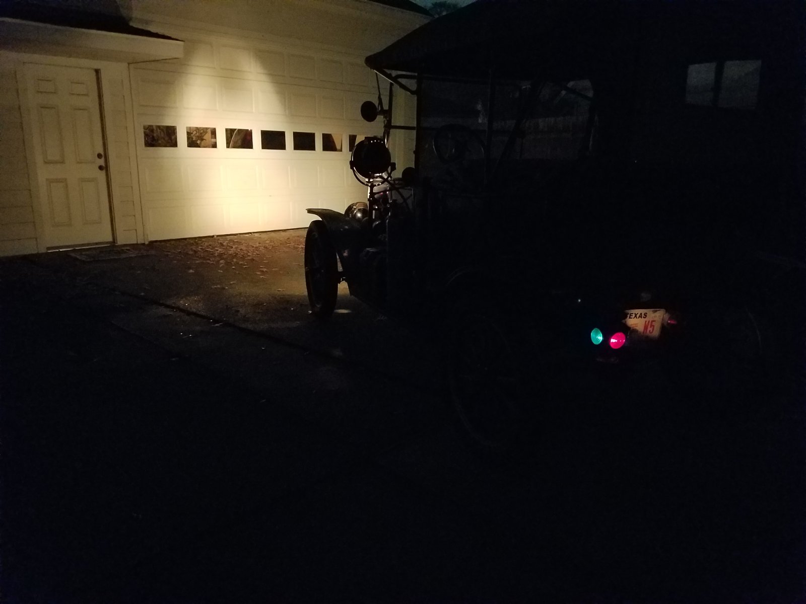

I shine mine on one of the shop overhead doors about 50 fifty feet away when I set them up.
I had just come back from a drive in photos below and was closer to the door but that's the idea.
The two Browns are down lower with the Victor up higher. The dark spot at the top is the burner
shadow in the Victor which I can move while driving and was aimed up a little for some reason.
in the chart below.

The eBay mirror with its 11.8” focal length is essentially a shaving mirror. I don’t think it would work well in a headlight.

James Lyons helped us understand the Mangins in 2015 and I saved that post.
I had already found the focus position earlier that year and was driving with the
Prest-O-Lite tank. You can't be too far off if you just mount the burner stand in the
slot. I noticed last night that I had the burner stand a little to the front of the slot
to focus.
I measured my right front headlight setup last night with a small tape measure and
find it "aligns" with that discussion.
I am sure he wouldn't mind me posting that explanation. He is in the field so
he has the equipment to determine what we are using. Hope he chimes in.

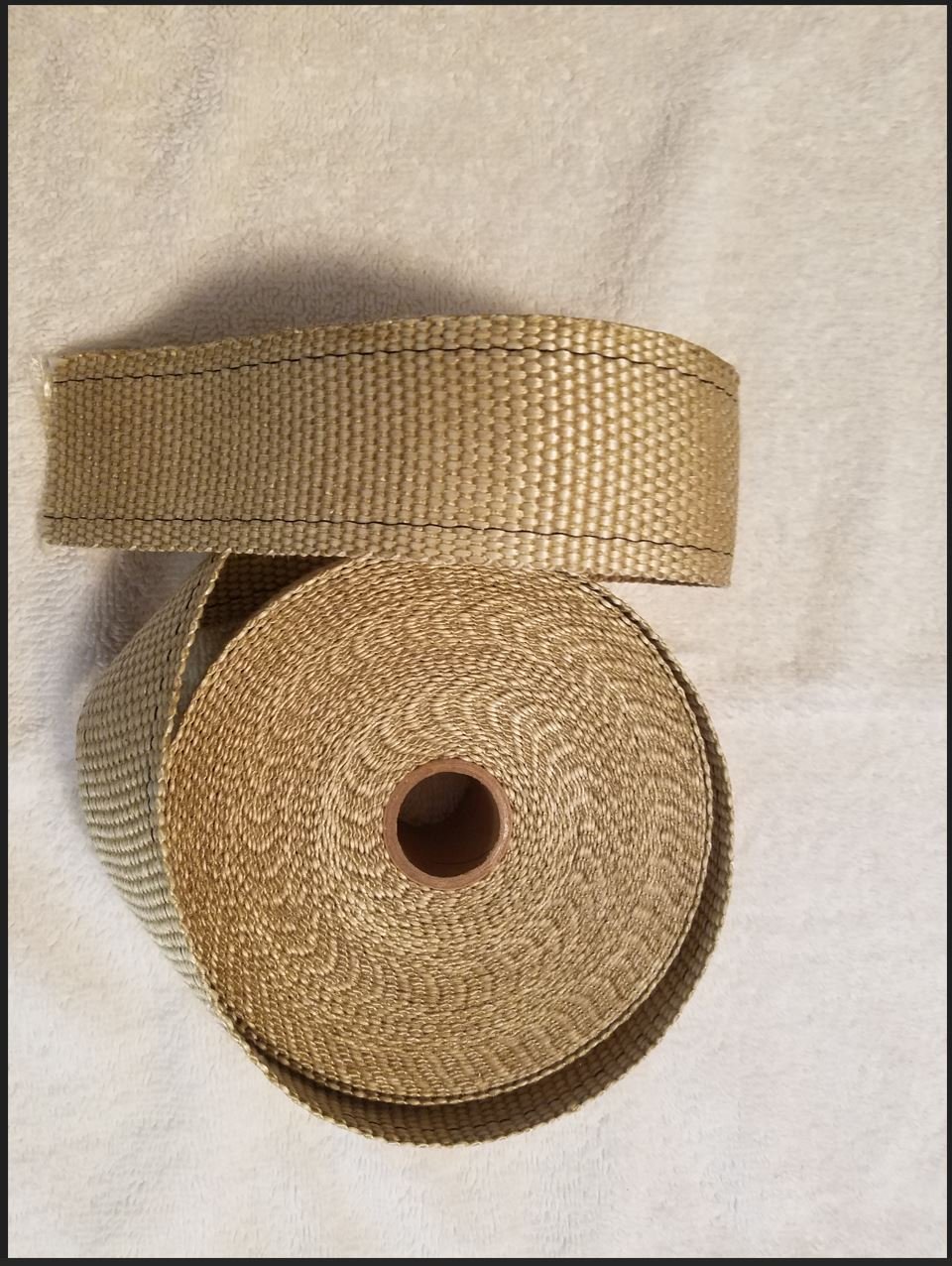

you can get. Getting the burner forward may help save the clock glass.
If the clock glass survived driving around burner lit for a couple of miles,
you could have the "front" of the glass silvered and shellac it. I set my
mirrors on a couple of strips of 2-inch webbing to snug up.

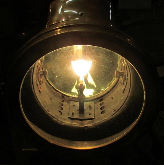

(Thank you Keith for great photo of lit acetylene headlamp with proper flame.)
