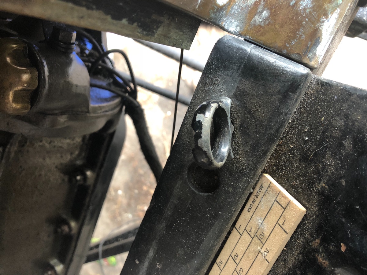

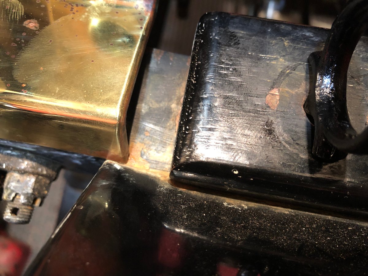

Gents I need some input please. I have a 14, the engine was pulled and now I'm putting things back together. I can't get the radiator to set down on the frame it sits on the fender by about 3/16 of an inch. It seems that the fender is just further forward than before but I'm puzzled why and don't know what to do about it.
Should the hood shelf be a full inch behind the radiator? Also interesting that the radiator inlet now conflicts with the timing linkage which will only get worse when the radiator comes down to the frame. I did adjust the length of the rod as a part of timing (new timer) so maybe the shape of the rod now is the issue and maybe has nothing to do with my radiator problem.
Looking for advice
Thanks Ben Umberger

Ben, on my 1912 van that foot on the radiator is over the side of the frame rail. Your looks like it sits on top. This may indicate that your front cross member has been spread somewhat. The lean on the stud also supports this observation. If things do not sit correctly, it is difficult to get things to line up. There is usually little gap between the foot of the radiator and the hood shelf.
- Posts: 4384
Re: 14 Help Please, Radiator/Fenders don't align
I suspect Allan may be correct. He is pretty sharp and usually right about things. I also suspect that your fender needs to slide back about a quarter of an inch. Hopefully, just loosen some bolts and slip it a bit. Many fenders had enough slop in the mounting holes to allow that. And some? Reproduction fenders sometimes get holes drilled by installers and off a bit from where they belong. Just a thought.

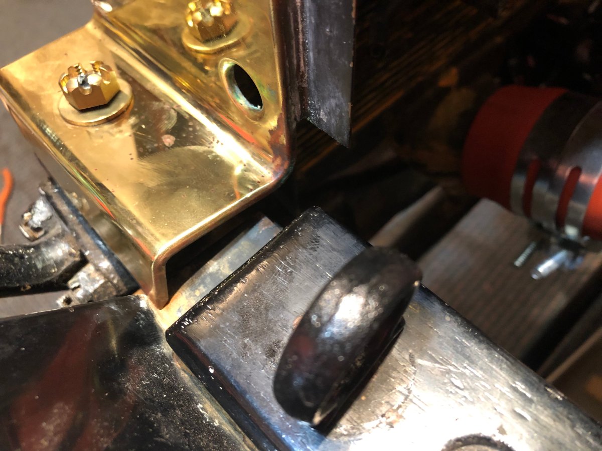

How much gap should there be between the hood shelf and the radiator brass? anybody have pictures of these details?
Here is how mine is.

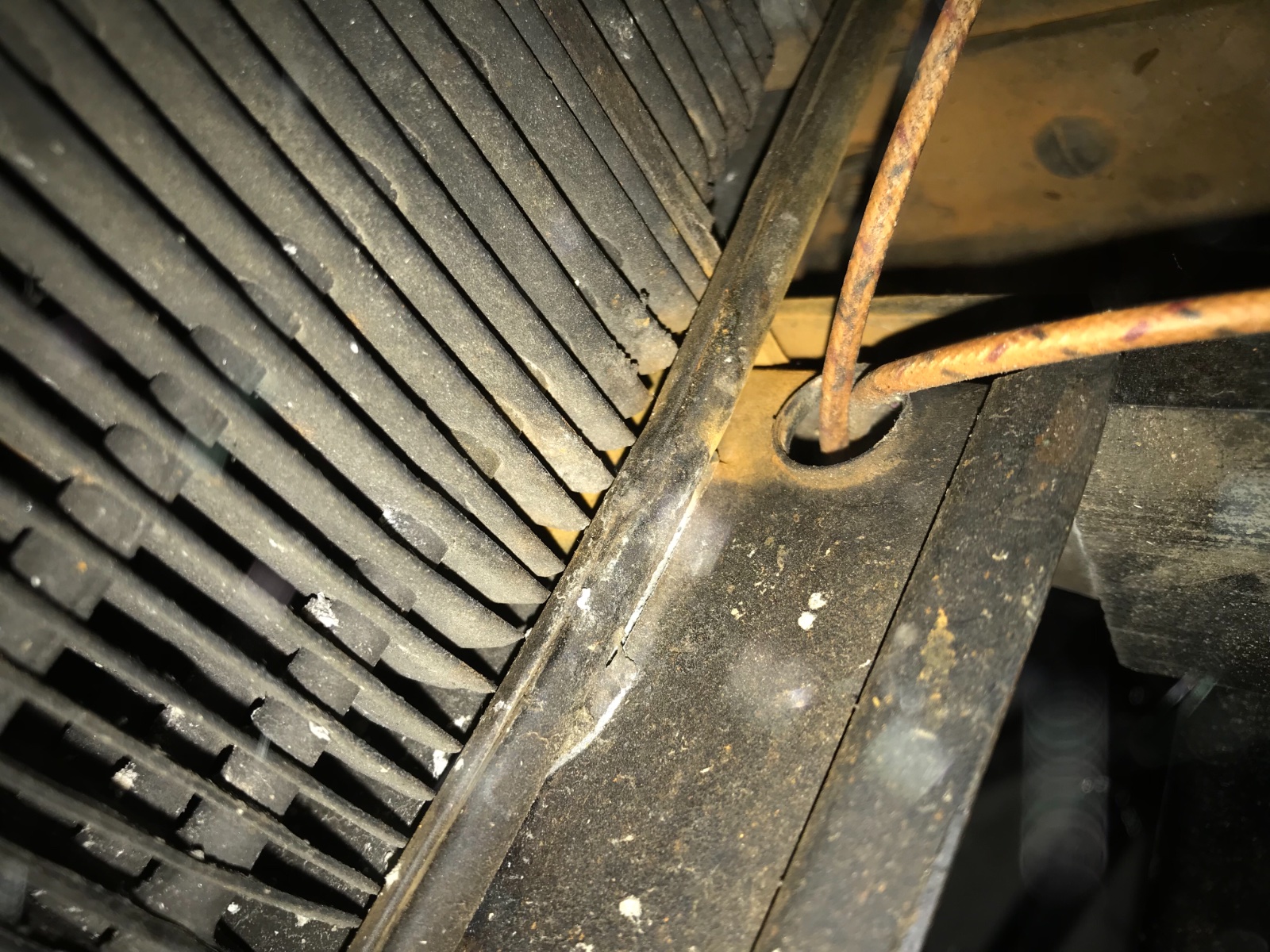

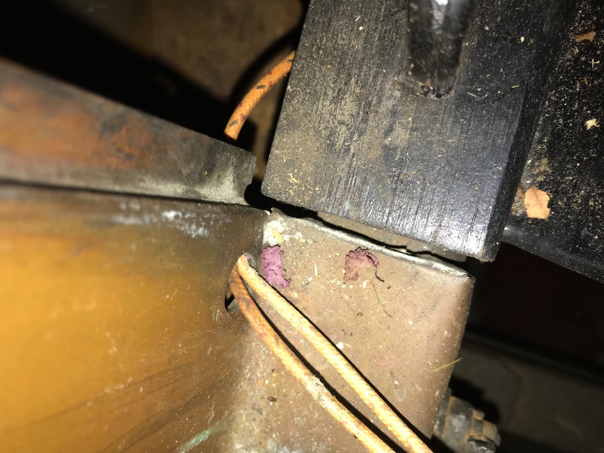

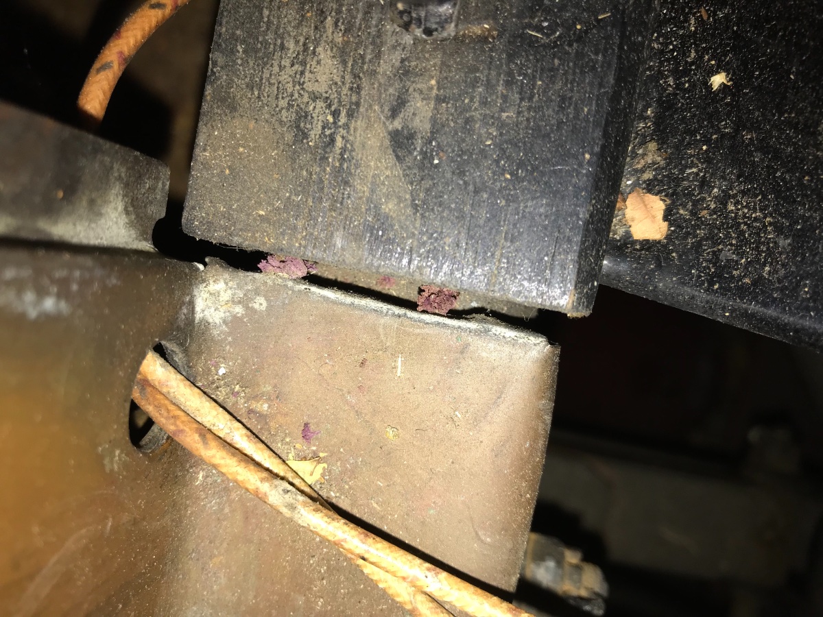

George Mills
- Posts: 644
- Last Name: Mills
Ben,
I don’t have a 14, but do have a 15 at the house here up north. I went out and looked....
I do have the 19 there in Anona Largo and while it is a black era...the radiator on that sits on hard pads like the brass and not thimbles. The house is a smart house so if you want to run over and take a look see at the ‘19 give a shout-out I can open the garage door from up north.
Here are the ‘15 photos,,the hood shelf sits higher than the radiator horn...
Sorry for the pic orientation...iPhone thingy
