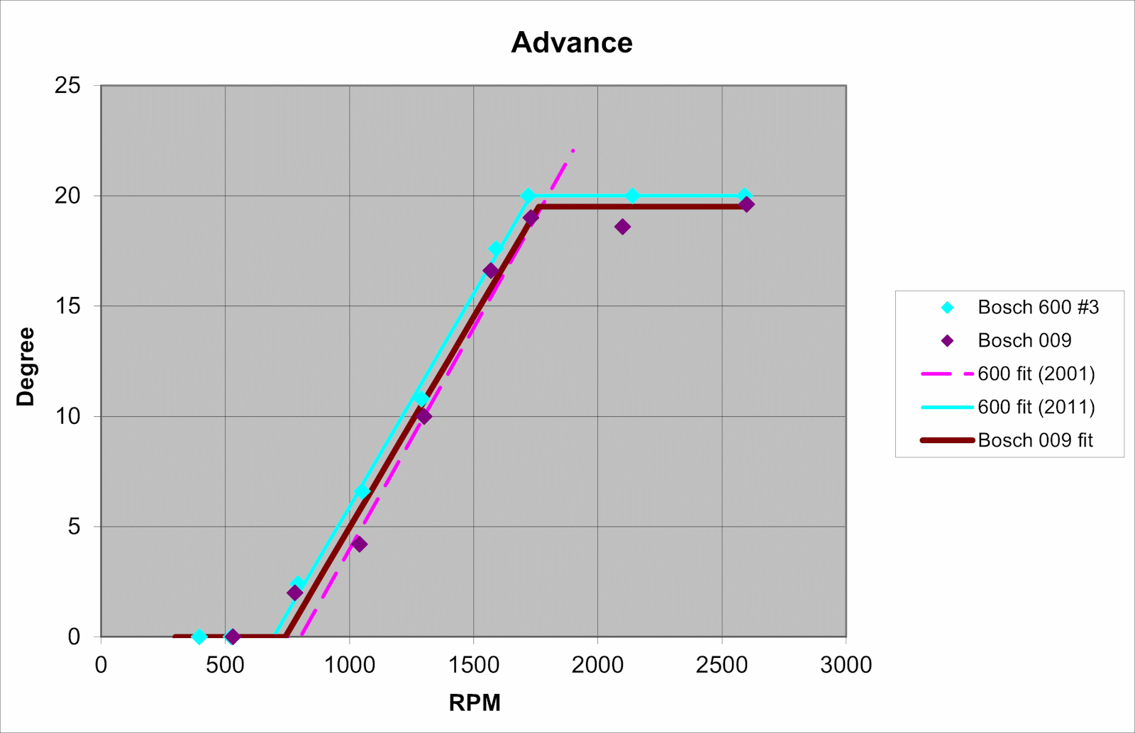

Re: American Bosch distributors with centrifugal advance
I run a Bosch 600 on my Tudor. It is converted to use a Pertronix Ignitor as described at the Tulsa website. I measured the advance curve for it, but I'm not sure which advance mechanism it was. I found it was very similar to a Volkswagen 009. Normally you want around 30 degrees at speed and 0 for starting, so I retard it to start and then advance it. The type without manual advance tend to break when you tighten the head, so I prefer the type with manual advance. They are a pain to set up because it can only be advanced over a small range.
