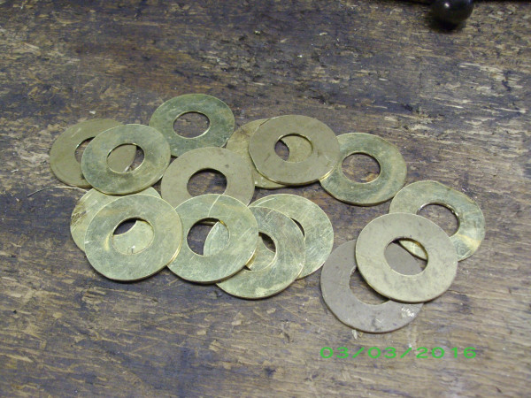

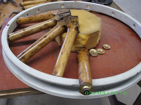

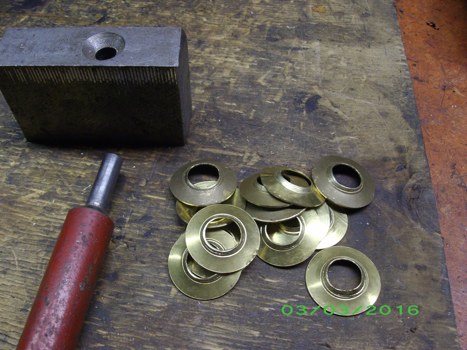

Allen : here are some pictures of hoe I do the wheels, when they talked to me [ claking]
Toon

If you don’t disassemble the spokes, I assume when you shim 2 spokes at a time with the U shaped shim that slides onto the tenon, you shim opposing spokes (across from eachother), before revolving the wheel 90 degrees to do two more, then two more, then two more, etc. until all are done. Would a drop of epoxy on each shim be a good idea to prevent them from falling out?

If you get them tight they will stay in place. I use small block Chevy valve shims with a piece removed the width of the tenon, they are .015 and .030 thick, a drop of epoxy couldn't hurt. To John's question about soaking them in water, it will tighten them but when they get tight it crushes the wood fibers and when they dry out again then they are looser then before, the same thing with hammer handles.

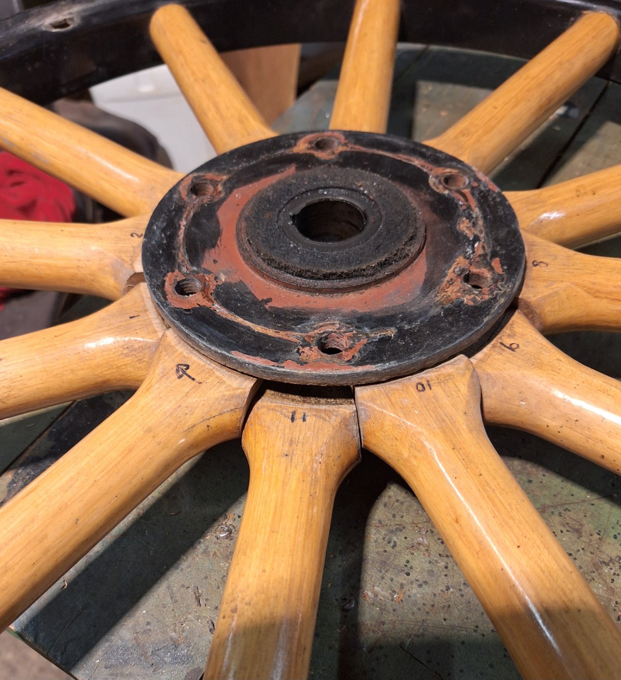

The beauty of working with Canadian Kelsey wheels is the double taper on the spoke ends. Not only do they taper as usual to the hub, but they also taper between the backing plate on the hub and the bolt on outer plate.
The photo shows one spoke partially tapped down. It is a simple matter to tap down five alternate spokes. Then the other six can be tapped down to meet them. This process is repeated until the hub is free of the spokes. It took me all of 4 minutes to do this. No damage to spokes, no press needed.

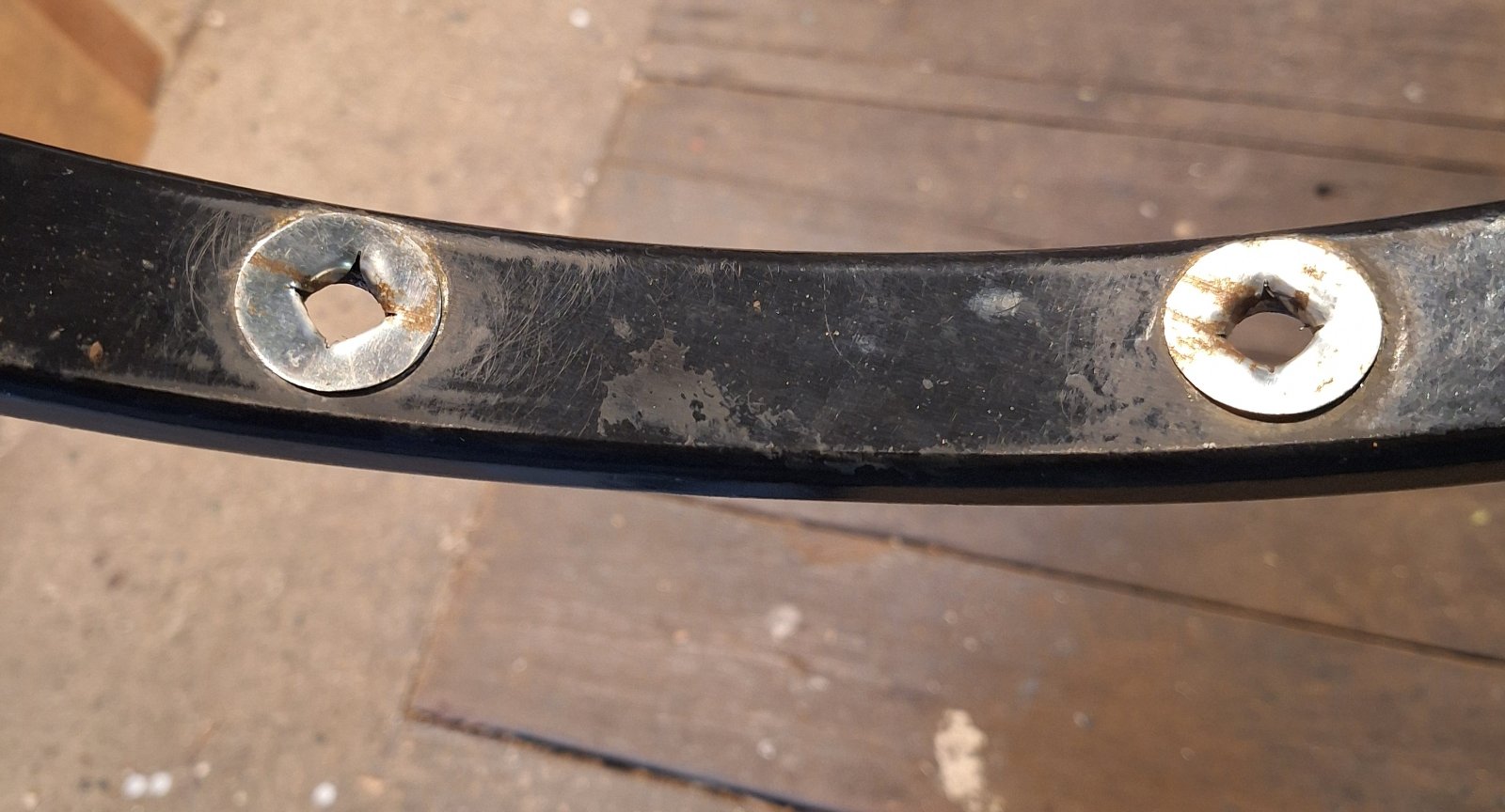

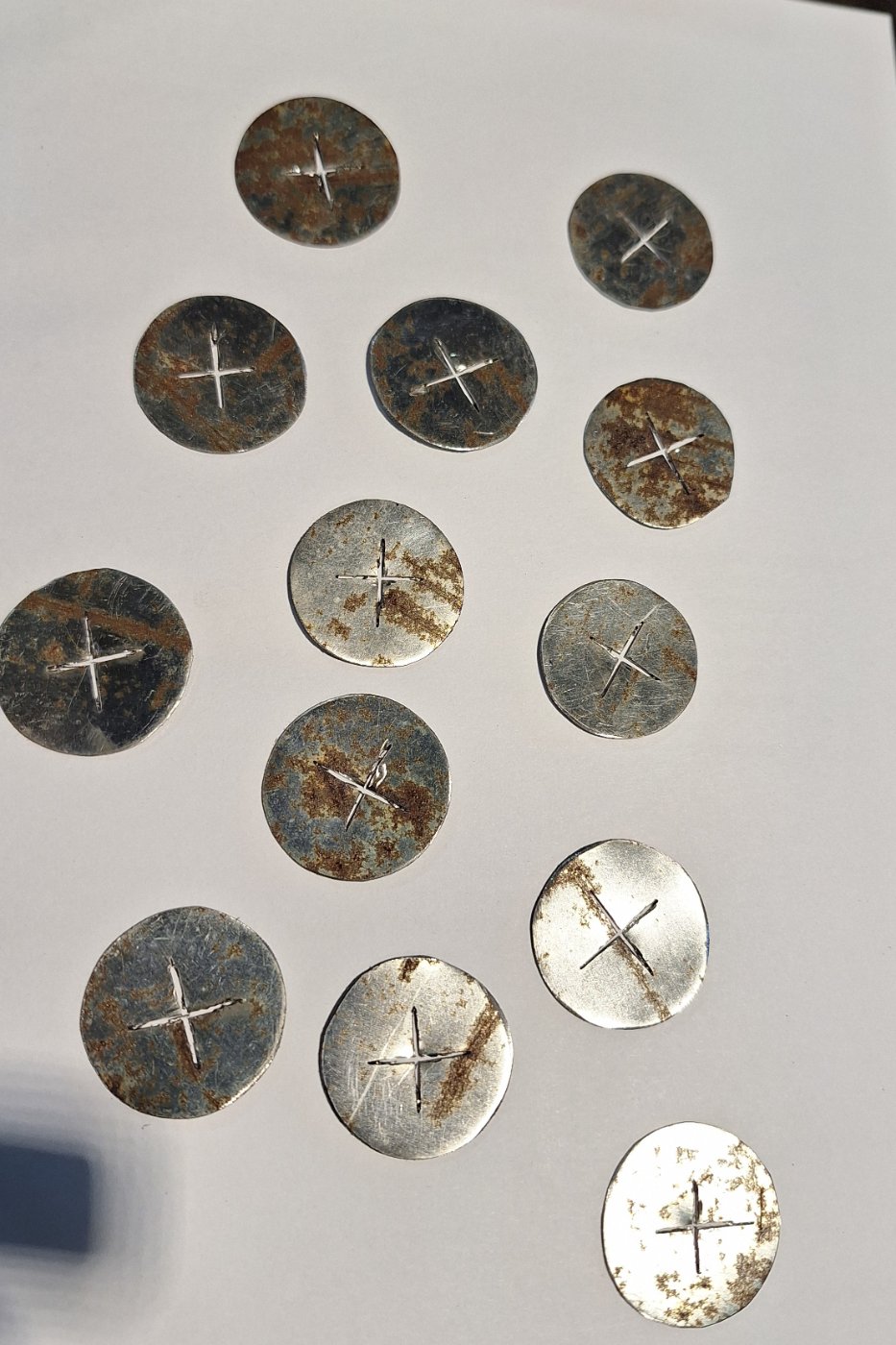

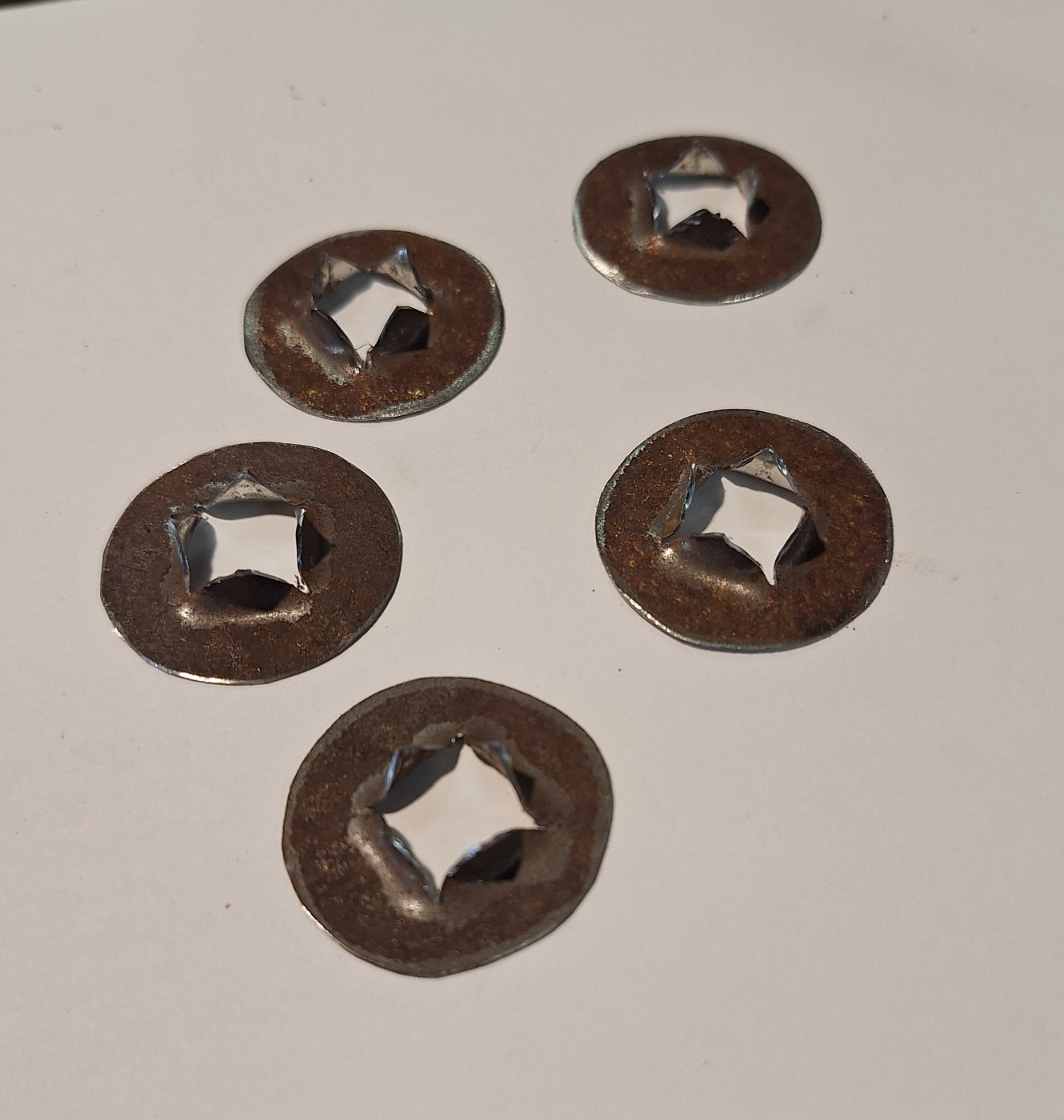

Back to the task. These shims were hand cut from a metal 4 gallon thinners drum. The brass shim I have was either way too thin or too thick
The crossed cuts were made with a Dremel slitting tool. Once they were done I used a blunt tapered punch to form the four points. These help to centre the tenon in the felloe hole. I will use. Some epoxy around the tenons just as a filler for any small gaps.

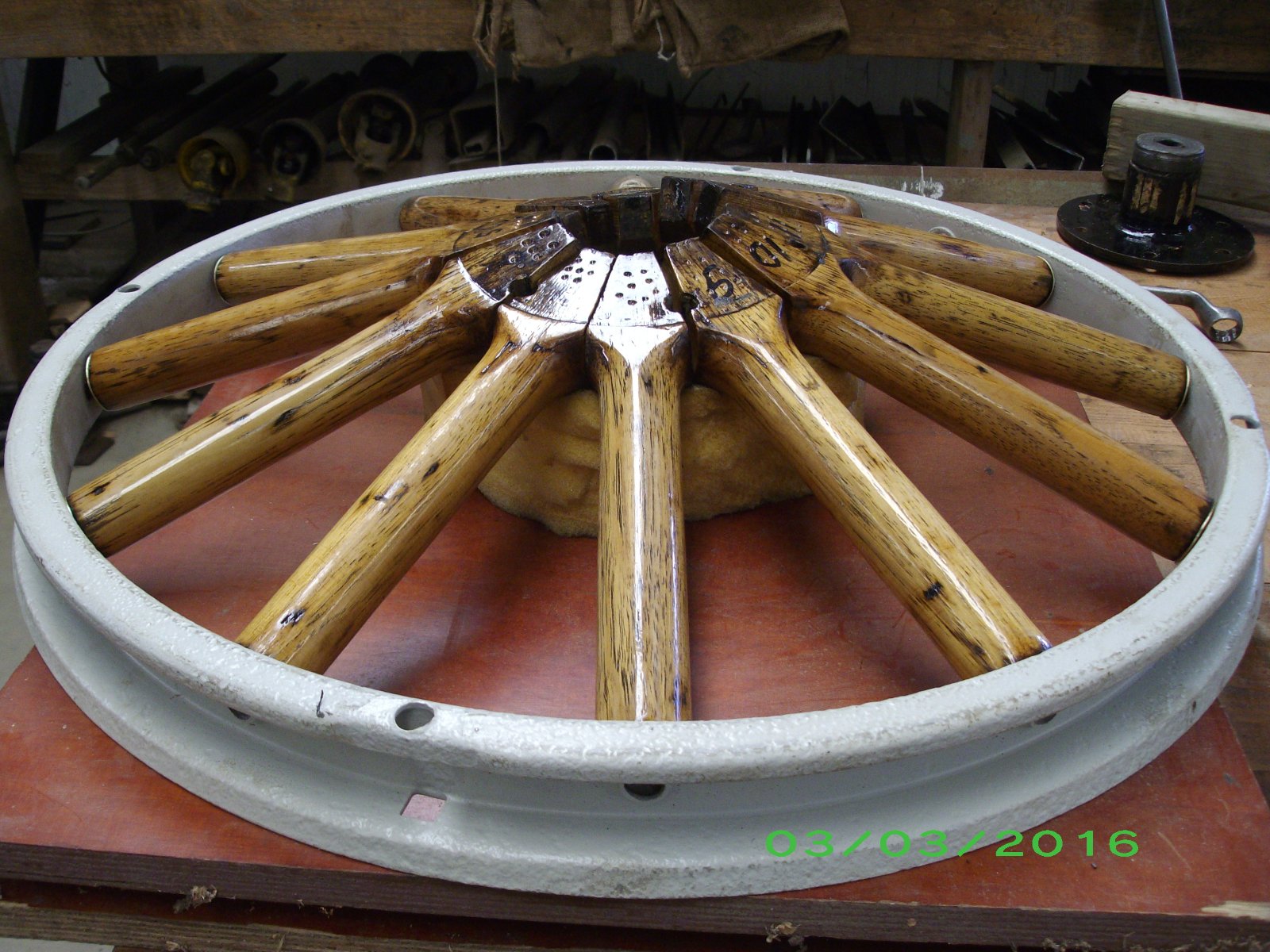

Post by Allan » Thu Mar 20, 2025 7:46 am

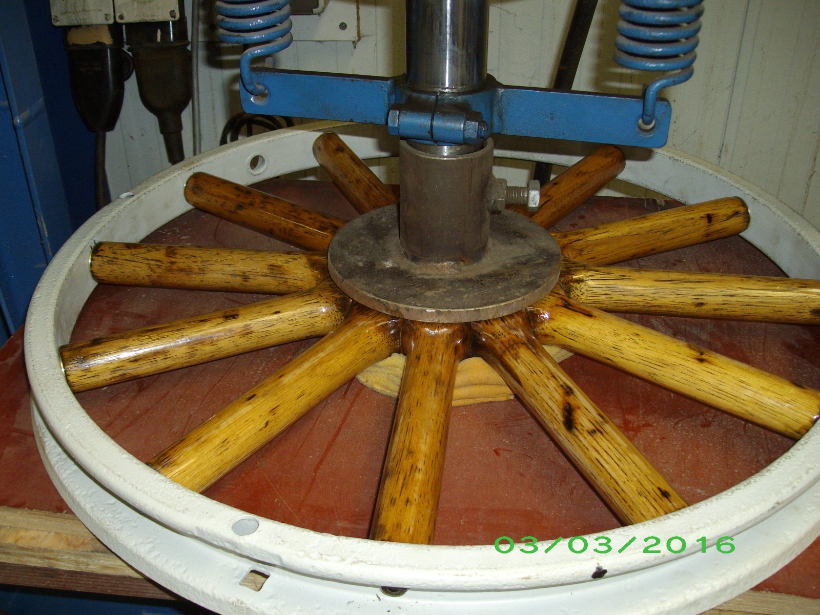

Here is the wheel reassembled with the shims in place. They made it too tight to drive the spokes all the way down, so it's off to my mate's workshop to use his power press
My workshop press is not wide enough to take a wheel.
