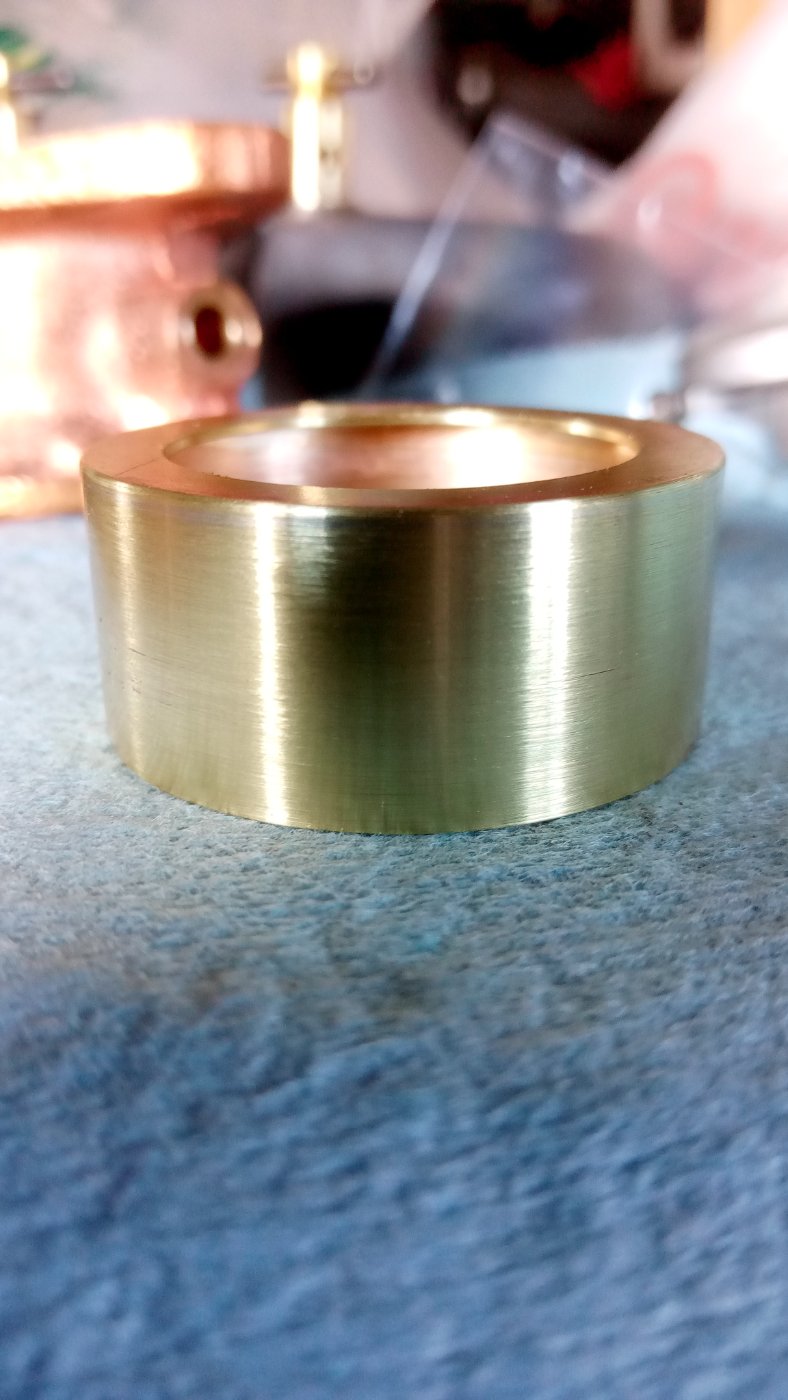

The void where the main jet was crudely drilled out has been filled in and machined back to as-new, a new venturi is done and now an interesting, fairly delicate venturi spacer needs to be made. This spacer clamps the venturi in place, as the throttle body is screwed to the main body of the carb. As finished, the brass is only .025 thick. Pictures of that job follow:

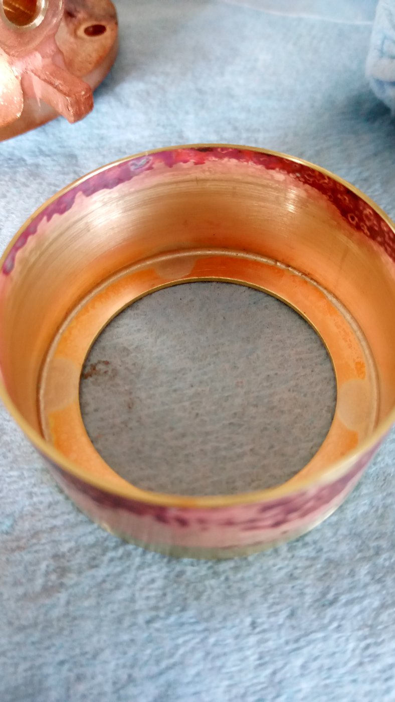

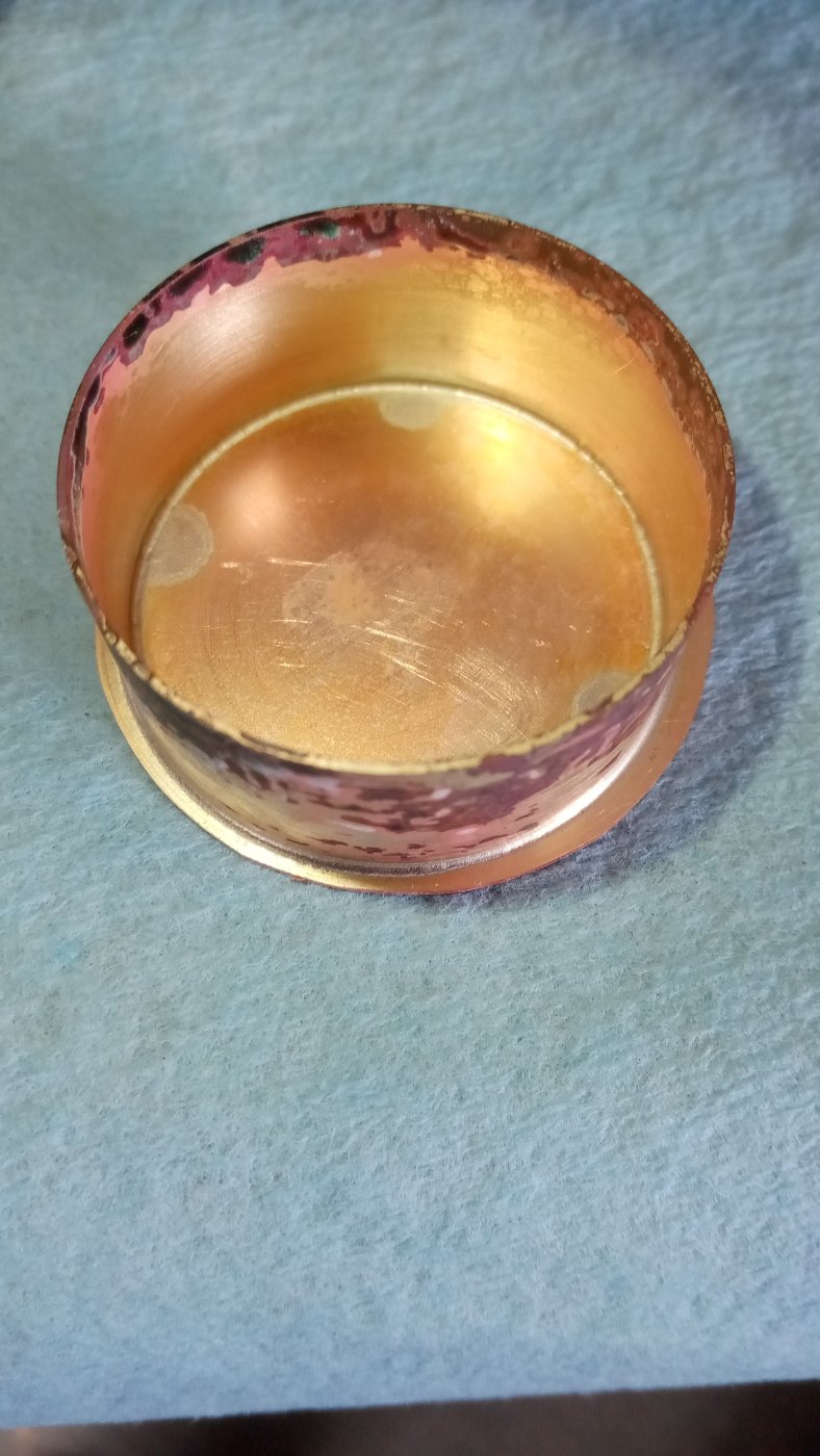

First, brass tubing is cut to rough length and turned to size...then a sheet of brass is rough cut to an oversize diameter. Four very tiny bits of silver solder are placed inside and heated. The fillet is absolutely minimal and wicks to the outside to give a nice undisturbed fillet on the outside, too.
Next, the flat sheet of brass is brought to diameter and bored to the ID diameter of the U & J's throttle body
Then finally, everything is cleaned up and now the solder seam on the OD disappears as the part is given its final finish. Once installed, the part is functional and virtually indistinguishable from an original
If you're curious, that part took 5 1/2 hours make. Material cost of raw material - brass tubing and brass sheet was $45 before shipping. Boring from solid brass would have been a horrendous waste of material.
I probably could have spun this part like the original, but I don't think it would have been any faster.
To me, a "repair" is something that will make the carb work, and perhaps a bored out slug of aluminum made in 15 minutes would have worked. On the other hand, to my mind, a "restoration" puts the carb back to original - indistinguishable from as-new.
I prefer to restore.
This kind of work is neither quick nor cheap.

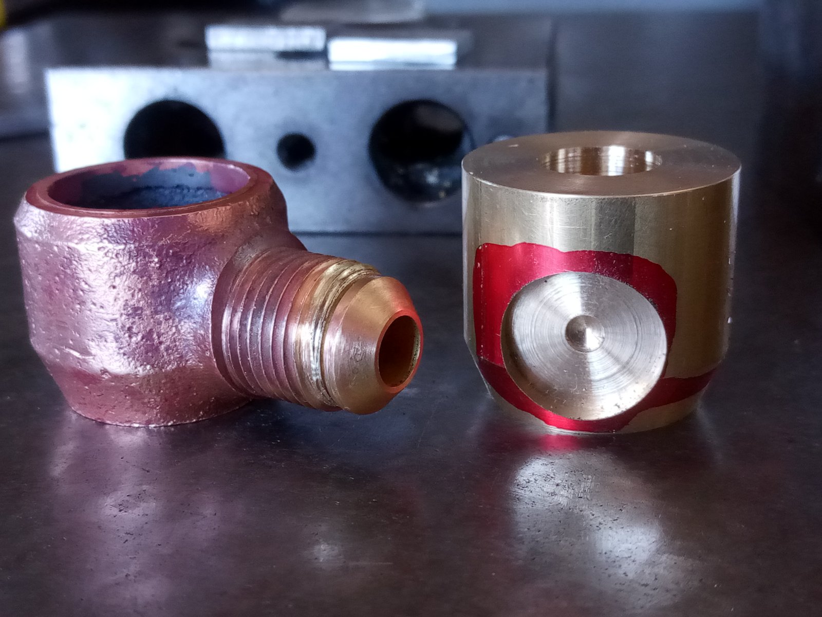

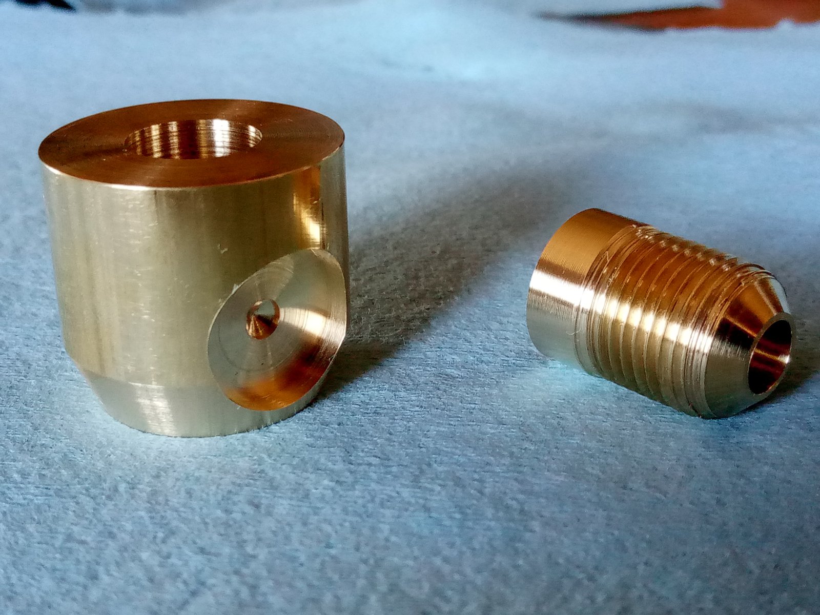

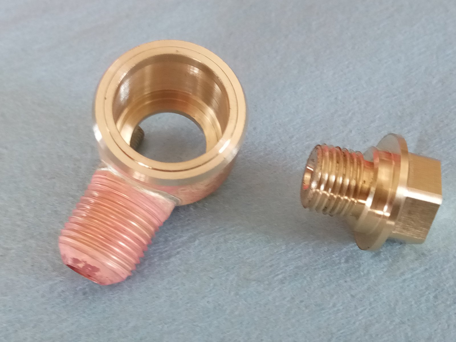

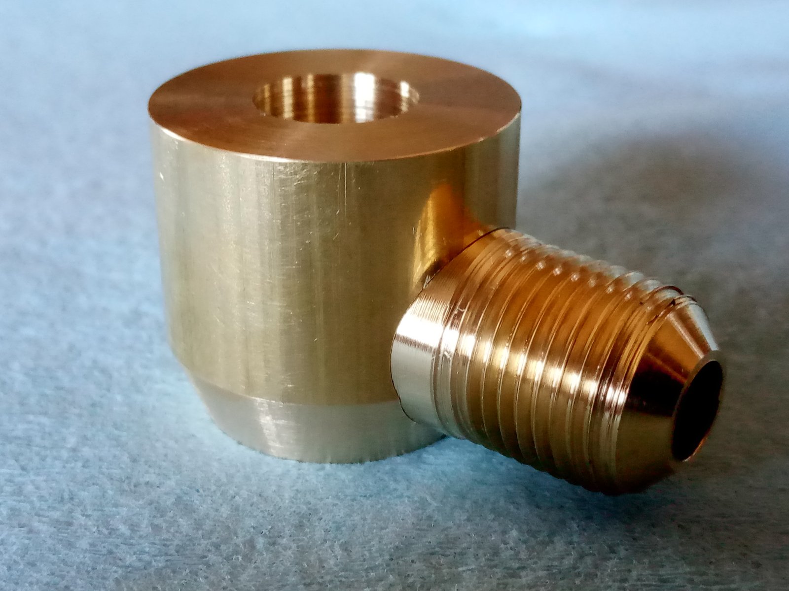

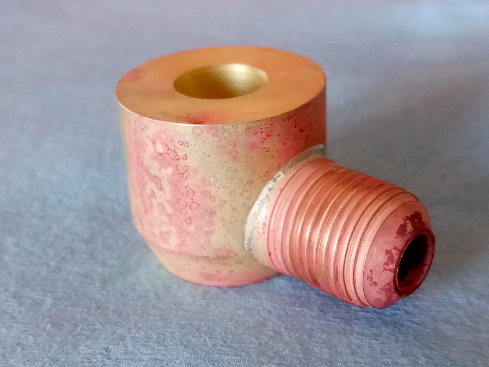

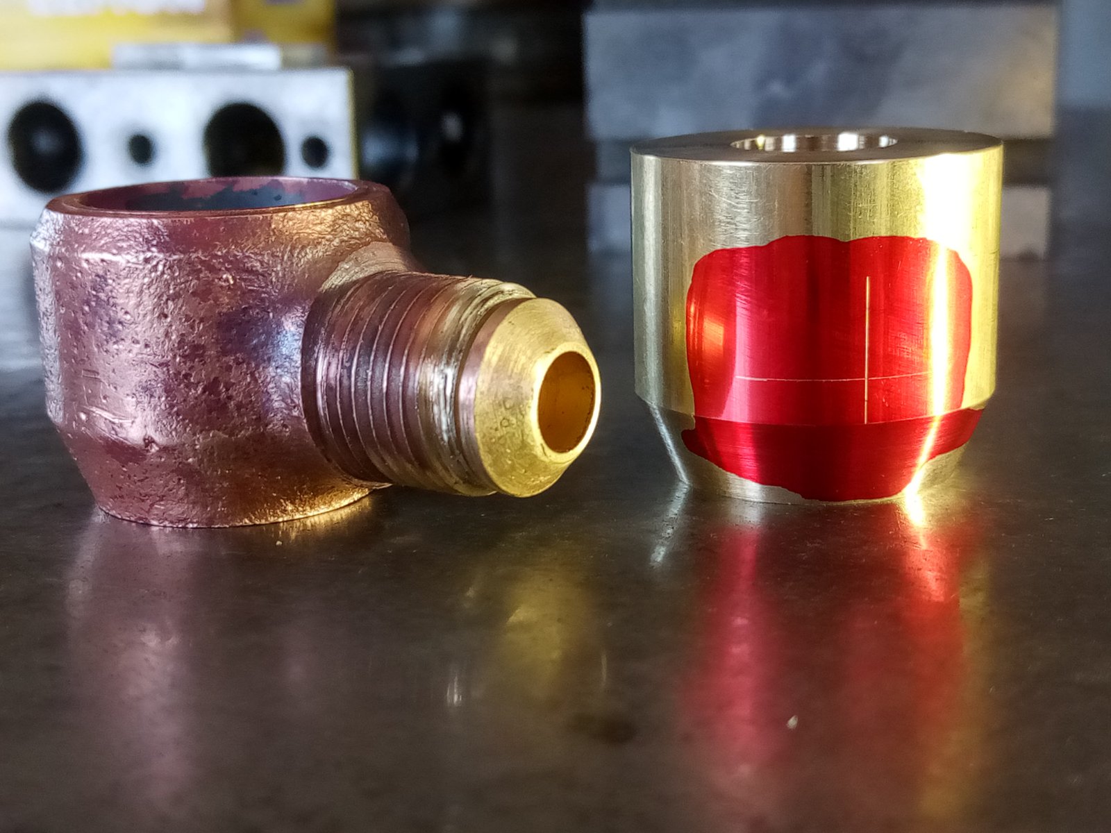

Some time back, I had a Zenith in for restoration which was missing the fuel inlet elbow and bolt. The first thing to do was to find a suitable example and duplicate it.
Parts are blanked out and then are soldered using silver solder. The amount of solder consists of two very tiny chips of solder, placed 180 degrees apart.
The pictures pretty much tell the story:
Because the original part was a casting, and the new part was a fabrication, when trying to duplicate a part as faithfully as possible, there are some considerations to be made. Where the casting has a filleted transition from the body to the threads, the fabrication has a much smaller fillet. Fillet size and final color of the solder can be controlled somewhat by using one silver solder over another, and varying the amount used. Because as the part ages, the solder will become more visible due to color change, I opted for a bit of a compromise, erring more toward a less-visible joint at the expense of a smaller fillet:
to be continued...
to be continued...

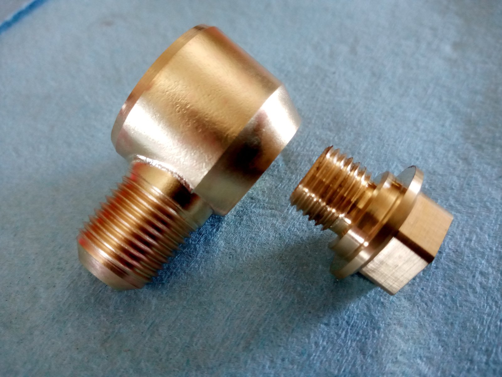

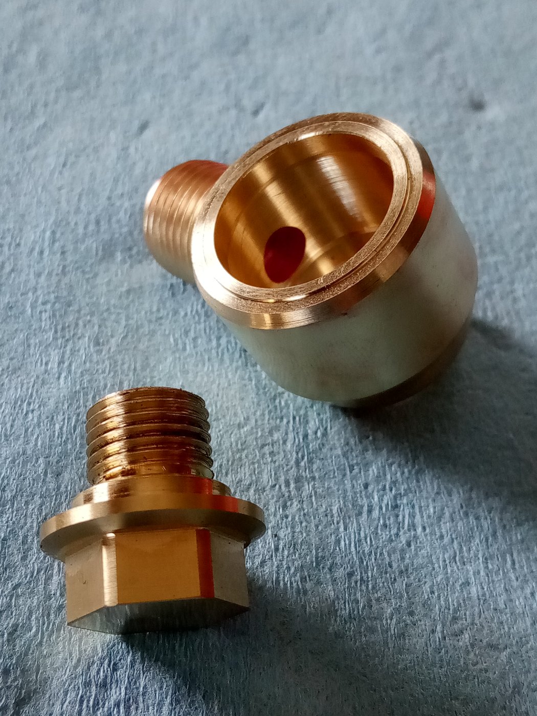

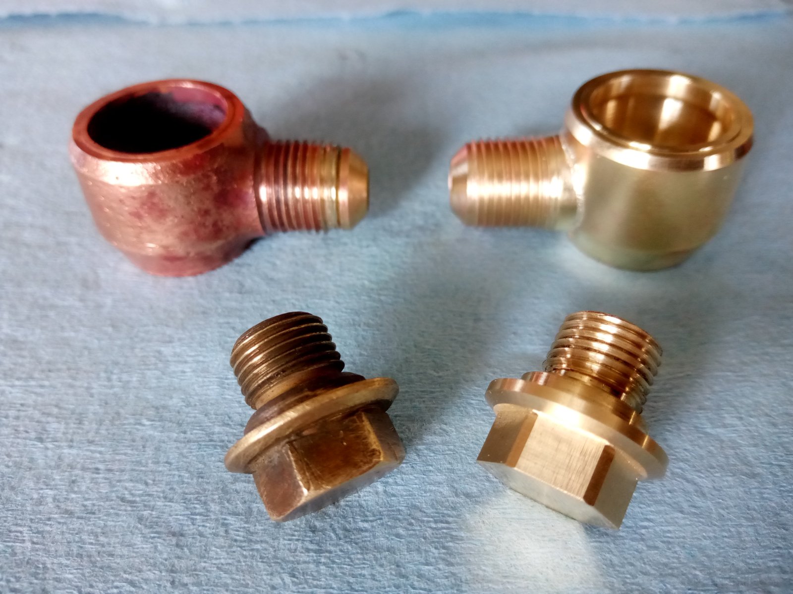

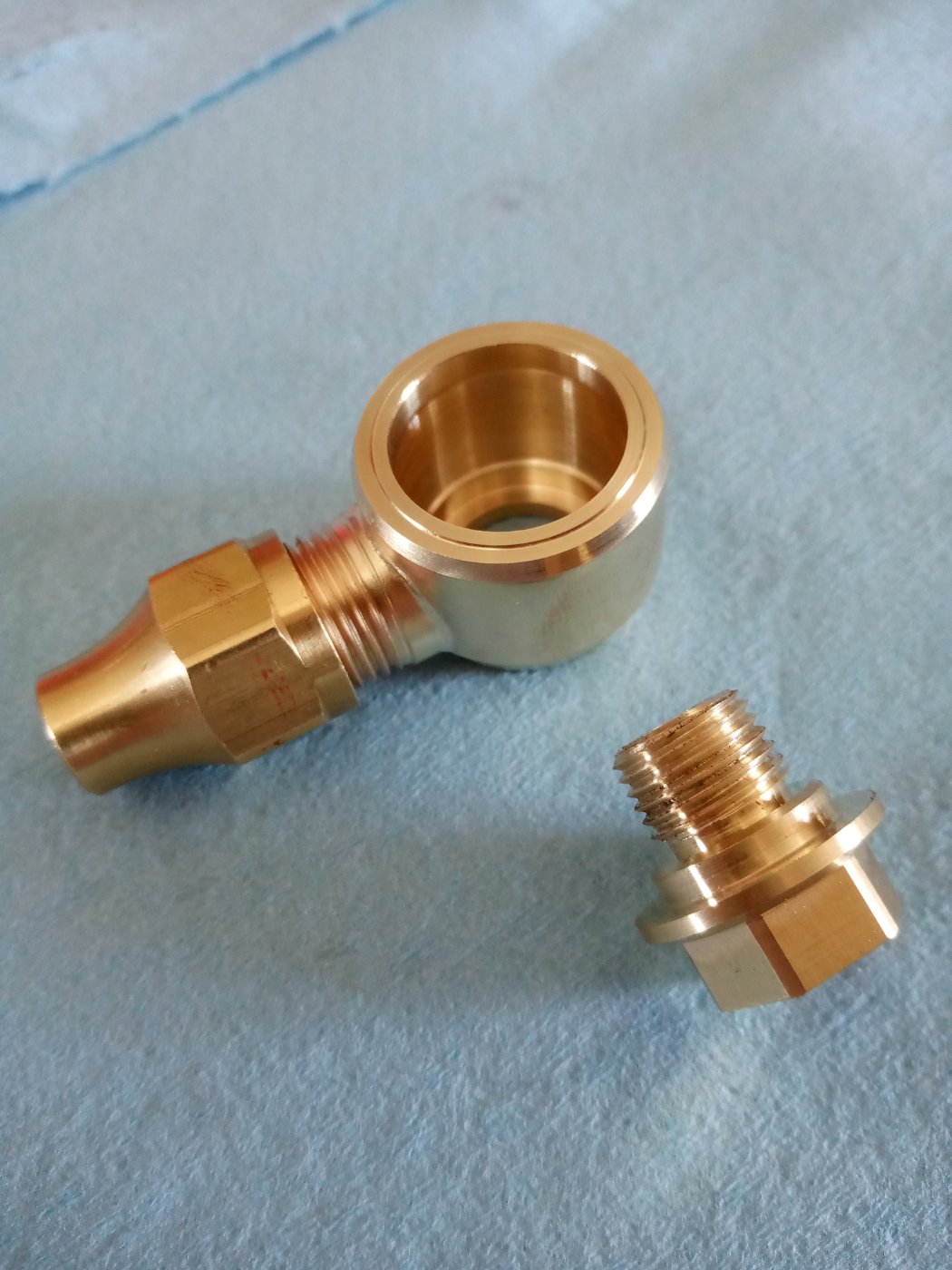

Continuing with the fabrication, more machining is involved:
And now some clean up to bring back the correct finish:
After about 8-9 hours of work - Finally, an original and the reproduction compared:
