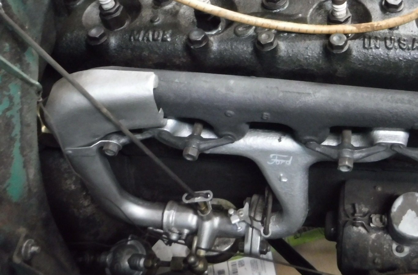

Post by Jim_PTC_GA » Fri Jun 28, 2019 9:24 am
I personally like to see the fuel, so all my vehicle's have a glass bowl water separator/fuel filter. I know the under tank bowl does a good job and the addition is not needed but I like it.
Bottom left of picture.
