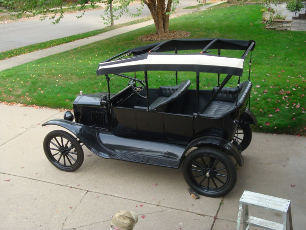

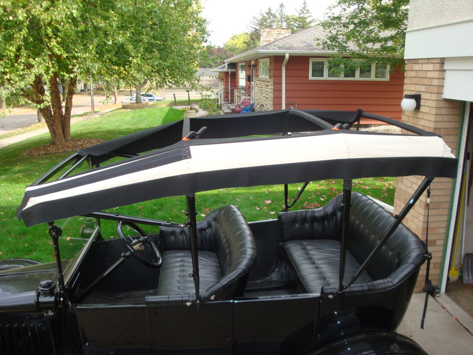

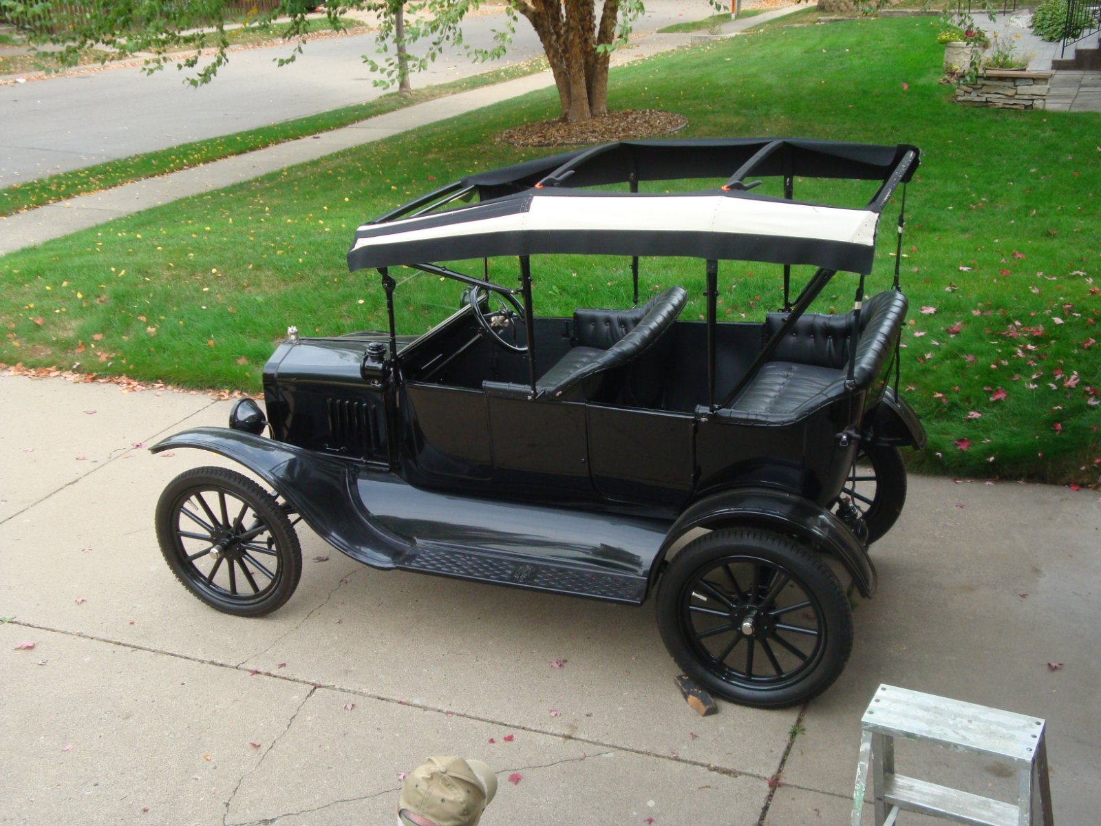

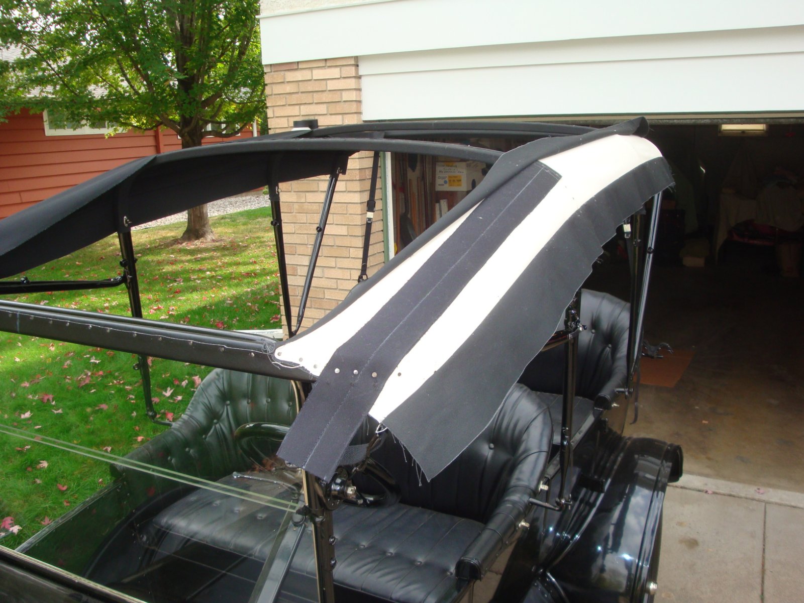

From the factory, there were no webbing straps undere the top.
The top pads serve that purpose and, if they are made correctly, they have canvas sewn inside them. There are two pieces of leatherette top material sewn down the middle tacked between the first and second bow as reinforcement (finished side down in the photos below).
