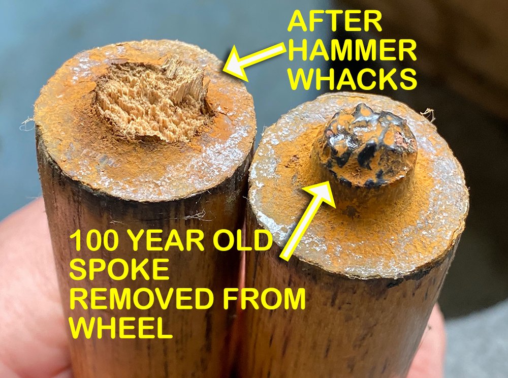

The movement in your spokes scares me. Use of shims and the like are just bandaid fixes. If the spokes are truly loose, you need new spokes. For the price difference, I prefer to have my wheels re-spoked by a professional and send mine to Noah Stuzman in Ohio. If you're going to do your own spokes you'll need a spoke press as well, and getting the right spoke length is critical.
If your wheel is loose on the axle, you could have a whole bunch of other problems. What does the taper and keyway on the axle look like? Is the hub or the taper so worn that you need a shim (available from vendors) or a new axle or hub? Do you have modern seals or the old felt type? Regardless, when you put a rear wheel on they have to be tight, tight, tight....like 90 ft-lbs or more. They also need to be checked after driving the first 50 miles or so after install.
Another thing to watch, sometimes a spoke looks good but the tenons can be rotten. A good side load and they can fail. I've attached a couple of pix showing what a tenon should look like and one that is rotten and ready to fail. I whacked such a spoke with a rubber mallet and it sheared right off.

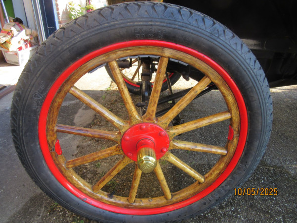

Hallo .
One of our Wheels of our 1912 have some spooks who are a little loose .
What is the best way to repair that ???
My spooks appear to be in excellent shape
Thanks for your answer .
Toon

A red rim causes spokes to loosen much sooner than a black non demountable rim :roll:
