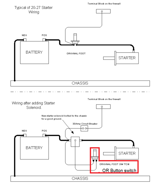

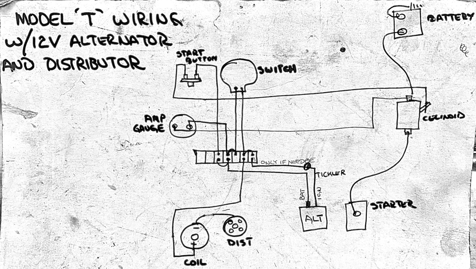

I don't like the location of the original starter button, so I am wiring a solenoid in my wife's 6v speedster (negative ground) and have found two vastly different wiring diagrams:
This diagram makes sense to me. The solenoid takes the place of the original button and a new button sends a signal to make the connection inside the solenoid. It shows 6v+ going to the small connection via the starter button.

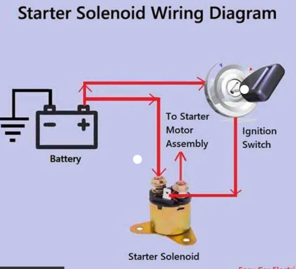

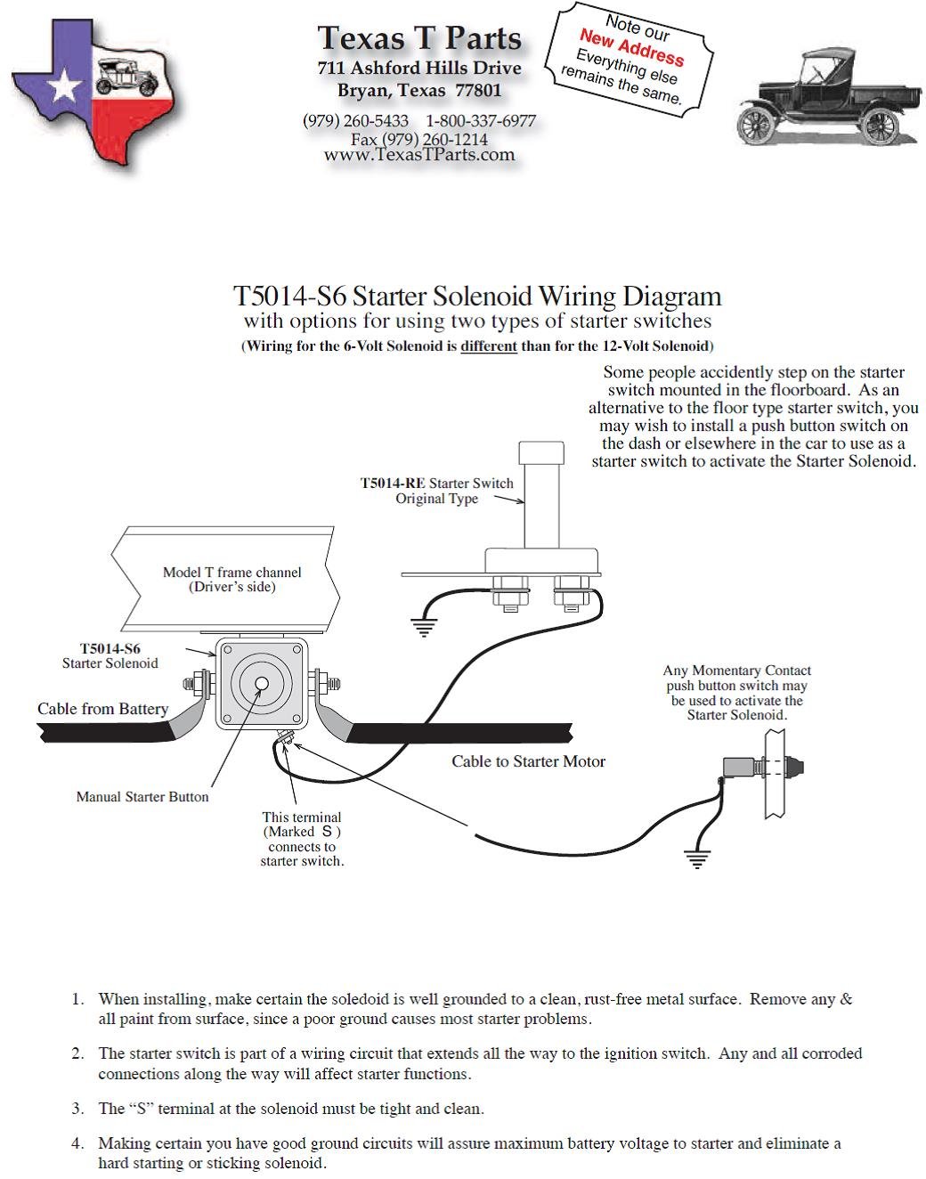

This diagram says it is for 6v system
I am using 6 volts. But the wiring is very different. This one show Ground going to the small connection via the starter button.
Why would the wiring be different just because the voltage is different?
Please help we wrap my head around this.

There are at least three different solenoid types, regardless of voltage, based on their internal wiring. They look almost identical and are easily confused. The first has the solenoid coil connected internally to the “battery” post and has a small stud for the trigger which will energize the coil when grounded through a switch. The second is exactly the same except that the coil is connected to the chassis ground internally and is energized when the small trigger post is connected to the voltage source, again through a switch. The third has the coil isolated internally and has two small posts which require connection with both ground and voltage. The manufacturer may or may not construct them with a manual button built into the solenoid. They are also produced for either intermittent or continuous operation either of which will work for the purpose of operating a starter.

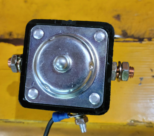

I will try this solenoid:
Wired with the second diagram.

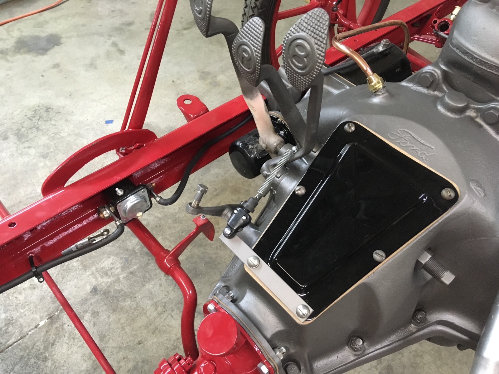

I use the same solenoid mounted inside the frame with a starter button out the bottom of the coil box.

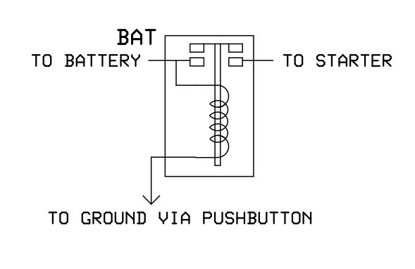

When I put a starter on mt '16 I used a three terminal solenoid.
The solenoid had one of the large terminals marked "BAT".
Below is the diagram of the solenoid that I used.
As you can see, the coil is internally connected to the "BAT" terminal.
The small terminal needs a ground to activate the solenoid.
Respectfully Submitted,
Be_Zero_Be

Post by Dollisdad » Thu May 22, 2025 11:20 am
Using the hand brake bolts as an attachment location, I remove the paint between the bolts so the solenoid grounds to the frame. The mounting holes in the solenoid will have to be enlarged to accept the hand brake pattern.

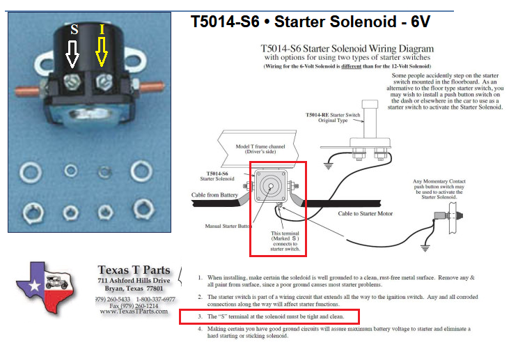

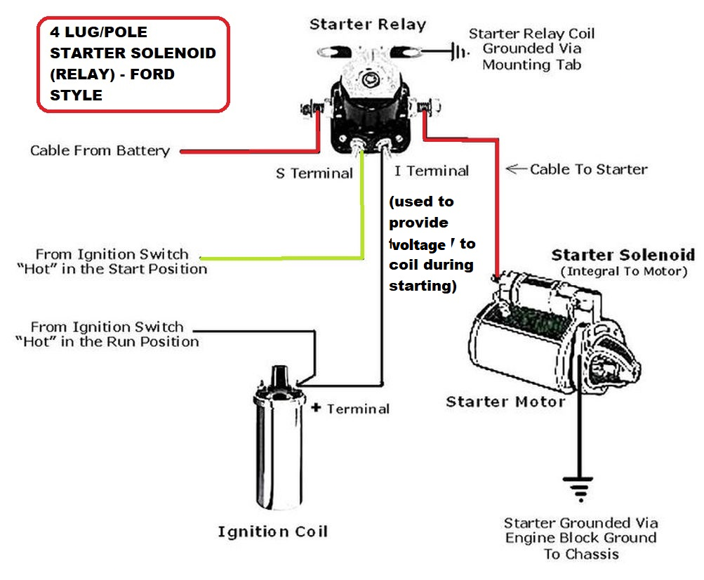

There are different types of solenoids based of use: Continuous, Intermittent & Marine. The intermittent (Ford style) is for automotive use.
Irrespective of voltage there are 3 pole & 4 pole configurations. Each of these is wired differently for a starter button (there are some other dependencies we don't care about) . The initial diagrams above are correct for each of these type but not labeled as such. HOWEVER, the TEXAS T instructions confuse the issue in showing just an S pole on the wrong side of the unit while the photo in the catalogue shows a 4 pole solenoid.
So what type of solenoid are they selling, 3 o4 4 pole?
So for a 4 pole solenoid

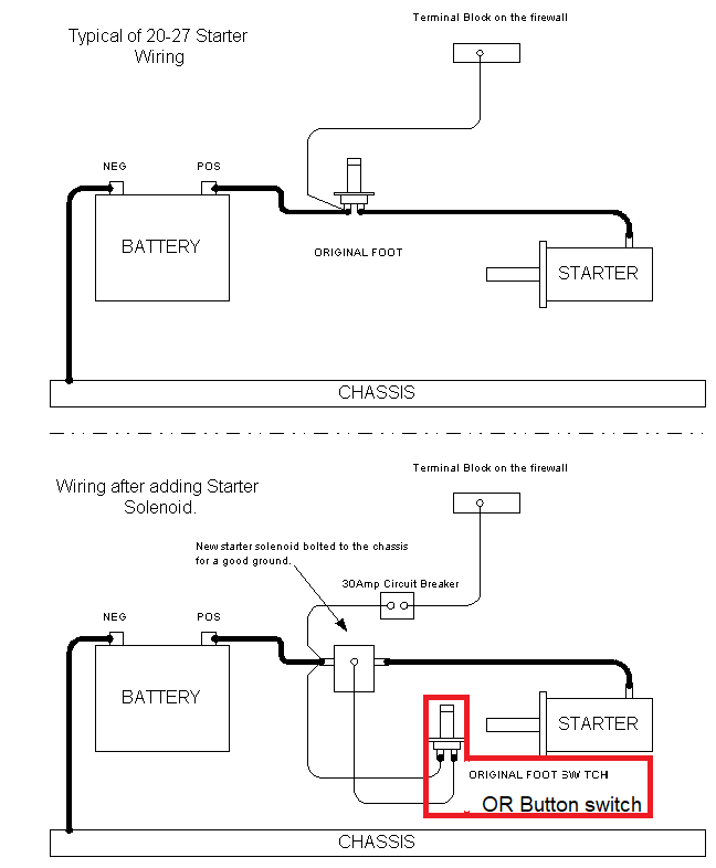

For a 3 pole solenoid

I have a 4 pole solenoid mounted on the bottom of the frame rail in my '14. I have the start button on the bottom of the coil box where I can hit it with the tip of my shoe, very handy if the engine stalls at a traffic signal. Because I'm using the regular T ignition with coils, timer and mag, the "I" terminal is not in use.
The noticeable difference between the 3 pole and 4 pole solenoid schematics is that with the Texas T 3 pole diagram, the switch/button circuit appears to provide intermittent ground to the "hot" S terminal. With the 4 pole diagram, and in my car, the "hot" switch/button circuit provides the S terminal with intermittent voltage. My installation has been working fine for 10 years.
