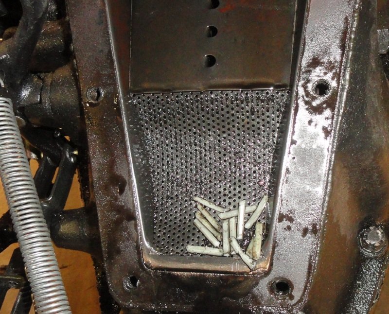

Bill Robinson
- Posts: 316
- First Name: Bill
- Last Name: Robinson
- * REQUIRED* Type and Year of Model Ts owned: '21 Depot Hack, '25 Touring Car, '26 Roadster Pickup, '27 Tudor, & another '27 Tudor
- Location: Salty Bottom, ALABAMA AL
Re: 7.5 degree timing advance
Back in NOV 2015 I got stuck on the side of the road. Here's why (see photo). Upon repair I installed the bronze gear and have had no problems.
