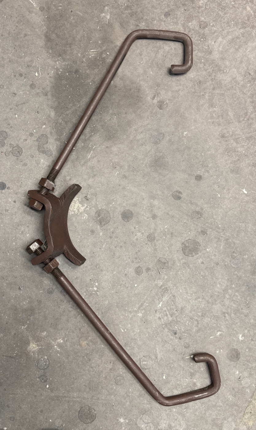

I was able to obtain a Trusko support bracket thinking it would help support the added weight of a Warford transmission.
While poling around I found an old post showing that Trusko also made a Warford support bracket.
My question is, should one shown help, since it supports the drivetrain ant the 4th main, of should I search/ make for the style shown in the old ad?
Thanks,
Scott
Posts: 5443
Re: Warford Support bracket
Post by RajoRacer » Mon Jun 02, 2025 1:13 pm
Yours appears similar in construction to the Warford accessory with the addition of the "collar" that supports the ball cap - see how it fits in place with the Warford installed or you might drill out for the drain plug & whack off the collar. Anything support is a bonus for holding up the extra weight !
South Park Zephyr
Posts: 371
Last Name: Francis
Location: St Louis MO
Board Member Since: 2022
Post by South Park Zephyr » Mon Jun 02, 2025 2:24 pm
It appears they made both styles
I agree, something is better than nothing. I have a homemade one on my car now, but I want an original style one.
