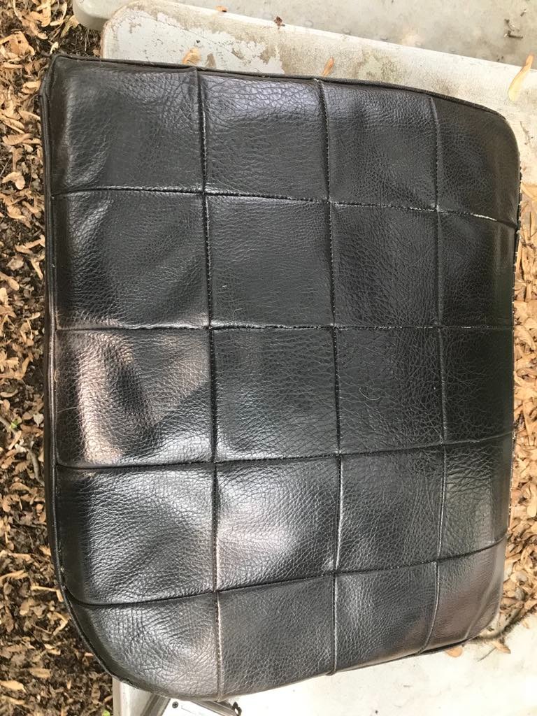

Can someone recommend someone who can make a cushion like the one pictured at a reasonable price? Rough dimensions are pictured but I'm no DaVinci. Whomever does the job can use the existing cushion for more accurate measurements.

I'm glad to see you don't have diamond tufting. American LaFrance used this square upholstery pattern. I supposed it carried over to their partner rigs like Brockway.

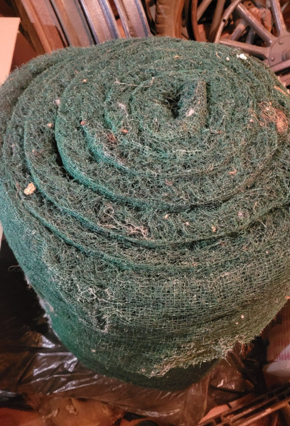

I don't think ALF used any springs. I would use modern rubberized horsehair as a base and real horsehair for cushion cush. I have some.

The real reason behind the square pattern in upholstery is the likely price. It enables small pieces of leather to be sewn into larger covers of infinite size. There is no need for a single hide to be big enough for the job. Probably this is why the pattern was used in commercial vehicles with large cabins and seats to match. Deep buttoning gobbles up fabric at an even greater rate than simple pleating with buttons in the pattern.

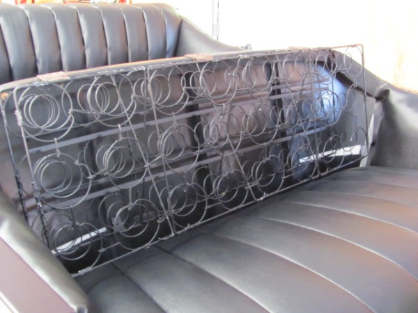

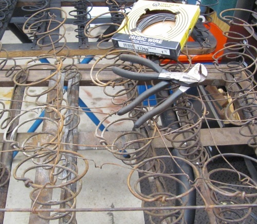

Doing coil spring seats requires spring steel music wire.
IMG_1267 (500x436) (500x436).jpg (149.53 KiB) Viewed 1699 times
Really difficult to cut, stretch, and to tie off. Know as did some repair by adding reinforcements to old (non-T body) seat cushion springs and wasn't a walk in the park! Lifted up the coils and gave them more support by adding more strands of music wire. Did get the seat springs and the rear backrest spring looking and working better with more support.

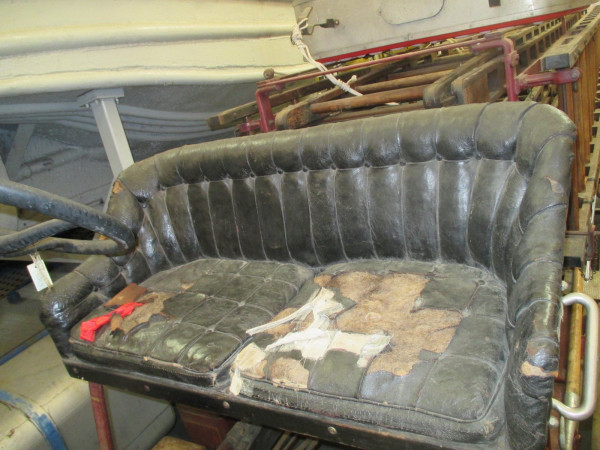

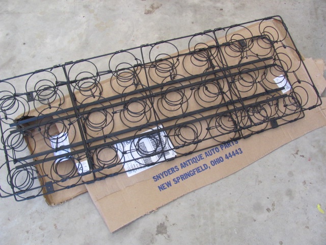

Snyder's knows seat springs, they made me a new one for the front backrest, as the old one was well beyond repair as the coils were so flattened. and missing pieces. I gave up on working that one!
