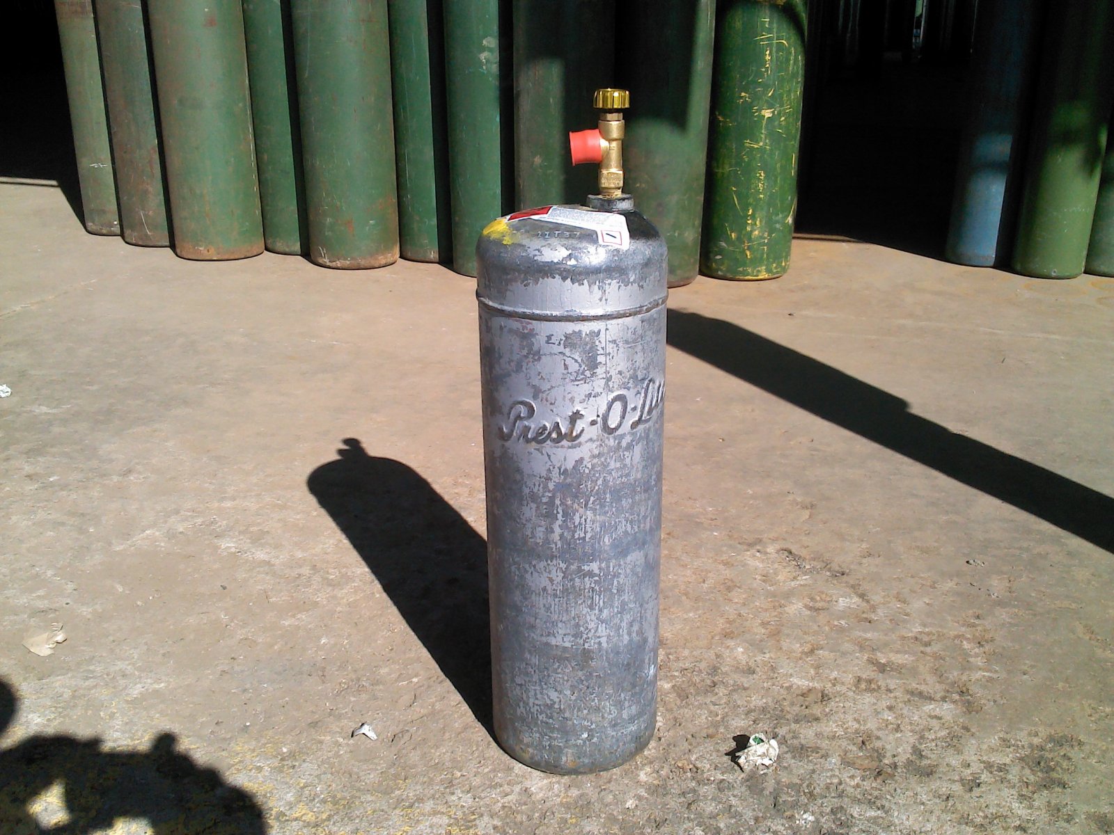

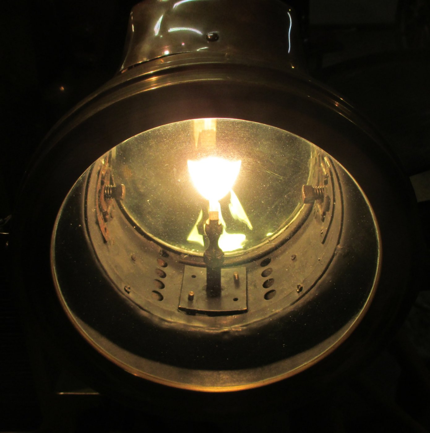

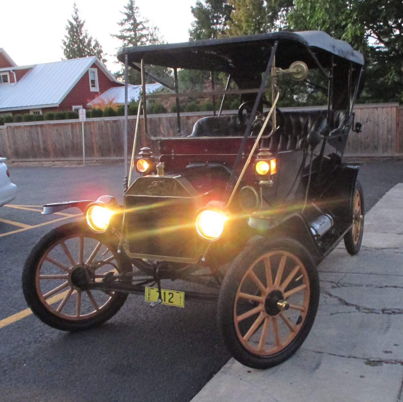

Brent,
I LOVE burning my acetylene lamps with my Prest-O-Lite B tank!
As noted above, the stock acetylene generator is messy and needs to be cleaned out after each use.
Brightness depends of what size of burners you have. Burners are marked: 1/2 , 5/8, 3/4, etc. The number indicates cubic feet of burned gas per hour. Ford used 3/4 burners.
An MC tanks can only be used for a brief static display!
The problem with using an MC tank is it will not provide adequate acetylene supply for the lamps to be used continuously. You can only use it for brief demonstration purposes.
I have to put on my safety guy hat here:
"To minimize the withdrawal of liquid solvent, acetylene should be withdrawn from the cylinder at a rate not to exceed one-tenth (1/10) of the capacity of the cylinder per hour during intermittent use. For full withdrawal of the contents of the cylinder on a continuous basis, the flow rate should be no more than one-fifteenth (1/15) of the capacity of the cylinder per hour.
If you don't adhere to withdrawal rates, acetone (contained in the acetylene cylinder to stabilize the acetylene gas) will be drawn off with the gaseous acetylene. This acetone reduction from the cylinder makes the cylinder unstable and poses an explosive hazard. The acetone withdrawn with the acetylene gas passes through the regulator and on through the entire system. If this happens...the acetone deteriorates any rubber or plastic parts of the system. Typically, the regulator will fail and shut down the system before the cylinder becomes unstable."
An MC tank holds 10 cubic feet of acetylene. Standard burners used are 3/4 (that means they burn 3/4 of a cubic foot of acetylene per hour.) Since there are two of them, the flow is 1-1/2 cubic feet of gas per hour. So you are already way outside of the safety standard. If you use burners marked 1/2, you can get down to the safe operation range for intermittent use. However, 1/2 cuft burners only give off about 18 candlepower. Whereas 3/4 burners give off about 29 candlepower.
The B tank holds 40 cuft of acetylene. The E tank holds 30 cubic feet. Either a B tank or an E tank are ideal for continuous use.

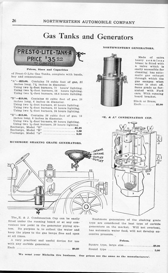

To elaborate on what Keith posted, efer to the upper left of ad below.

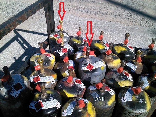

Best way I've found to find a filled Prest-O-Lite tank is to ask the supply house to let me look
at their B-tank rack of filled cylinders. Below is a photo of acetylene B-tanks at an Airgas
near me where I exchanged a POL tank for another POL tank I posted above. There were two
(arrows) POL tanks in the rack of standard center-valve B-tanks and I took the one in the back/left
corner with the "coarse" valve since I use the small regulator. The other POL is a "fine valve"
(no knob) which works good if you just want to "crack" the valve like Keith prefers.
Most supply house folks I've worked with are not aware of what the off-set valves were for;
valve-up on a running board to keep the acetone in the cylinder.
Also, they WILL NOT refill old POL tanks with the pressure gauge in the bottom of the tank
and NO ATTEMPT SHOULD EVER BE MADE to transfer acetylene gas between tanks.
Propane should not be used in Model T acetylene gas headlamps.
