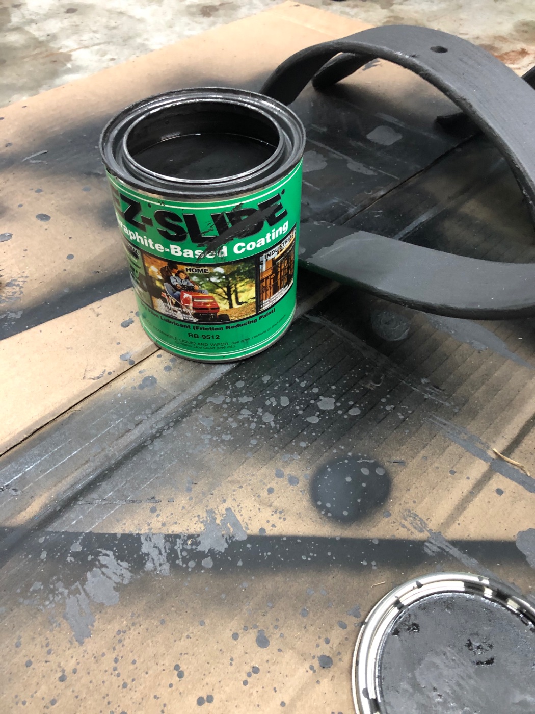

E-Z Slide paint is just a graphite powder in an oil base paint - make your own
You could also used some 5th wheel lubricant - many companies make it. Has to be available in Alaska
