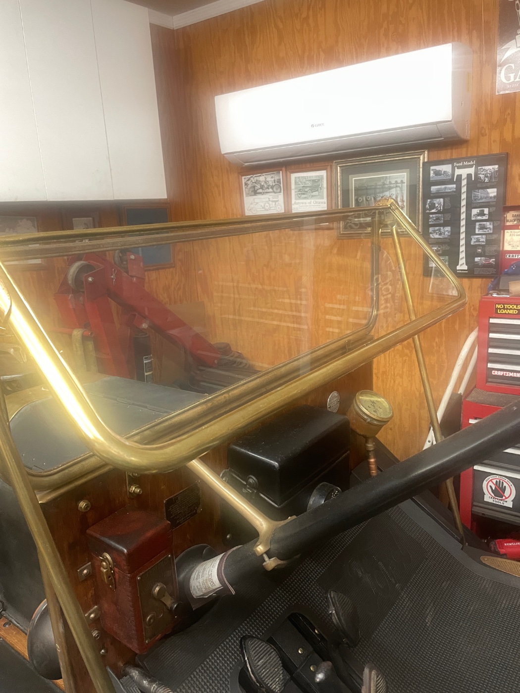

For real dull tarnished parts have used the ketchup trick, it works to remove stubborn brown tarnish!
But for brass windshield for the '12 project, the brown tarnish was removed really fast, by hand, applying about 2 coats. Bit more on some spots, but impressed by this stuff!

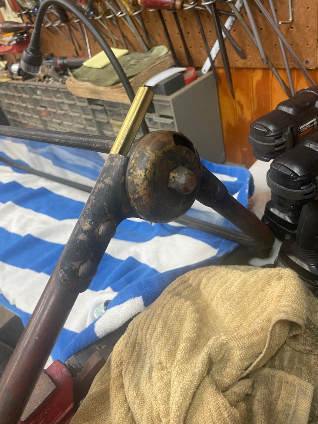

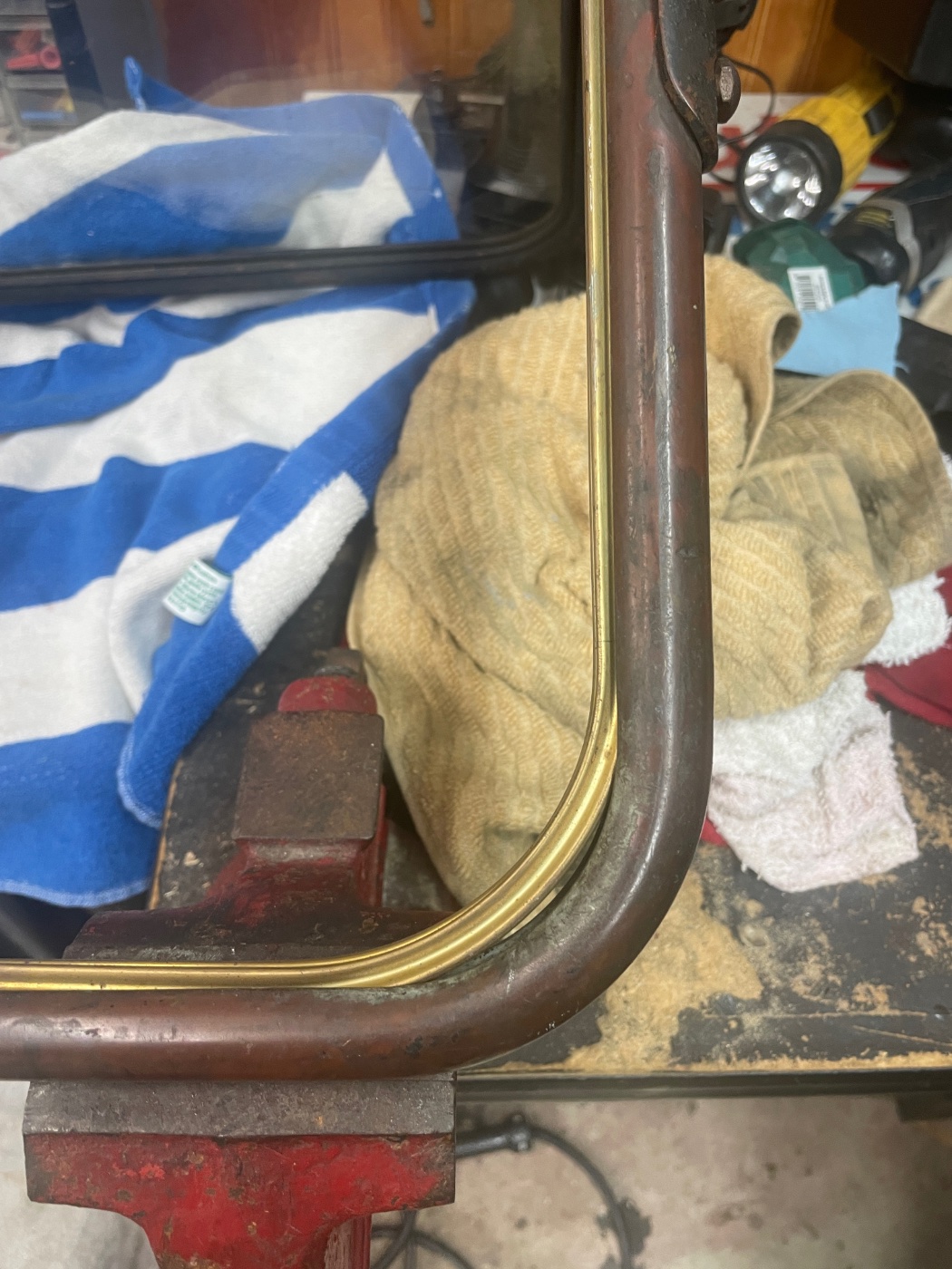

For heavily tarnished brass, use Bar Keepers Friend and then follow-up with your favorite polish. It works extremely fast, even if the brass is brown. Wear nitrile or rubber gloves when using it.
It's inexpensive and available in powder or liquid and you can find it a Walmart and, if you are in the midwest, Menards. However, my opinion is that the powder works better than the liquid.
It's also fantastic for polishing chrome and cleaning stainless steel. If there is rust blossoming through the chrome, it will remove the rust.
