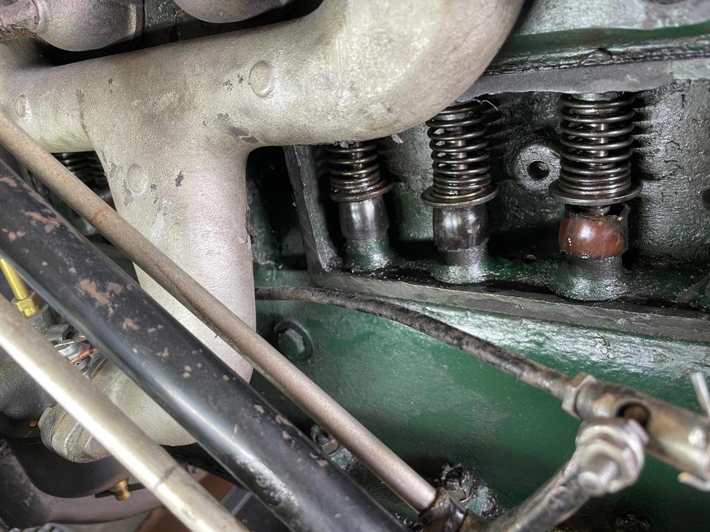

Hello specialists,
I'm currently restoring a 1917 Ford T Touring by Dunkan and Frazer from Adelaide, Australia. Because I also want to adjust the valves precisely, I removed the cylinder head and both valve covers. I discovered that the tappet outlets were fitted with short plastic sleeves from a plastic hose. What could have been the reason for this being done by a previous owner?
Note: The installed valves all have a larger "plate." I removed these sleeves to adjust them to standard. But what was the previous owner's intention?

Perhaps to retard oil leakage from the pushrod action of crankcase oil splash.

Thanks for your assessment. That was my initial guess, too.

There should be oil drain back holes in the chamber.
I would be concerned that inhibiting oil here might minimize the oil to lube the valve stems.
This would limit oil being sucked past the guides reducing oil consumption/smoking from excess guide/stem clearance.
These rubber caps/tubes are a patch for another issue(s).
They are unnecessary in an in spec motor.

Yes, that's what I was thinking about, too. I've already checked the play in the valve guides; it's really minimal. Perhaps that was the case with the older valves. The valves installed now are fairly new. I think those plastic sleeves would be rather unfortunate. That's why I removed them.

Are the larger "plates" just flat washers? If the valve springs are retained by the original style keeper pins, a simple flat washer will allow them to drift out of the valve stems. Maybe the hoses were supposed to help retain them?? The original "plates" have a recess in them that captures the pins and does not allow them to fall out.Anton Seelmann wrote: ↑Thu Jul 31, 2025 3:36 pmHello specialists,

A common upgrade to a restored engine is the fitting of one piece Holden V8 exhaust valves to replace the original two piece valves. These do not have the usual cupped keeper and pin to retain the spring. If you can see collects holding the keeper in place they have likely used the V8 keepers as well. The standard T valve spring engages the same land on the keeper as the inner spring of the V8, so the flat washer you are seeing may well be the outer rim of the larger keeper.
I cannot see any benefit to the plastic hose bits either.

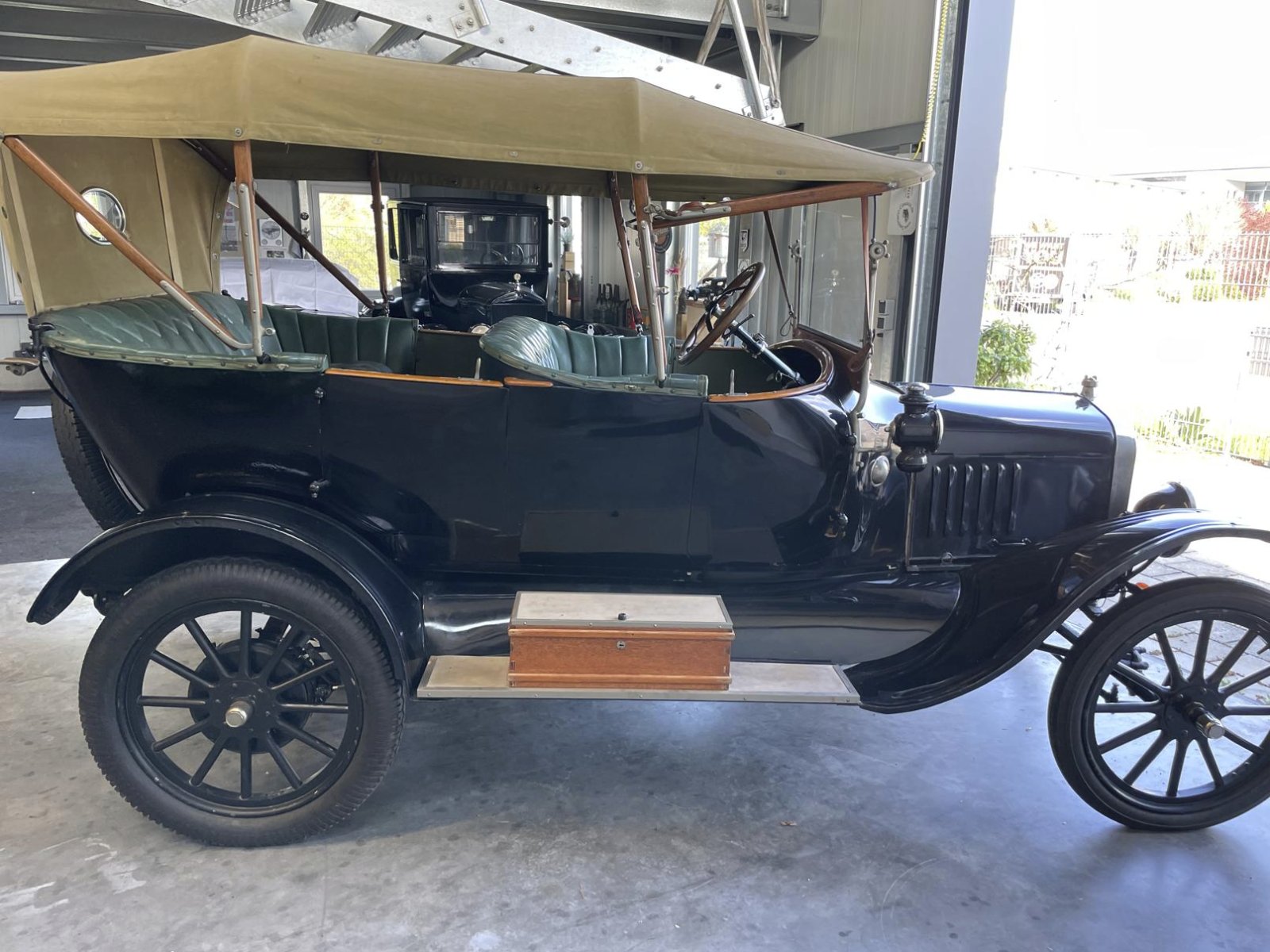

Here are some more pictures before the restoration. I'll report back here in the forum later. Thanks for your feedback.
Regards, Anton

Beautiful car.
The license plate numbers in the painting match the license plate numbers in Antons's photo and the car looks very similar.

Jerry: The larger valves are "modern style" with valve spring retainer split keepers.

Allan: Yes, it really is a nickel beauty, as you described. On the exhaust valve plate, you can see Holden and an N. The valve spring retainers have a split keeper. It's now certain that this is the T from Bob Chantrell in Adelaide. I compared the license plate number on the painting Kerry posted with the photo I also posted. They are identical. Many thanks to Kerry for the painting!
