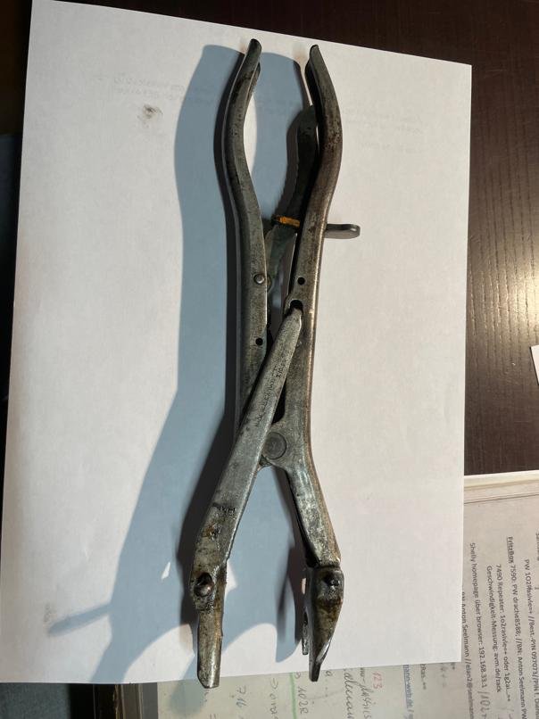

How do I install the split keepers when the engine is in the car and the intake and exhaust manifolds are mounted on the engine?
I use a compressor tool for the spring - see photo.

There are tools made to do that.
- Posts: 7275
Re: Easy way to install valve split keepers?
You do need a valve lifter which lifts in parallel. Otherwise the keeper and spring will be cocked and the two collets cannot be fitted. With the springs truly compressed, "glue" the collets to the valve stems with the suggested heavy grease. Taking the inlet manifold off makes it much easier.
