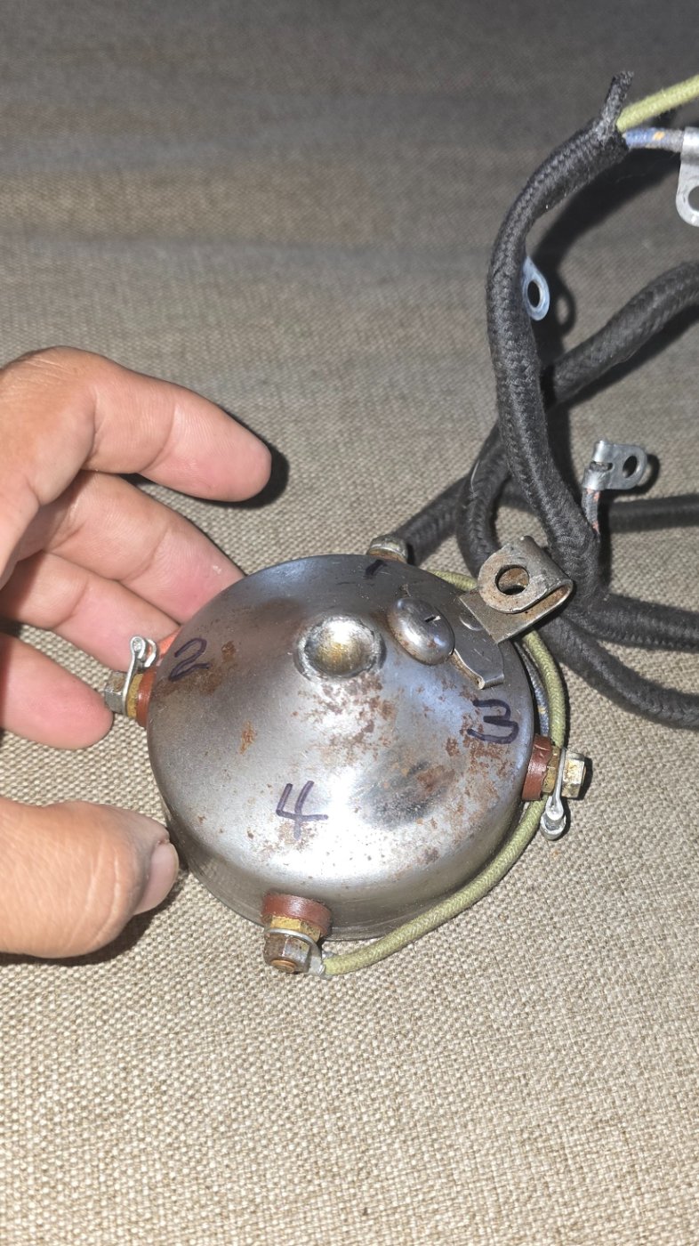

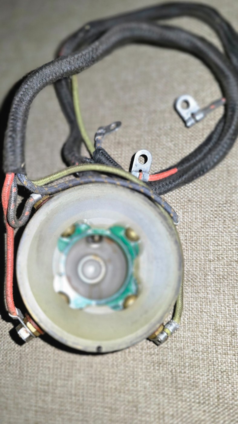

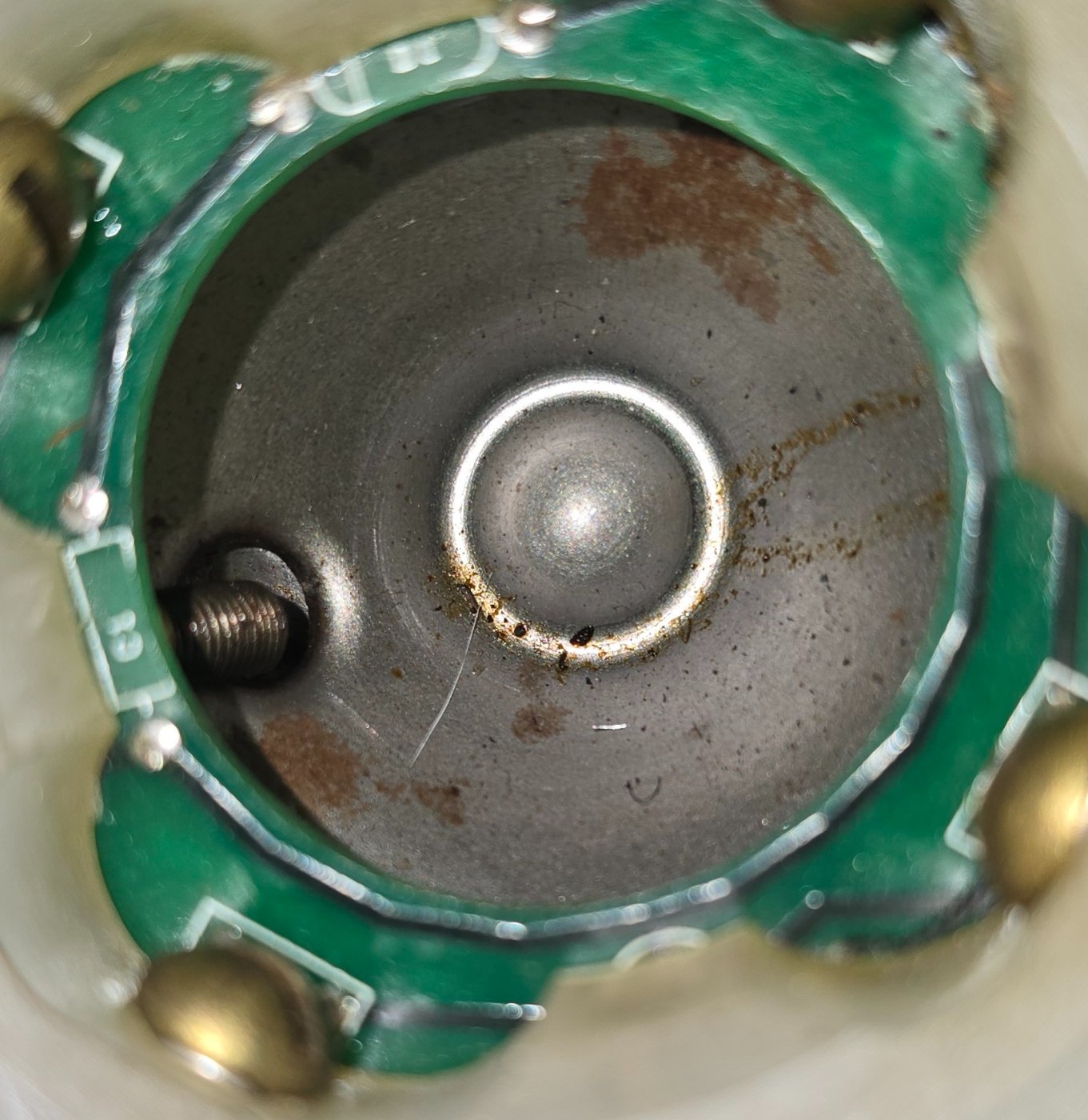

Can anyone identify this electronic model t timer? Any information would be appreciated. What else does it need to make it work? Thank you!

Post by Abakca » Sat Aug 09, 2025 6:00 pm
This is not what I have on my car but something that was included in a lot I bought on ebay. I have a bosch conversion from Snyders on my car with pertronix from Lang's .

Post by Fire_chief » Wed Aug 13, 2025 4:08 am
That looks like the Tru-Fire ignition without the center piece that mounts on the cam shaft.
