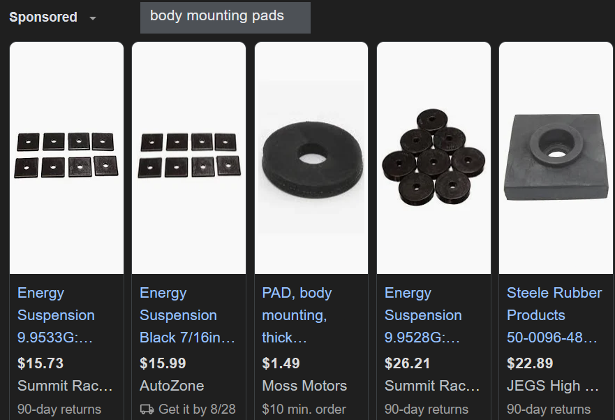

Campbell Tellman
Topic author - Posts: 66
- Joined: Mon Oct 11, 2021 9:28 am
- First Name: Campbell
- Last Name: Tellman
- * REQUIRED* Type and Year of Model Ts owned: 1916 Ford Touring
- Location: Beaufort, NC
Re: Body to Chassis Pads
Thanks to all that responded. I looked at the pads today and they are about 1/2 inch thick rubber. There is a longer pad under the radiator. I have done a lot of work on the body and the doors are perfect. I will check the frame rails to see if I need the pads to keep the body level.
Campbell Tellman II
1916 Ford Touring
Beaufort, NC
Campbell Tellman II
1916 Ford Touring
Beaufort, NC
- Posts: 7272
Introducing a 1/2" pad under the body would necessitate raising the radiator too so the hood would still fit. !/2" is overkill. If the aim was to stop noise/squeaks 1/8" would do. Best to use insertion rubber with the fabric in the rubber That said the only place I have ever used any rubber is under the pan ears on just one of my Ts.
As others indicated, sometimes shims are used on the frame mounts to adjust door gaps. The need to do so indicates the frame is no longer straight.
