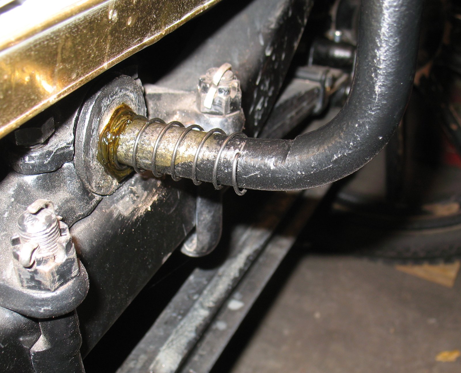

Since the starter does not work, and if I can't get it overhauled soon, I'll use the crank. I know how to hold it properly to avoid injury. There was only a remnant of a spring on the crank - the spring that makes the crank pop out of the engine once it starts. It appeared to me that the way to get the spring on was to take the "ratchet," that engages with engine, off and then I could slide the new spring on. I read a few posts about the pin that holds the ratchet (thank you posters). Mine had the pin with a cotter pin. The cotter pin came out easily but the pin only came out with applications of penetrating oil and a center punch. The posts I read mentioned no problems getting the ratchet off, but mine would not budge no matter what I did. I was able to wind the spring onto the shaft of the crank. However, instead of popping the ratchet out of the engine, the spring just slid down the curve of the crank. Now the last quarter inch or so of the end of the spring farthest from the engine was bent at a right angle. What was that for? Upon close inspection of the shaft near the curve I saw a small ( about 1/32") stub. I tried putting the bent end of the spring against that stub but it wouldn't stay. Then I had an idea. I got a firm grip on that stub with a pair of pliers and pulled and out came the last piece of the former spring. With the same pliers I pushed the the bent end of the spring into the hole, which held the spring, which popped the ratchet out easily. Success! Luckily I had wound the spring onto the handle the right way.

- Posts: 7411
Re: Can I test starter with head off
The crank has a small hole near the first bend. The little bend at the front end of the spring fits into that hole like this.
