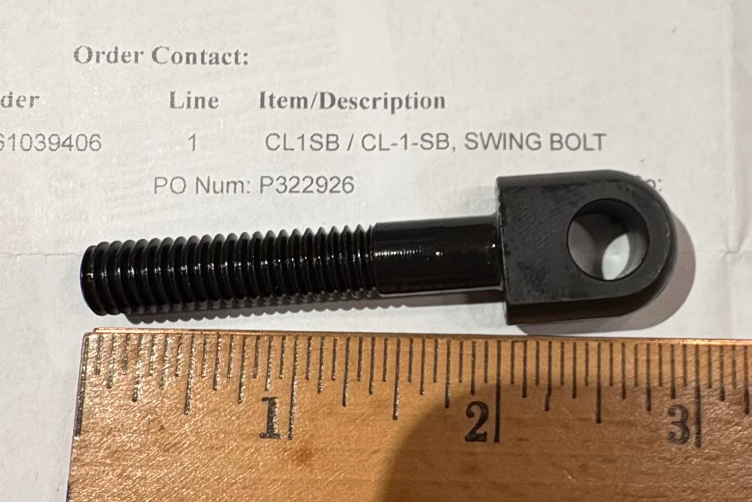

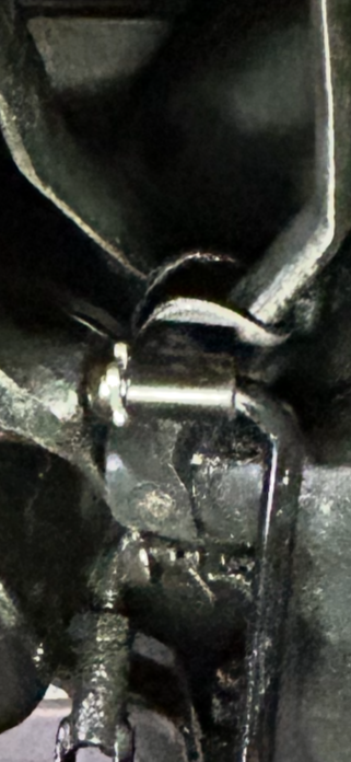

These fixture bolts are an even closer match
https://www.carrlane.com/product/clampi ... ts/cl-1-sb

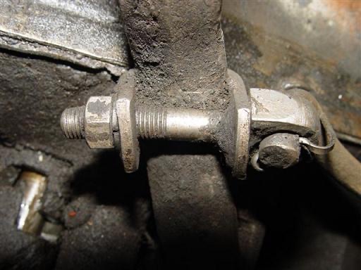

Post by RajoRacer » Mon Aug 18, 2025 7:14 pm

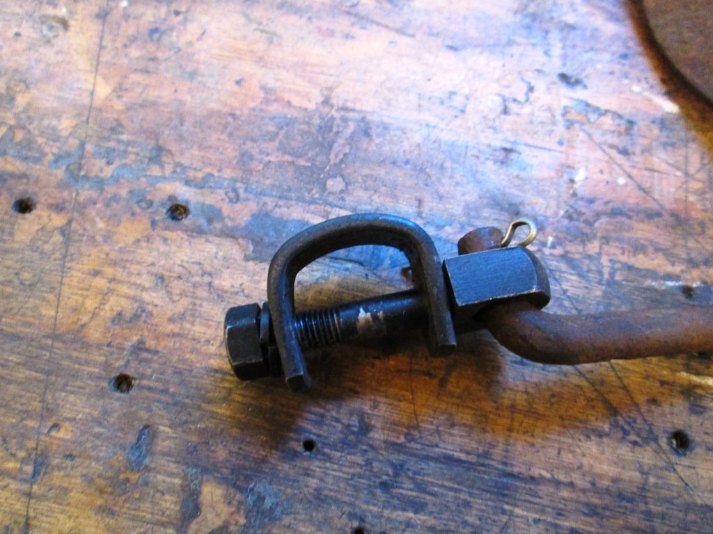

Here's another photo - Ed has a great suggestion !

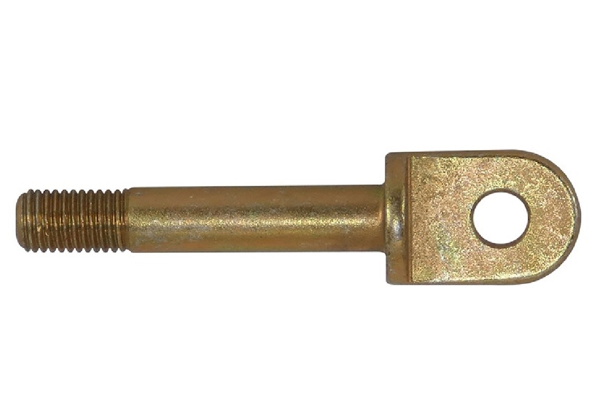

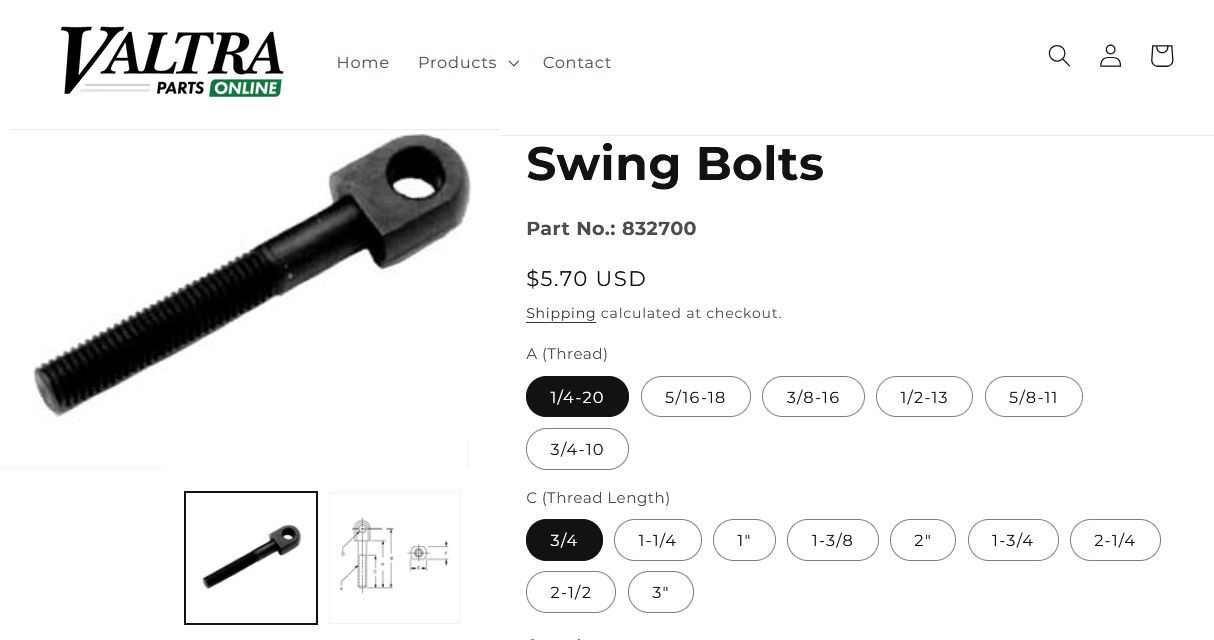

Post by TRDxB2 » Mon Aug 18, 2025 7:24 pm
Swing Bolts

Those hinge pin swing bolts are very close, but need to be modified to be correct.

This isn't a "photograph of an Rock Mountain Brake 'pedal clamp'!
Edit: Thank you Larry for the correction below!

It certainly is!

Post by NorthSouth » Sun Aug 31, 2025 10:17 pm
Found One.
Now I just need the C clamp.

The C clamp looks like it would be easy to fabricate.

C-clamp material - 3/16 x 3/4 flat stock w/rounded edges - Mc Master-Carr.

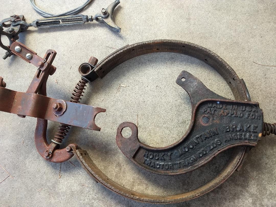

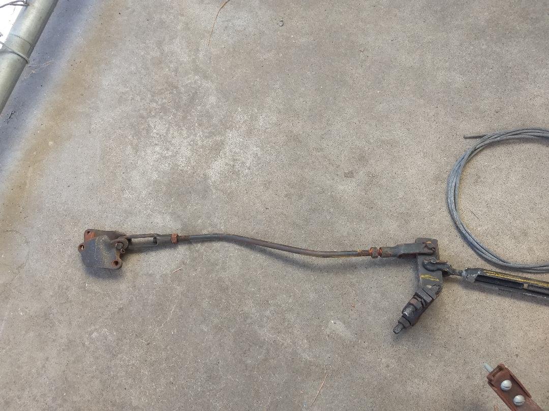

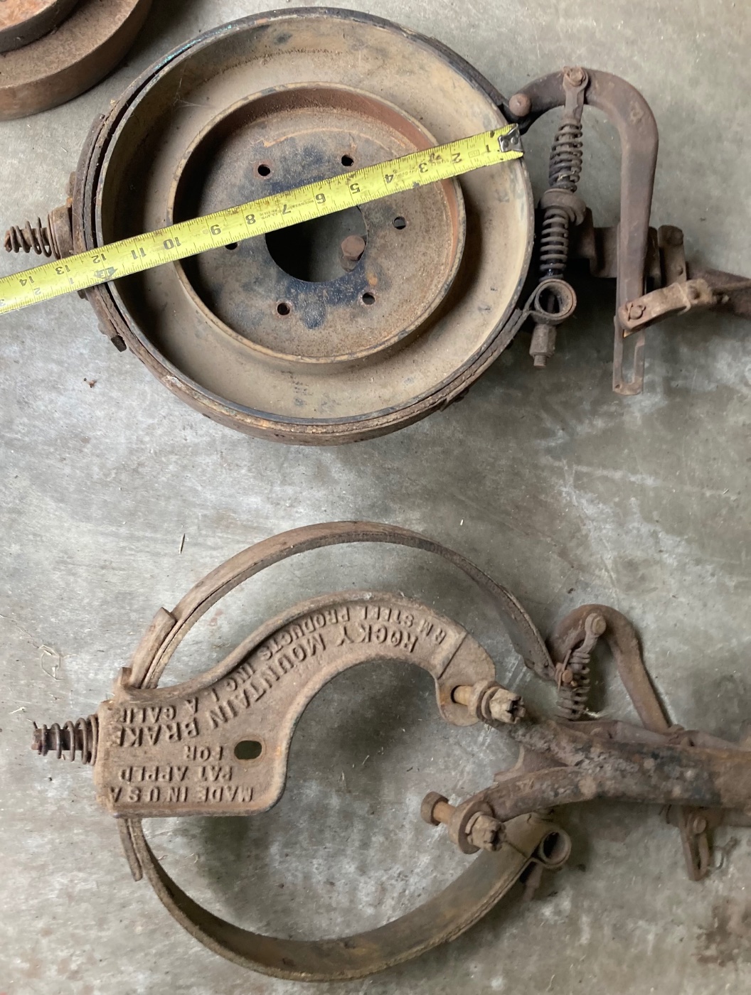

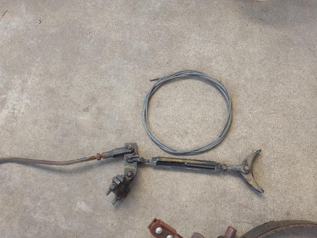

Post by speedytinc » Mon Sep 01, 2025 9:12 pm

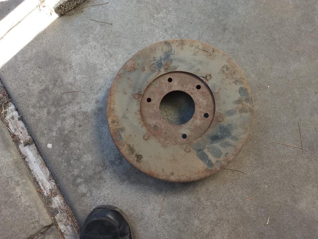

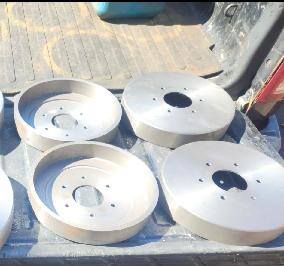

The pedal linkage unit appears to be unused. mounts to pivot from the DS tube.
Pedal clamp is 2 pieces cast to clamp onto pedal with 1/4" bolts.
Drums are riveted together.
Obviously made for a cable that automatically equalizes.
I dont know if this is an original RM brand set or a Sunderland reproduction.

John - I have a set of both - the main bracket you are showing is an original. The Sunderland drums are cast in one piece.

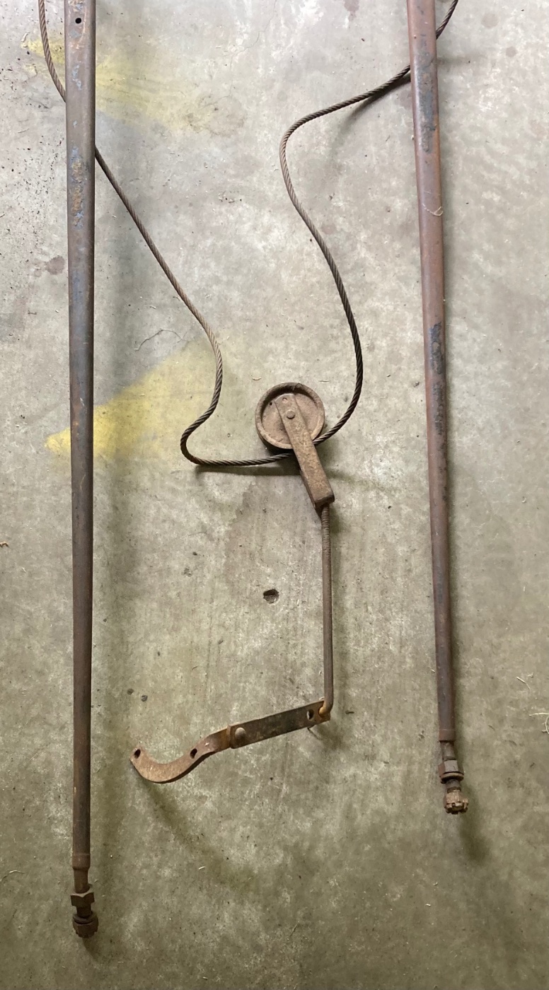

My "modern" Rocky Mountain brakes have rods with the associated equalizer. If I were to convert "back" to cables, two questions:
Did the originals interact with the parking brake, and if so, how? Or since I already have the equalizer installed and linked to the brake pedal and parking brake, should I just replace the bracket that the brake rods attach to with something (see next question) to pull the cables?
I've recently seen pics posted showing a "y-shaped" channel to pull the brake cables, and others show a pulley to do the same. The pulley seems like it would be better for equalization. Which method was used with the original set-up?

Originals are not integrated with the parking brakes.
I have seen the pulley setup before. I believe it was original. The u piece on my setup is new to me, but I believe it will work equally well.
That piece is the same all of the parking brake setups for 60's fords & probably many others used. Both these pieces provide simple & cheap self equalization.

John- your equalizer assembly was made by me for use with my small drum AC brakes that I reproduced for many years. Just don't want folks to get confused with original versus reproduction parts. Dan

Dan McEachern wrote:
Tue Sep 02, 2025 11:13 pm
Thanks Dan. I appreciate the info.
Makes sense being in new condition & came with a set of AC small drum brakes & the RM's I pictured.

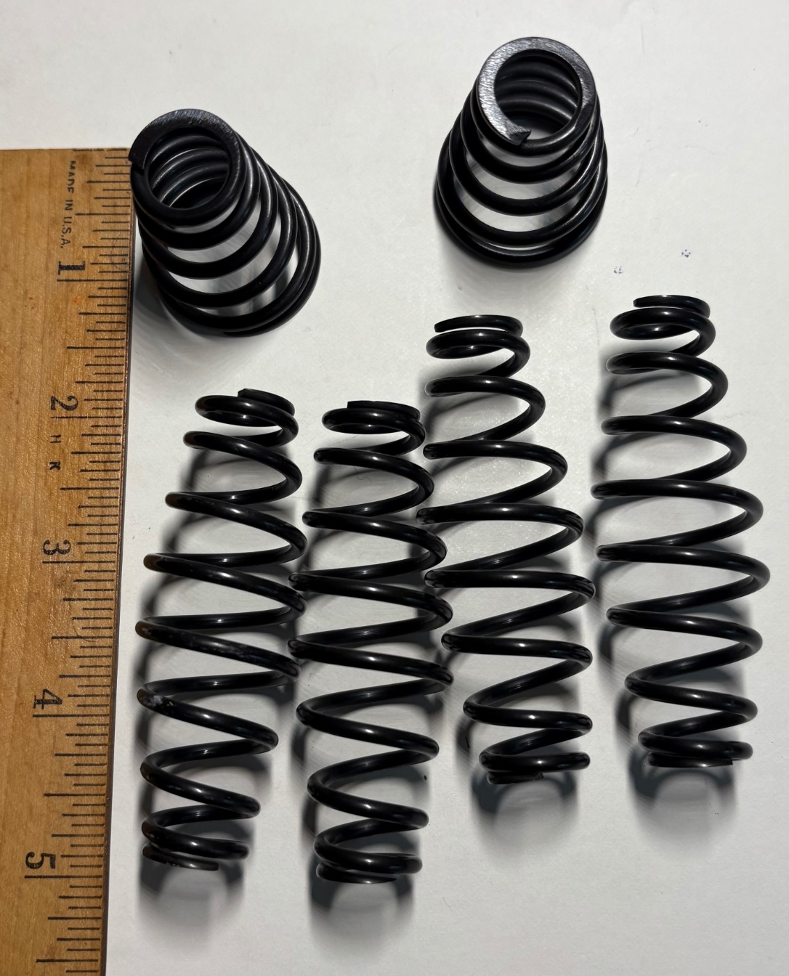

For the benefit of those who have original Rocky Mountain brakes, I had all the springs reproduced, and are for sale @ $5.00 each.

Great news Larry,
I would like a full complete set and agree to the increase ($10 each) for the “rear conical springs”. I will send you a check. What is the total cost including local shipping?

I made a mistake on the brake springs. The barrel springs are $10 each, and the conical springs are $15. You don't even want to know how much it cost me to have these made!

Larry “Original” Smith just sold me this brand new, period correct, spring kit for my now complete set of original Rocky Mountain Brakes.
“$37.99”
Doing things correctly can be expensive.

Steve - if the R.M. brakes you posted the photo of above are what you have - those are Sunderlin repros - I currently have a set of both. John K. posted a photo of an original just above yours - note the "oversize" hole and the smaller hole above it which you apparently drilled a hole in the original small drum backing plate

I just had an informative visit with Mr Ed in Hayward and he assured me that my “Sunderlin” Brakes are are a correct copy of the original Rocky Mountain Brake design and will operate in both forward *and in reverse*.
So, I will keep this now complete setup and put them, and the new cast iron brake drums, on the 1924 Paco bodied speedster.

Yes, they are somewhat correct BUT they are not exactly as the originals ! Tell Ed "Hi" from Tomaso !

Some people only know half the story! Sunderlins first attempt at making R.M. brakes was pretty good. Where he messed up was he didn't know what the rest of the setup looked like, and unfortunately chose a Bennett equalizer! That was a huge mistake, and to this day Buds Rocky Mountain brakes are 100% incorrect!
When Tractor Train took over making the brakes, they made some improvements. Why they added to the bracket mentioned above is not known.
I have been around since the start of this venture, and what I say is true. The first series cast drums are very nice. I have a set of these on one of my cars. All I had to do was machine the casting marks off the inside of the drums, and put a radius on the upper corner.
