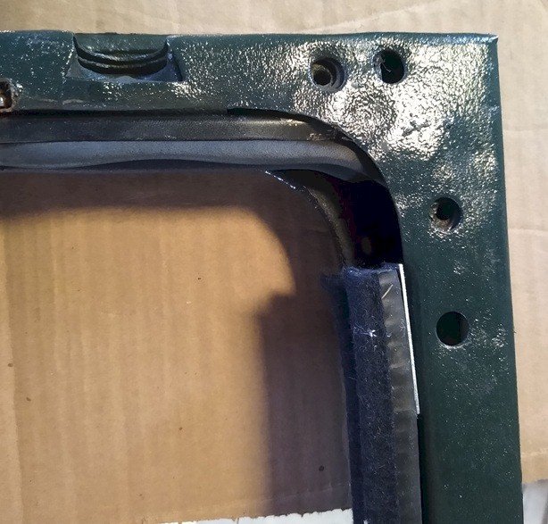

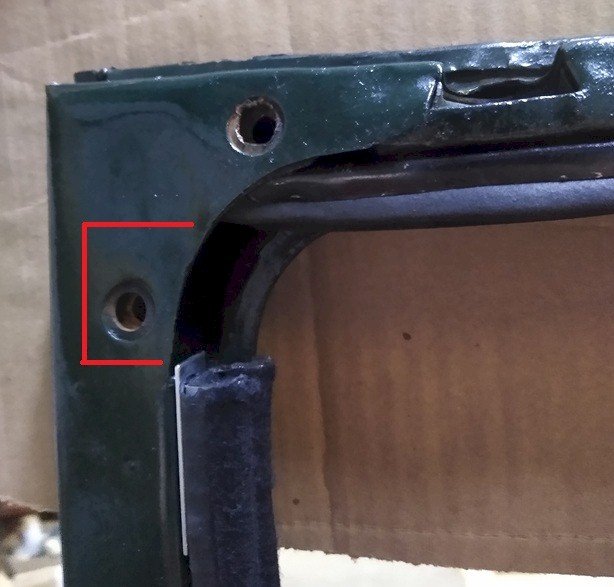

Post by varmint » Mon Aug 18, 2025 7:10 pm
The fuzzy guide for the door window glass (26-7 Coupe) is clipped into position but it does not reach the top.
Do I need to drill out the rivets and start over?

Re: Fuzzy gap OK?
Post by Humblej » Mon Aug 18, 2025 7:40 pm
You need to do it all the way to the top.
The glass channel is held in place by clips that hook into slots in the door at the top, bottom, and somewhere in the middle. Hooks are riveted to the channel.

Re: Fuzzy gap OK?
Post by TXGOAT2 » Mon Aug 18, 2025 7:41 pm
The gap may allow annoying wind noise when on the road with windows up. It could also admit dust, rain, cold air, and even dirt daubers. I'd want to figure out why the gap is there and correct it.

Re: Fuzzy gap OK?
Post by varmint » Mon Aug 18, 2025 8:32 pm
There are no middle or lower clips with these fuzzies, only at the top. So, looks like I need to remake these.

Re: Fuzzy gap OK?
Post by Humblej » Mon Aug 18, 2025 8:37 pm
You need to buy the clips seperatly and rivet them on.

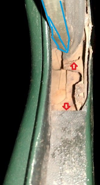

Re: Fuzzy gap OK?
Post by varmint » Mon Aug 18, 2025 10:13 pm
So, I went back to the garage to deliver new door window glass and while there, took my screwdriver (outlined in blue for clarity) to push back the rubber top and revealed another clip up higher than the ridge. I have never seen a photo of this online. Moving the fuzzies to this new location, the problem is resolved at the top. Glad I did not cut the fuzzy for length yet.
