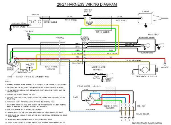

This shows the correct wiring for your car. Follow it.

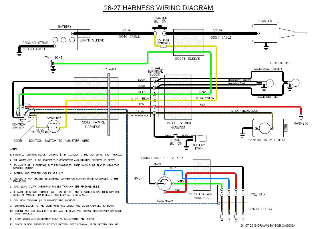

- Posts: 6581
Re: Your persistent pest here! Votage and battery question
Basically same Diagram as above (Steve Jelf's) but with color of wires

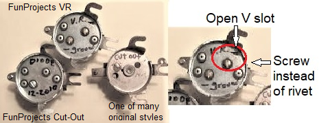

The Forum's Administrator, AdminJeff, is making Voltage Regulators that work like the Fun Projects did.
https://modeltstarters.com/voltage-regulators-cutouts/

Frank, thanks for posting the info about Jeff’s voltage regulators. Just for clarity the OP has recently acquired this T that had been unused for a while. I was merely suggesting that it was possible that a FP voltage regulator could be on the generator & precaution was needed so he wouldn’t ruin a good part that would have to be replace or repaired. Jeff has a great product that more recently became available & based on the length of time the T was unused probably didn’t have one of Jeff’s fine products. No slight to Jeff intended. Best John
- Posts: 6581
Here's how to ID a FunProjects Regulator if there is no label on itJTT3 wrote: ↑Thu Aug 28, 2025 12:56 pmFrank, thanks for posting the info about Jeff’s voltage regulators. Just for clarity the OP has recently acquired this T that had been unused for a while. I was merely suggesting that it was possible that a FP voltage regulator could be on the generator & precaution was needed so he wouldn’t ruin a good part that would have to be replace or repaired. Jeff has a great product that more recently became available & based on the length of time the T was unused probably didn’t have one of Jeff’s fine products. No slight to Jeff intended. Best John
- Attachments
- fp vr compare.png (131.77 KiB) Viewed 4379 times
