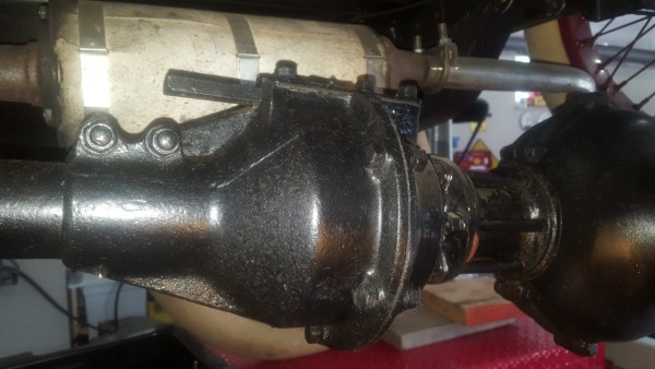

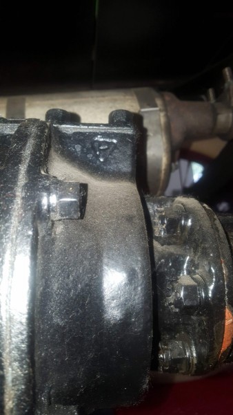

Post by ChrisB » Tue Jul 02, 2019 7:58 pm
Mounted in front of rear axle spool.
Side view. Piece outlined against muffler is how unit is shifted, not sure which way is which.
Close up of P in a triangle
Top view

Post by Dropacent » Tue Jul 02, 2019 8:03 pm
Pretty sure it’s a jumbo planatar. It appears that it may have been locked into one position.

Post by Dropacent » Tue Jul 02, 2019 8:18 pm
I don’t see the shifter mechanism on it. If it’s a jumbo, I don’t think that flat plate should be there. I have a complete one here. If you need better views to decide what you have there, just ask.

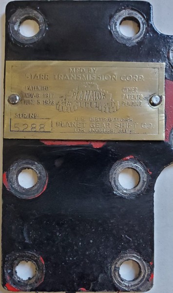

It looks to my like a Starr Planator. They later sold out to Jumbo. I have three of them here. They are all slightly different. Two are for Jim Burns in Texas, the third is a parts one for those. The shifter was a problem in the Starr. Jumbo made at least two different designs.
Without looking up some notes and doing some searching, here is how I remember the story behind these.
Starr also invented the basic Ruckstell. He had it at a trade show and Glover Ruckstell saw it. He bought the rights to it, redesigned it and made it into the Ruckstell. A couple years later, Starr came up with this design using mostly Ford gears and a very simple shift mechanism. Ruckstell sued him, dragged it out in court and eventually the court sided with Starr. But Ruckstell had stalled him and kept him out of the business to some extent, the other side of it was Starr got free publicity he could not have bought and made hay with some magazines that did stories on him and his sued with Ruckstell. The Starr was also quite a bit cheaper than the Ruckstell. He sold quite a few but not a lot. He did, I think, get some money from the lawsuit but not much. So he sold his design to Jumbo who fixed the problems with the shifter and put it on the market about the time the Model T was on the way out, roads were getting better and the competition for accessory transmissions was brutal.

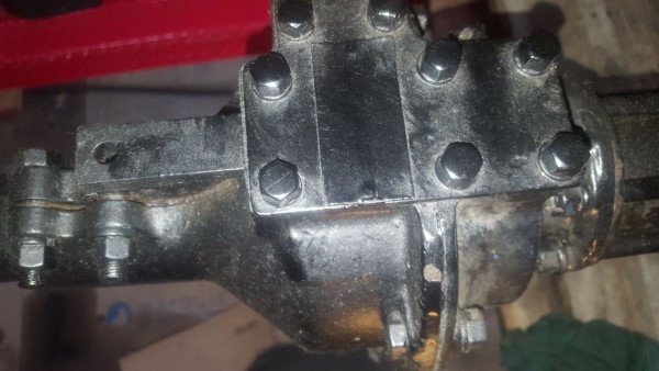

pictures of innards

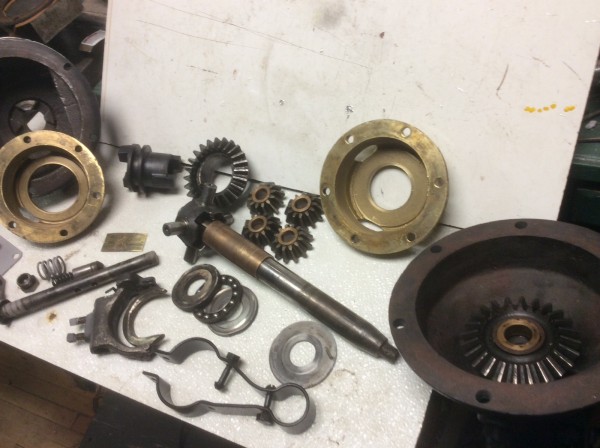

Post by Dropacent » Mon Jul 08, 2019 9:06 pm
Chris, these are the requested pics of the insides. Keep in mind, these are from a jumbo planatar , and as I’ve never seen inside the version you have, I have no idea if they will be any help. Mine has a heavy spring loaded ball detent that should keep it in one gear or another. I have searched for awhile with no success for what the actual shifter looked like. The early ad copy is sometimes notoriously inaccurate. This unit is either in one gear ratio or another, there is no neutral, unless something is seriously damaged . I was able to find a great early shifter that has a very positive lock in one direction or another. I feel this will be a good insurance instead of just relying on the heavy ball detent. In one picture , I’m pointing to the part that was damaged in mine. The throw is somewhere around 3/4” , from one ratio to the other. Just a guess but likely if the rest of yours is the same, the throw should be about the same. My opinion Is that the planatar was a well built unit, and the big selling point is that it used primarily ford gears, which are easy to find. Also, much less work to install than a Ruckstell is. I’m surprised there are not more around.

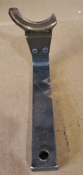

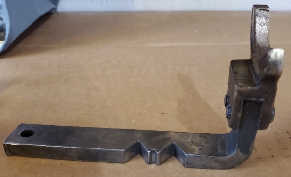

The Starr Plantor shifter is different. It is a flat piece of steel with two notches in it that moves a shift fork to engage one or the other of the gears. There are at least two and I think three different versions of that shifter, which must have been a weak spot in the design. The ones I have seen have all been brazed at least once to build them up.
Chris, if you are ever coming through Helena, you are welcome to stop and go through all the stuff I have. I have two that I have been going to rebuild for years, one for parts and not much else.
I have never seen the original shift lever and rod setup. As Dan said, the drawings are notoriously unreliable.

shifter mech
Post by Dropacent » Tue Jul 09, 2019 10:17 am
Chris, if you look closely, this is what your unit shifter mech looks like . If you can believe the advert, It was still being offered by jumbo in this earlier shifter version.

Tim, yes the picture above looks like the top of my unit, 8 bolts on mine, only seven show on the picture but I think they just missed one.
I got mine stuck in both gears somehow and it would not move off the hoist. Pulled the shift bar out and got it so it would move.

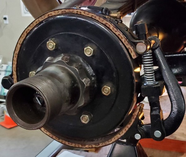

Post by ChrisB » Sun Dec 29, 2019 12:26 pm

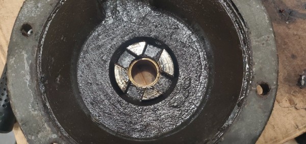

Have come back to this and have removed the rear axle from the car.
It is a Planator mfd by Starr Transmission Co. There was a piece of tape that was painted over covering the data plate!

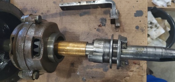

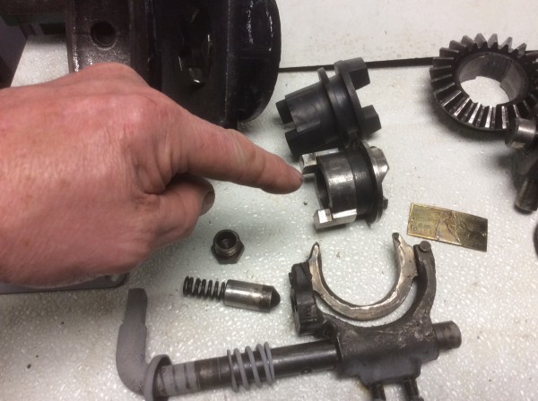

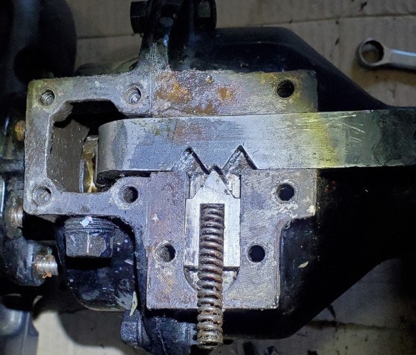

Post by ChrisB » Thu Jan 09, 2020 3:09 pm

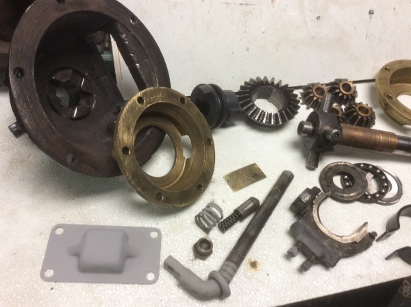

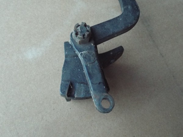

A little more progress, pictures of the shifter. It was pretty gummed up needs a good greasing, think that was part of the problem with it not shifting.
Does anyone have a picture of the same shifter? Not sure that the brass part should be a half circle?

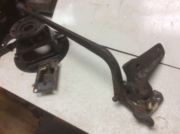

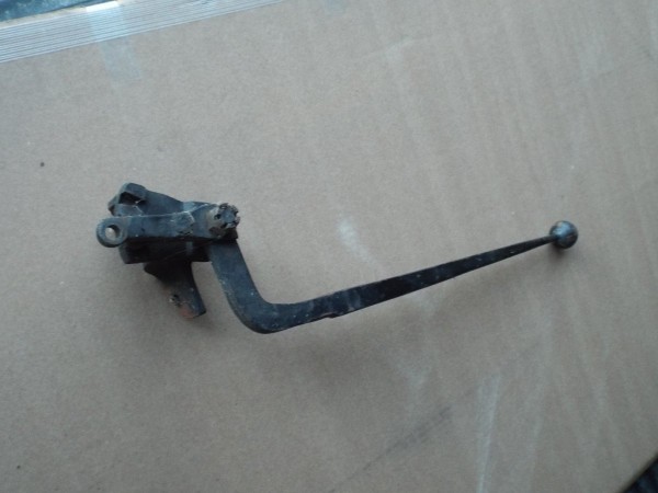

Post by Liberty Garage » Thu Jan 09, 2020 8:06 pm
Chris: Attached are pictures of the Jumbo shift lever at the hogshead. As you can see it has 2 definite notches to keep the transmission in gear. I don't know for sure if the Planator used the same shifter .

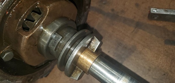

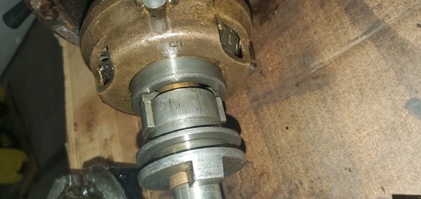

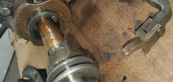

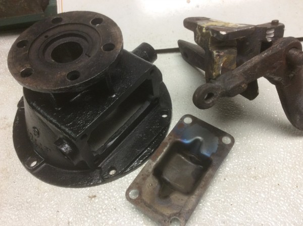

Post by ChrisB » Tue Jan 21, 2020 4:13 pm

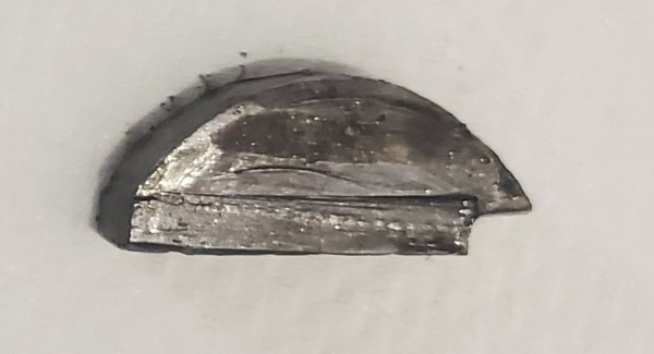

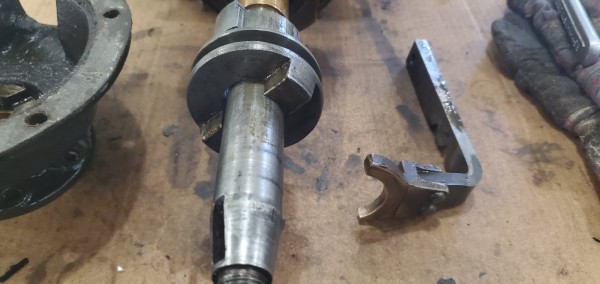

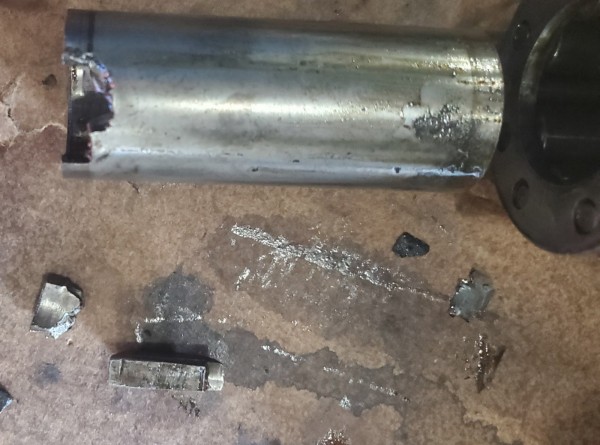

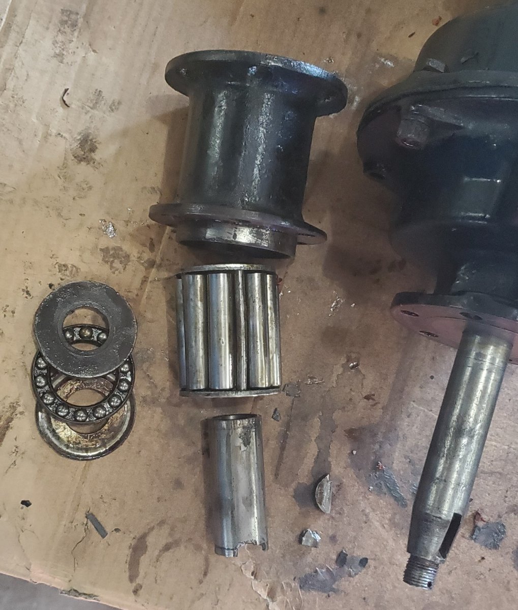

More progress on the disassembly, but problems found (as usual).
The pinion bearing sleeve is a slip fit on the end of the driveshaft and a little piece fell out when I removed the pinion gear.
You can see the damage on the end of the sleeve.
Also I believe someone notched the woodruff key which I believe is incorrect.
... and solid roller bearing.

Post by RajoRacer » Tue Jan 21, 2020 4:38 pm
I believe that "notch" is from movement, Chris.

Posts: 6558
Re: Help ID this auxillary transmission - Planator
Post by Scott_Conger » Tue Jan 21, 2020 5:46 pm
Steve
this is well beyond my knowledge/expertise, but long study of that picture leads me to believe you are correct in thinking it does not belong there. I would bet there should be a "pause" there...a flat spot on the shifter for that period of movement. It just doesn't look right...from lack of symetry or anything else.
Russ T Fender
Posts: 466
First Name: Val
Last Name: Soupios
Location: Jupiter Florida
Post by Russ T Fender » Tue Jan 21, 2020 7:06 pm
It has been a while since I had mine apart but it also has the detent in the middle. I can easily shift mine with the car standing still. In fact that is usually what I do when pulling into the garage or the trailer.
ChrisB
Posts: 403
First Name: Chris
Last Name: Brancaccio
Location: Calgary AB
Post by ChrisB » Tue Jan 21, 2020 7:23 pm
I can't see how mine would shift standing still, the 2 dogs in the sliding collar have to fit into the notches in the case.

Post by ChrisB » Tue Jan 21, 2020 7:29 pm
A few more pics of the guts.
