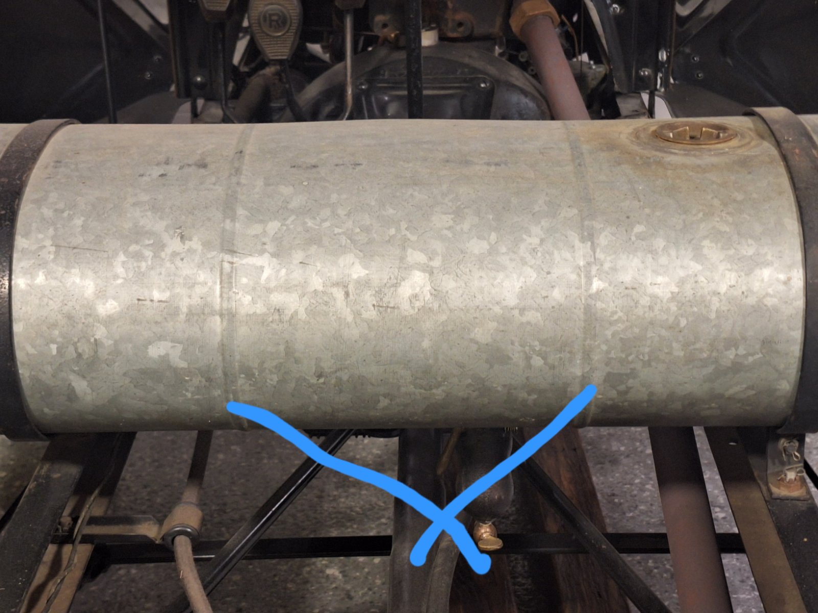

My gas tank I believe is original to my 1913 Runabout. The plating is original, and the inside is as clean as the day it mas made. What I noticed yesterday, is there is a nub on the bottom I haven't noticed before. It appears to look like the head on a 6# nail, and only sticks down about 1/32". It is obviously original to the tank, but why is it there? It is almost centered on the bottom.

Maybe the splash plates have rivets through the shell to secure them, or maybe a dimple in the shell for the same purpose.

Re: Round Gas Tank
Soldered in these two beads.
