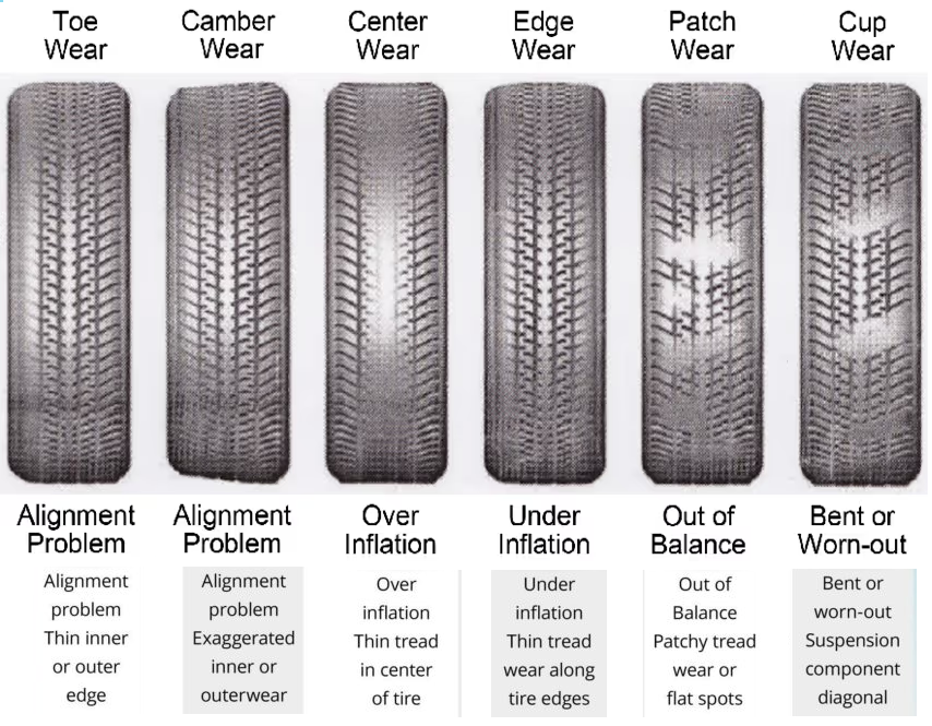

Overinflated tires will show more rapid wear in the center of the tread on all 4 wheels, assuming the car is in good condition. Be sure your rims are in good condition. Many are not.

Common misunderstanding is that the pressure on the tire's sidewall is the recommended pressure for one's car. What it is It is is the maximum pressure the tire can hold. Ambient temperature as well as tire temperature will affect tire pressure readings (10°F difference can change pressure by 1 PSI). Vehicle weight on the specific tires, more weight and the tire will spread out, less and it will narrow (could result in to high pressure). So front tire pressure and rear tire pressure can be the same or different, with the correct PSI depending on the vehicle's weight distribution and the specific tire size. Need to adjust between 55-65 PSI

If you have significantly irregular tire wear, you have a tire problem.
