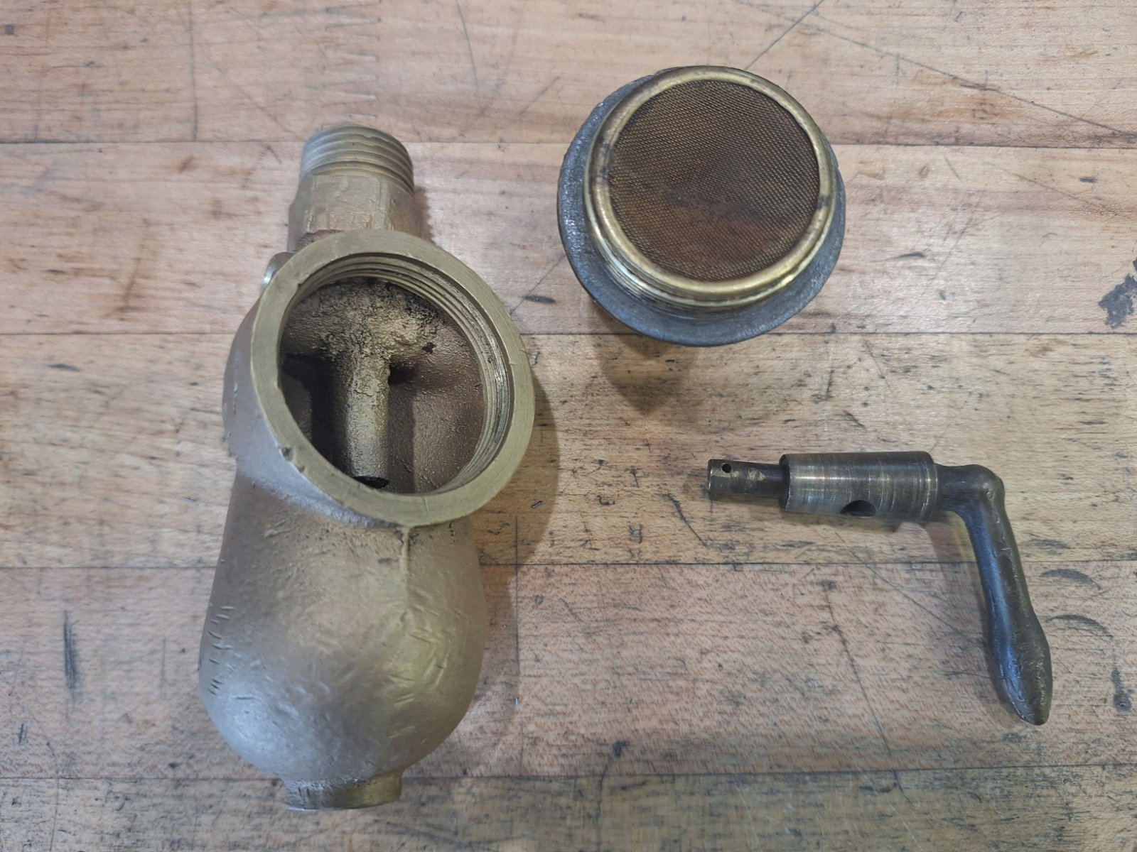

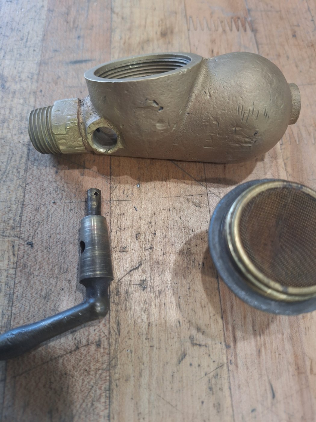

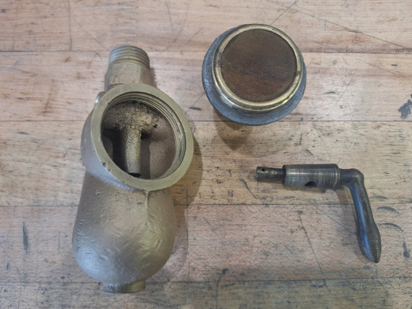

I have a brass one here. When the shut off lever is open, it only exposes half the port. Are the tapered arms on the brass units different than the iron units?
Also, does anyone know if the taper is 6* or 7*?

I'd guess the handle is bent or twisted.
- Posts: 5504
Re: Brass sediment bowl
I've found that the handles are not interchangeable.

The brass units appear to have a stronger angle.
- Posts: 7167
The earlier brass units with out the hex at the top to wrench them tight certainly have a different taper to the later brass ones.

Allow me to clarify. The taper of the shut off from an iron unit is about 6-7*, using trig since we don't have an optical comparator.
The brass unit pictured has a stronger angle, more like 10*.
I was going to rebuild it, paint it black, but I have the incorrect arm.
If someone wants the body, and has the correct arm, email me.
