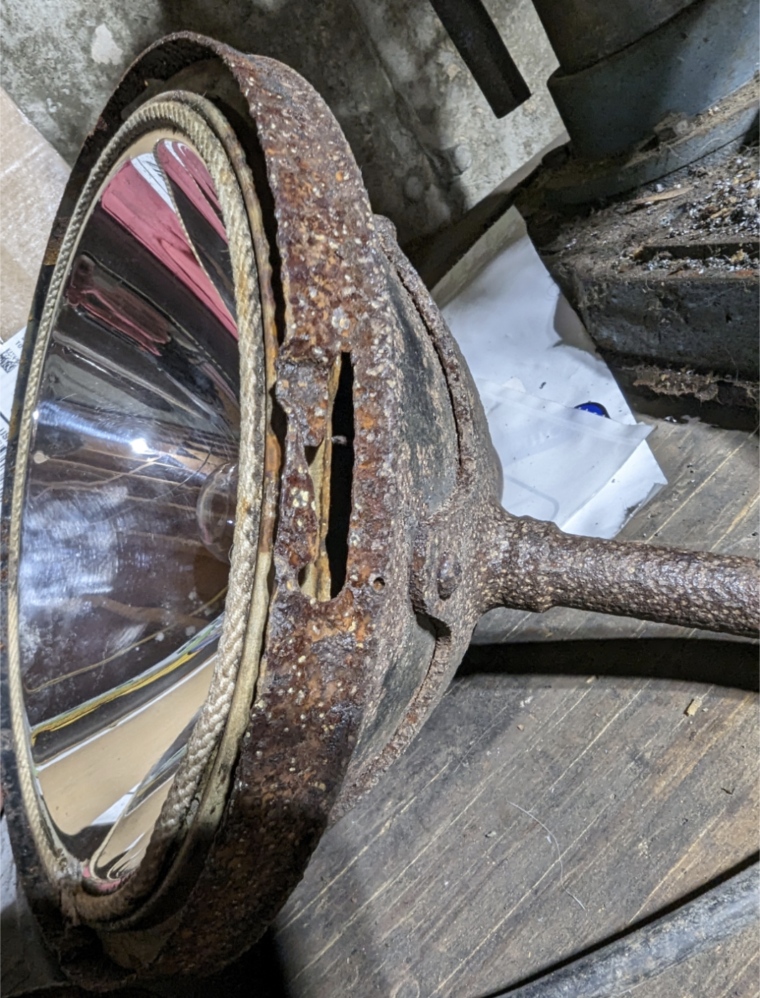

OK. I have a silly question.
I have a '27 touring that I am putting new glass and rims on.
They also need the rope seal replaced. One side was missing the other side just peeled off.
What was used to keep the seal in place? Where they built facing up so they really didn't need any stick'em?
Any ideas would be great.
Thank you
Steve B.
Thank you
Steve B.

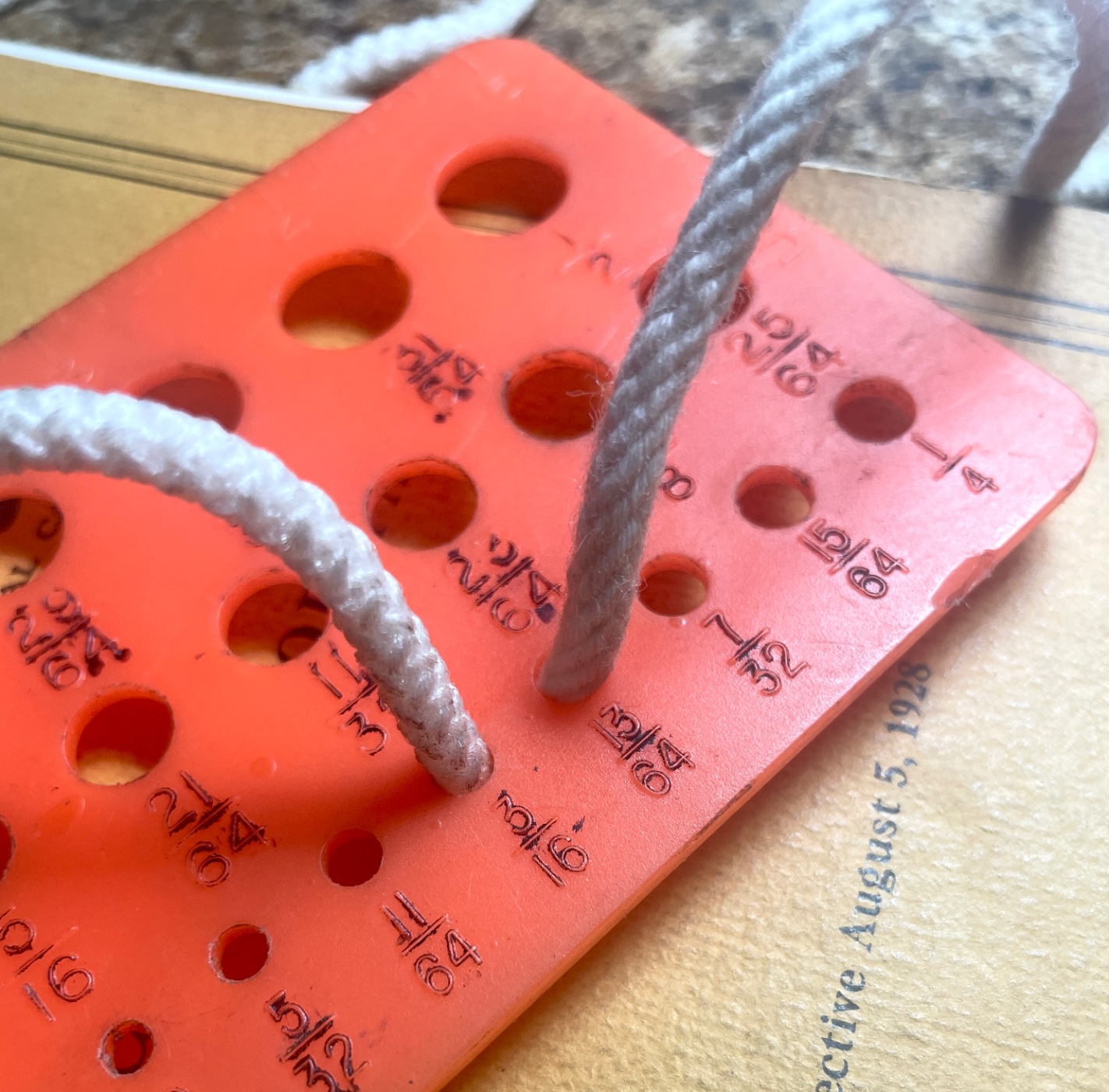

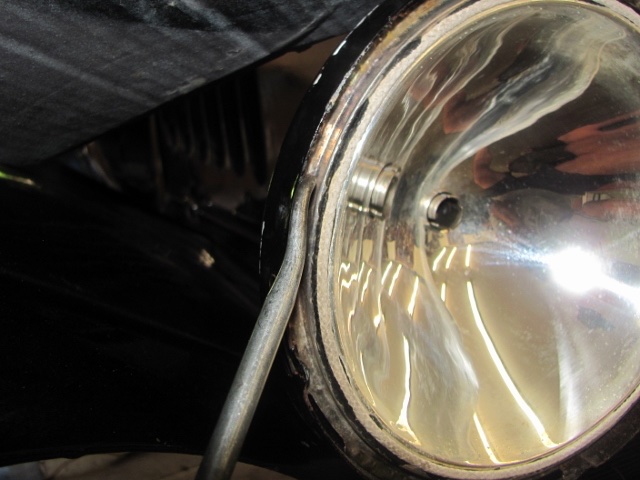

Thickness is important too, to prevent lens rattle, the modern nylon cord on left is smaller, the larger cotton cord (like clothes line) with more twists is better.
Originals used a type of black tar like adhesive on the cord seal......

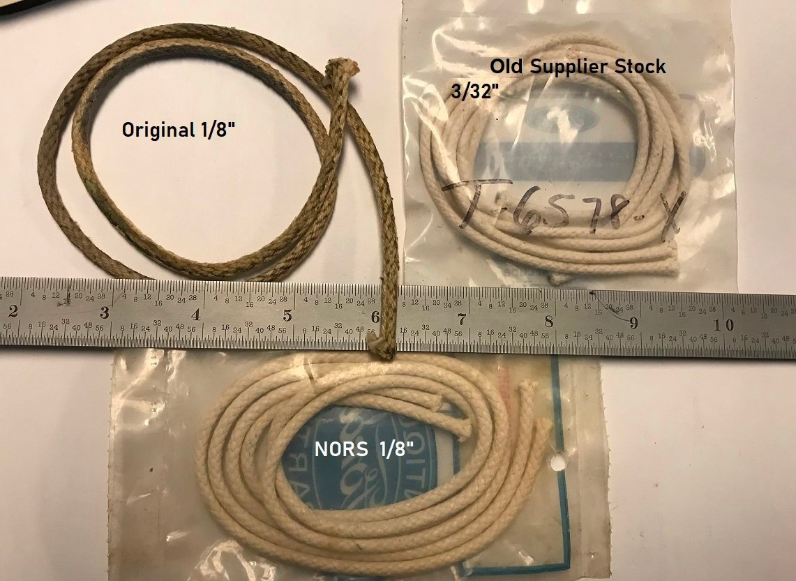

As its been said thickness is important. This is what I got. Also non-cotton, something that doesn't absorb water is better
Need to remeasure Old supplier Stock but as I recall it was very thin

It's 1/8" cotton sash cord. It's not hard to find.
Don't know if it is a still a common item at hardware stores but it's readily available online and most likely at your local window blind/drapery/curtain supply.

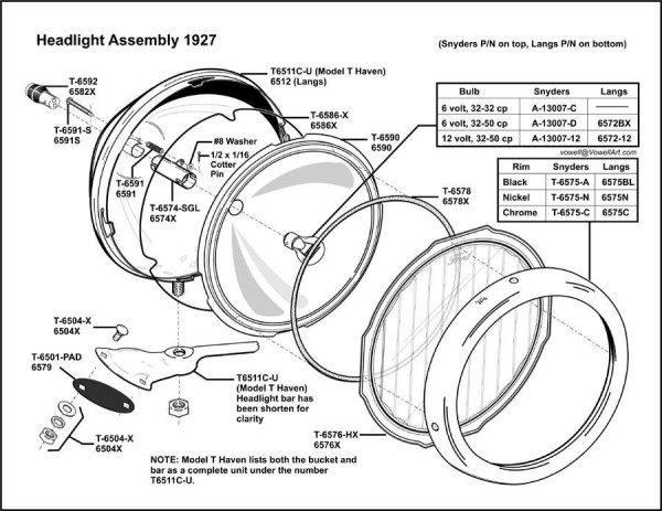

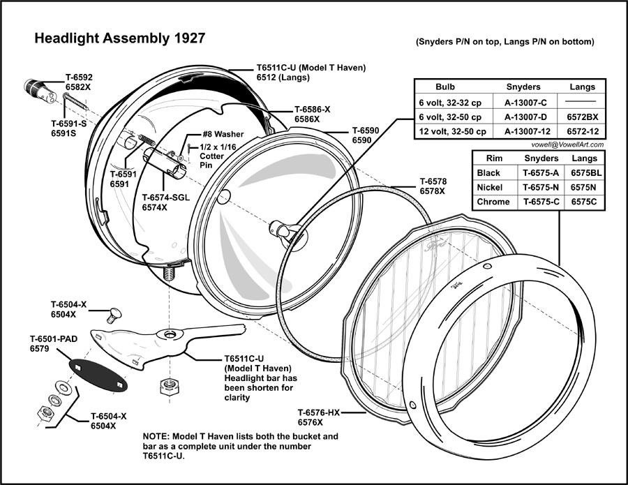

From Vowellart in the MTFCA gallery:

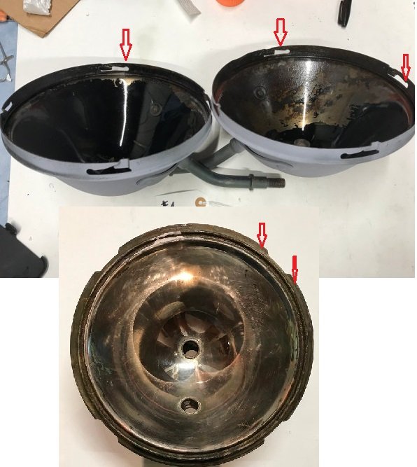

Ant thoughts about a bit of anti-size on the retainer positions headlight and/or reflector
Maineiac
- Posts: 17
- Joined: Sat Nov 08, 2025 12:29 am
- First Name: Michael
- Last Name: Whalley
- * REQUIRED* Type and Year of Model Ts owned: A 1924 TT project, that started as a stripped chassis.
- Location: Bangor, ME
Re: '27 headlight rope seal
I would think it unnecessary. Those locking points aren't under serious compression, like the threads of a nut and bolt. Now, a thin bit of grease around the outside of that area might help mitigate any sticking. But with parts in good repair, even that would be unnecessary imo.
My parts, however, are not in good condition. Lol
While you are up there working, verify the retainers and the pins on the rim are in good shape.
If these fail, the lens does not bounce well off the pavement, I have had it happen.
The brass ones (and nickel plated brass) ones are particularly suspectable to this.
After it is assembled make sure it is properly locked on and then tap on the glass.
If the glass rattles, it is not correct and will fail, the lens must be secure.
