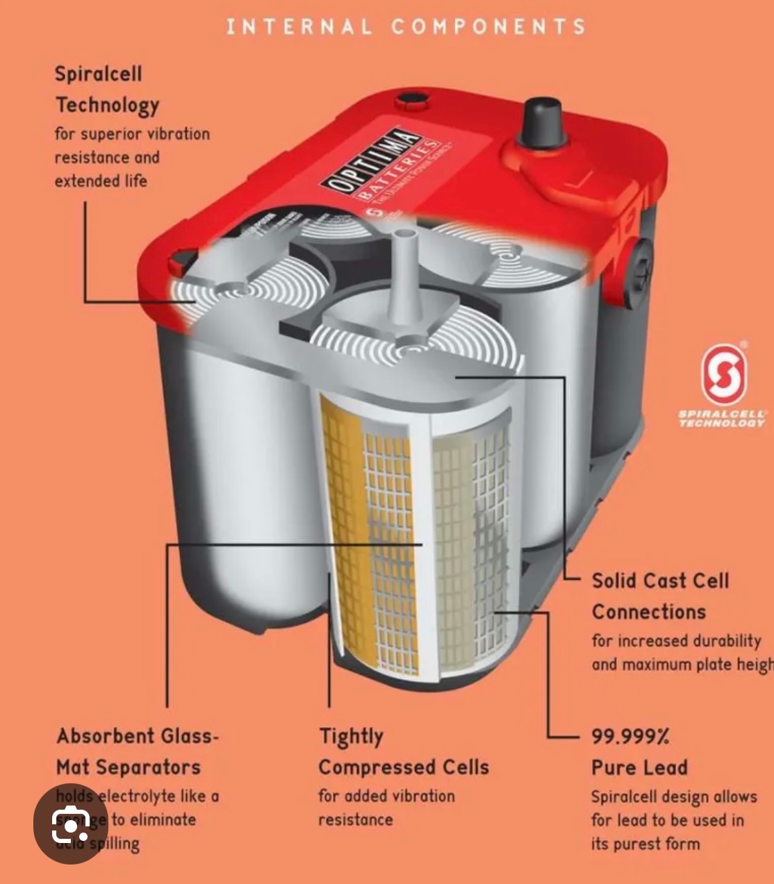

Re: Batteries
The Optima red top, 6v or 12v pictured is absorbent glass mat battery, or AGM. The lead plates sandwiched in the glass mat, and sealed in cylinders to contain the electrolyte. Mount in any position, and no evaporation or adding of water as with a std. lead acid car battery.
Gel cells differ as the electrolyte is mixed in a silica slurry.

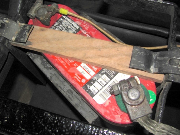

Great battery for the starter equipped T. 800 Cold Cranking Amps!
