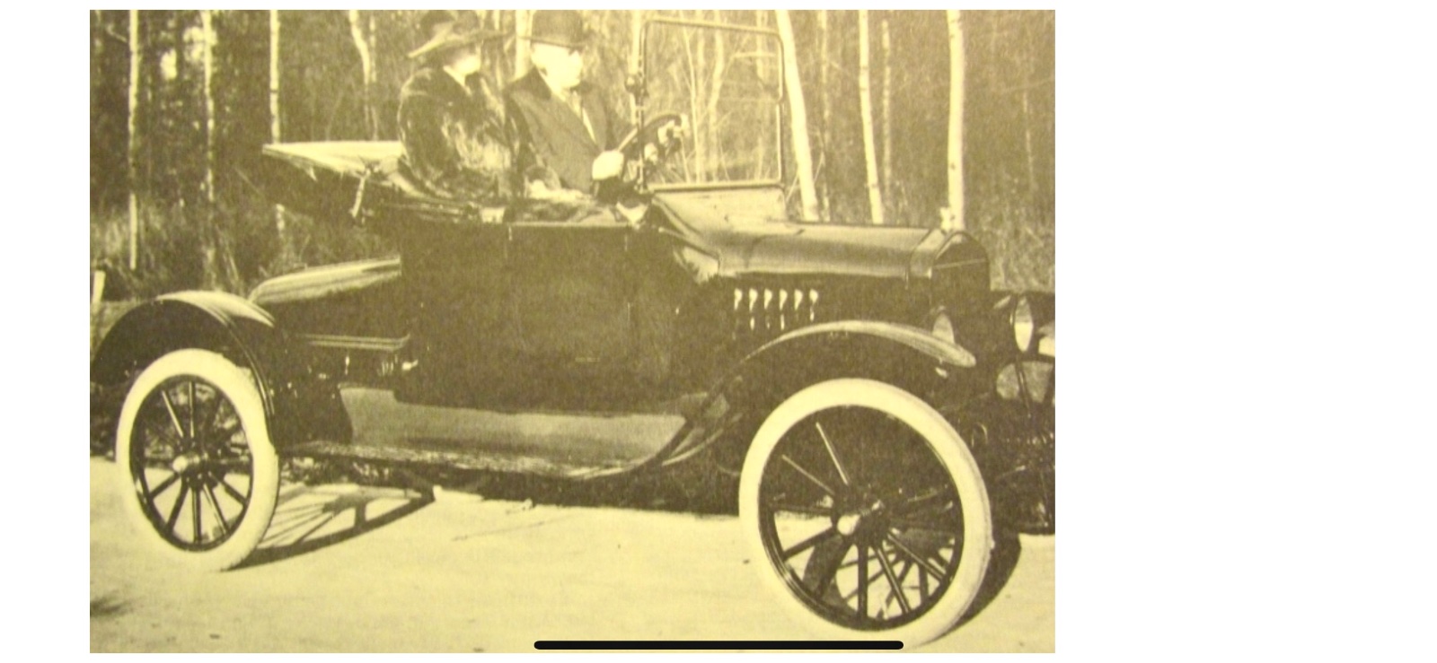

The inexpensive Ford models in the 1920's were sold without demountable wheels and starter and generators. How many of these exist today? An example is on the back cover of the current Model T Times. It has 30X3 non demountable wheels in front, and 30X3 1/2 non demountable wheels in the back. If you look closely through the rear spokes, I think I see a battery. So, it's possible a starter has been added. I saw a late T touring about 30 years ago like this. It would be nice if the owner can give us some information on this vehicle.

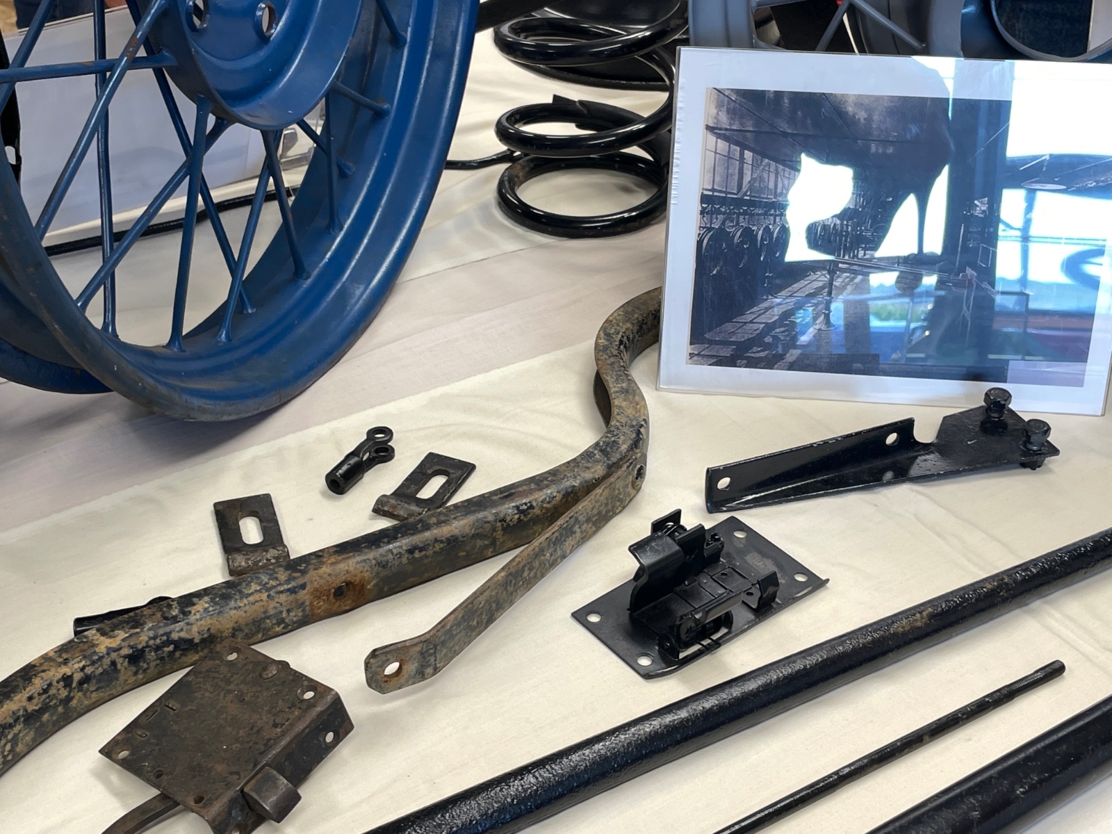

I assume the 1925 frames had the holes drilled for the battery carrier, so it would be easy to install one. However, two of the holes had the carrier riveted in, and the remaining hole was for the ground strap. from the factory.

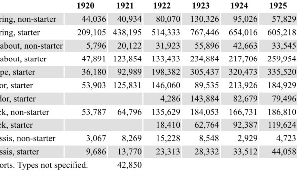

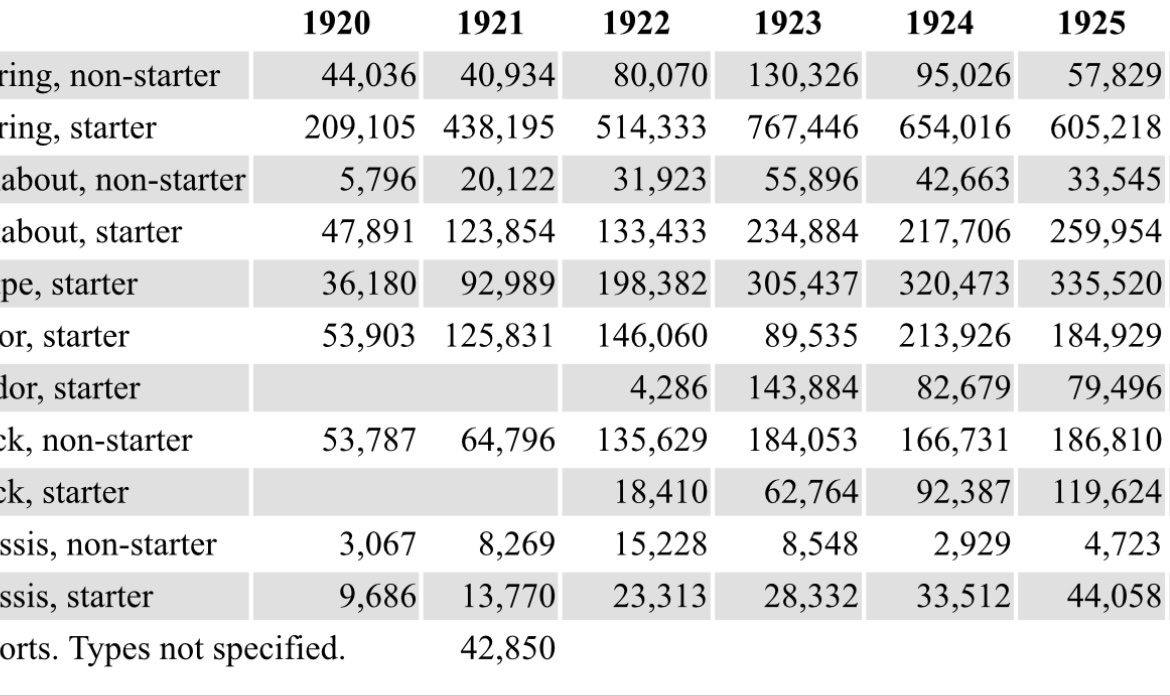

33,000+. Non-Starter Runabouts sold in 1925. Likely some sold as pickups or converted by dealers on owners request for the bed instead of deck.

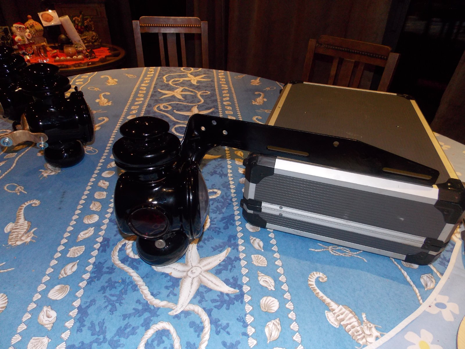

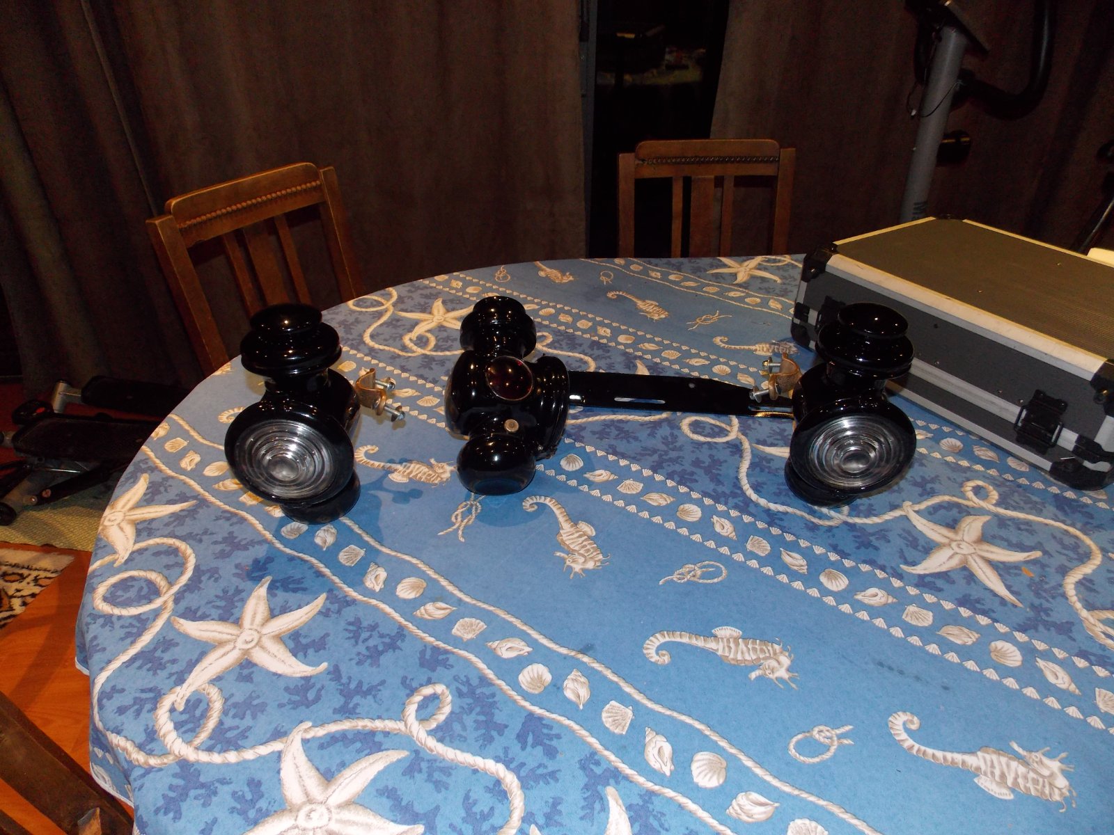

AndreFordT
- Posts: 566
- First Name: Andre
- Last Name: Valkenaers
- Location: Scherpenheuvel
Re: Non Demountable Wheels on Late T's

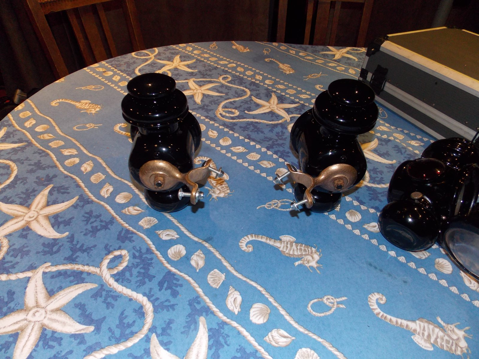

Not only the wheels were different.
Those cars had also two petrol side and a rear lights.
The brackets of the front lights are fixed with the two upper bolts of the windsheeld support.
The rear light had the small lens (red) pointed to the rear and the big lens (door) pointed to the licence plate.
(See photo's)
(They came with my 1926 runabout)
The contact switch plate had no amp meter (must have some photos of this somewhere)
The place for the amp meter was flat. On the back there was a resistance for the front lights working with the marneto.
Just what I know about.
Andre

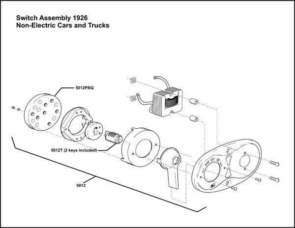

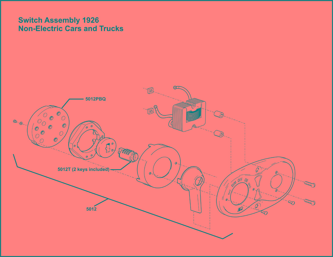

AndreFordT
- Posts: 566
- First Name: Andre
here by the drawing of the 1926 non electric switch.
dykker5502
- Posts: 504
- First Name: Michael
- Last Name: Deichmann
- Location: Rågeleje, Denmark
Thats interesting, because that's not a resiator sitting there, but an inductor - a coil with variable resistance depending on frequency. The voltage from the magneto raise with the revs, but it is AC, so using a coil for resistance it will be higher at the higer revs and voltage ensuring almost same current through the headlamps. It is most likely the same inductor that sits in meny HCCTs that can meassure the performance of the magneto.
They knew what they did back then.
Ford Model T 1914 Touring
- Posts: 8705
The inductor, a coil on a laminated iron core in series with the lighting circuit, acted to regulate AC current flow to the headlights on the magneto only cars. The inductive effect tended to support current flow at lower engine RPM and limit (choke) it at higher RPM / frequency. They were sold as aftermarket accessories for earlier cars under various trade names. I don't think you'd want one in the ignition circuit.
- Posts: 8705
The primary winding of a modern ignition coil might serve the same purpose.
