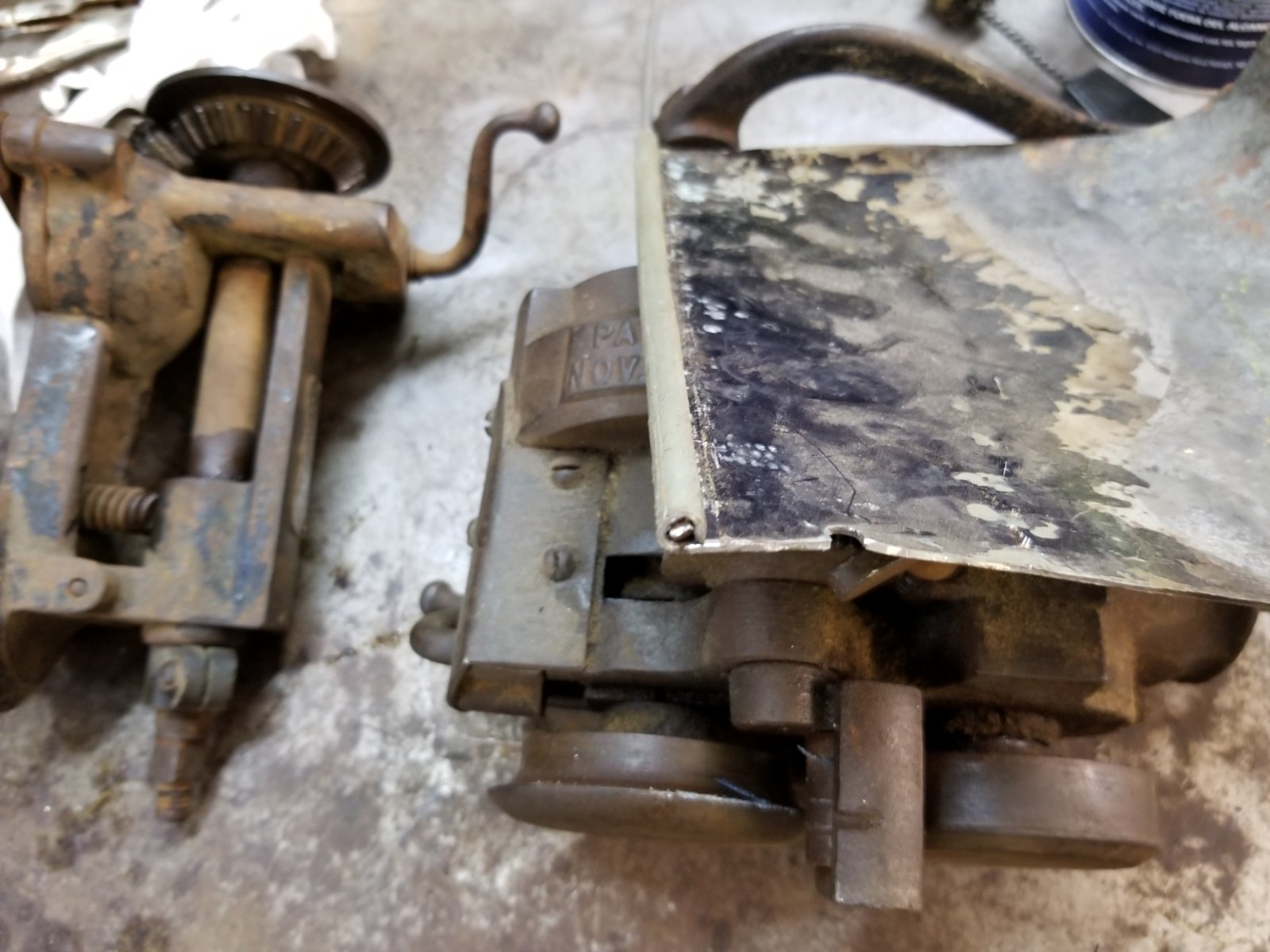

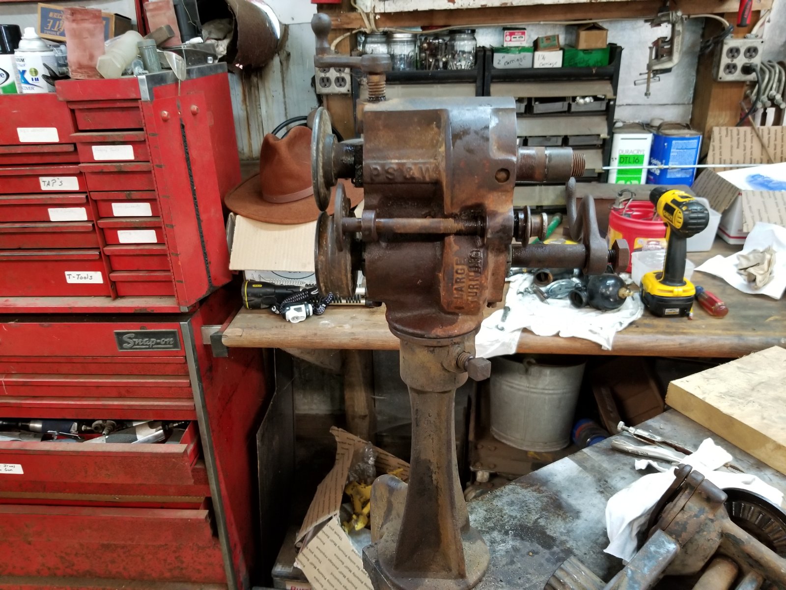

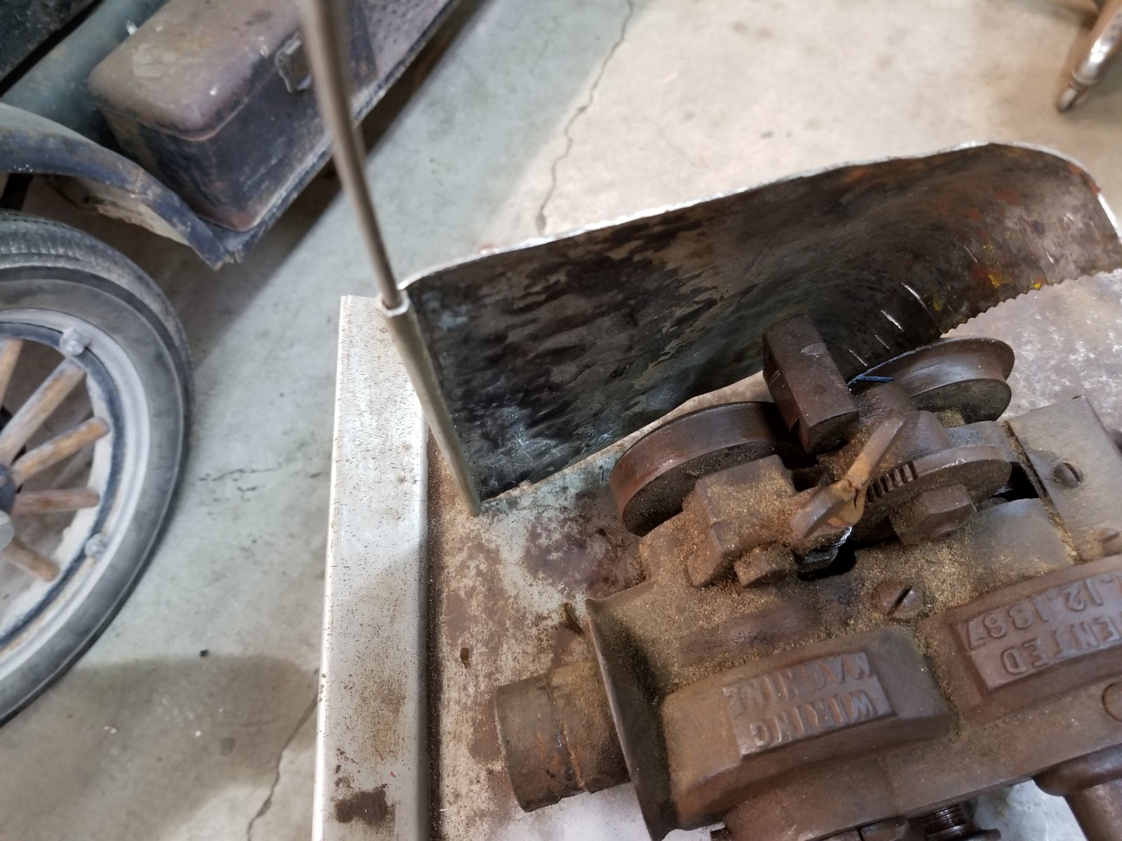

Tinkering in the shop this morning before it got hot. Picked up some tools from Tim Morsher to aid in the process. 1867 pat. Date. After study of said apperatus, I grabed some scrap metal and started playing. Before I knew what happened the morning was gone! Tim didnt send the instruction manuel?

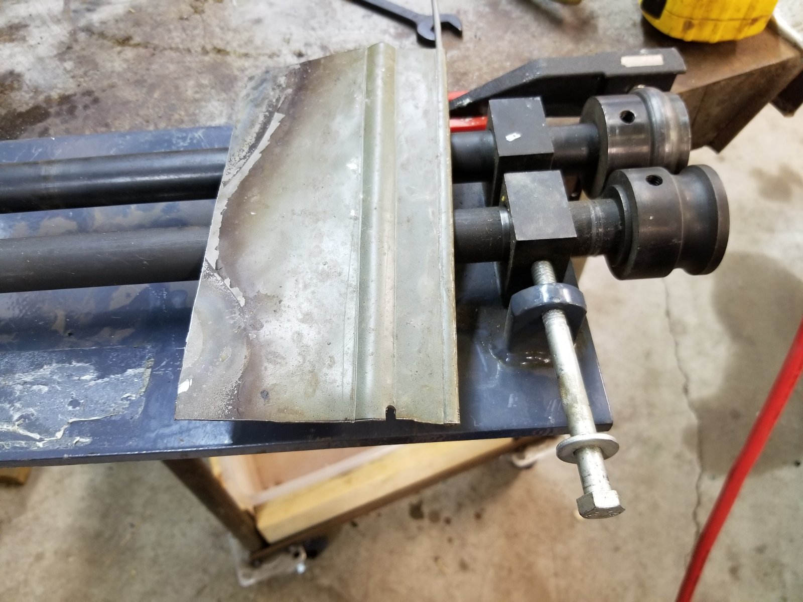

The scrap I used was a tad thicker than what tim sent home with me but not much. He also sent an original MP fender for a pattern. My fenders on the 8in1 are fastened different on the ends but the rest is the same. After some measurements and turning the cranks for a while, I think I may be able to do this. 1st I went through the process of making the L on the edge. Then some clamping and hammer action and final run through wire bead roller the wite was in the edge. Then on to the bead roller for fender bead. I will need a larger diamiter roller but I have the general shape figured out.

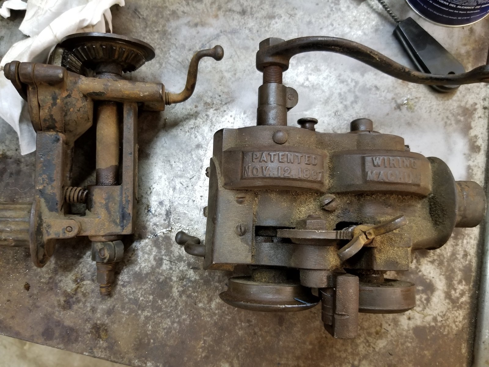

I am no metal expert. This is the 1st time I have attemped something like this. A couple photos of the tools.

Thanks George. Tips and tricks are what I need. My plan is to figure the width and lenght of metal needed for the fender. My buddy has a shear and a roller to get the arch I need. Then the fun will begin. Mine will be arched like the MP but will need a flat on one end to center the arch above the wheel. Then it will need a flange to bolt to the bed. The flange is the part I am having trouble figuring out how to make.

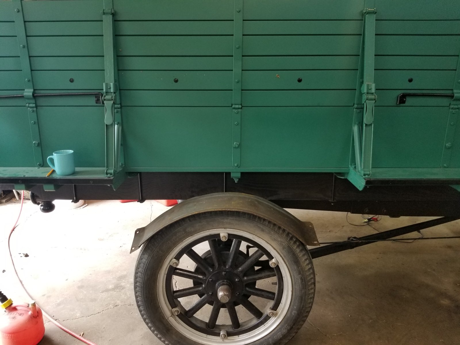

Re: Making fenders 101

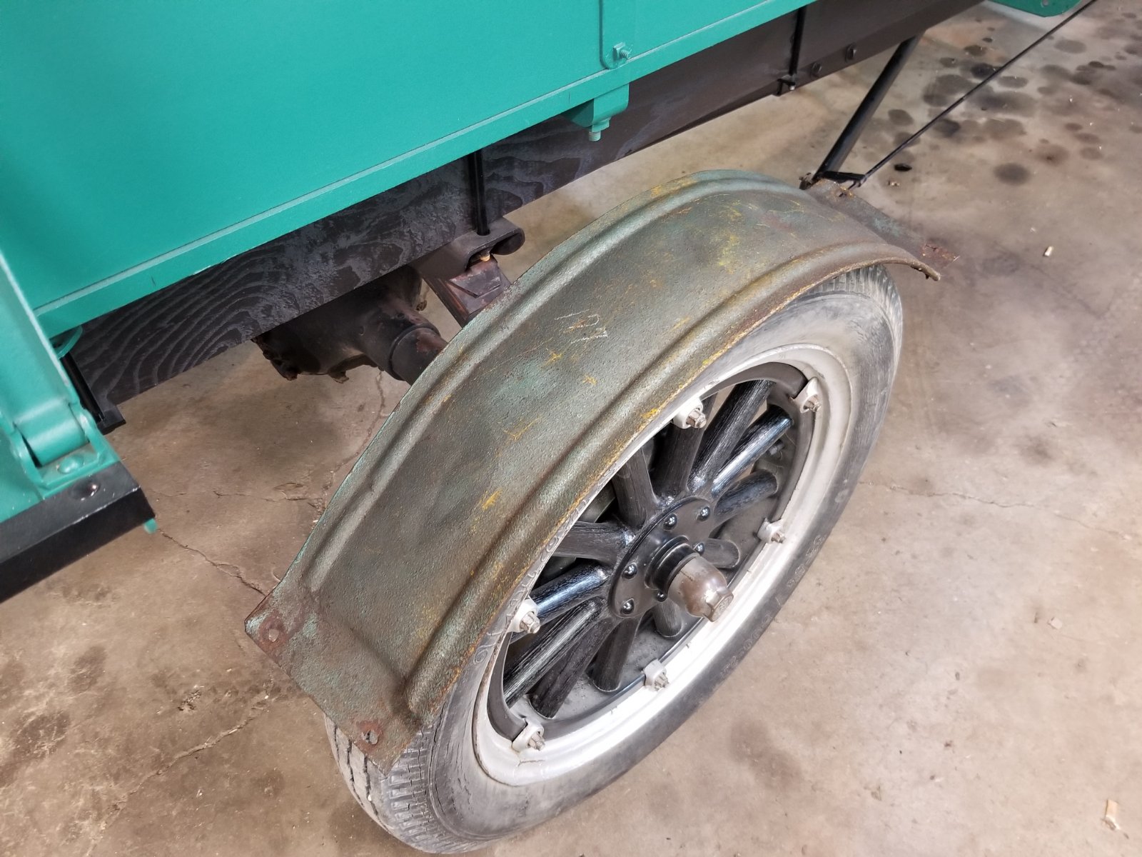

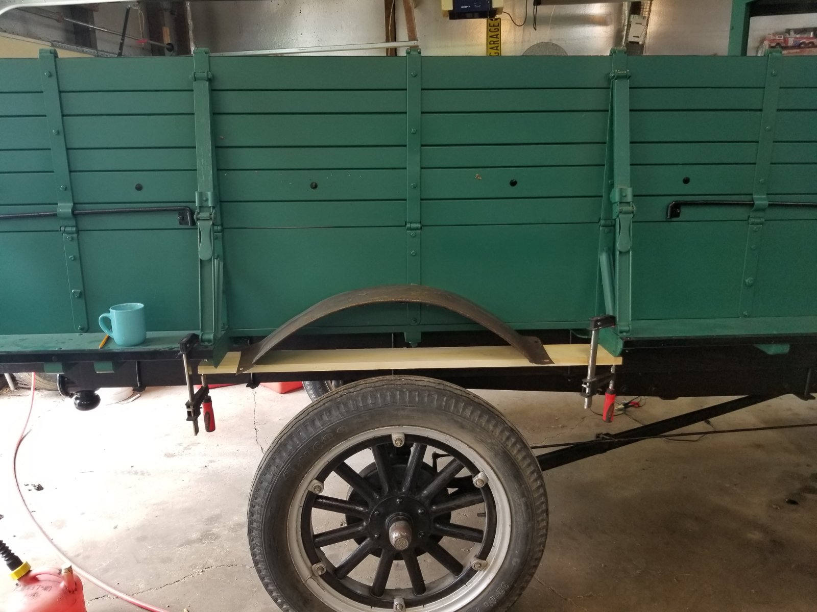

George, the fenders go on the 8in1 bed on my TT. The MP " Martin Parry" fender Tim sent home with me is the perfect arch and style I want. In the photo you can see that the wheel is not centered in opening on the bed. Since this bed would fit multiple truck chassis, the fenders had to be made different for each brand. " Just guessing there" .
The original wood in the bed had holes for a fender but its long gone. The holes suggest that the fender centered over the wheel. The fender bolted to the bed side and the angle iron fore and aft the opening. There must have been a notch in the top of the fender to clear the flat strap iron for the hinged bed side. Again just guessing. Since the cab is MP and the fender style is almost exact match to the T style beads, I thought I could create something that looked like it belongs there. Since I have no reference to look at and nobody else does, how can I go wrong.

This shows the look I am going for.
