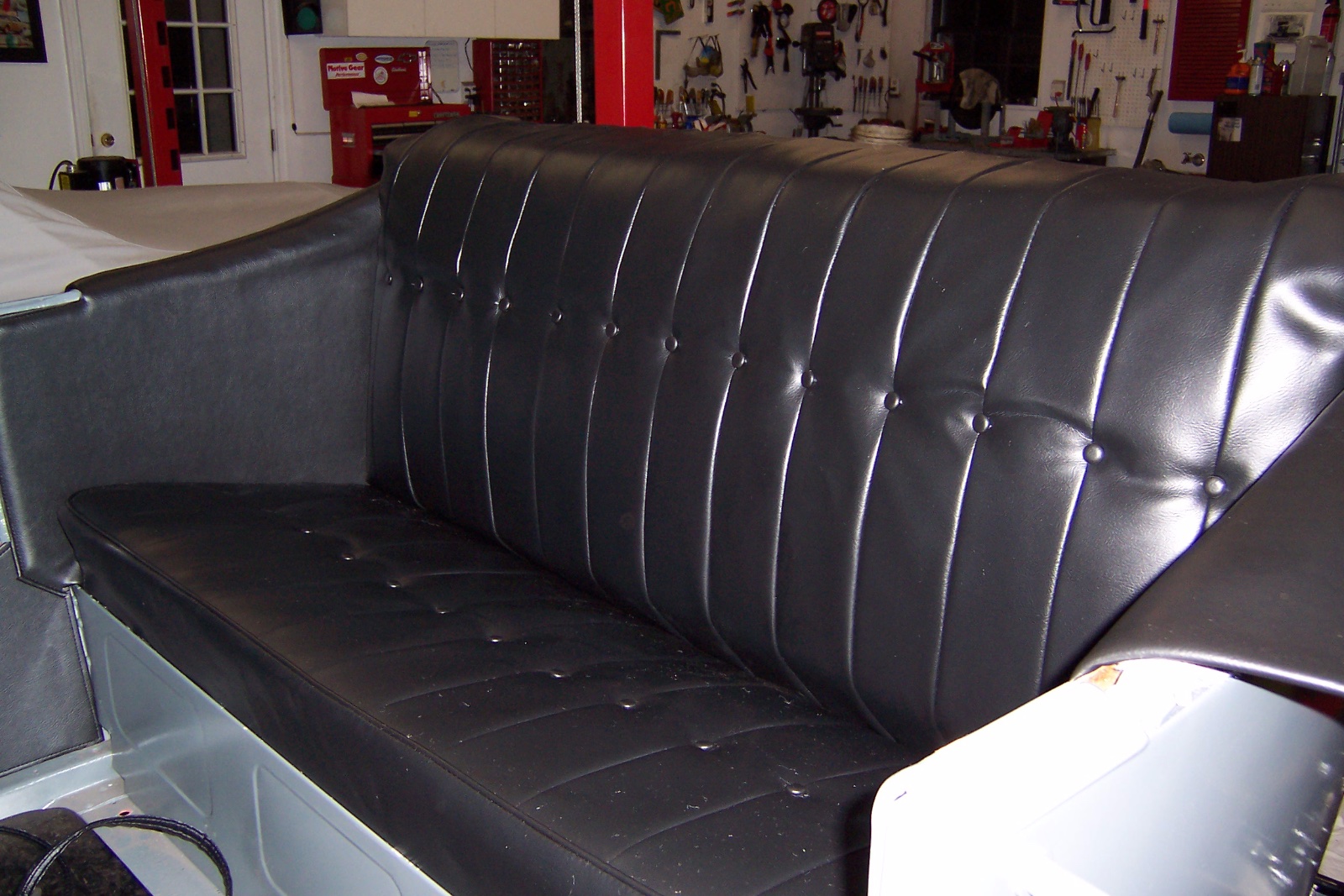

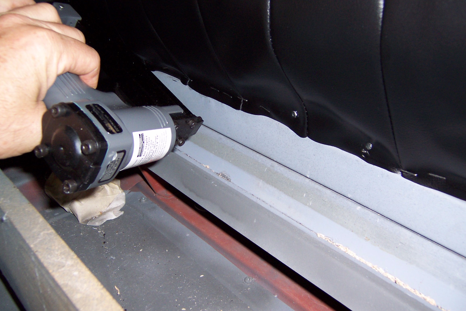

The hip pads go in first. Then the backrest lays down, tack the upper first, pull taut over the backrest springs, and tack to the wood tack strip at the base.
front seat backrest install.jpg (58.22 KiB) Viewed 3602 times
Hip pad on far right, fitted first, then backrest, tucked under behind.

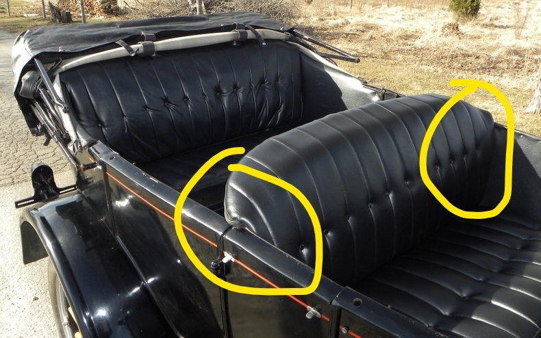

See circled sides, since there isn't a tack strip on the sides, how does the cover get fastened down?
Posts: 4046
Re: Help with 1926-27 Upholstery tuck?
Post by DanTreace » Tue Jul 16, 2019 10:30 am
Jim

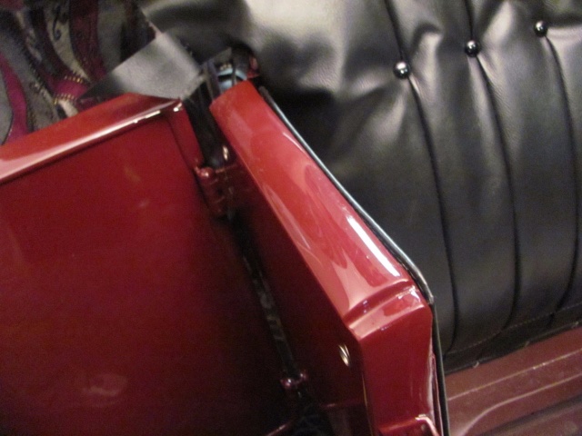

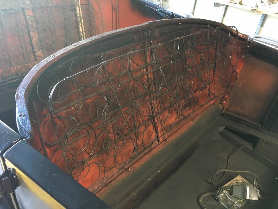

The sides for the backrest upholstery are made extra wide, they just 'tuck' in and under the backrest spring, the mushy padding gives the fill against the hip pads, or you can add more fill if you wish. No tacks, if you wanted to, you could just pull it away, but in reality it stays put, as the whole backrest upholstery is under tension of being tacked at the upper tack strip and at the lower tack strip across the horizontal.
The backrest spring 'floats' from straps hung from the upper tack strip.
This is a rear seat backrest, similar to how the front seat in a touring is done. The rear has wood stays, the front seat only a metal stiffener and uses a water proof cardboard backing panel to insulate the body metal from the spring.
