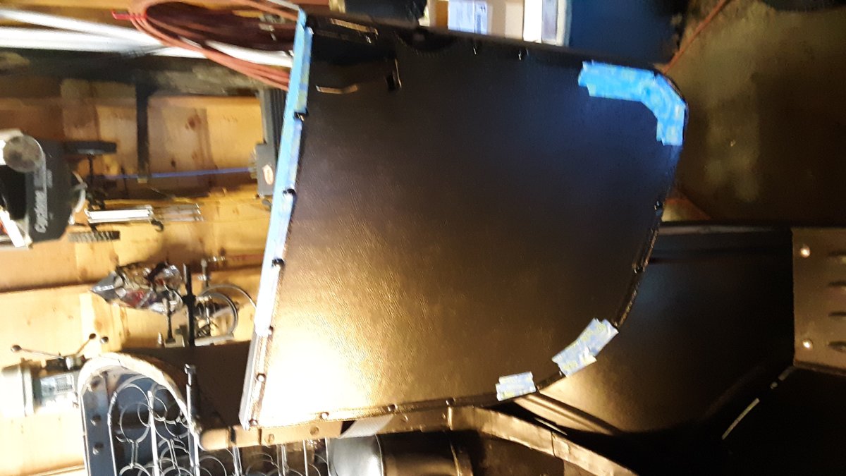

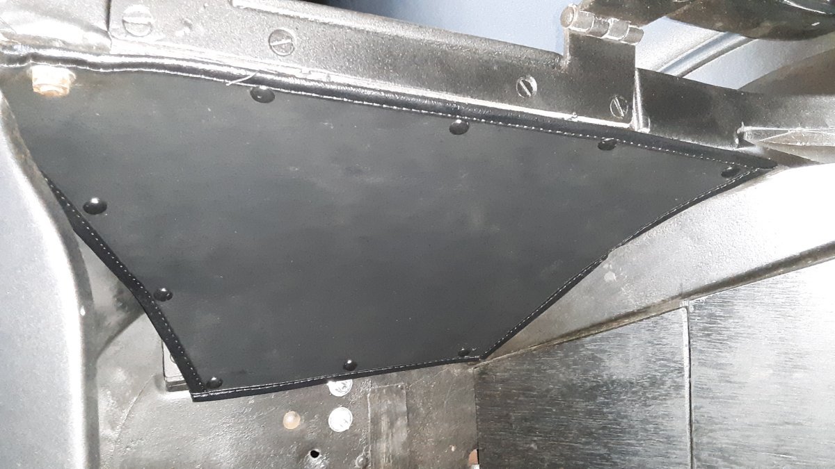

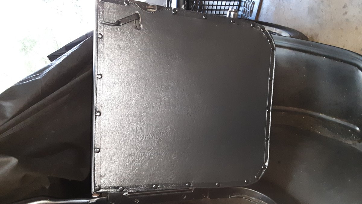

When installing the welting on your door panels the edge of the welting lifts giving an unfinished look. Lay some masking tape along the lifted edge so you dont get any glue on the door panel then apply some black weather strip adhesive with a toothpick in the crease, press it closed and put another piece of tape to hold it tight until it dries. It really works nice.

Make a clip out of sheet metal to hold the kick panel to the floor board riser to hold it to the curve

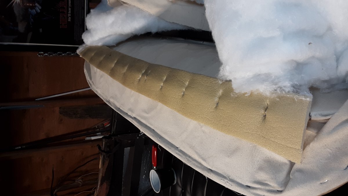

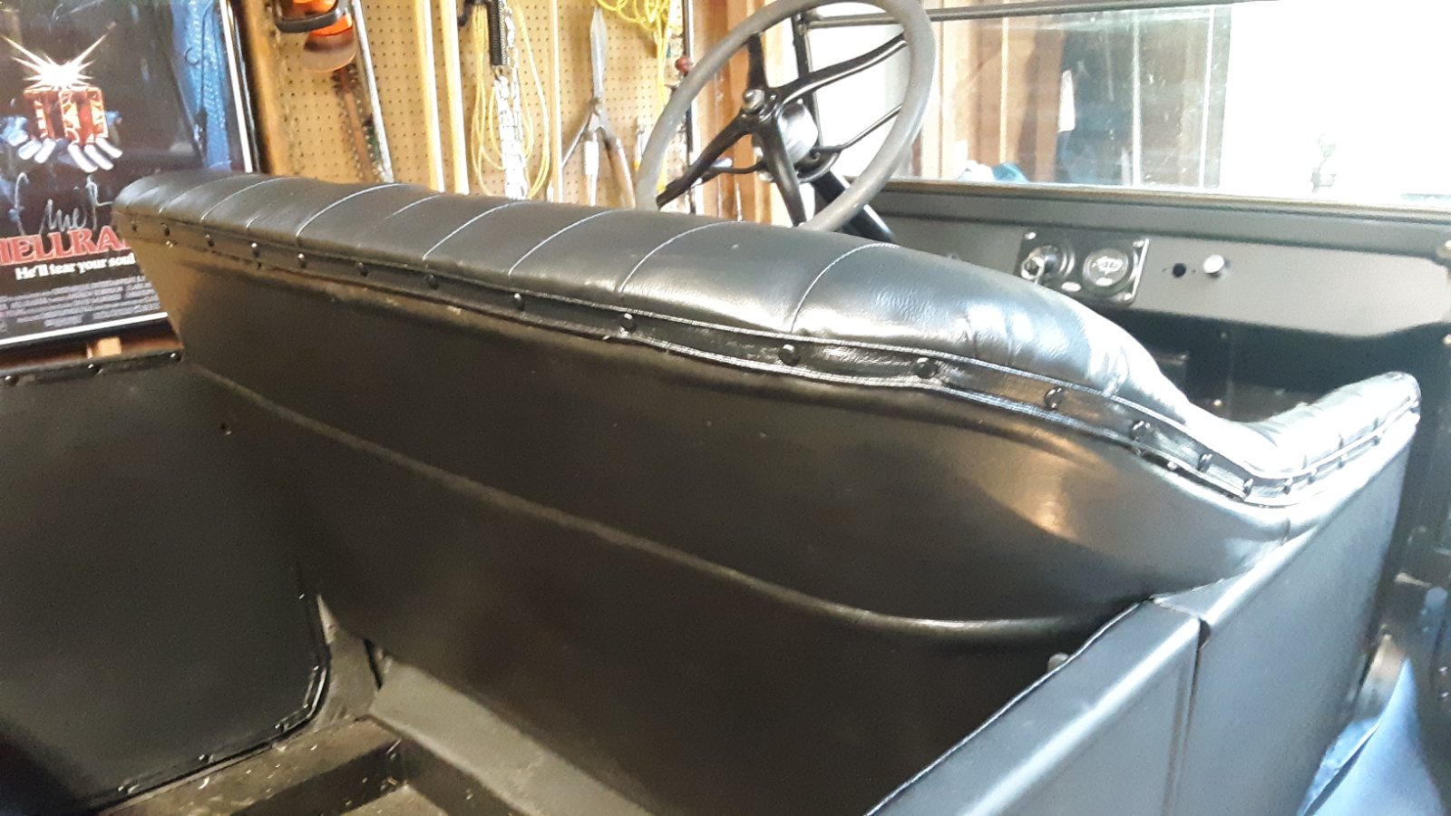

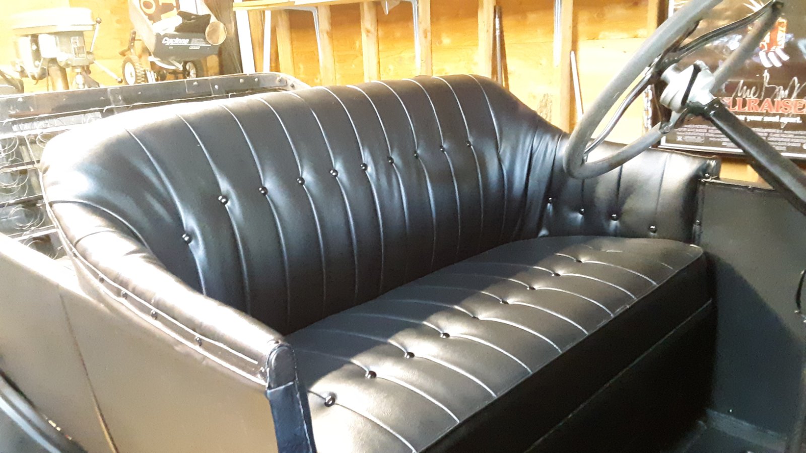

I could not get that nice round crown on the seat back until I cut a strip of dense foam that you sleep on in a tent and hogringed it to the top of the spring. It worked really well.

Post by Henry K. Lee » Sun Aug 04, 2019 7:21 am
“Grasshopper” I meant Doug, Super Job Brother!
