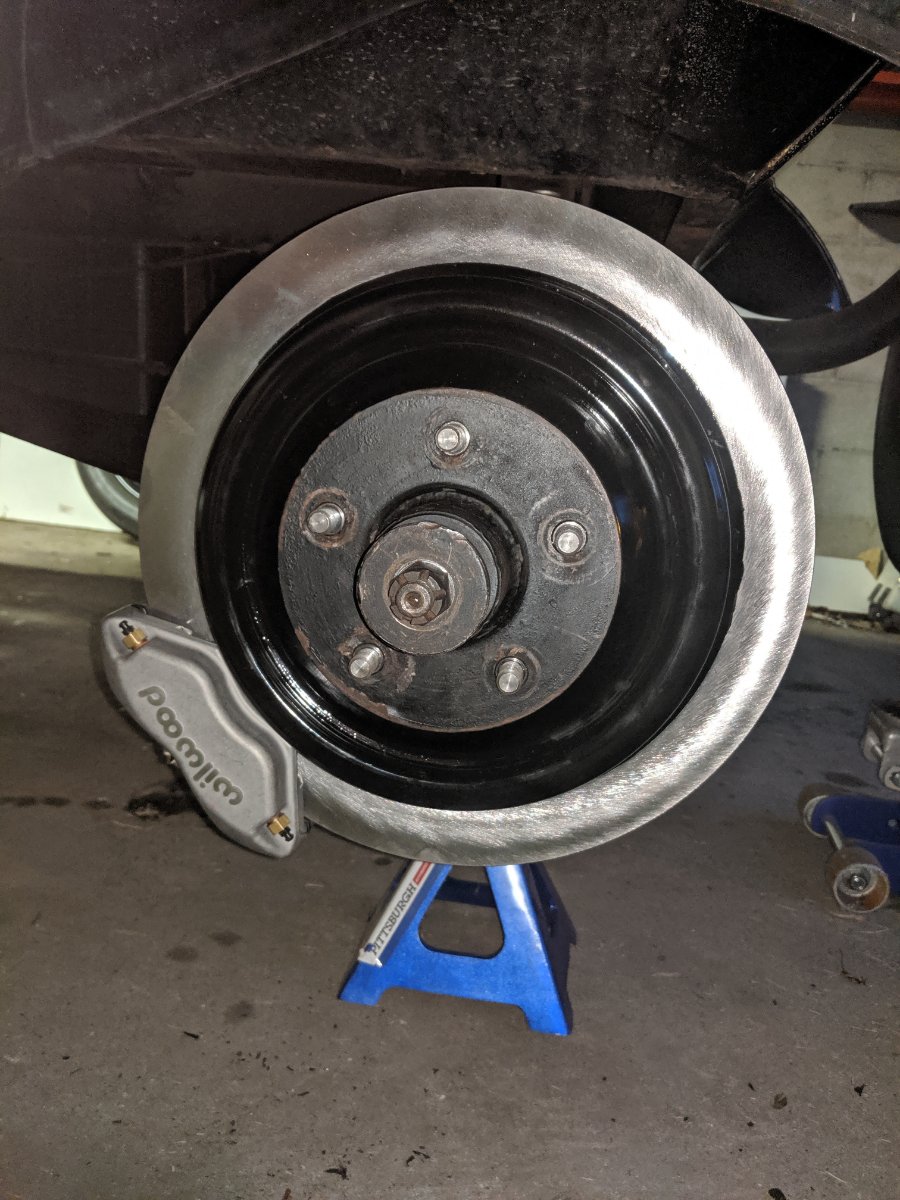

Because I have a Ruckstell axle and no brakes other than the transmission brake, I decided to install the Sure Stop disc brake kit, both because I like driving my model T and I would also like to go on living.
It really is more or less a bolt on kit.
Minor annoyances:

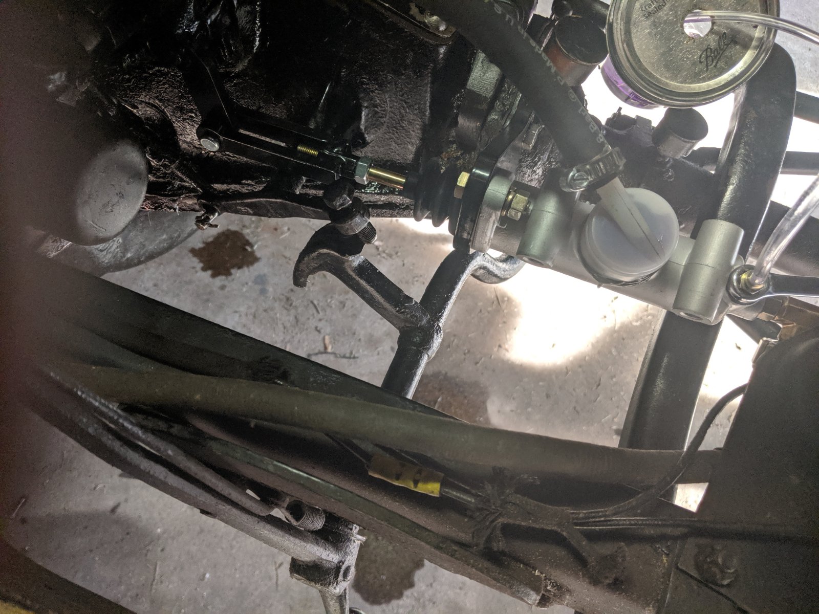

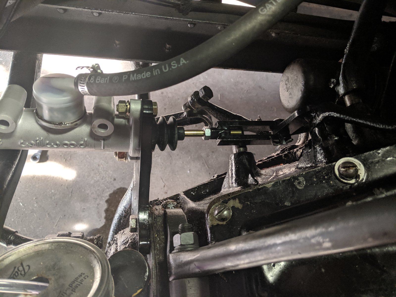

1. To install the brake hose coming out of the master cylinder requires that you unbolt the starter switch assembly and shove it aside because there is a brake light pressure switch immediately aft of the master cylinder and you can't turn the hose fitting without hitting the starter contacts, which is unpleasant. :|
2. The master cylinder sits at about a 15 degree angle to Port for no reason that I can see.
Other than that, it's a breeze to install, as long as you don't drop washers and nuts in the transmission or have a machine shop drill out the lug holes of an aftermarket rear hub made in Hong Kong. ;)

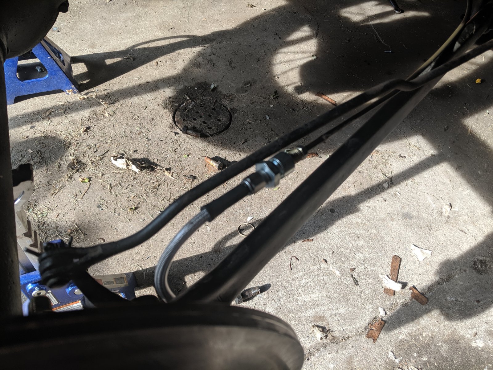

Hose connection
