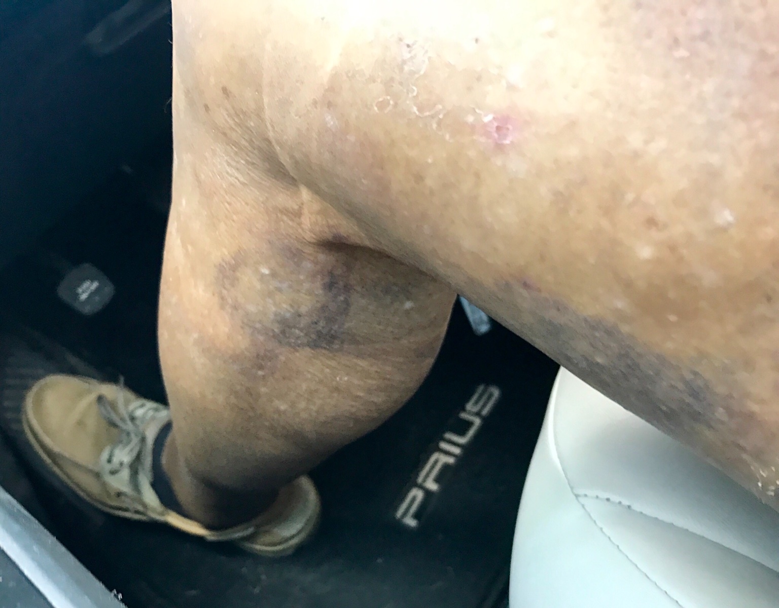

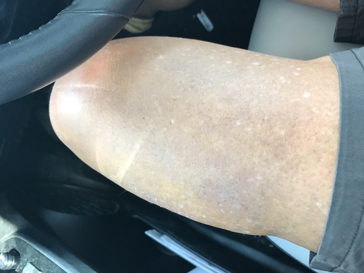

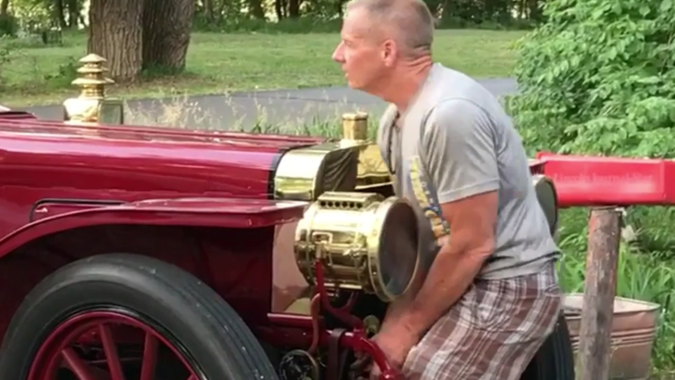

I’ve had two bad kickbacks from the 1910 Ford racer, and one from the K so far this year. So far, the K’s bite is worse.....
Due to the large motor (406 cu in), I have to grab the crank in both hands, and essentially perform a deadlift motion:
Unfortunately, that leaves four limbs exposed when they kick back.......
Finally went to the doc today. The good news, nothing broken or serious. Bad news? 6-8 weeks before the swelling goes down. :shock:

Thanks guys. My first serious kickback with the K happened last year at OCF. I always prime my cars prior to switching the ignition on, but the higher compression K usually still need a pull. And the racer only has a dual spark mag, no battery.
Just as I pulled the K over, I noticed two coils buzz, and BANG! Turns out a little piece of metal shorted two commutator contacts and two plugs fired at almost the same time.
This time it was all user error. I had the K at the Milwaukee Mile and used it to pull start the racer. My co-driver would drive the K to pull and i the racer. However, I had to start it (K) each time. Soooooo
I hooked up the racer and K, set the spark and gas on the racer, then did the same on the K, retarding the spark and giving a quarter pull on the gas.
Only trouble was, the gas and spark are opposite between a 1910 Ford and 1907 Ford........ I advanced the spark, no gas on the K.
Ouch!

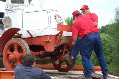

And witnessed the same at circus show, starting a huge MAC truck, the one guy stabilized the other, helping to lift his leg away, while the other guy kicked that beast to life :lol:
kick starting a Mac.jpg (64.07 KiB) Viewed 7972 times

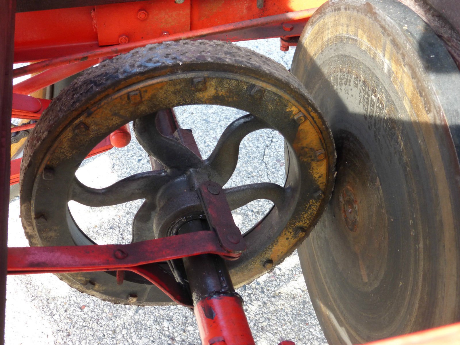

Rolling down a hill and popping the clutch often works for most vehicles as they have a large contact area between the face of the flywheel and the clutch disk itself. A friction drive car has only a very small contact area between the driving disk and the friction wheel. "Popping the clutch" on a Metz WILL damage the friction wheel. Don't ask me how I know.
All of you stem winders out there; be cautious, Bill.
Not my car, but you can see the very small contact patch. This shows a different material from the original compressed paper as used by the Metz company.

Post by Rob » Thu Jul 25, 2019 10:58 am

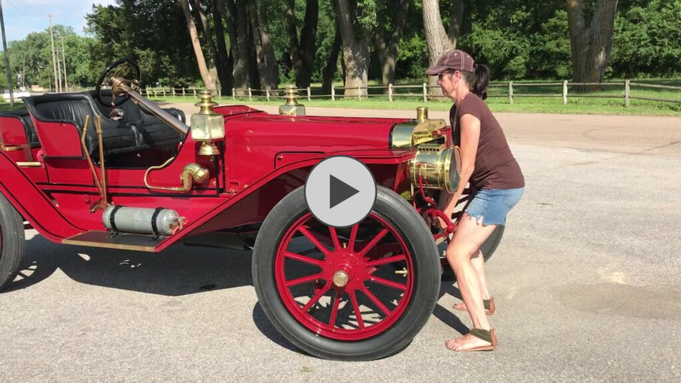

Adding insult to injury......
https://www.dropbox.com/s/bw0qgxw3dprl9 ... M.mov?dl=0
The K was warmed and primed, with everything set right before this. Still, I doubt we'll have Julie start it anymore...
