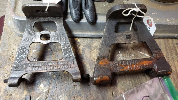

Thought I'd share these unusual parts.

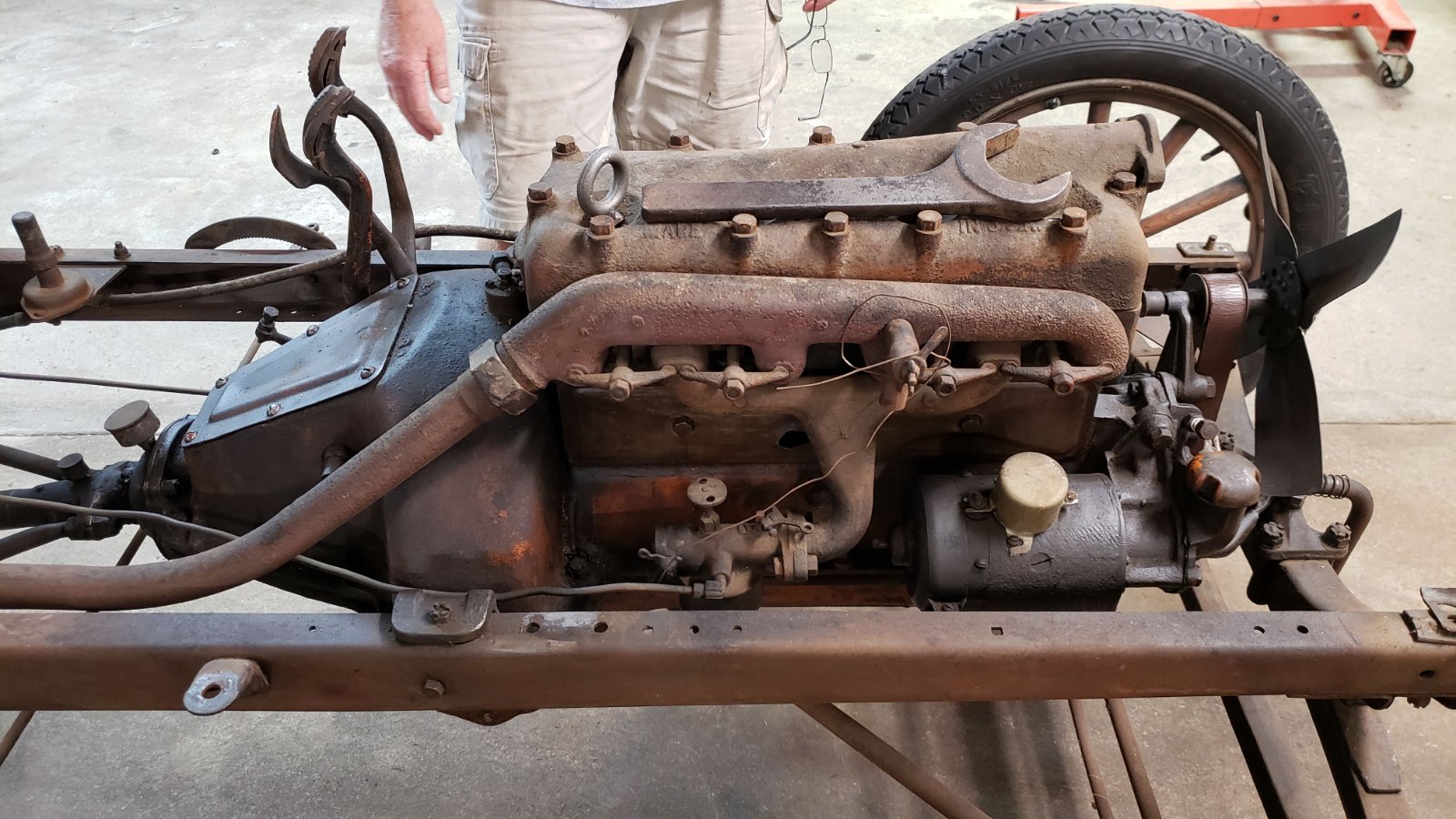

Pulled the Sept. 1922 engine out of my 1915 cut down touring today. This car is nice and cobbled together, a real farmer's special.

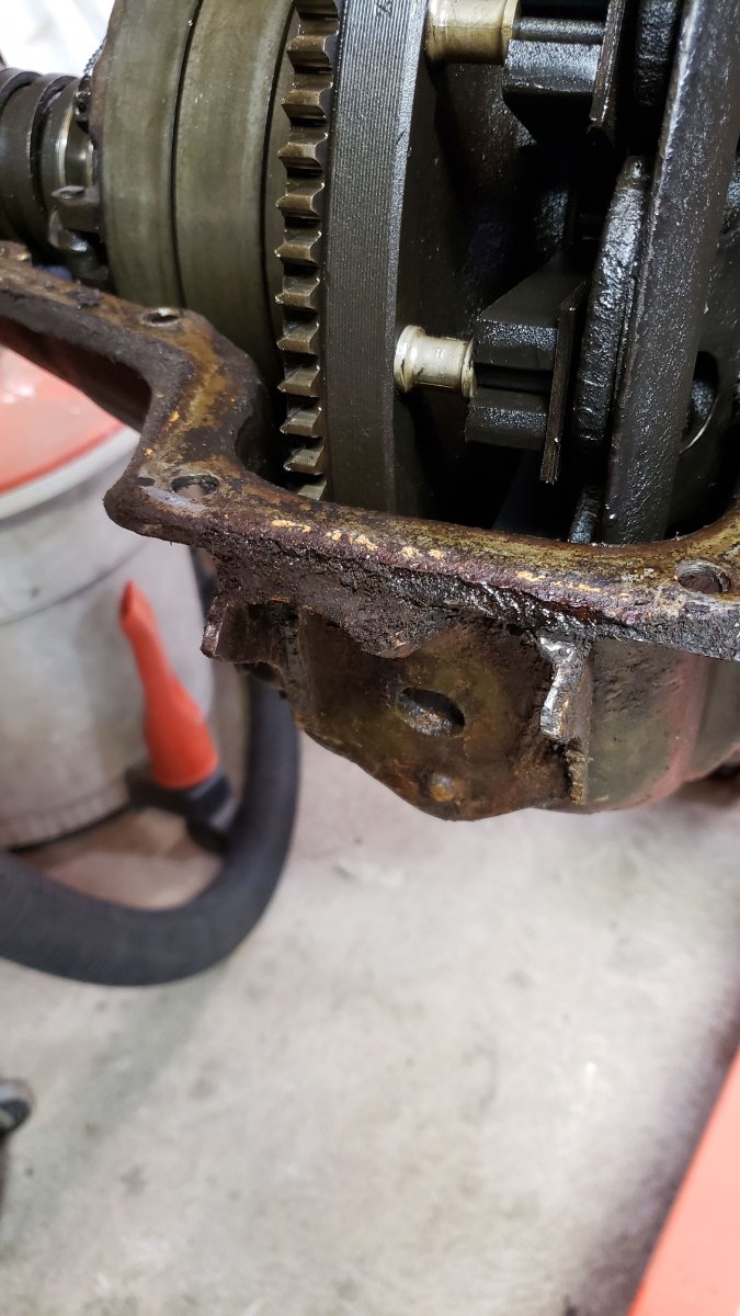

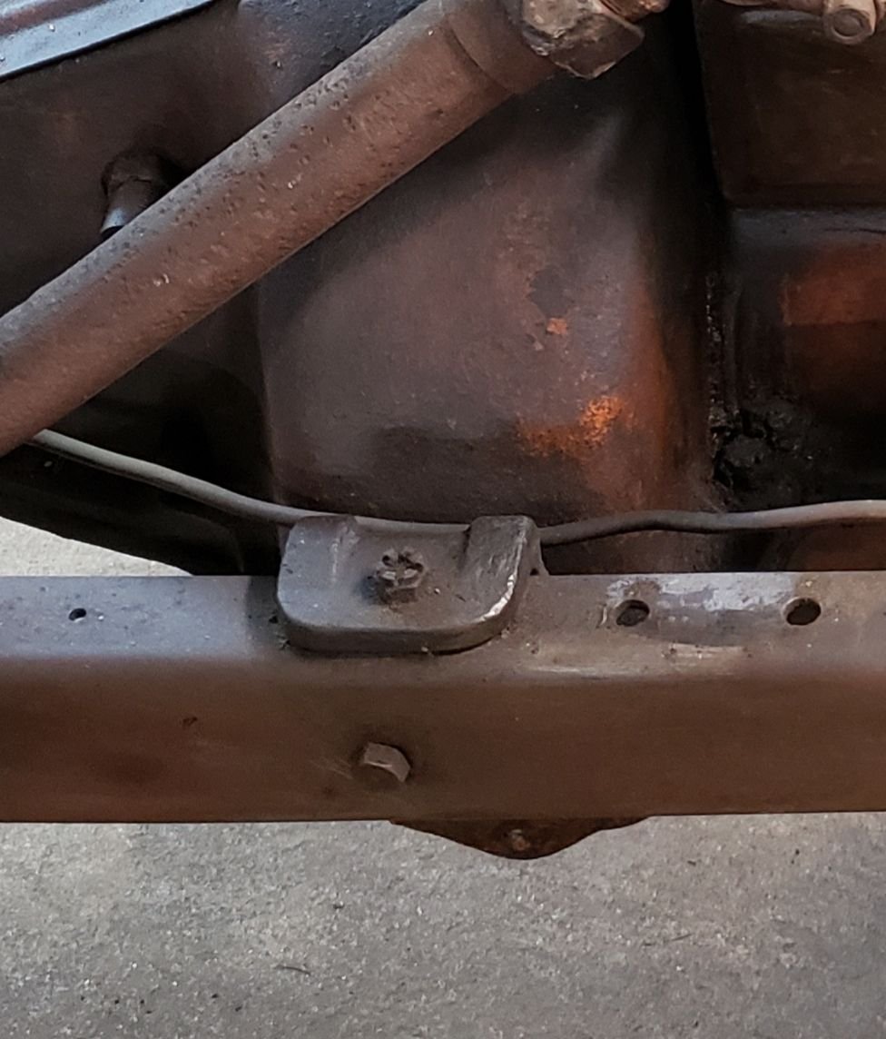

Two interesting items or accessories of note on the car are the two different 'Crank case repair arms' used in place of the riveted rear engine mounts. The original engine mounts are crudely hacked off, and in their place, these accessory brackets do the duty of mounting the engine to the frame. Pretty cool brackets. I will be cleaning up the jagged edges of the old mounts and reusing these accessory pieces when we put it back together.
I would love to know why the old mounts busted off. If only these cars could talk! Thought you all would enjoy.

Ref. your first picture Andrew; reconsider the routing of that fuel line. Think ‘under the motor mount and in the frame rail’.

Yes, line will be re-routed. We actually pulled this engine out right after the photo was taken. As I got it, the car is cobbled together and there are many small changes needed to make it right, and safe!

Those are some nice castings. I only have ever seen the bent plate steel versions (which I have two sets of).
