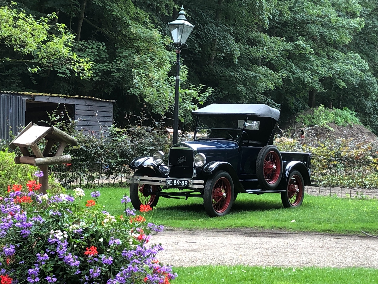

Buth still diving it every day, actualy using it as a normal car, if it is not raining ...
The climat change makes holland more sunny.. ;)
Bert
Bolow a photo from 10 minuts ago
[image][/image]

A beautiful model T ! I have always liked the Ford body pickups.

I agree. That is a very nice Pickup, Bert.
