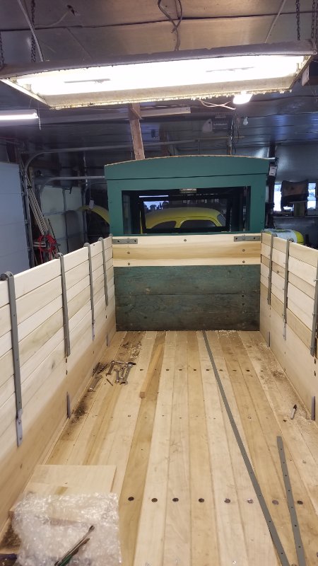

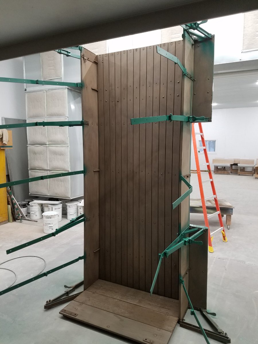

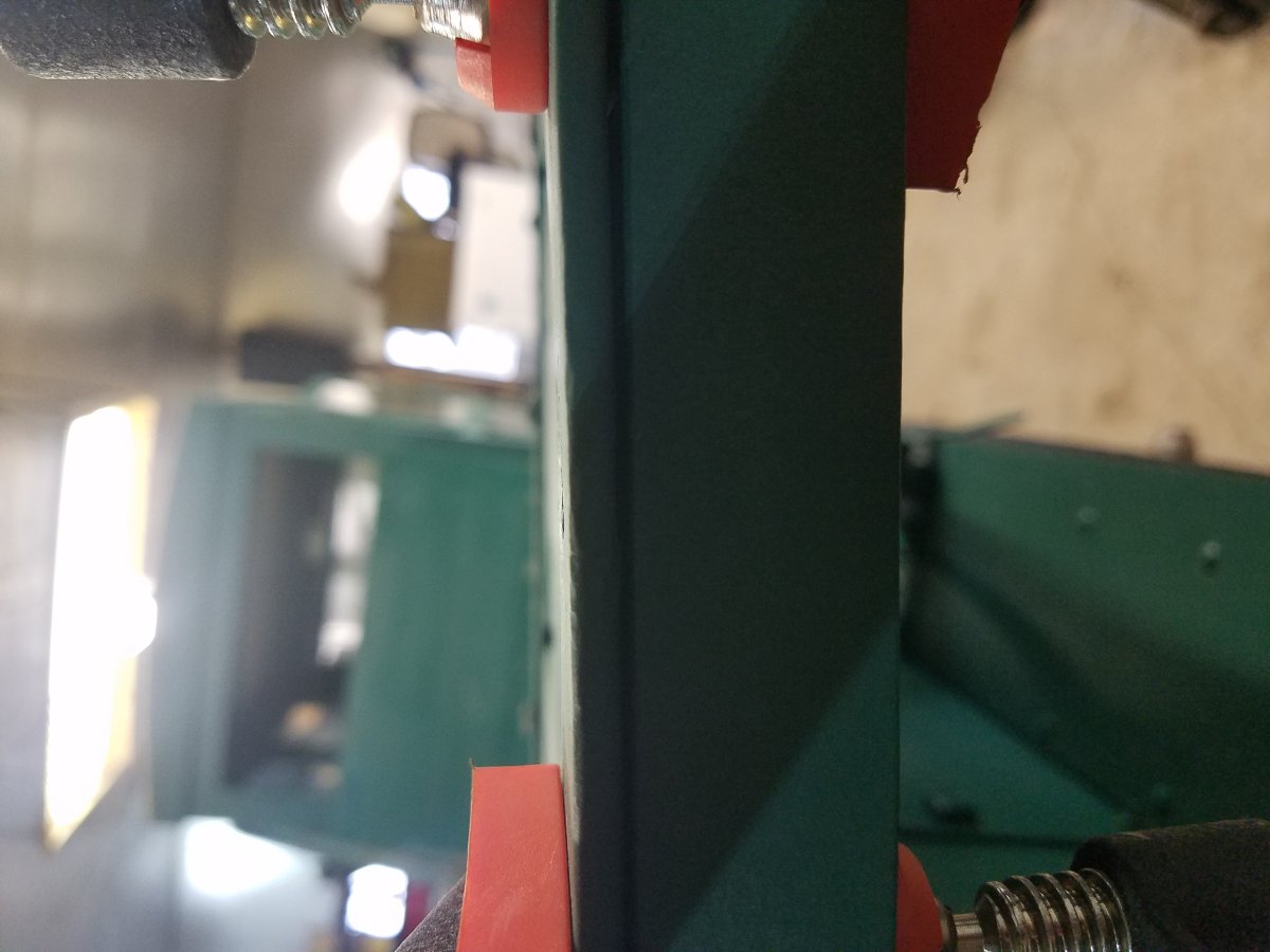

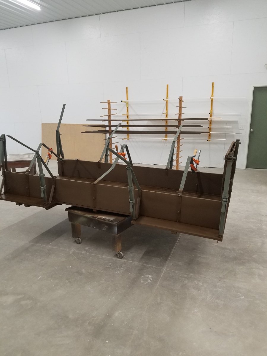

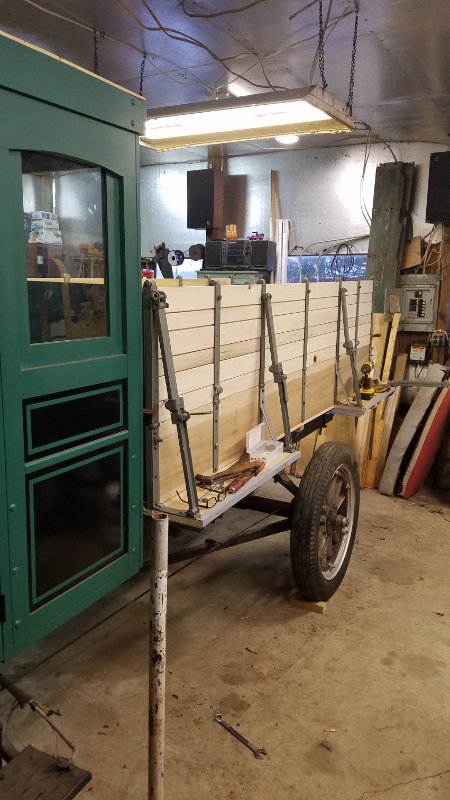

Breaking it down for paint.

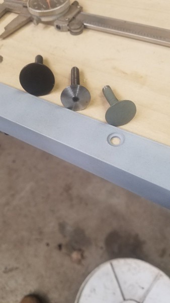

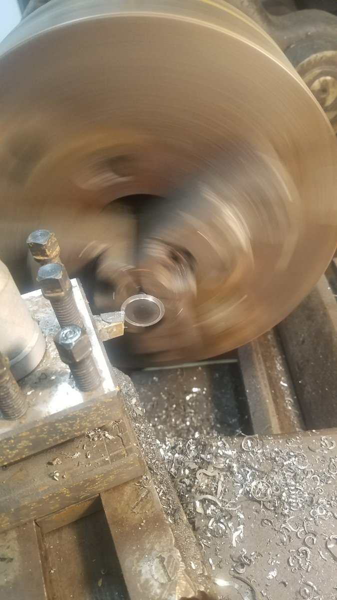

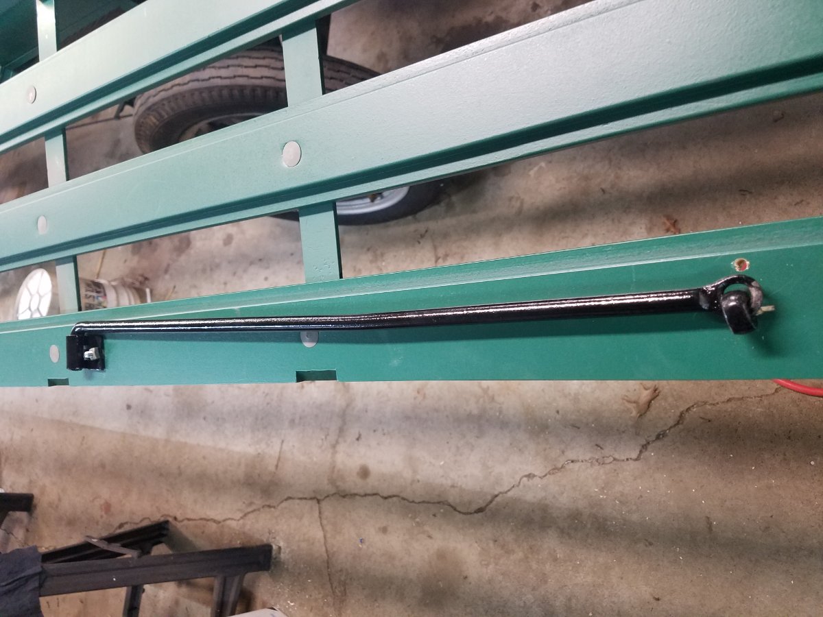

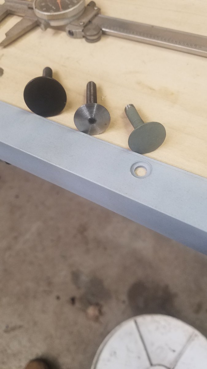

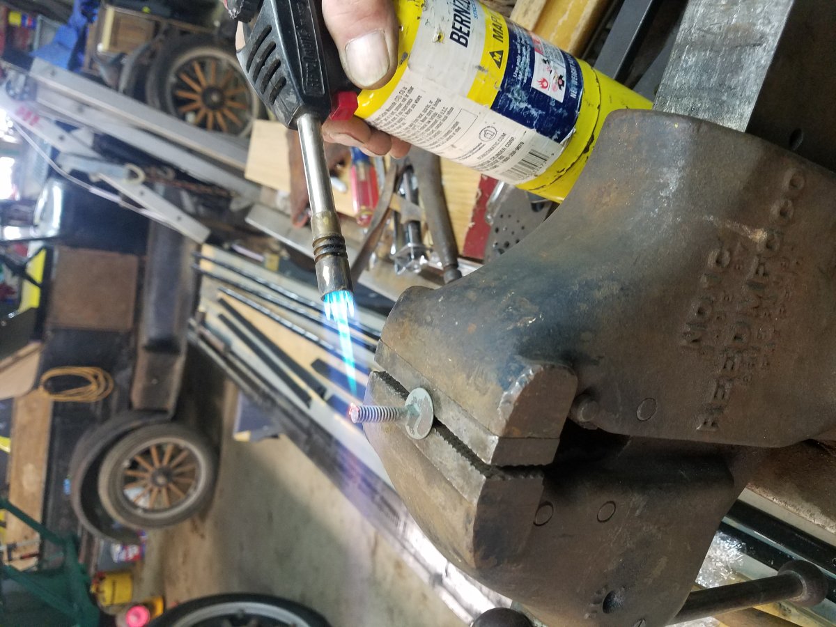

Glad it warmed up a bit. Spent some time on the old Rockford lathe tonight.
Turned the left bolt into the center bolt to match the original right bolt.
I made 14 of the 29 bolts that broke or was beyond saving.

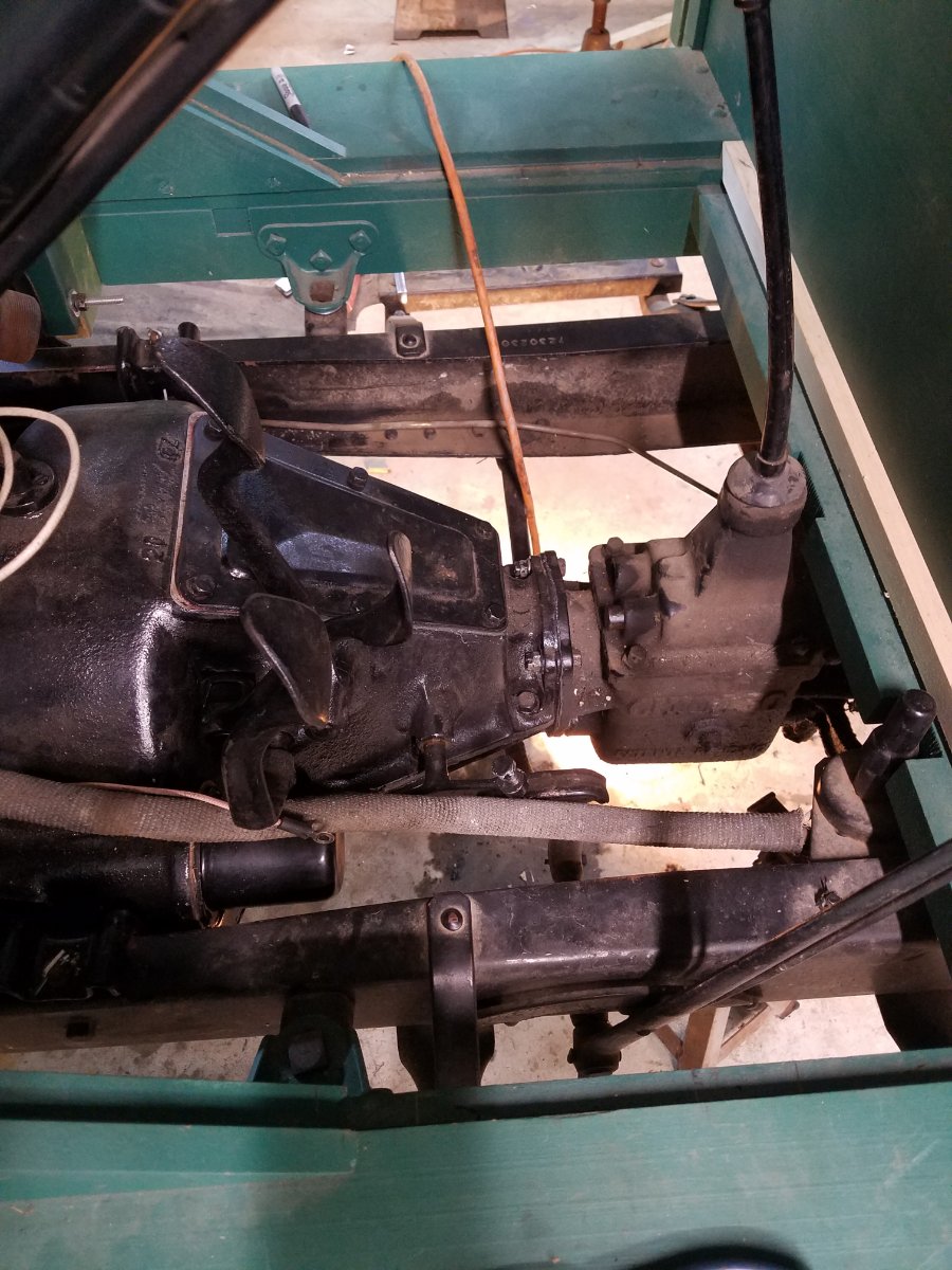

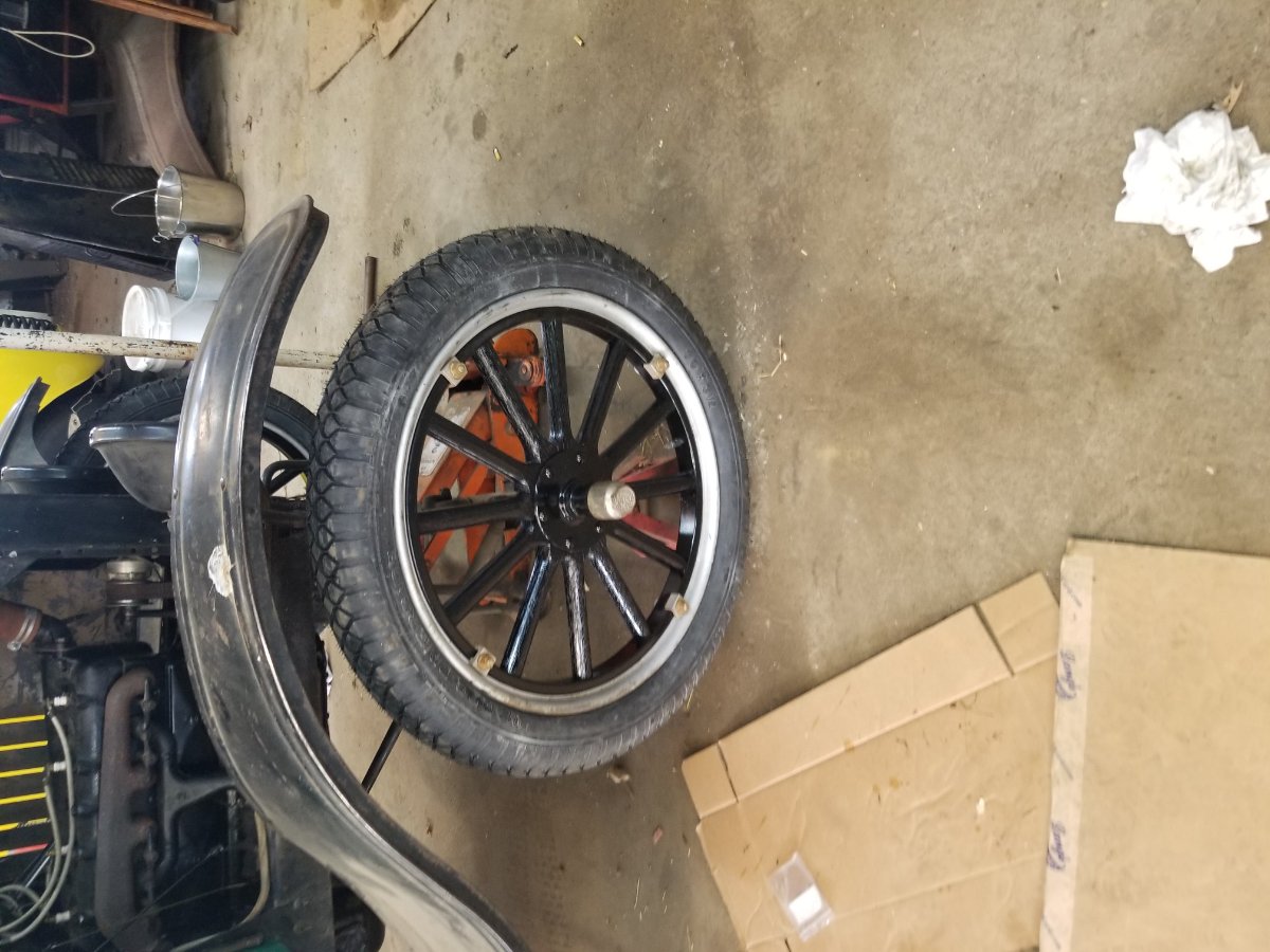

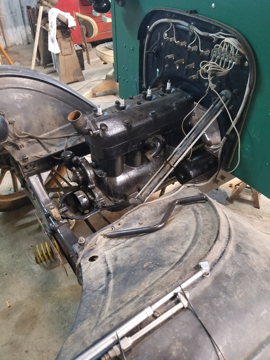

Well Ive been working on the other end of the TT the last couple weeks. The rib is still pretty sore but I'll live. The rebuilt engine from Joe Bell is in. I finished wiring and worked on the sediment bulb. I lapped the shut off on it with tooth paste. I also dicovered if I pull slightly out on the shut off handle, it works very easy.
I put a gallon of gas in and then two priming pulls on the old crank handle. The second pull and she roared to life!!!!!!!!!! A few quick adjustments of timing and fuel and it purrs like a kitten. I had to break for lunch and let the new engine smoke clear in the shop. I need to install radiator and see if I have a muffler but its been a good day so far. And for all the guys that would like to see the bed left natural, the cab roof is natural and will stay that way.

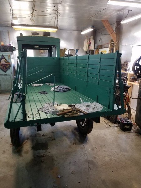

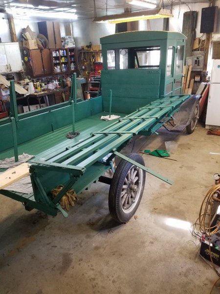

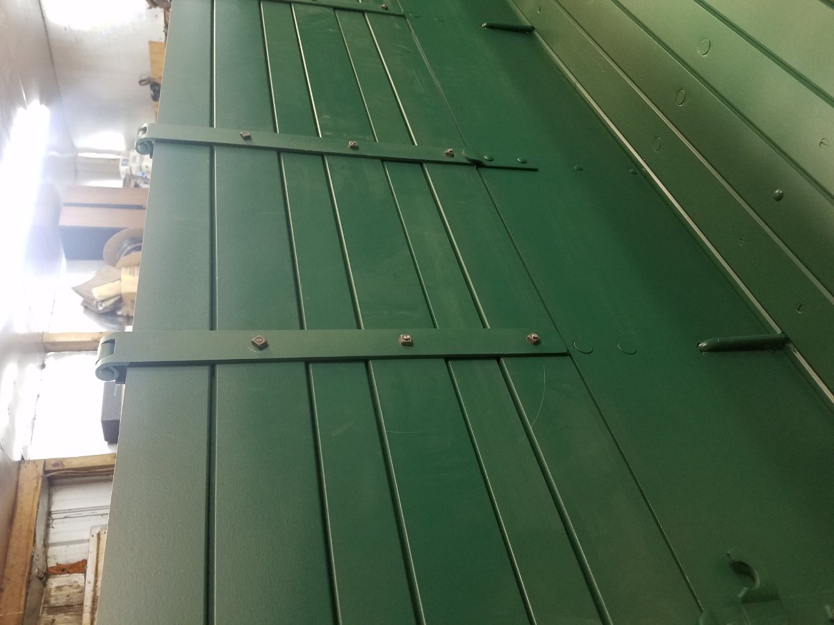

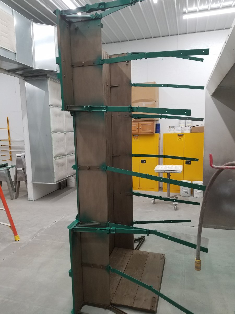

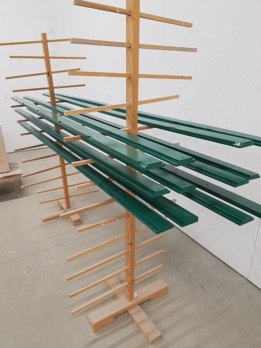

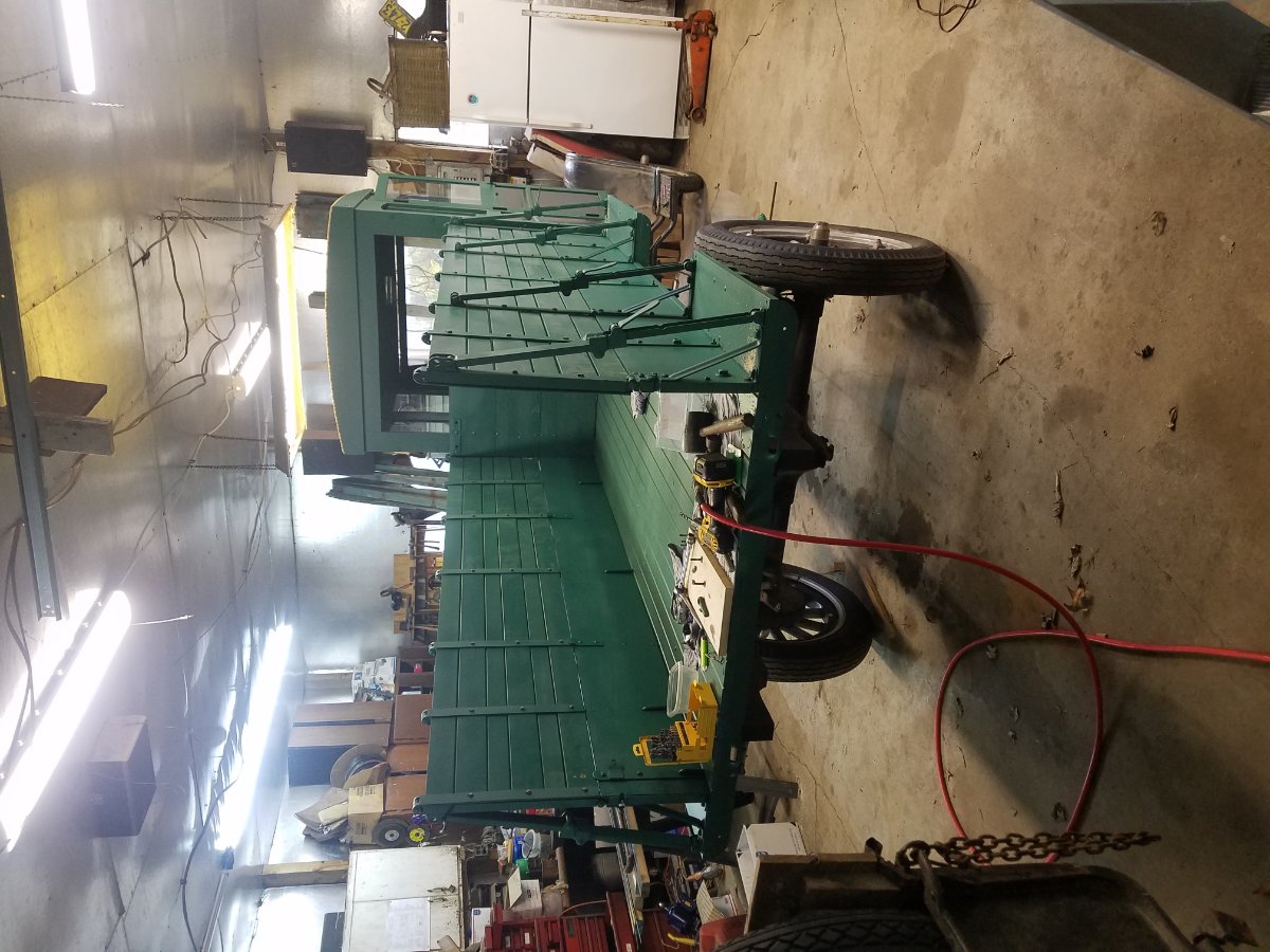

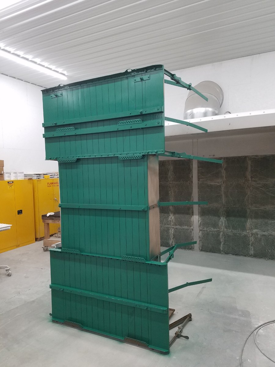

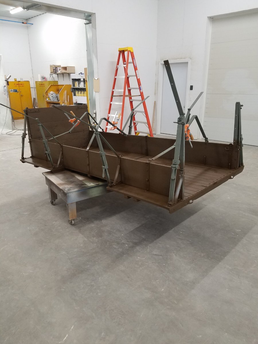

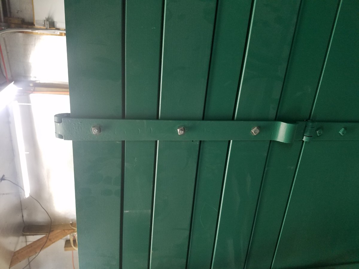

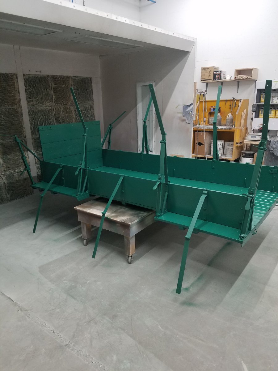

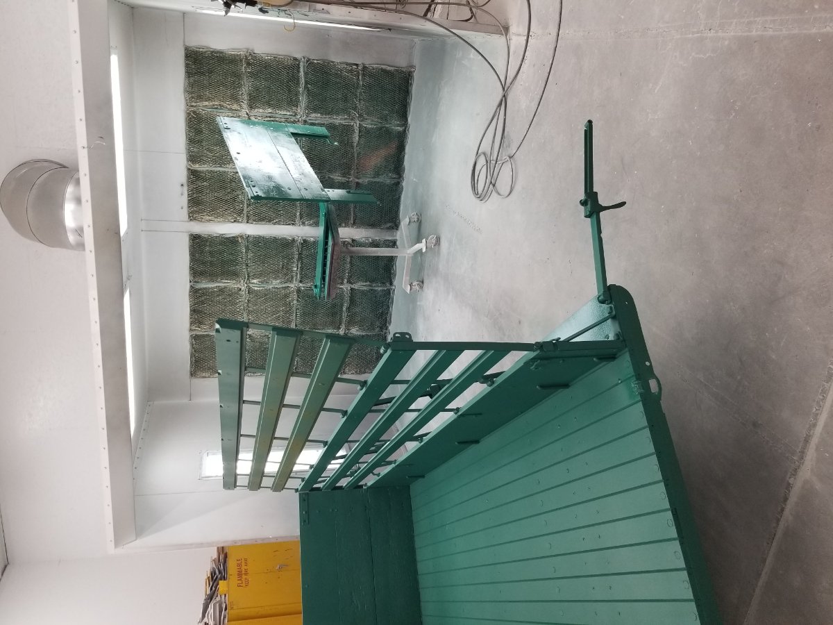

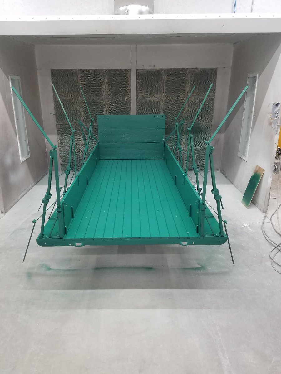

Finally the bed is ready for paint. The1st coat will be disassembled. I will put it all together and 2nd coat everything. Now I need to find some strong backs to take it off!

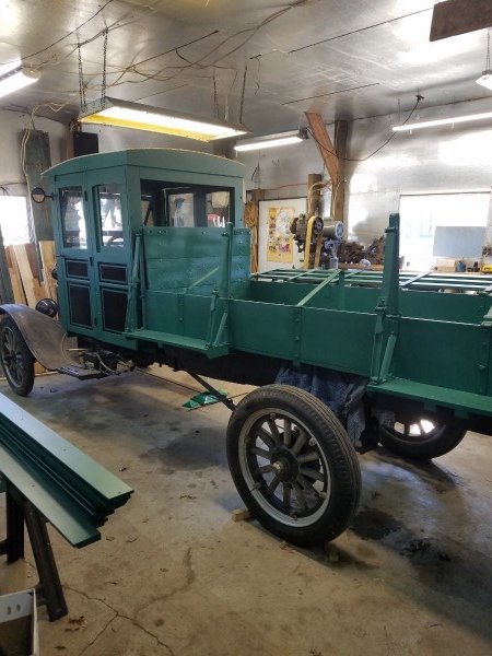

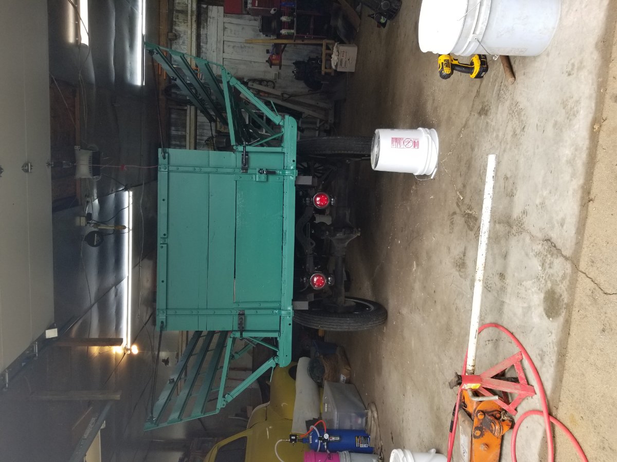

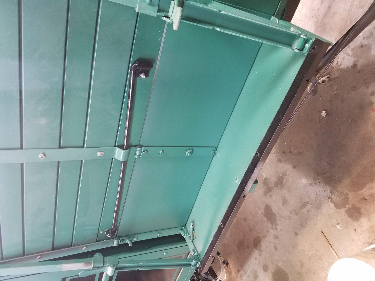

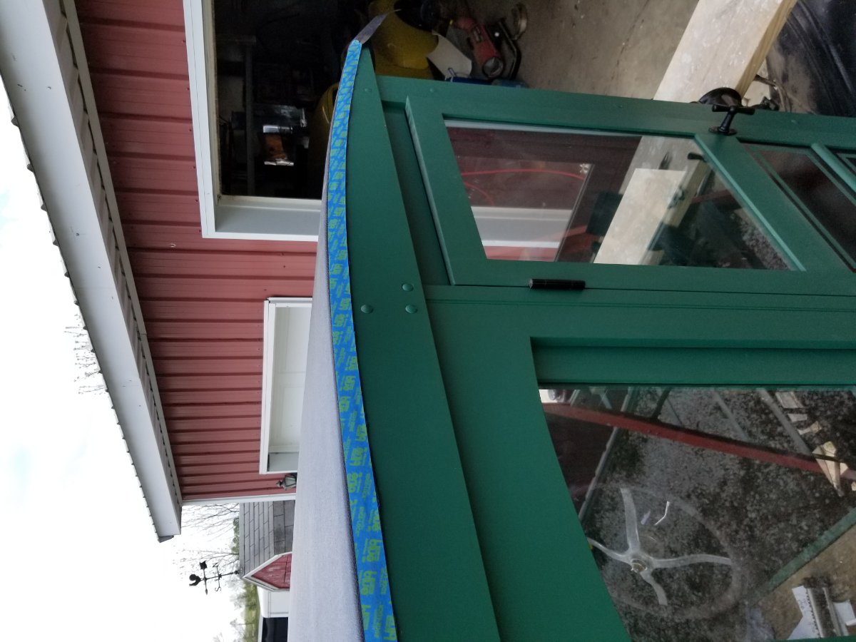

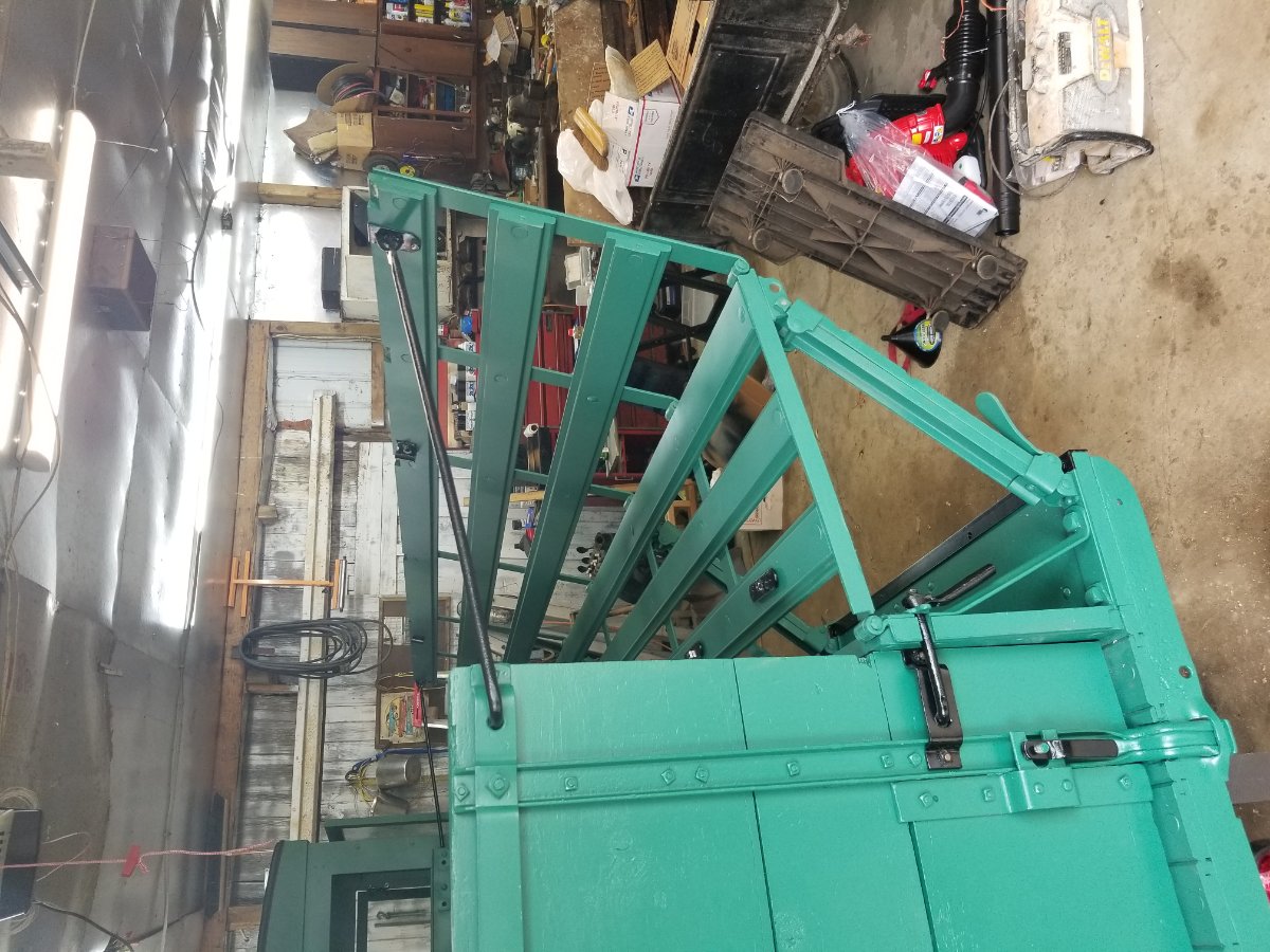

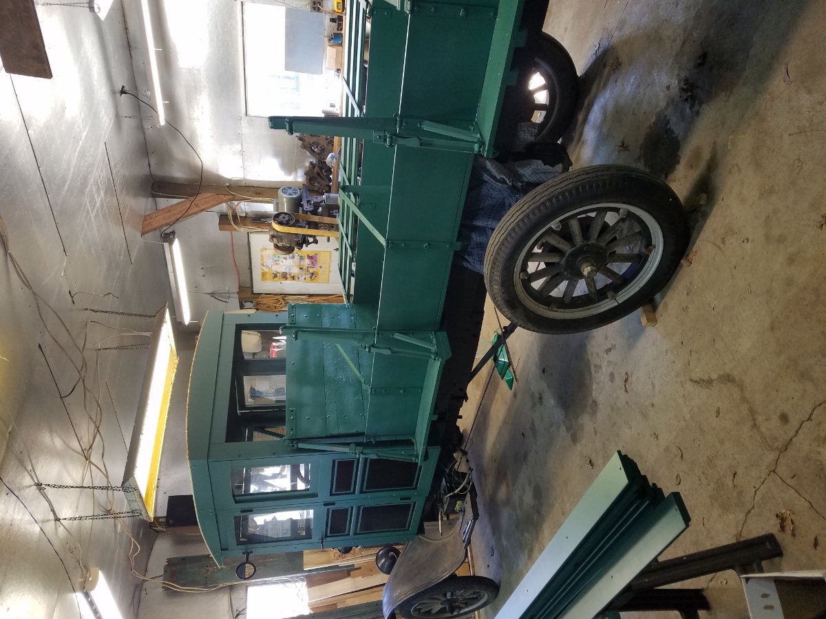

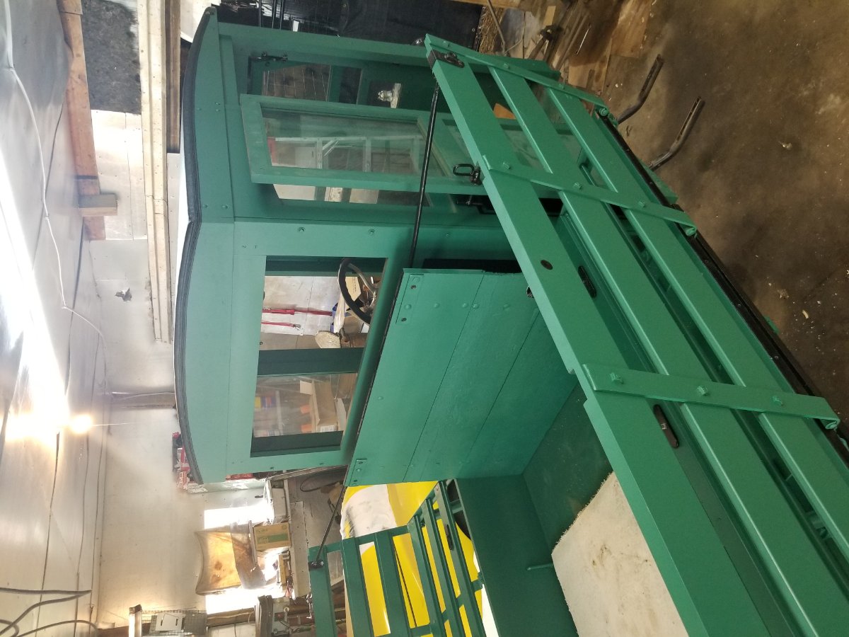

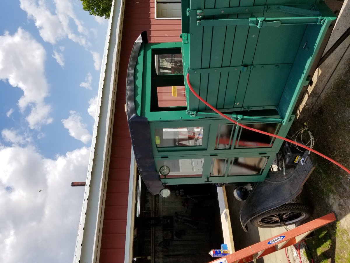

Finally! Some young fellas are coming over tomorrow night to help put the bed into my trailer. Taking it to my buddy's cabinet shop Saturday morning for primer and 1st coat of paint. Seems like forever but its a labor of love. Lots of relaxing time in the shop to get this far.
The engine swap was a break from the bed work. As much as I have enjoyed rebuilding this bed, Im not sure I would take on another like it.
I will post more photos of paint in progress.

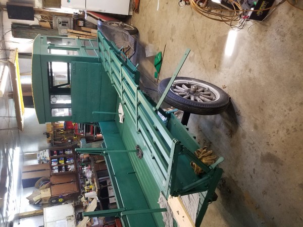

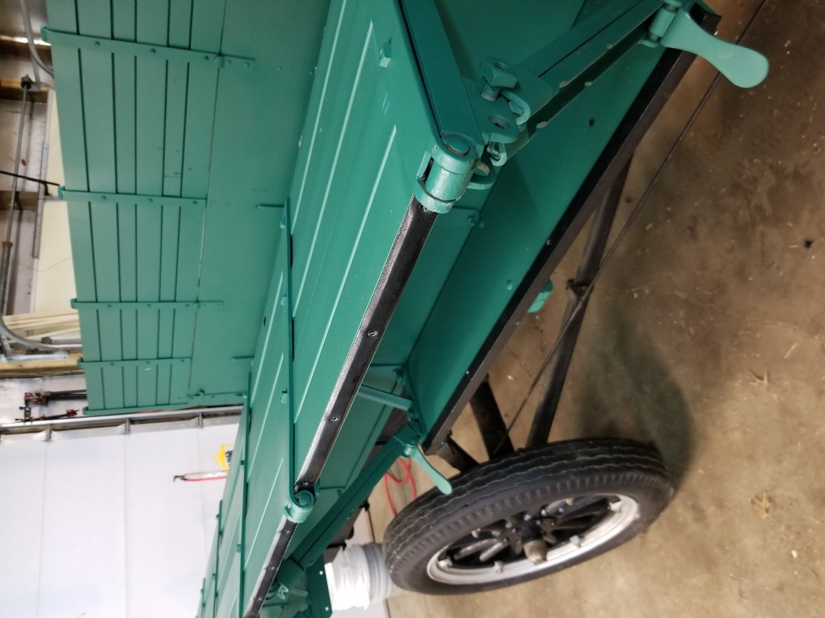

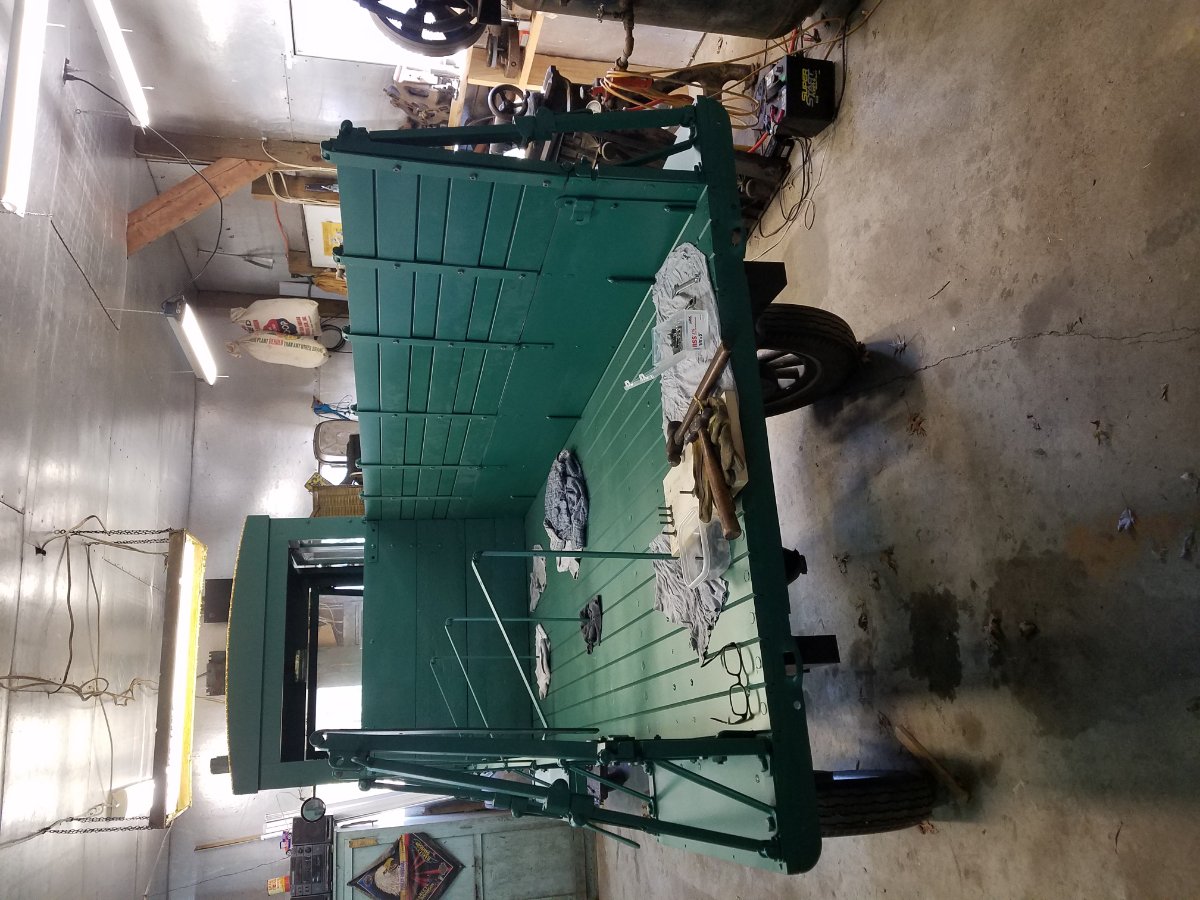

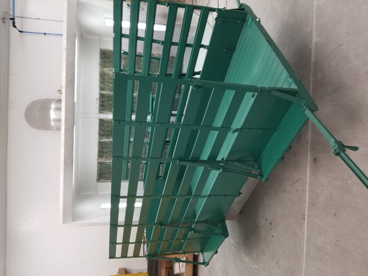

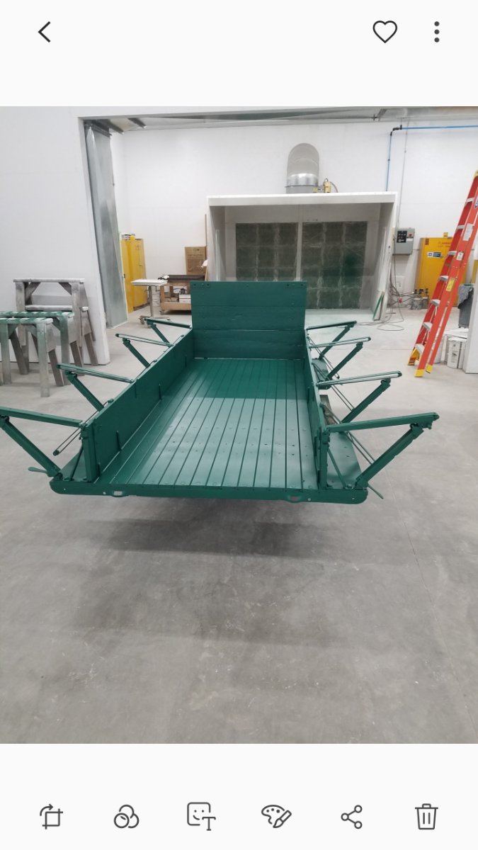

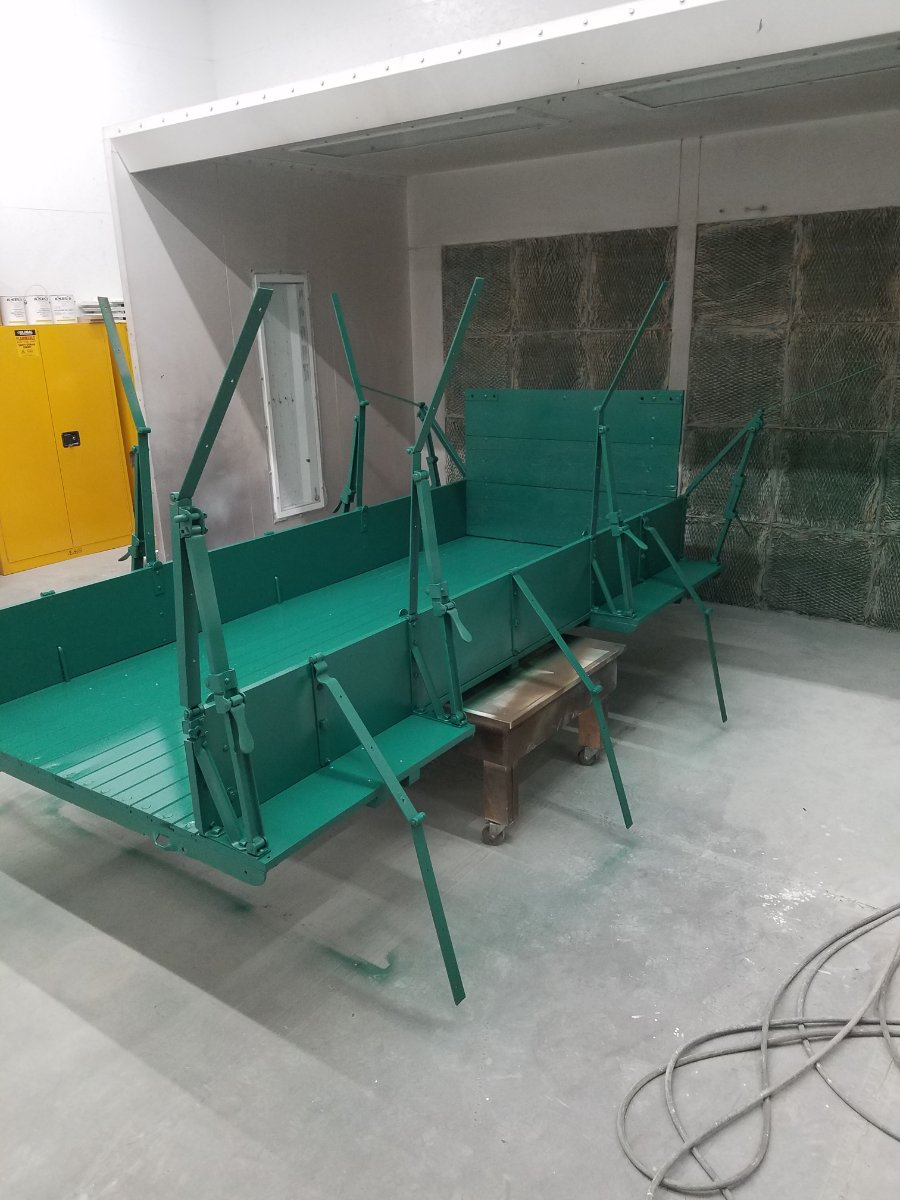

Primer on. Hope this afternoon to get paint started.

Don, I am watching your project as well. I like to see others making progress and get inspired from seeing others craftsmanship.
Burger, I think the fool part is right. I have two other wood flatbeds and another wood cab I got from Dave when I picked up the TT. After the 24 coupe is road worthy I may be fool enough to start another TT project. I have a 26 TT running chassis with a Warford.

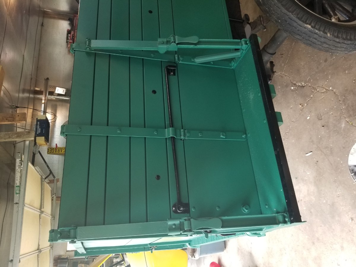

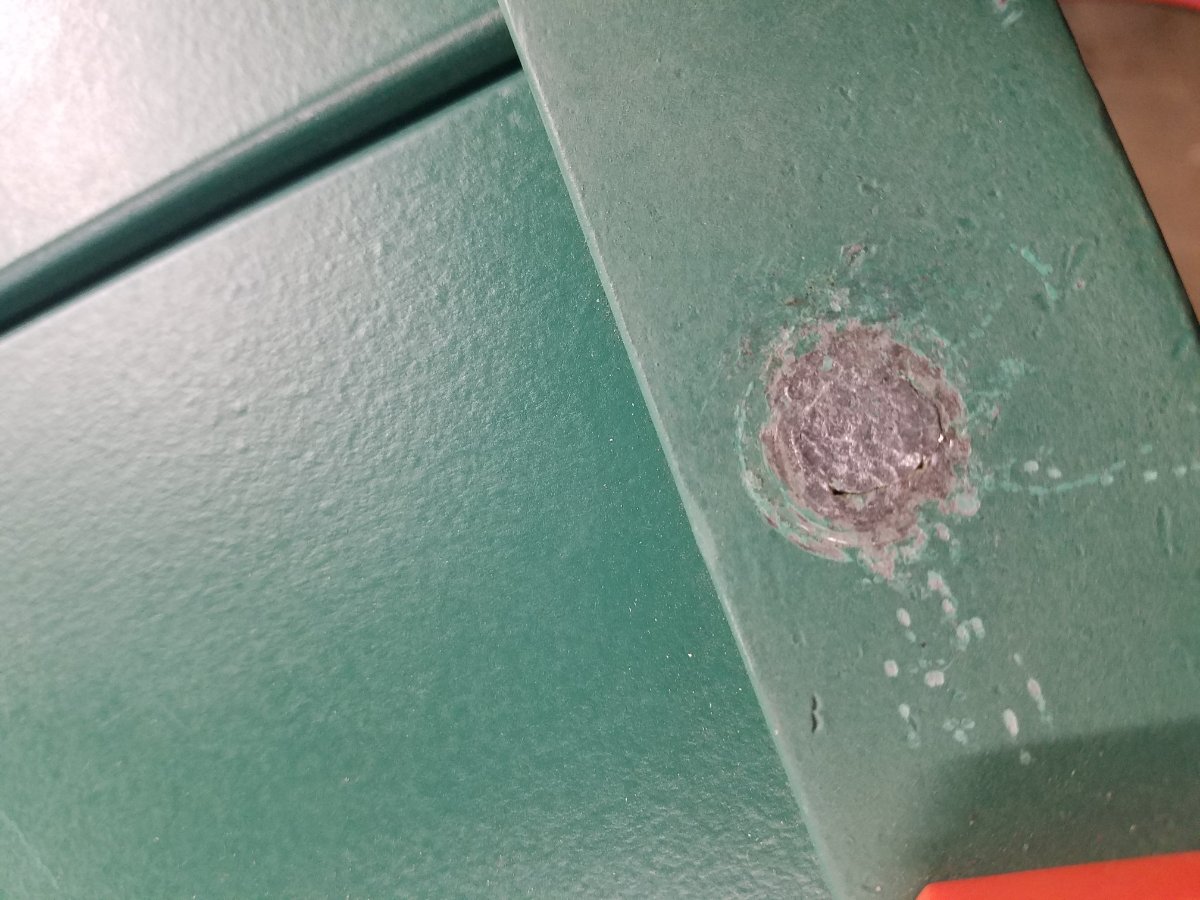

I wanted to post some photos of the paint on it today but its not drying. Tomorrow I will flip the side boards that are on the rack in the one photo and prime them in the morning. Paint will have to wait till next weekend. Monday its back to my real job.

Re: 8in1 American Convertible Motor Truck Body " restoration"
Yesterday after work I sanded bed and other parts for paint. Today after work I started painting 1st coat. Tomorrow morning I can set it down and finish. Next weekend I hope to get it home and put it all together for final paint.
It is a wild looking creature!
After the all nighter, I went straight to the shop and finished 1st coat.
Dave I used a little over 1/2 gallon on the MP cab. Looks like its going to take about 3/4 gallon on the bed. Using top feed hvlp gun. A few pics for those watching. Color will darken like cab when dry. I will bring it home next weekend.

A good coat of primer is a must. I am using a oil base primer and paint called Rust Scat. It is good on wood or metal. Sherwin Williams if I remember right. Its basically a house paint only it cost more. Not bad compared to auto paint. $57 per gallon for paint. It will get another coat of paint when I get it all together. Should go together fast as I number stamped all the side boards so the go in the same place they were drilled for. In an unseen place of course. Being hand made the holes in the hinged parts are not exact spacing.Yes I hope it lasts at least another hundred years. It will never live outside as long as its in my care. I bet it will out last me.

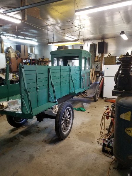

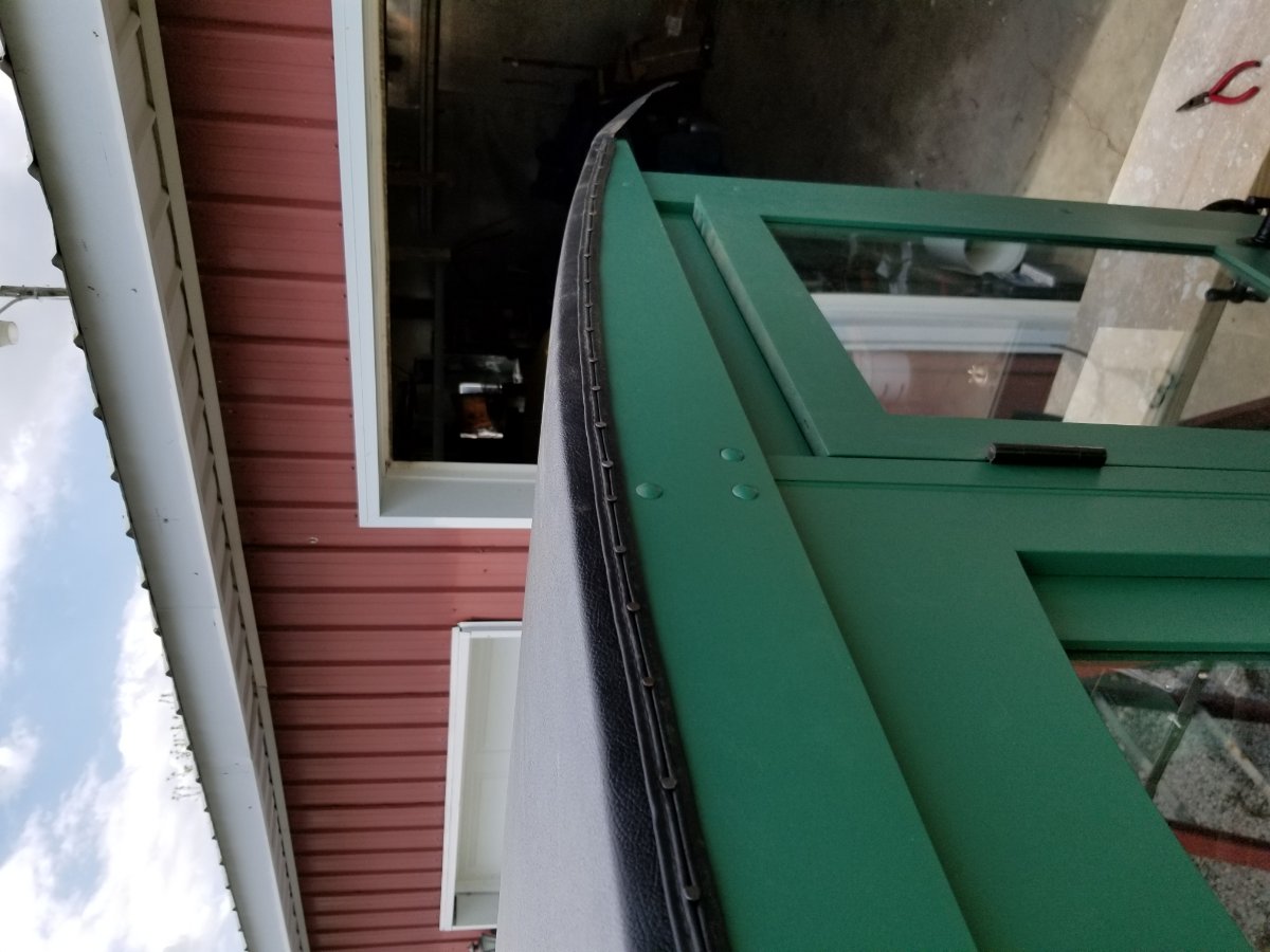

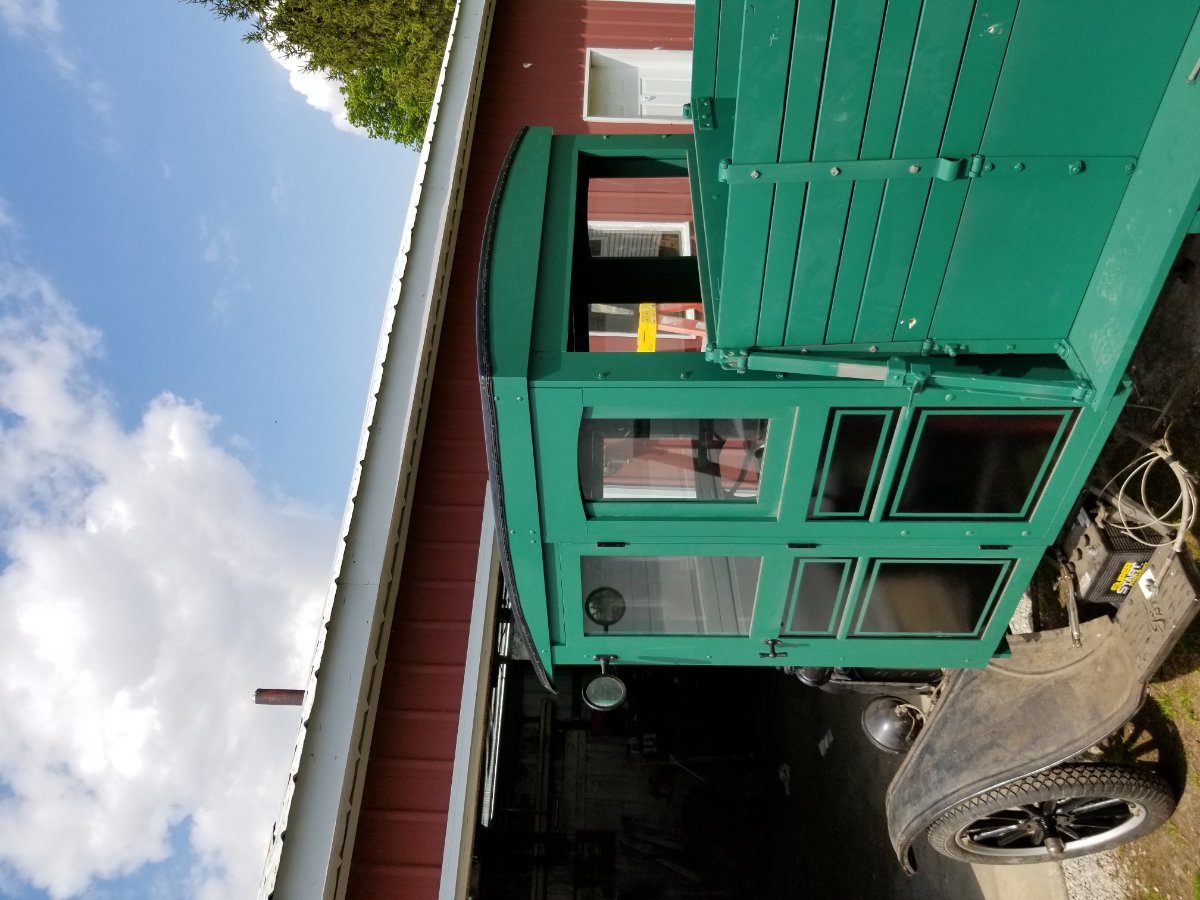

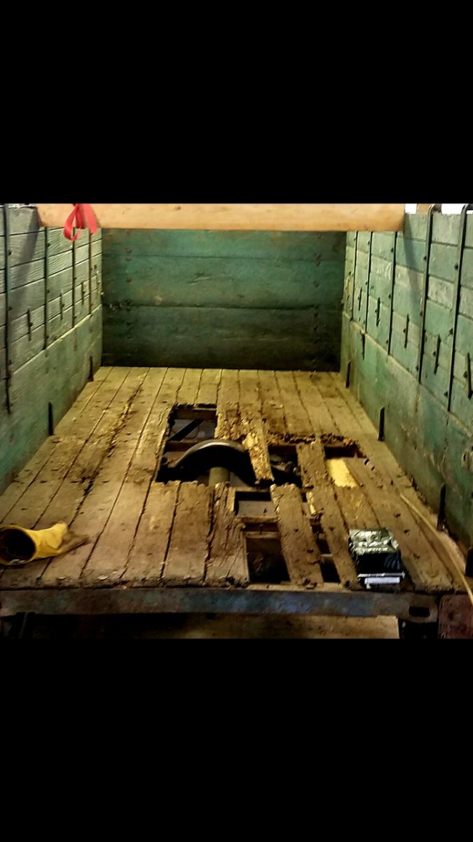

Here is before and after shot.

Something to be proud of Dallas! Looks Awesome!

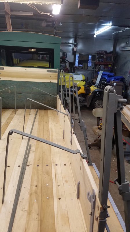

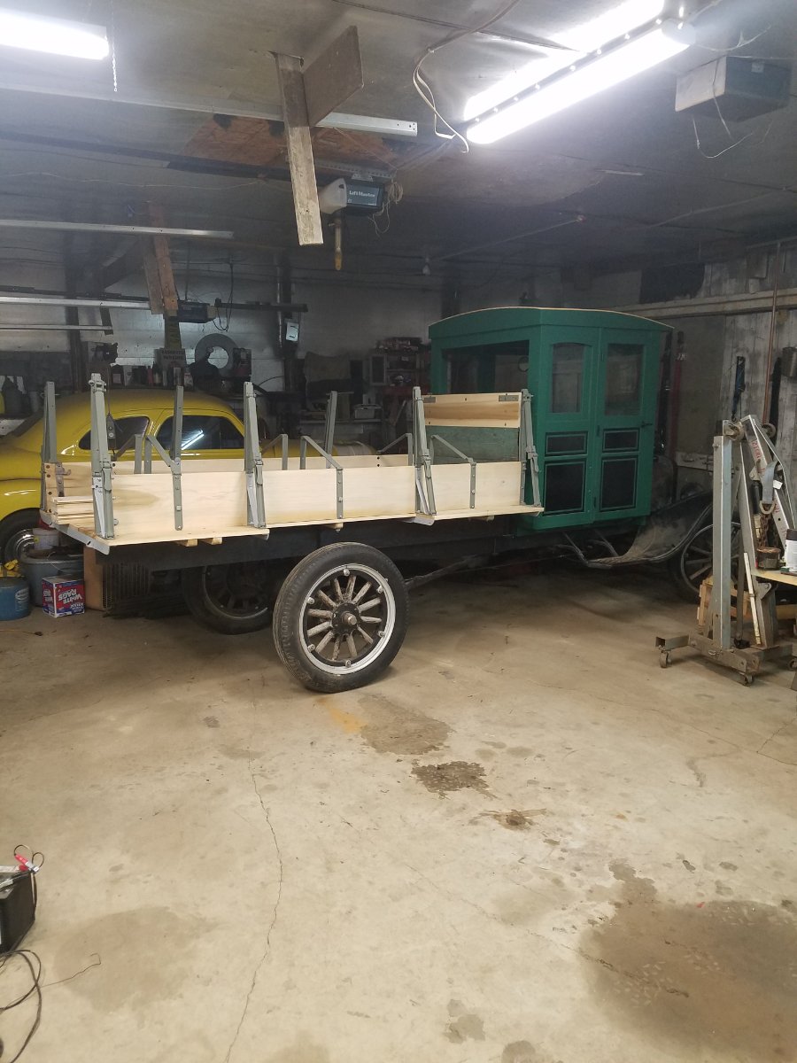

Well I had to stop work for today! I finished modification to the bolt heads and cut to lenght.The shop forman forgot to tell the purchase agent that I was almost out of the correct 1/4 - 20 square nuts for this project. I was so upset, I sent all three in the house for the rest of today!
We are sitting in my chair watching TV now.

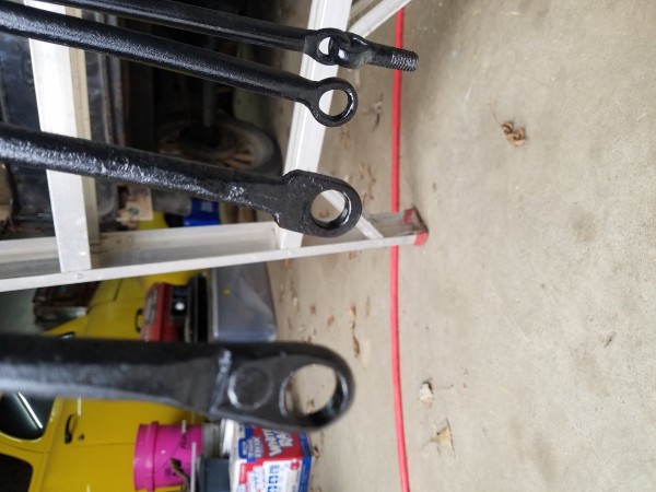

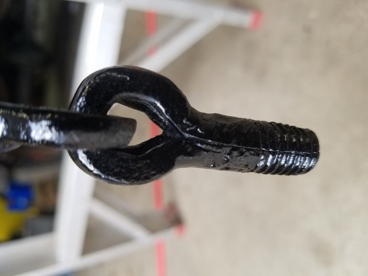

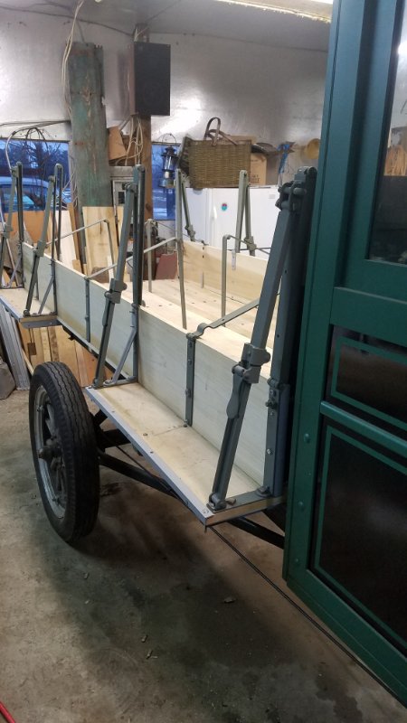

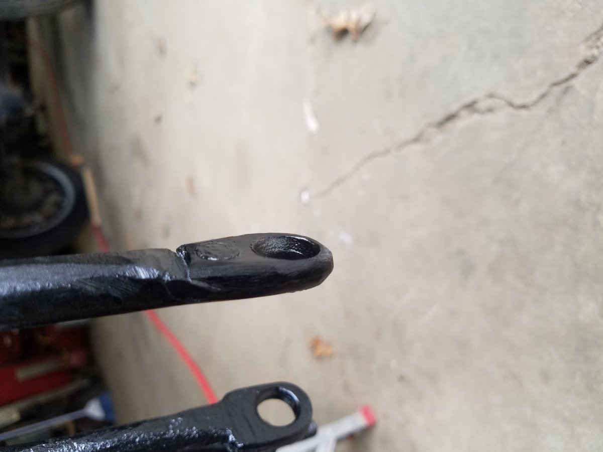

I found some interesting thing on the 8in1. The rods that hold the sides in place are all different. There are 4 of them. The way they attatch to the bed is different also. Now these rods have to be the same length or the sides will be crooked when it if folded out. I think one is original but with nothing to compare it to Im not sure. I just painted all that hardware but will get photos posted.
RustyFords
- Posts: 1559
- First Name: Don
- Last Name: Allen
- Location: Houston, TX
Interesting. Are these rods things that would've seen heavy usage...and therefore became worn out or broken over time?
1924 Touring

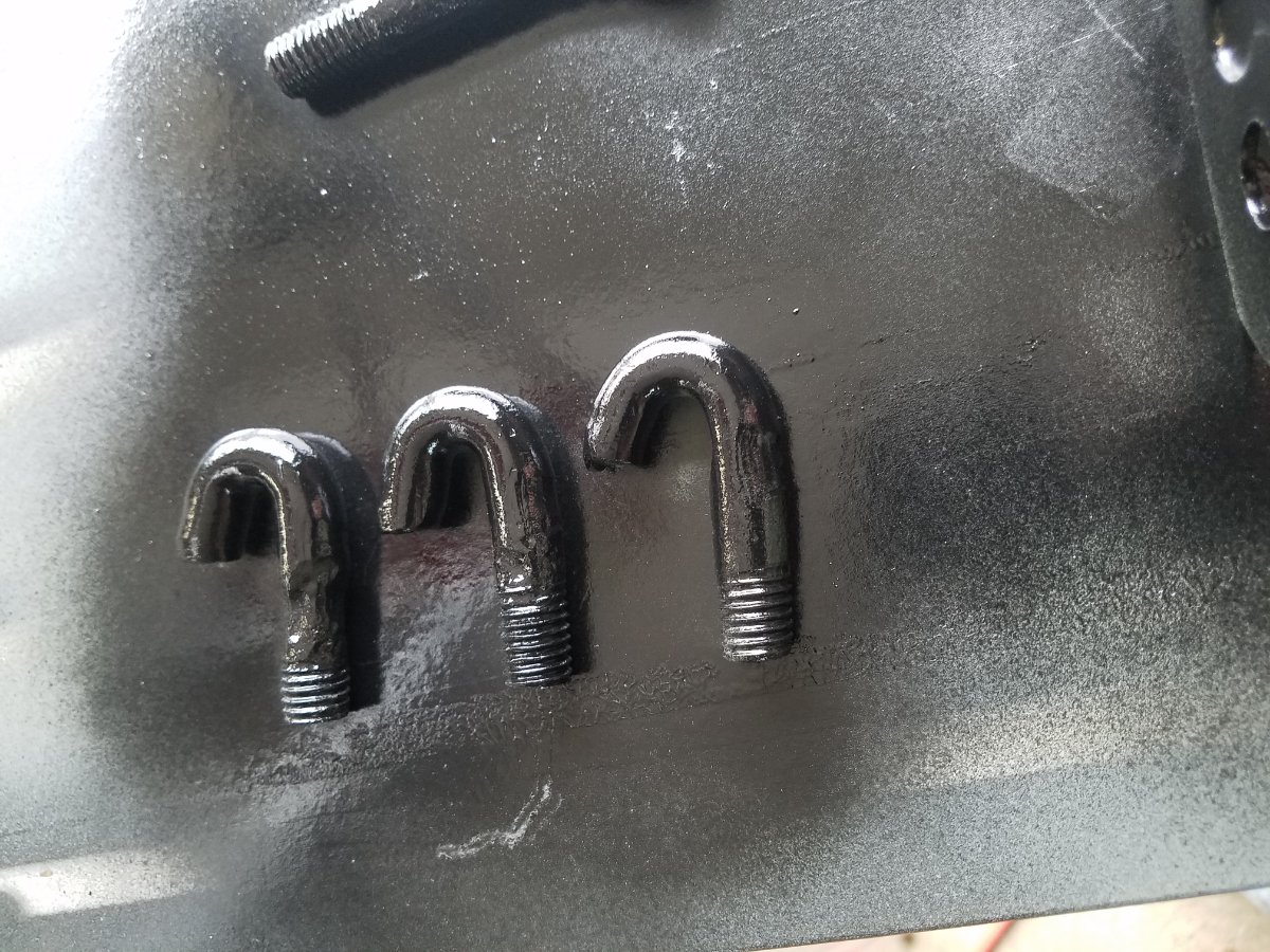

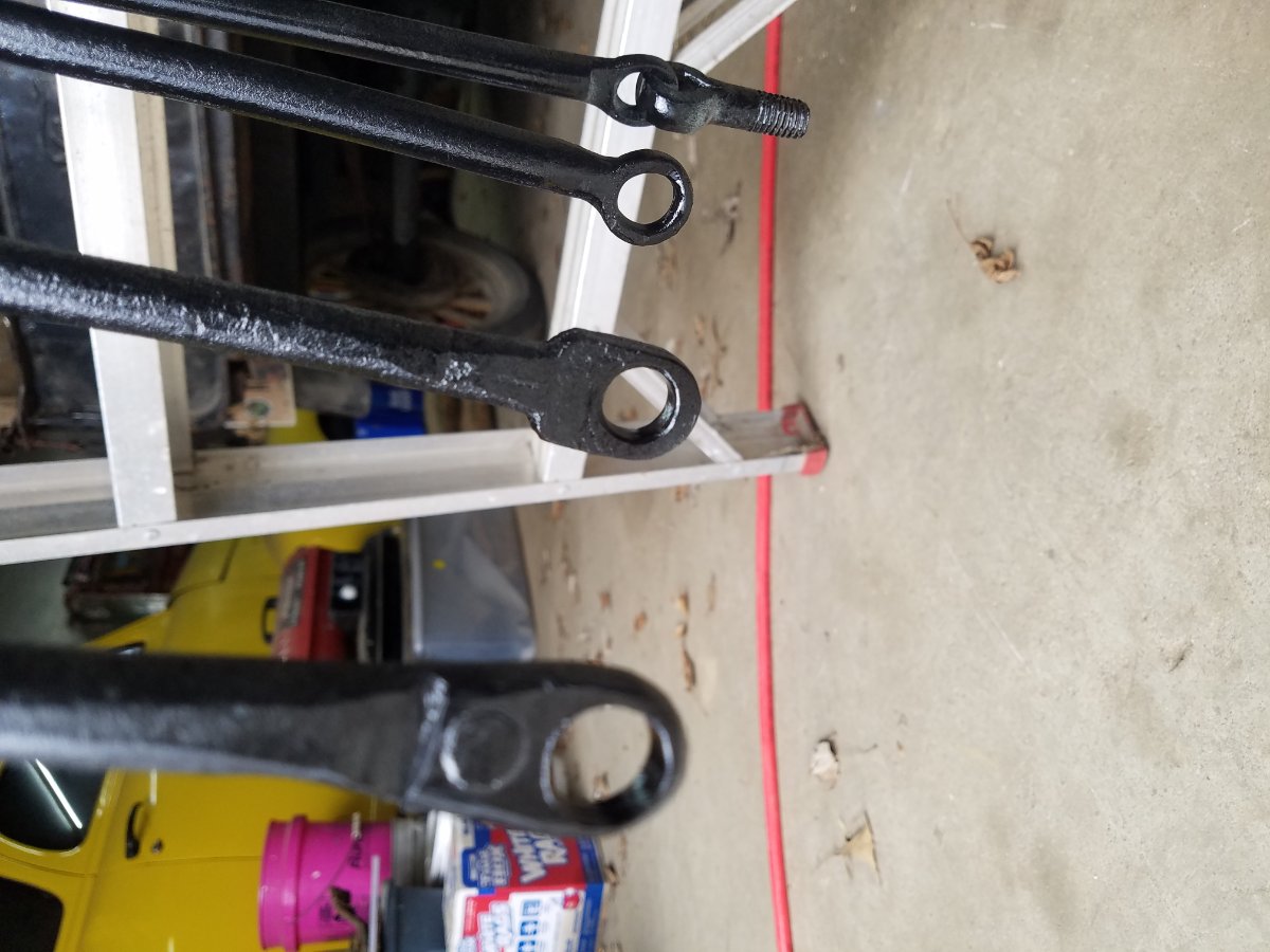

Topic author - Posts: 2842
- First Name: Dallas
- Last Name: Landers
- Location: N.E. Indiana

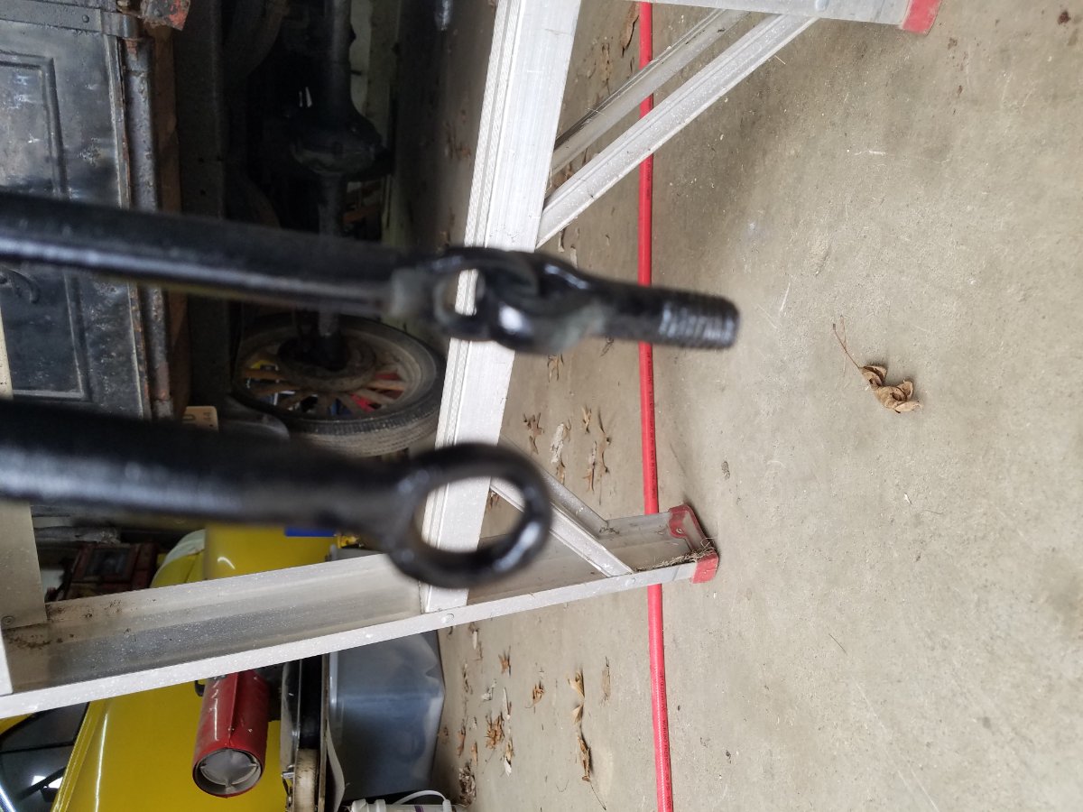

I thought this was interesting. This eye bolt is flat stock folded over and hammered round and is split like a cottoer pin and threaded.
You can see the four different ends on these support rods.
These two are close but not the same.
These two are close to the same. Both hammered and folded but they added a rivet to one.
I think during a hard life this were some of the repairs done to keep it going. I can almost smell the smoke from the forge that these parts were made on and hear the ring of the hammer. I can see where it was filed and cleaned up. These take the place of the eye bolt in the photo above along with another metal piece. Not sure which is original and dont really care as it adds to its charm. Just keeps me thinking about how they made that part and how it broke. I have had to straighten many things on this bed from its former life of hard work. I will use this bed as it is a truck but it will have a much easier life now.
Don, these rods support the side racks when they are folded out or upright. I think what probably broke is the eye on the end of the rod. It is pretty thin. The rod is 1/2 inch round so pleanty heavy.
I think back then without a welder, forging a new one was all that could be done. Unless you ordered a part and waited to finish your work while waiting on it to arrive.

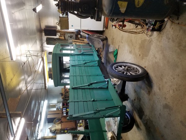

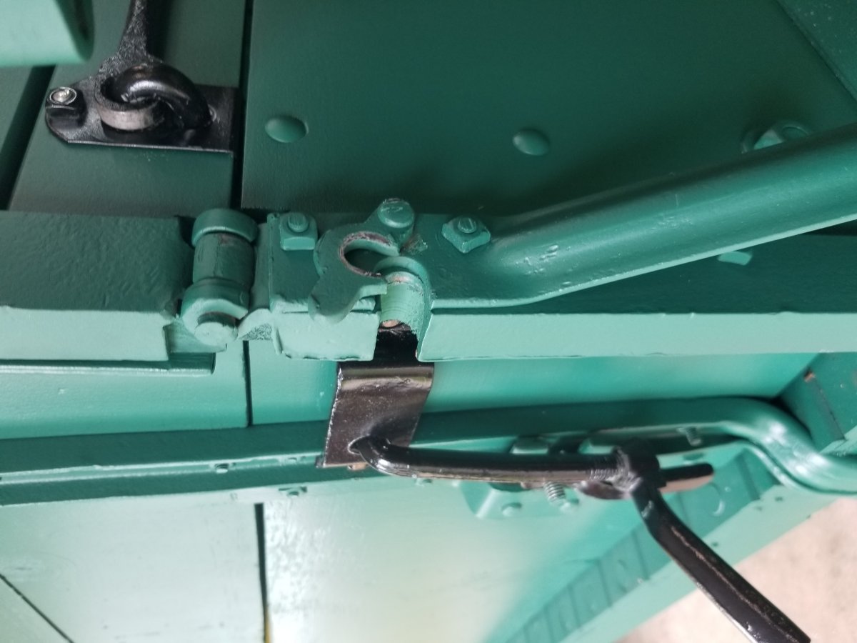

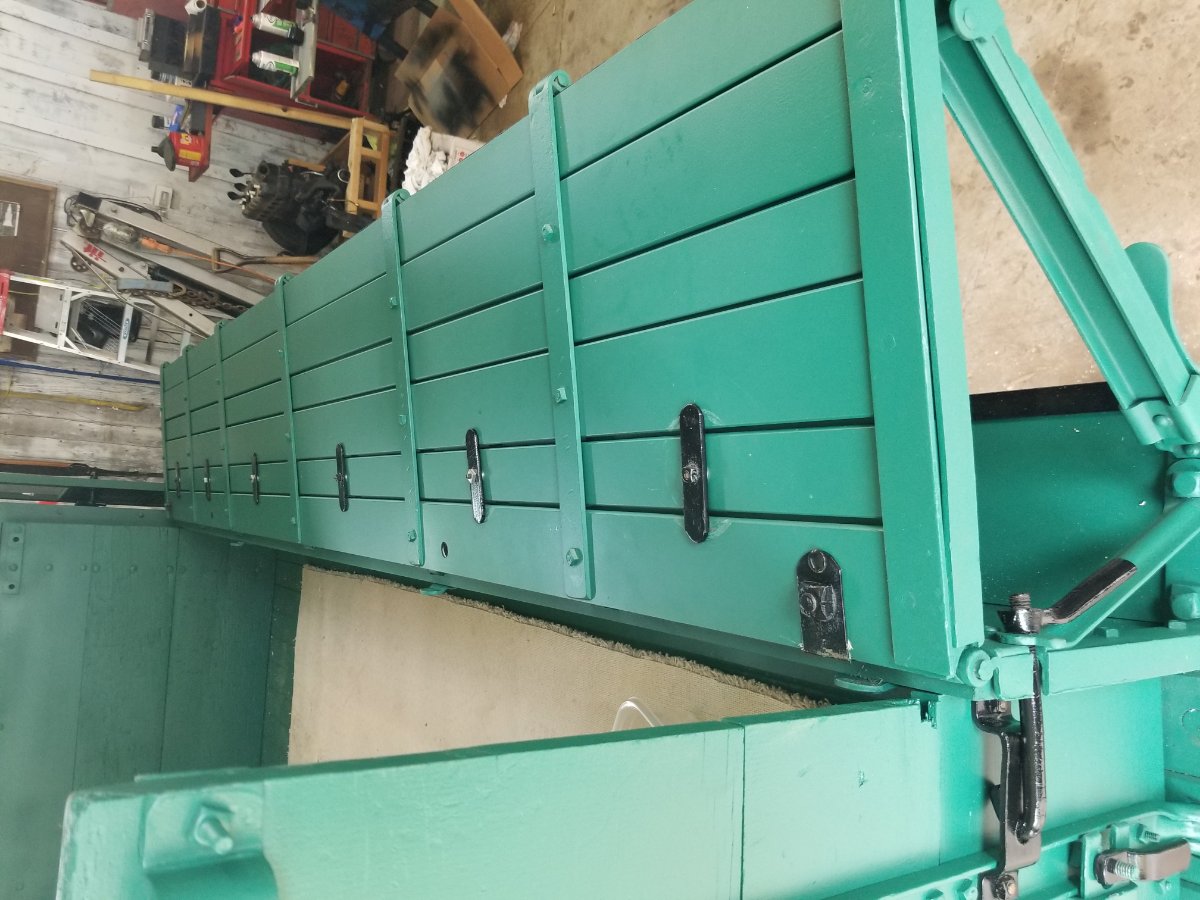

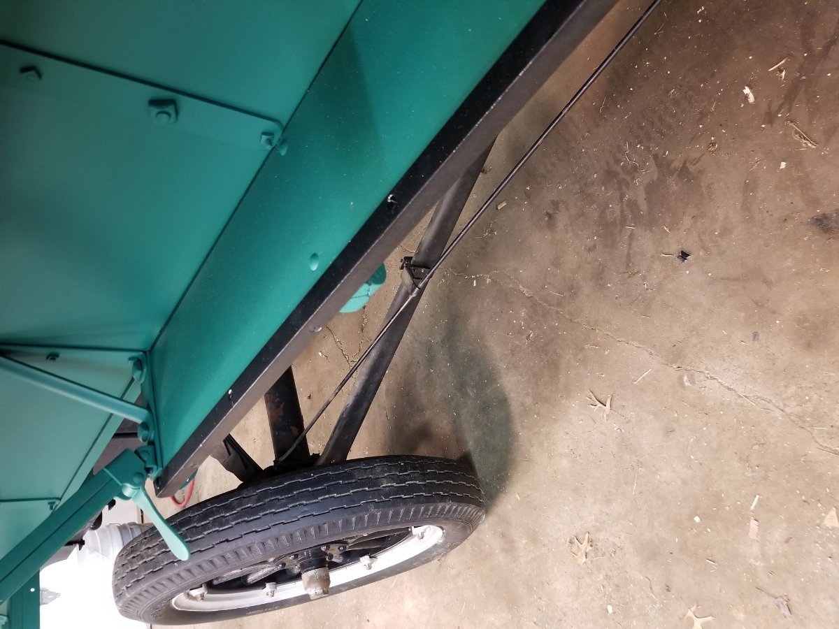

Well today the bed has two sides again!!! Here is a fact that I did not realize untill today. All the bolt heads I modified for the bed sides are totally hidded when the bed is in this configuration.
Inside
Outside
When unfolded they will be seen so it was worth it.

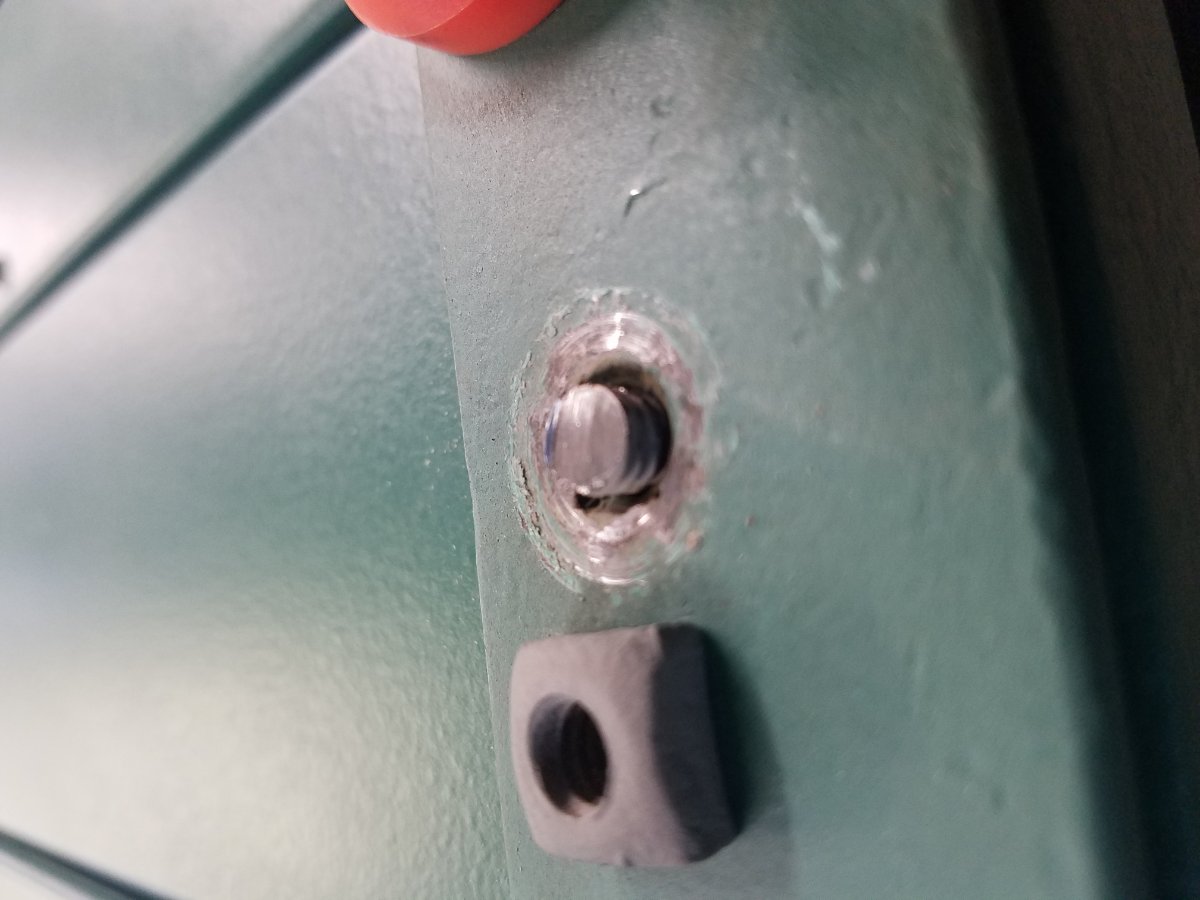

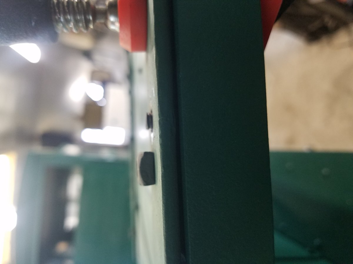

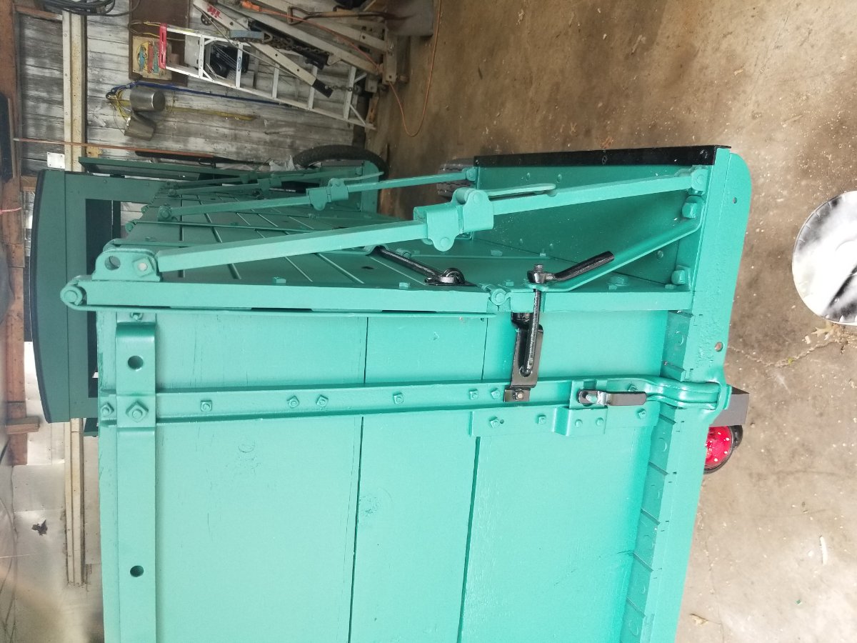

Also today I came to a job that I was not looking forward to because I had never done it before. I asked here a while back about how to rivet the boards to the rear for the tailgate to slide in. No room for a nut and the original bolt was peened into a rivet. Once again the knowledge from the masses here explained the process in detail.
1st I cut the bolt off with a die grinder and took a guess at how much to leave for peening.
You can see the dished area oround the bolt to fill .
Then anealed the end. Heated the top 1/4 inch to a dark red.
Then after clamping with the angle from the bed side as a bucking bar I began to hammer in a circle with a ball peen hammer. Round and round I go. Not to hard as it was explained to me.
You can see the progress
Finally flush. Guess the final photo has to go in the next post

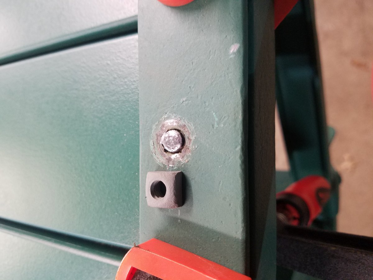

Got a little lost in the photos and doble posted one but here is final product
Flush
Maybe wont hold up the Brooklin bridge but it should hold the boards on the back of this old rig.

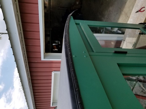

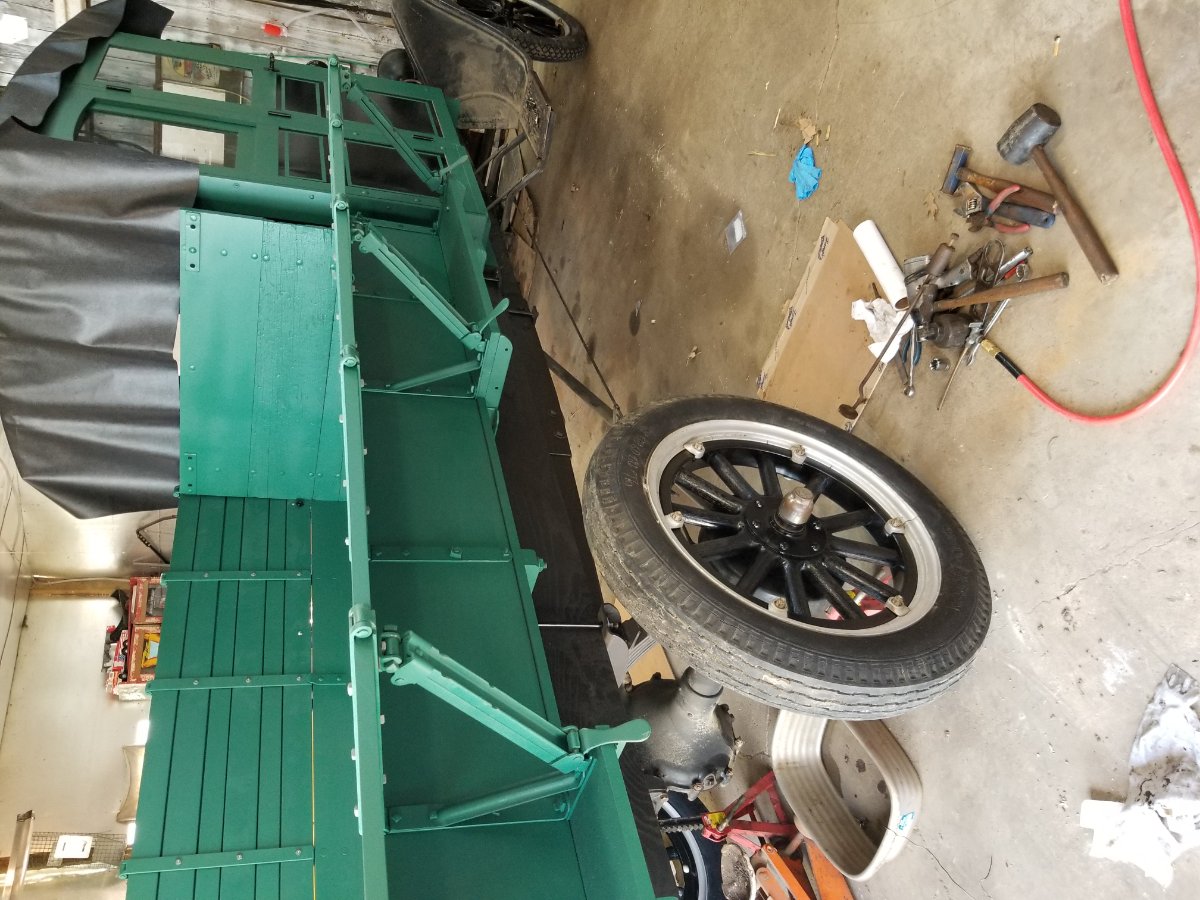

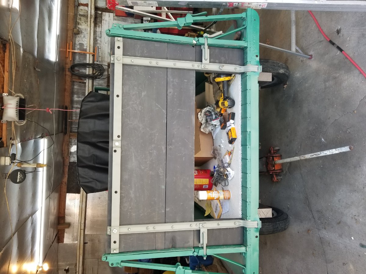

Test fitting some metal bits before final paint.

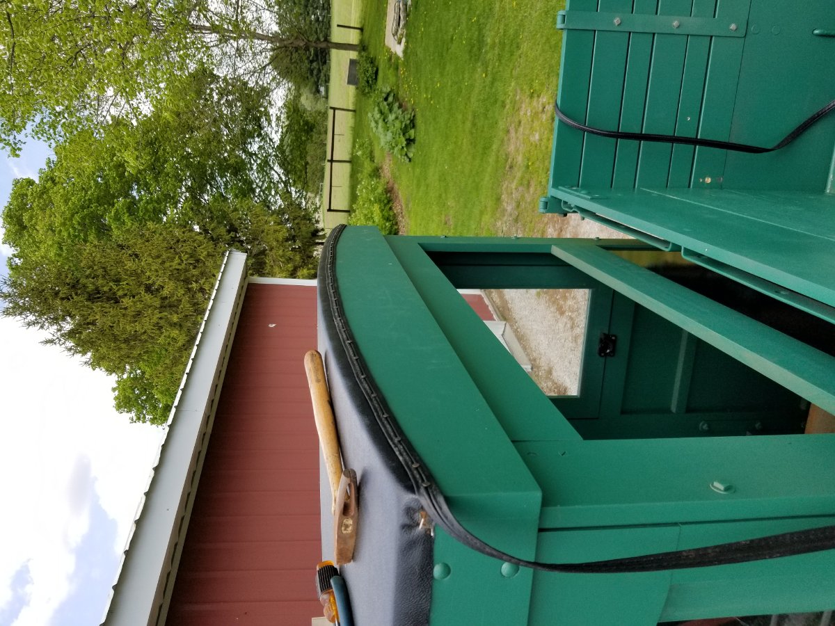

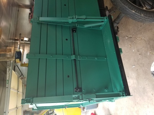

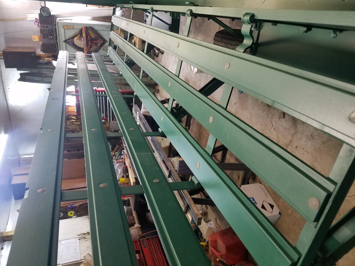

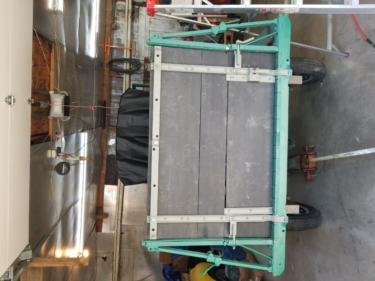

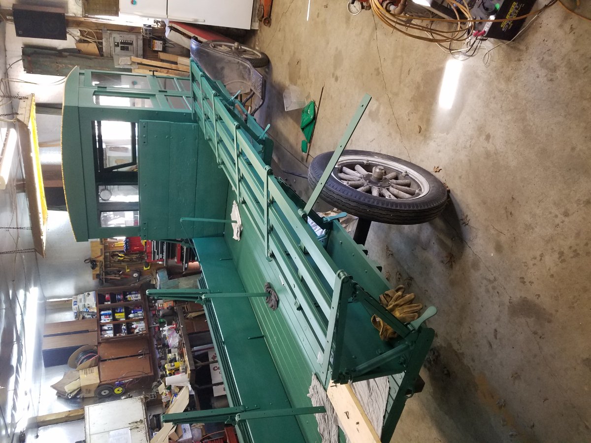

Now that the wheels are done I got to work on the final piece for this bed. The tailgate is apart and 2 new boards are made. A couple hours with the blast cabinet and all the metal bits will be ready for primer.
Front
Rear

I have friends coming thursday evening to help load the 8in1 into my trailer. I am painting it in a buddys booth friday after work. Final paint!!!!
I have the tailgate ready for paint. Withe grain door.
Without grain door.
Im fussing with a latch nut for driver side as it was MIA.
Without grain door.

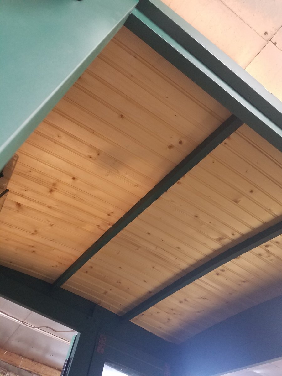

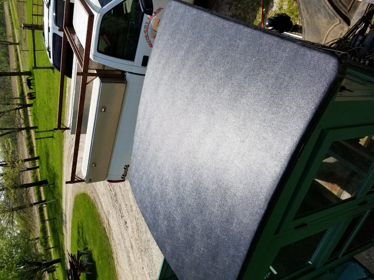

Well today was great! 72 and sunny. Not much wind so I put a top on.
I didnt take a photo of pad but the 1/4 " pad Tim Morsher sent me worked great. Top material tacked on.
I used air stapler to set it and tach it about 3 inches apart and didnt stretch too much so the nice edge on foam would stay as a straight corner.
I ran a piece of 1 inch tape as to have a nice straight edge and an even reveal for hidem welt.
After finishing corners I installed the hidem with nails about 2 inches apart. I will set nails later when Im sure I like everything.
A nice arch on sides and rear. Thats where the tape was worth the time.
Maxed out photos I guess.[attachment=1]20190515_154440.jpg[/attachment]
[attachment=0]20190515_154920.jpg[/attachment]
Not bad for a beginner?
I have some metal bands that wrap around the front of top for MP cab. I need to make new ones as I only have one and its in poor shape. I can finish the front and install those when time permits.
Danial, Langs has it all. You can buy the material by the foot.

Thanks Richard, it took alot less time than my roadster top. I set all the nail last evening and will post a photo later. I am short 2 end caps for the hidem on the front of the cab or it would be complete. I have the bed loaded in the trailer and will be painting final coat at my buddys shop tonight. Its all coming together. Its been a two year project to get this far.

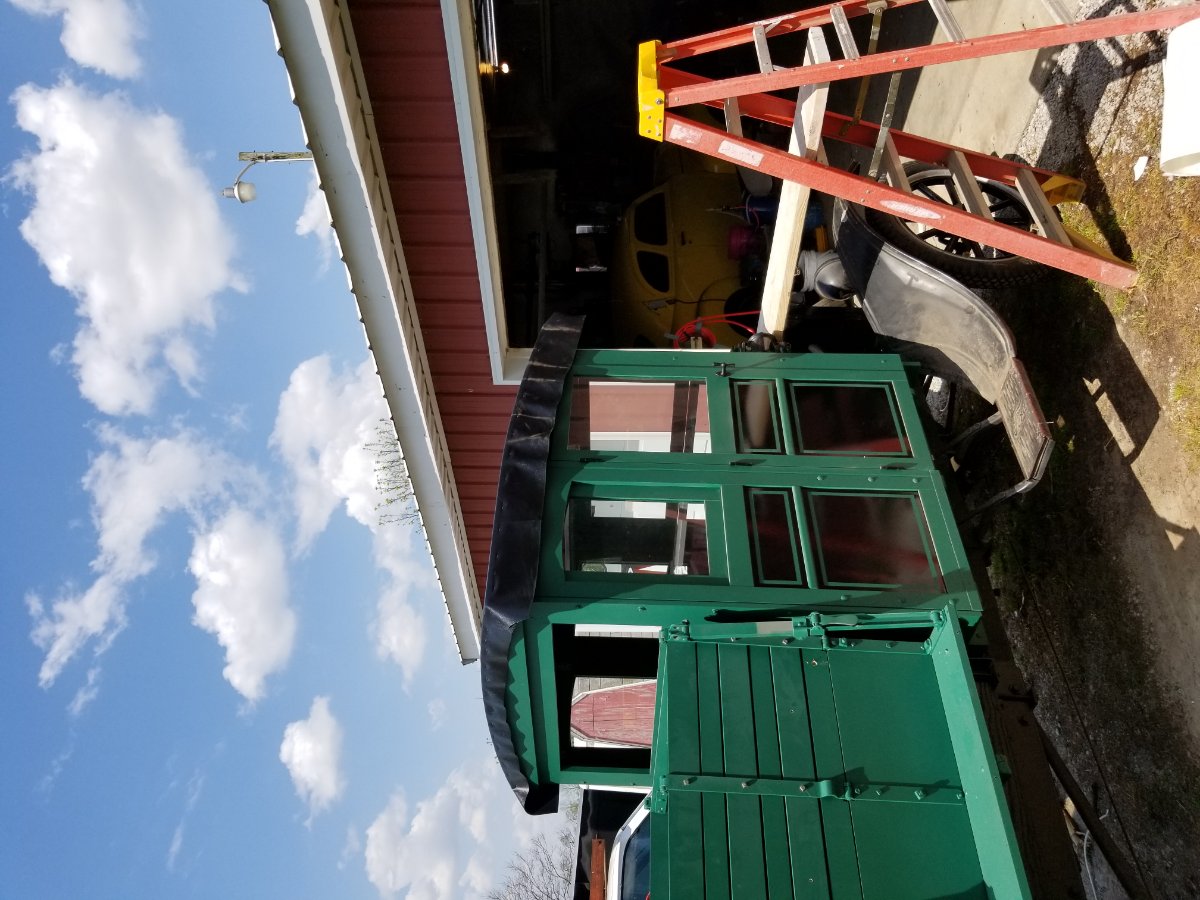

FINAL PAINT!!!!!!!
Tailgate hanging

Installing more metal bits on the bed. Lots of wood screws here. The metal strips that protect the top boards have 23 little screws in each side. One on the front and the rear wraps the tailgate.
The angle iron on the flat area fore and aft the fender is a combo of screws and carriage bolts. As they say " they dont make em like this anymore"
A few photos of bed and how it works
Rods in closed bed style
Locks to keep sides closed. 1/4 turn to unlock.
Folded out with support rods in place and cotter puns to keep in place
Tailgate latches
Latched closed
Unlatched
Unlatched
