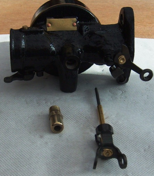

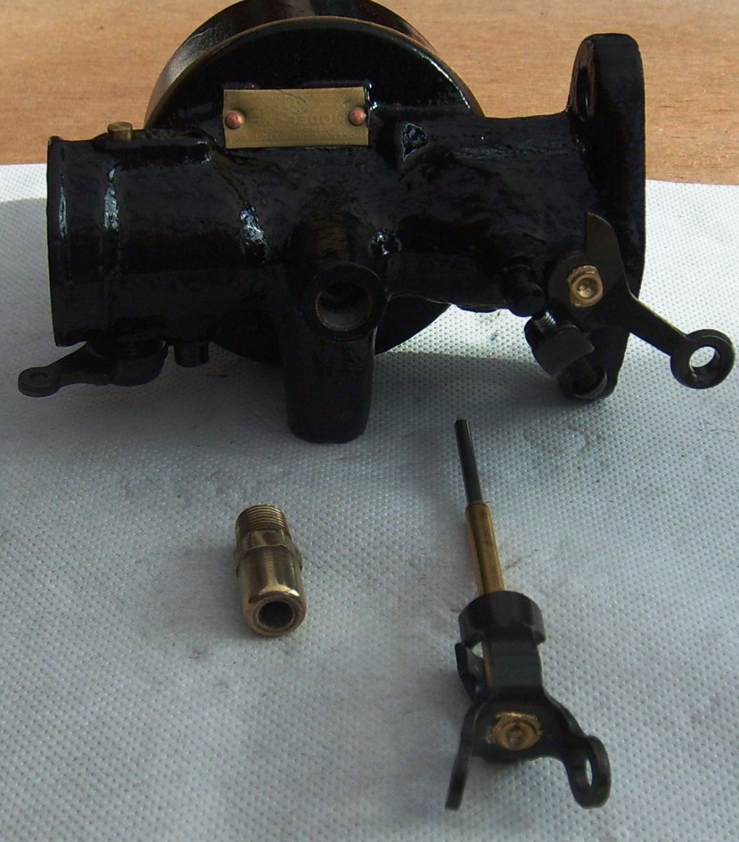

Sure, but you need to swap over both the needle & adjusting needle clamp.

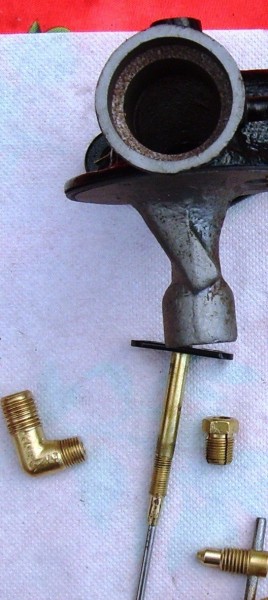

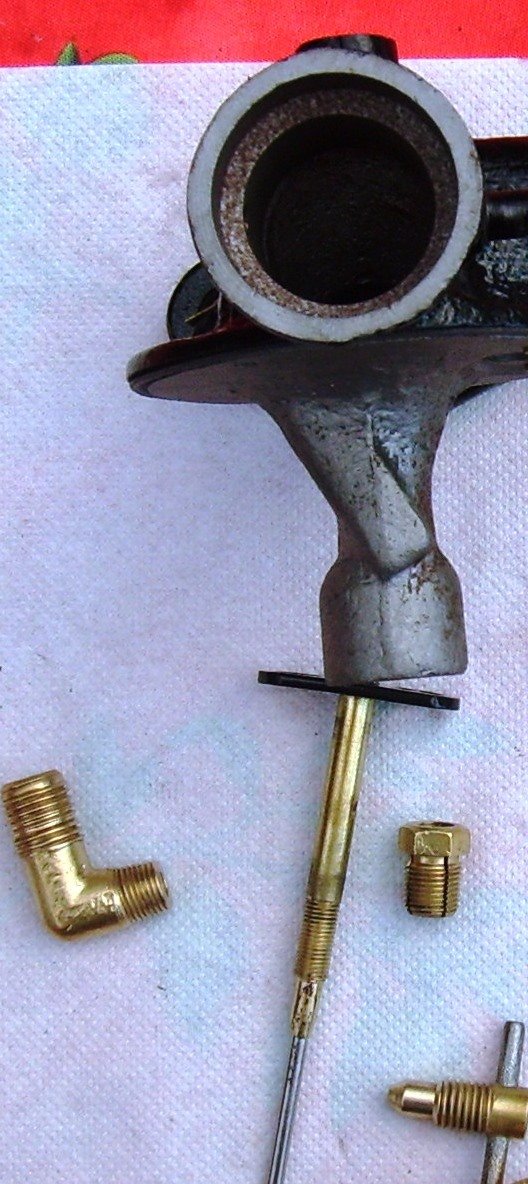

What you need to change are this.
Not the elbow but the needles and clamps.
Good luck
