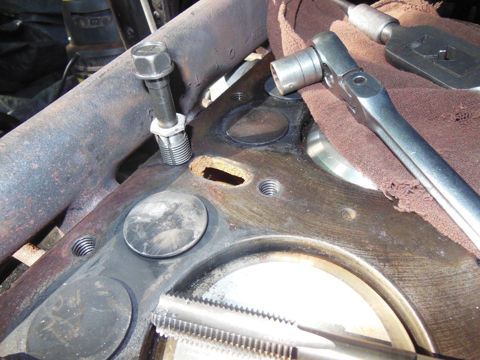

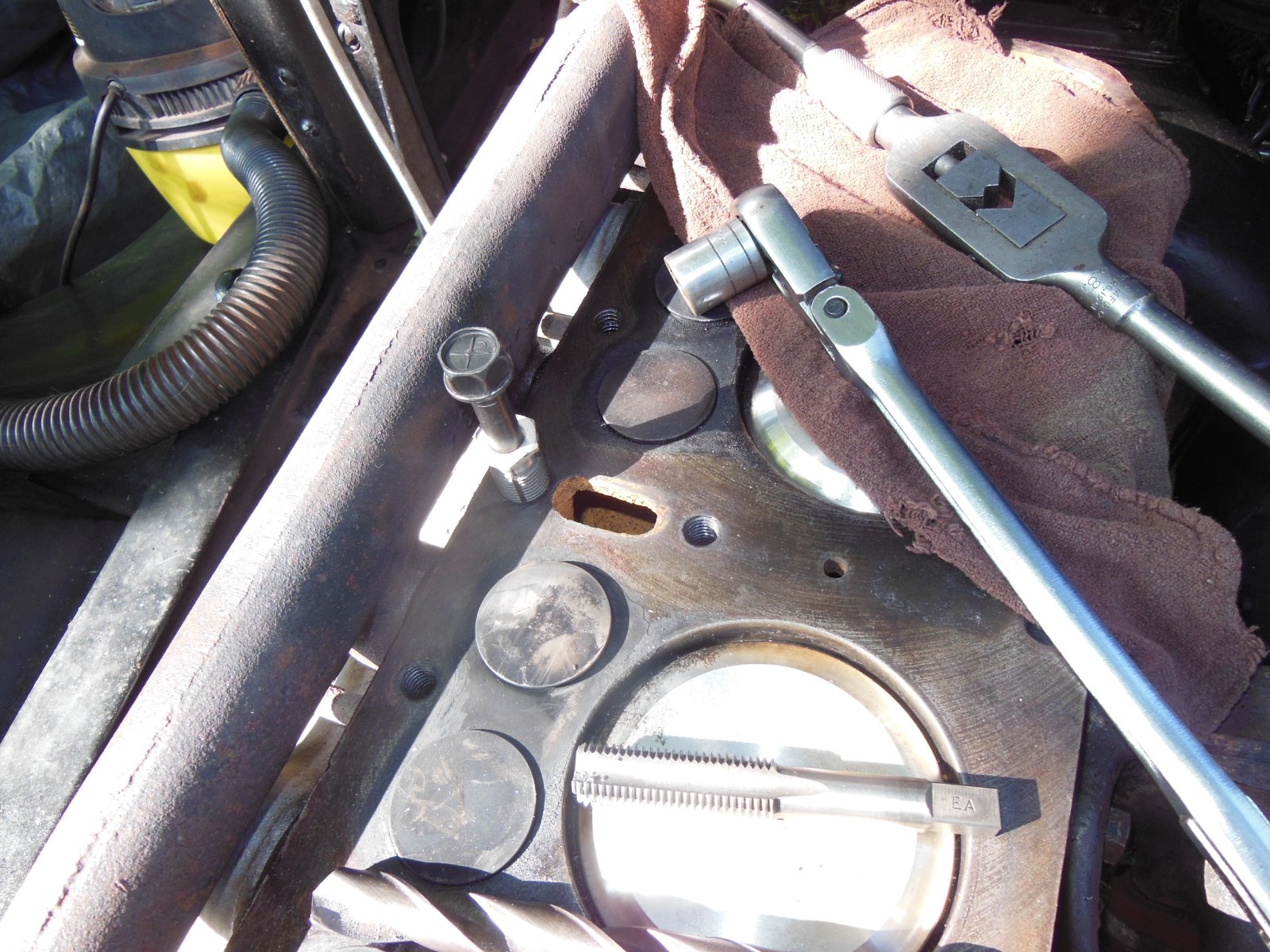

Went to torque @50lb the headbolts on my 26 today and the rear center bolt pulled out. Had used a torque wrench on all the others and used a ford sparkplug wrench on this one cause it was under the dash. I compared that bolt with an original and the repop was about 1/8" shorter. I was lucky and had some long v8 studs that were 1/4" longer, turned the large part down and screwed in in after pushing the firewall back a little. I tightened it very carefully and it held. bottom line is check those pretty repop domed bolts for length!

or check the block for good threads.

Jim is right on with his warning. Did a short block for someone and he installed new dome bolts with a Z head . Stripped out bolt holes in block. Bolts were short like Jim says. Dan

For the record: Block was just cleaned in the machine shop. Head was Z. Had had this engine down many times over the years with the same combination. None of bolts tightened with torque wrench failed. Bolt that failed was rear one on a 27 and was against the firewall where a torque wrench would not fit and was tightened with a ford spark plug wrench.

The reproduction bolts are or were short. My customer’s problem was two fold, bolts were short and his AL head was about .100 thicker than any other Al head in my shop, one head was brand new. This lead to a major problem.
Also, in Lang,s catalog, I think it says NOT to use these bolts with an AL head. And only tighten to 45 ft lb.

With the head and gasket setting on the block, drop a bolt in the hole and there should be a minimum of 6/10 of a inch of bolt shaft above the head. That will equate to a thread engagement of about 8 and a half threads. And to compound the situation your dealing with 100 year old cast and possibly under size diameter bolts. If the bolts are 1/8 short you lose a fraction over a full thread of engagement. I’ve run in to this before and it sucks.

Z head fitting is somewhat of a gamble due to a number of things. The bolt length problem arises because of inconsistencies in the actual height of the head, the use of a washer under the bolt head, and now slightly shorter bolts. All this before the head gasket is placed where it will not be in contact with the piston. Much to look out for.
I replace standard head bolts with those from a 6 cylinder GM Holden. These have an 11/16 head rather than 5/8, but their true value is in the length. With cleaned out bolt holes in the block, these bolts go almost to the bottom of the hole, for maximum thread engagement. Perhaps there is a US equivalent to these.

Just finishing a customer built motor with 15 domed nickle plated bolts in a Z head. It lost a head gasket seal with 3 striped and 4 soft torqued at 30 lbs, that's almost half of the 15. I used Keen Serts as there wasn't any good thread for the first 3/8 of an inch.
Helicoils might have work, but I didn't want to take any chances. I have used them In aluminum racing blocks with as much as 15.7 : 1 compression.
[The pictures show the KeenSert and my setup to install them on center and square to the block

Keenserts are a good product. However, if you are of the opinion that Helicoils are a risk, then you are mistaken. Helicoils are in fact, ideal for this job as they remove the least material in an area which is prone to break-through, and the head itself can and should be used as the drill pilot for location and squareness.
For those that will undoubtedly and repeatedly swear that helicoils are inferior, my experience with their use is on the Space Shuttle, guidance systems on spacecraft and satellites, and the navigation/pointing system on the M119A Howitzer. I know of no Keenserts on those products, but plenty of Helicoils...none of which have I ever seen fail. That said, I do not underestimate the abilities of a bad mechanic to ruin or mis-use a tool.
As applied to a T engine, at the very minimum, Helicoils are far stronger than the parent material cast iron in a T block.

Only problem with Keen type I have found is they make too big a hole. Sometimes the wall of T block is too thin a casting. Look into Loc N Stitch Full Torque inserts. They have blind inserts that will seal water jackets too. I have used them where a large part of insert was in water jacket and still held at double the torque valve of bolt. Not cheap, but is a new block and rebuild cheaper? Dan

Scott, Helicoils are not inferior, I had to use the KeenSert for that hole as the customer had tried to use a self tapping Insert and It pulled out because of a poor quality thread in the block. I have used Helicoils for more than 40 years on jobs for Kodak, Xerox and IBM and never had a reject. Yes KeenSerts are expensive but they have there place. I tend to use Helicoils If I can to save a torn thread and when prepping very high compression race engines and to save the customer money as KeenSert's are expensive and time consuming to Install.

End result: I bought a set of grade 8 bolts from RK which are 1/2" longer than the repop bolts. Checked depth of each hole, installed new bolts one at at time removing the repop, torqued to 45lb then to 50. Satisfactory job done.
