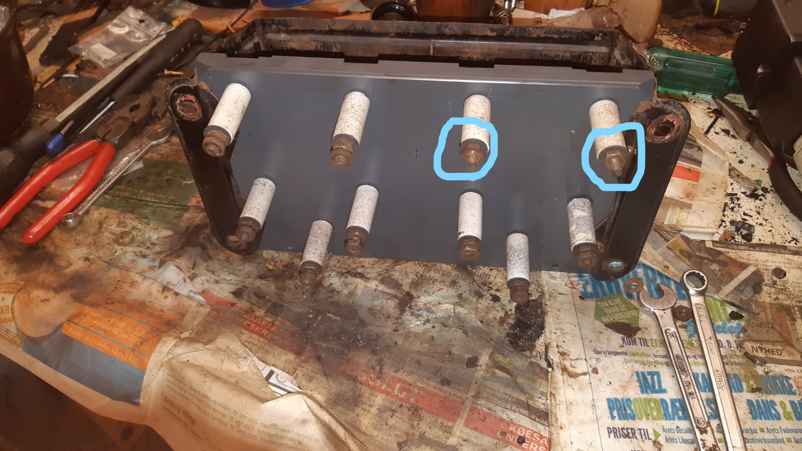

I've rebuild my coilbox and now I've found out that along the way I have lost 2 of the nuts used for mounting the cables. You can see they are missing on this picture and which it is:
What size are they? As it seems you can only buy complete sets at the vendors.

10-32
Nothing special, very common.
The originals were bigger across flats by a 16th or so
