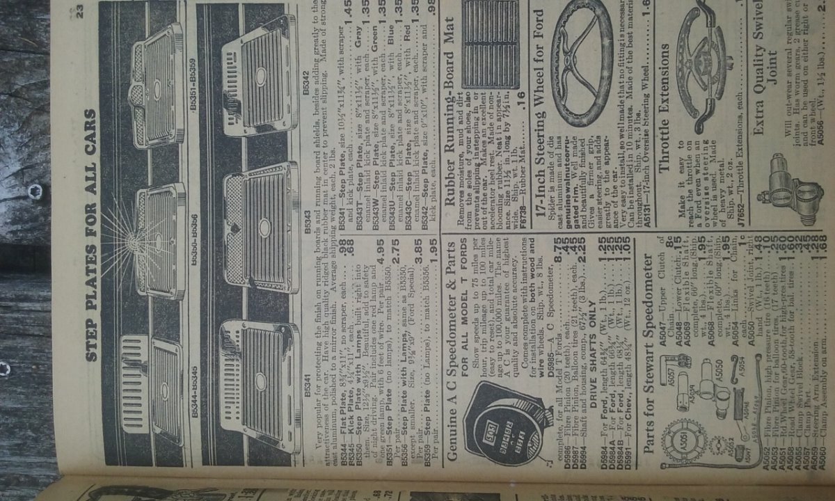

This may be what you are looking for.

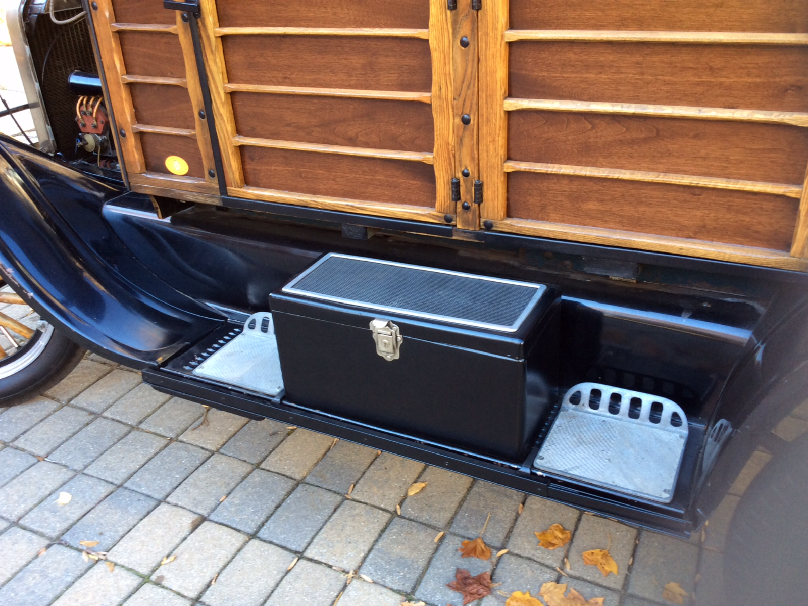

I put a tool box on my original unmolested running board, but instead of drilling four holes, I only drilled two

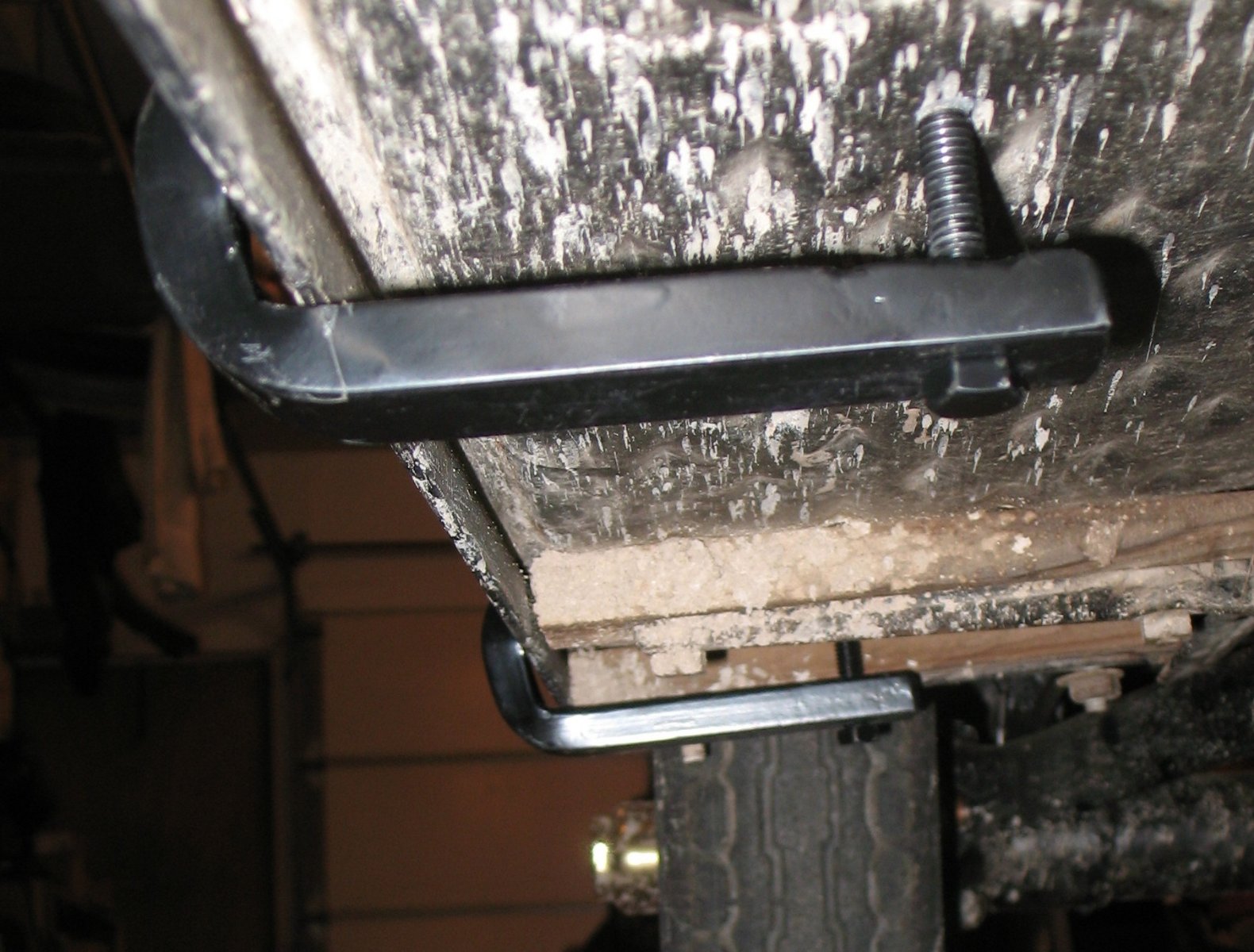

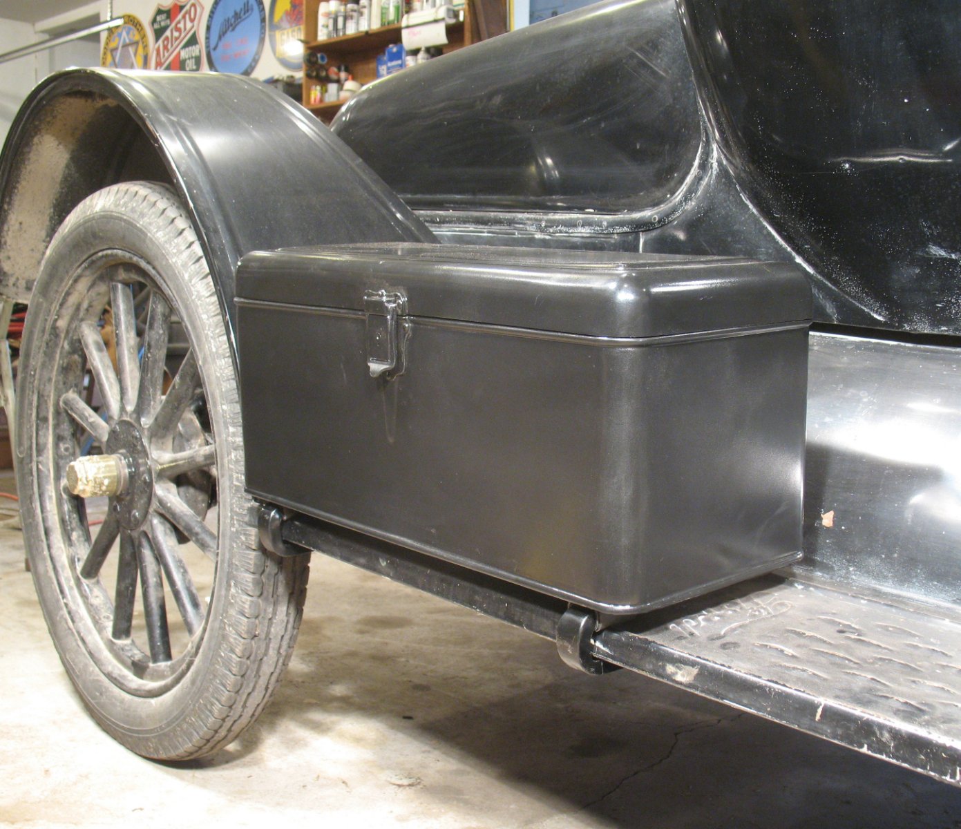

I don't drill any holes in my running boards.
I make brackets (clamps) for mounting accessories.

Post by Charlie B in N.J. » Wed Aug 14, 2019 10:57 pm
it was a tool box.
