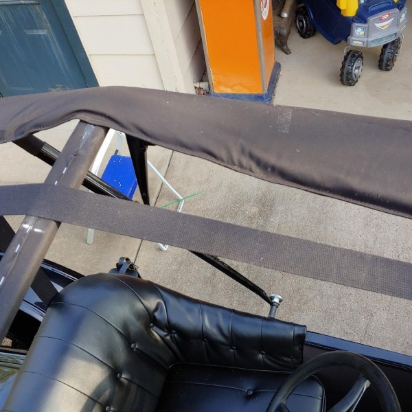

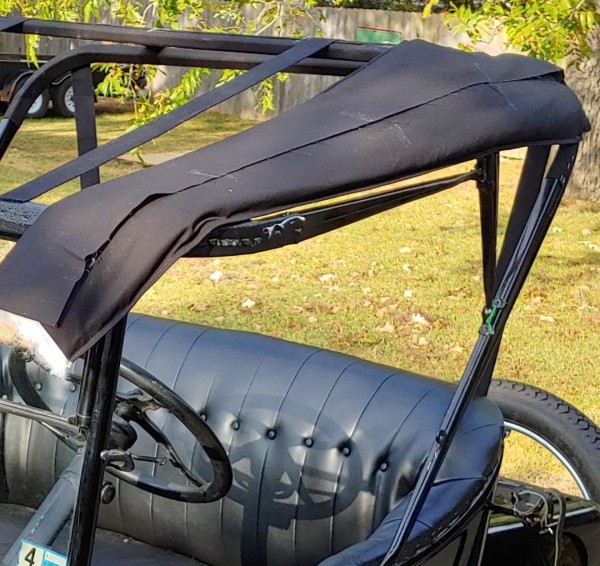

I'm installing the Classtique top kit on my '24 runabout and need the guidance of my fellow experts. Is the center strap and pad fastened to the bow or left without to facilitate folding the top down? I've been looking a videos and pictures and cannot find what I can determine one way or another. Also, for the pad installation, should it be nailed all the way through the pad or laid open and nailed through the burlap straps, or both?

Ford put a strap inside the pads, and tacked them to the bows. You really don't need to tack the center strap to the middle bow, but it will help keep it aligned. You need to have the rear bow lean out from the back panel at least an inch. You can use a plumb bob for that, or even a bolt with a hole through it. It appears you don't have enough padding in you pads. You will also need to cut a slit in the front of the top on the right and left sides to get it to look right, and then run your hidem welt over that.

I have about 2" of tilt (gap) towards the rear, so that should be adequate.
To keep the straps and pads aligned, I will go ahead and nail them to the center bow. Although the pictures don't show it, there is a good bit of padding inside the pads.
Any advice on reducing the wrinkles in the pad material, visible on the inside of the car? From what I see from most of the pictures from previous posts, wrinkling of some sort is unavoidable.

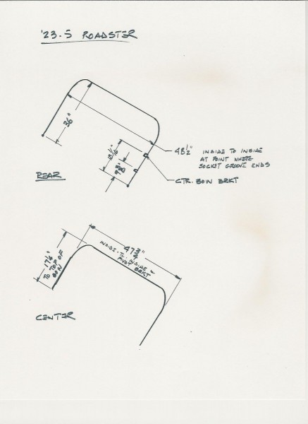

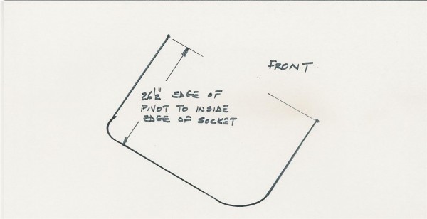

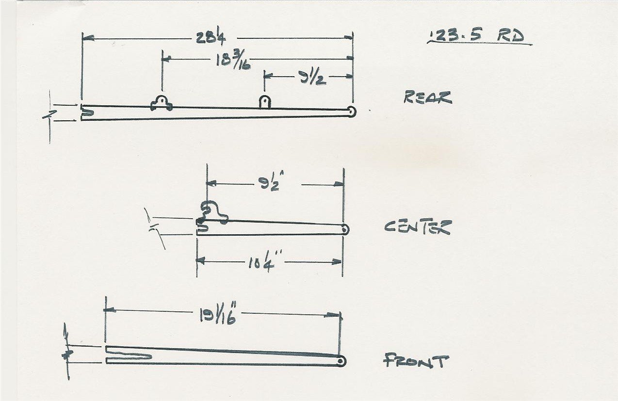

After attempting a trial fit of the straps, pads and top, I have determined that my homemade bows are too long. I need to know the dimensions of all three bows. Thanks in advance.

From elsewhere in the forum - note that the width of the front bow isn't specified because you trim it as needed so that the top attachment brackets line up and fit onto the ends of the windshield posts.
