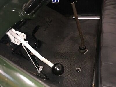

Is this a long gone after market item or are these extensions still being made ? I'd love to own one for my 27.

Nope..the one Langs sells will not work on a 26-27. The pic is of a 26. If its one of Langs someone has altered it to make it work.

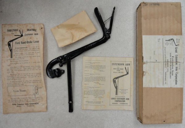

GROUT handbrake extension

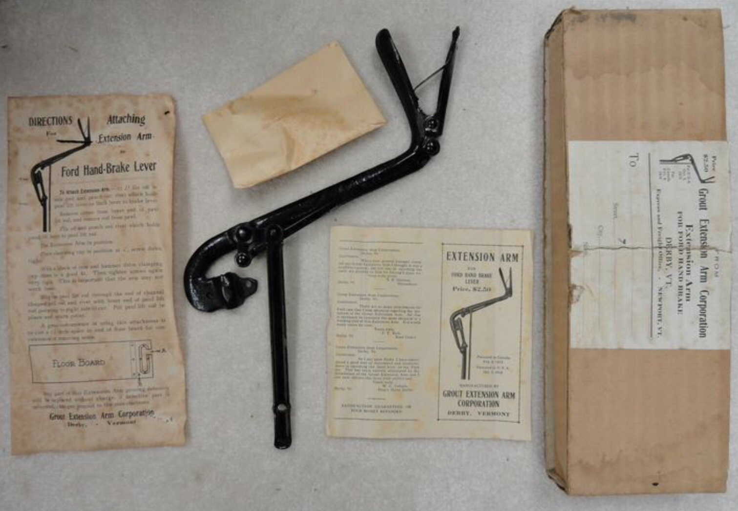

This is the original GROUT handbrake extension.
We made and sold 100 reproductions of them before selling the business, but it wasn’t kept going. We still manufacture a flip style , the NORWALK , patterned after an original design. Lang’s and Snyder’s sell it, and only available through them. The advantage is it only sticks up about a half inch higher than the original handbrake, and will clear your dashboard, and also flips forward for exiting the vehicle, if you happen to have a driver side door. I think it adds about 7” to your reach.

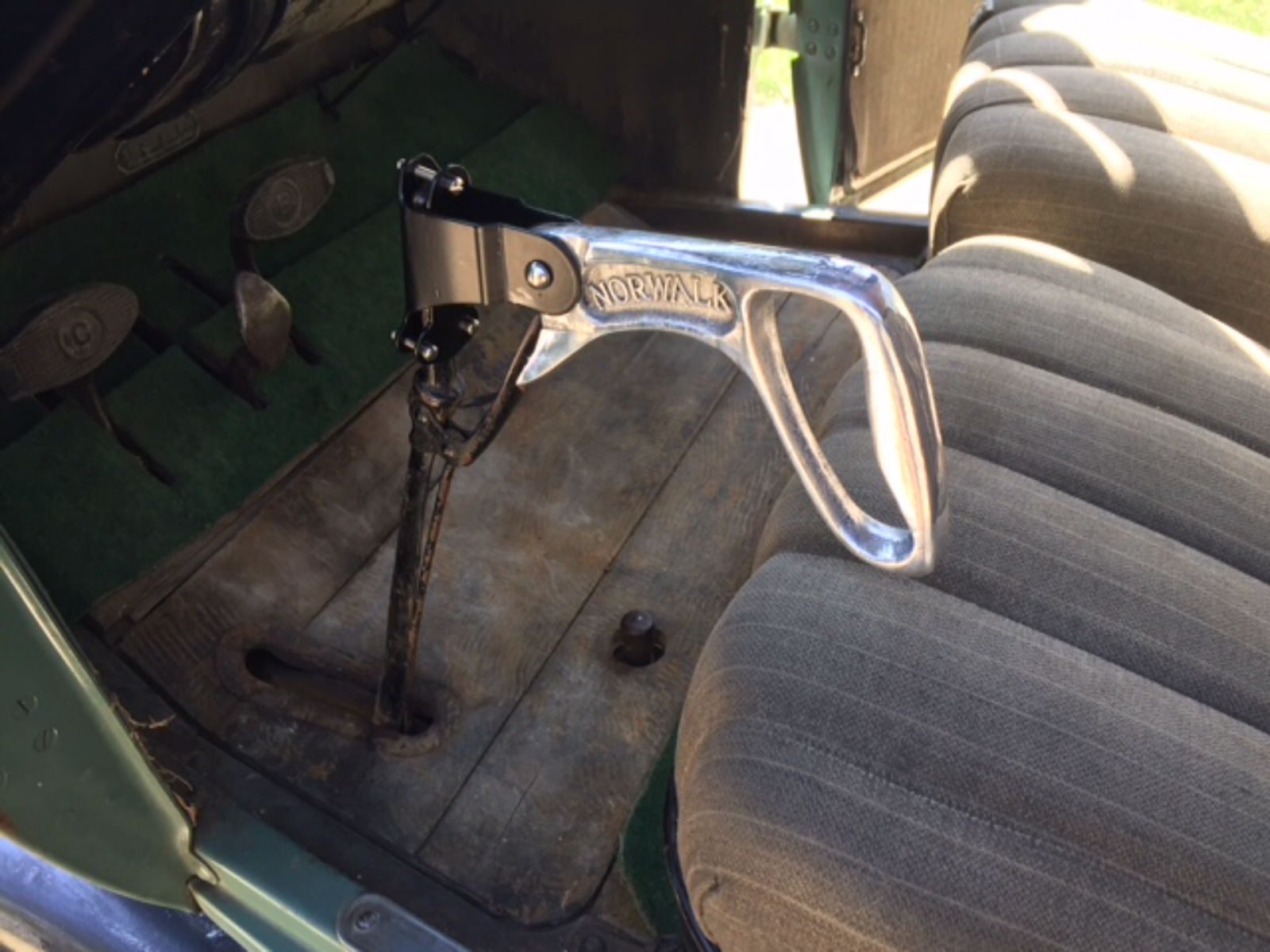

This is one installed in a friends 1926 Tudor Also, the original ad. Didn’t mean to steal the thread, just showing another option. This one can be easily moved from car to car, nothing to change, as you must do with the Grout.

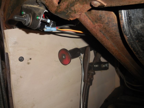

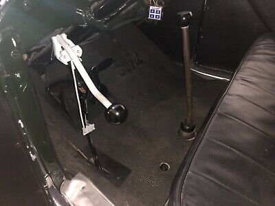

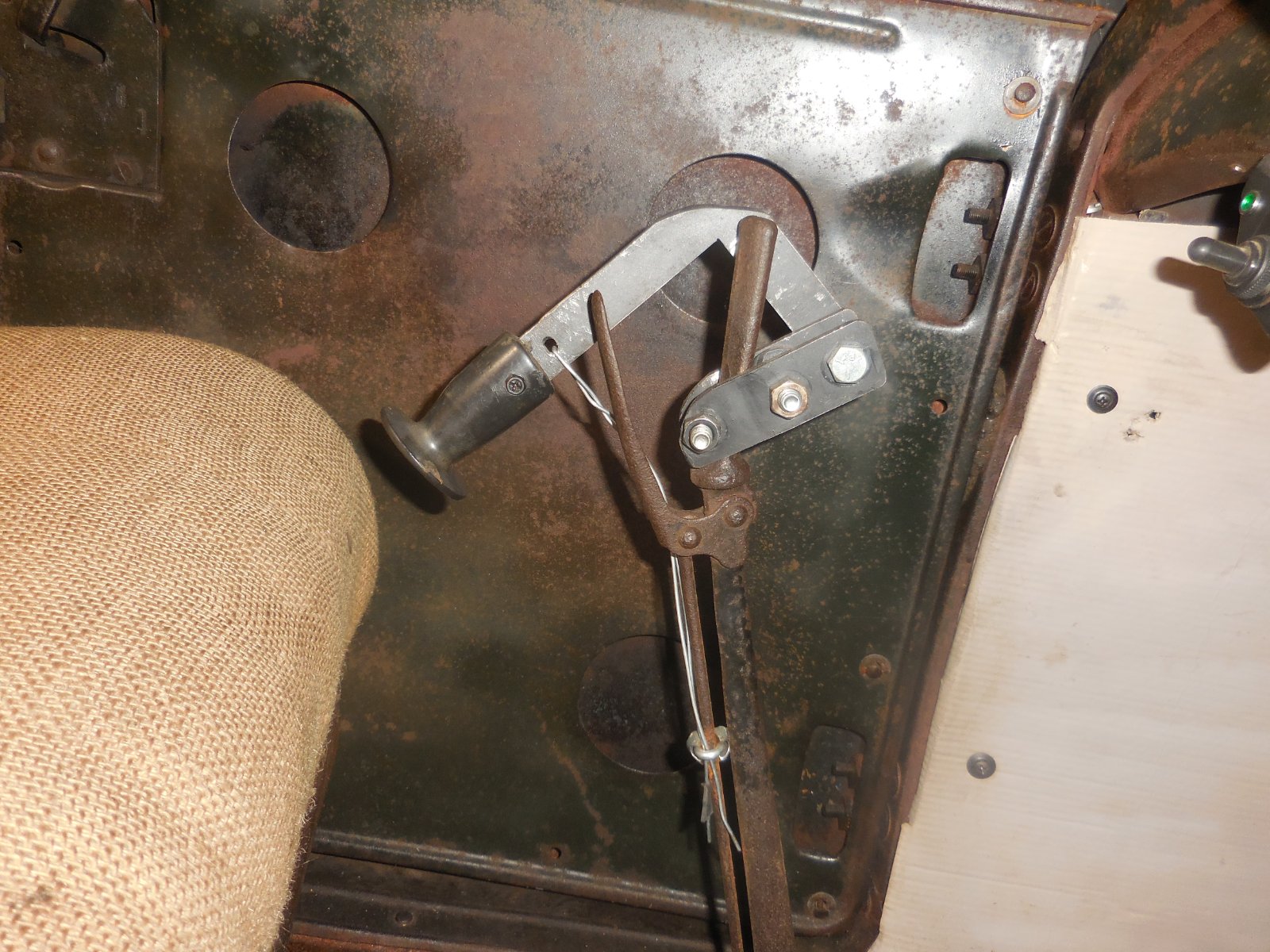

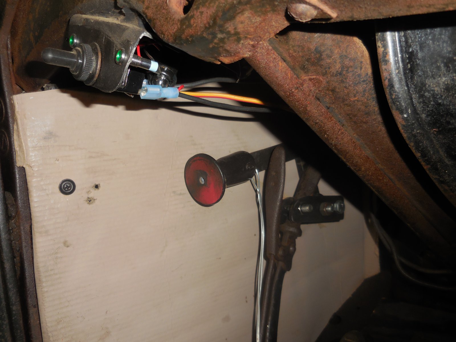

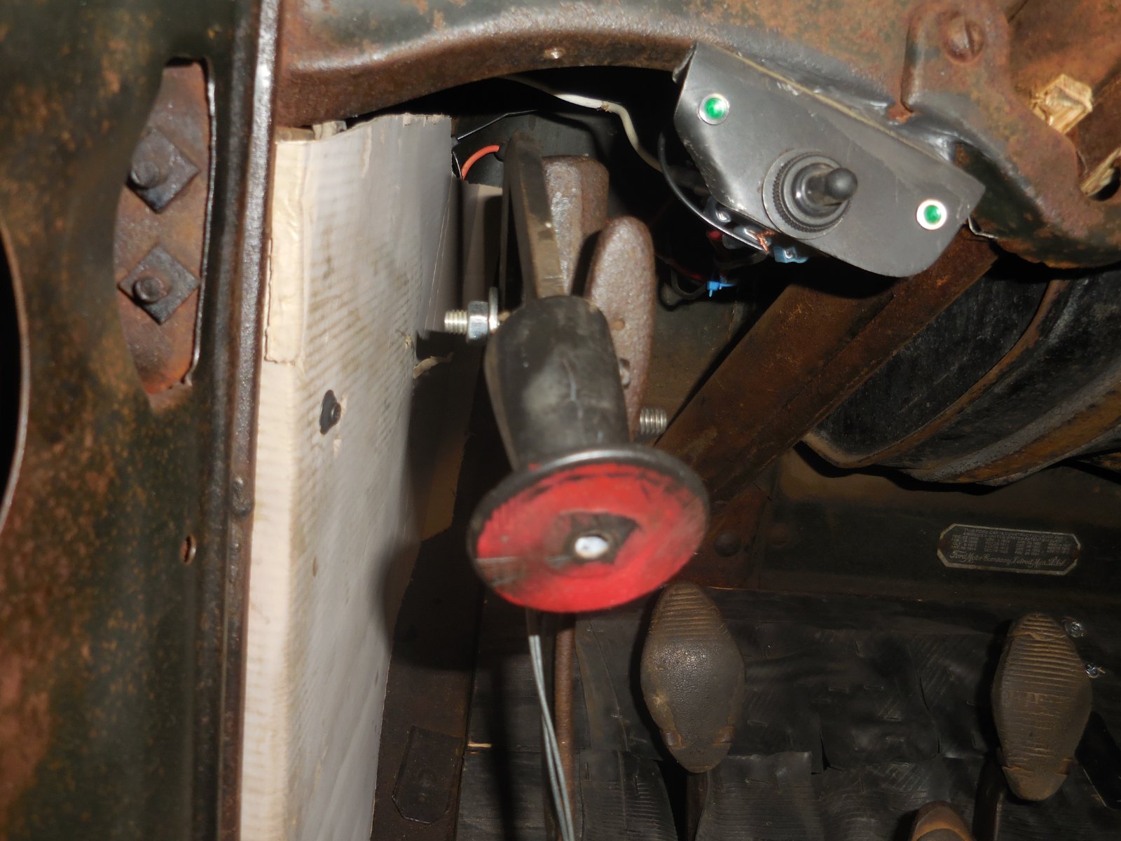

I have a 27 roadster pickup. I made this for the hand brake. It took lots of grinding, adjusting and redoing to get it to pass under the dash and not hit the seat. My father lost his left hand in a farming accident in the early 70s and make this red know for his tractor so that he could turn the steering wheel with one hand. After he passed away in 1985 I took the knob off the tractor and had it in my tool box until I used it on the extension about a month ago. This extension works great for me. The switch under the dash is for turn signals.
Phillip

It’s easy to check if the NORWALK would work with your dash. Like I said , it only adds about 1/2” to the height when installed. Also, keep in mind that the brake lever itself is easily bent at the floor level, and this will give you a bit more legroom, and also clear the dash more.Whether you use an extension or not, this isn’t a bad idea for better legroom.
I’m not understanding your complaints, Wayne , of it not clearing the seat. It’s not required to engage the toggle to set the brake.
The correct way to set the brake lever is to engage the paddle, so the ratchet is saved some wear, but everything is a trade off. Do you want to reach your brake lever easier, or do you want to make the ratchet not wear a bit more. Some grease dabbed on the ratchet teeth isn’t a bad idea, regardless.
