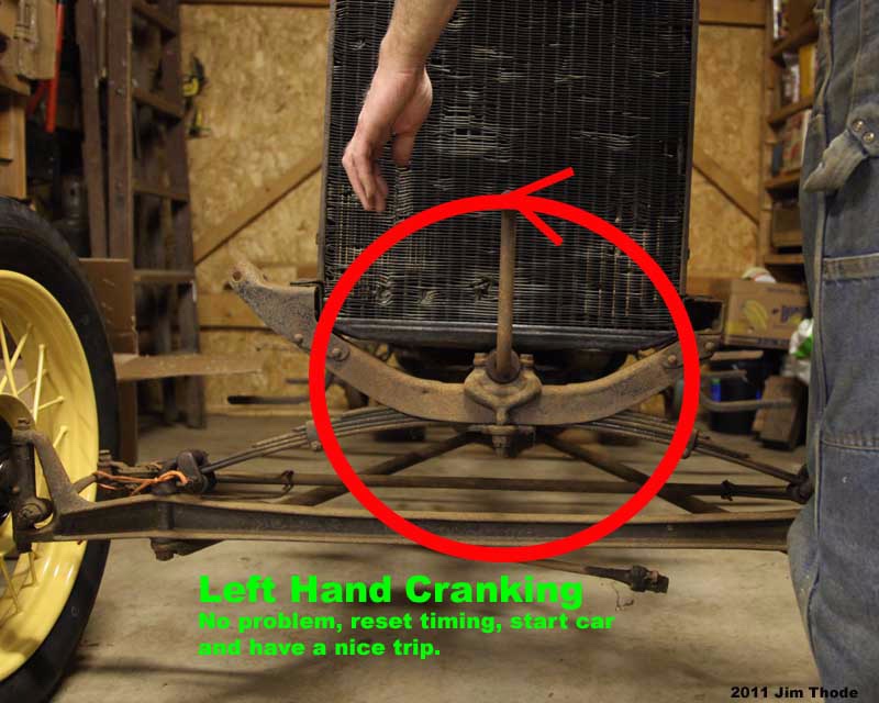

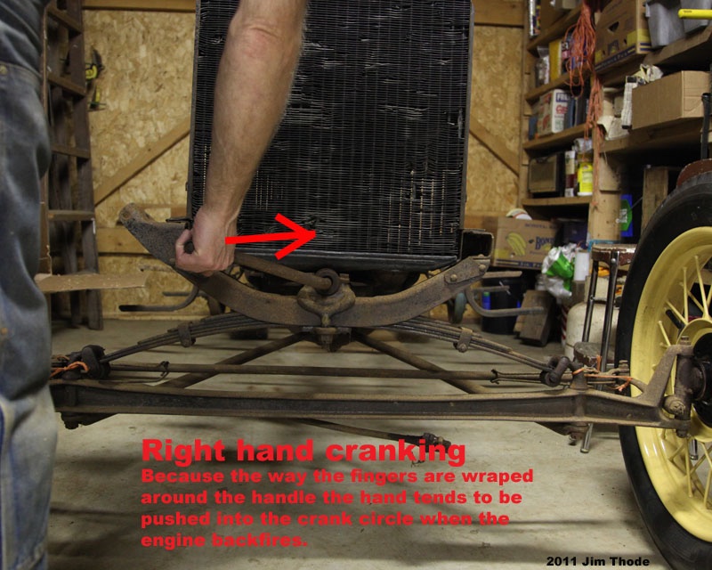

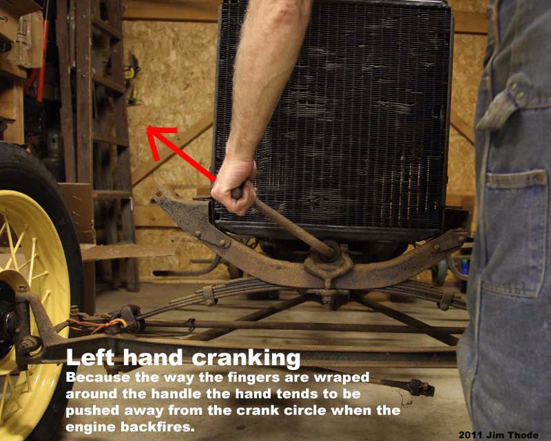

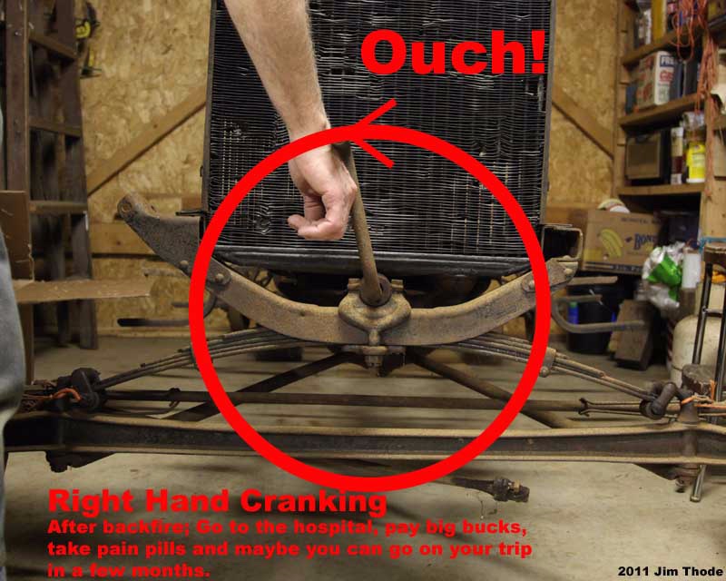

Years ago Jim Thode posted these photos, so I file saved them. He described the red circle ....highlighted....as The Circle Of Hurt.....has always been in my mind, and has been for years. That crank handle will spin around with a backfire.
Really liked his effort to make these photos...correct and valuable information for the Ford owner IMO.
