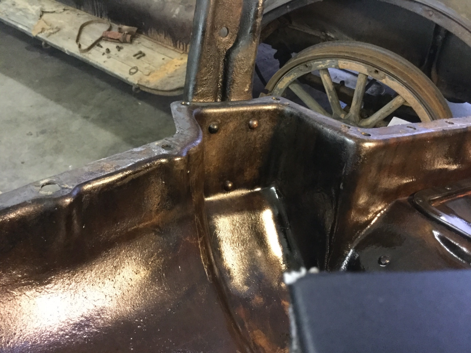

Post by Robert Bente » Tue Sep 03, 2019 12:44 pm
After replacing old valves with modern one piece valves, and reseating, I’ve been able to achieve speeds that I’ve never had before, 45+. Problem has developed with oil leaking from one of the oil pan mounting ear areas. Maybe due to extra vibration from higher speeds. It has gotten progressively worse, it’s now at a steady dribble.
Any fixes other than an engine removal?
r/s Bob

I tried JB weld on both sides of ear. The leak seems to be coming from the top center somewhere. So, 4 hours later I’ve the pan off and there is no smoking gun, cracks, splits or loose rivets. The only thing that makes sense to me is it’s leaking at the gasket. Nothing obvious. I plan on applying a generous amount of ATV to a new gasket and sealing the inner rivet heads with something. Any thoughts? I do not have access to a pan straightener.

Post by Autie » Tue Sep 10, 2019 2:59 pm
Correct me if I am wrong, maybe an optical illusion from the angle or the way the picture was taken but, on the gasket edge of the pan (in the area of the pan ear) is it curved/bent downward instead of being flat/straight?

Post by Autie » Tue Sep 10, 2019 3:01 pm
Take a straight edge across the area if suspected to be bent. This should confirm if it is. Hope this helps.

Post by Robert Bente » Tue Sep 10, 2019 5:31 pm
Yes, there is a role to the edge. I have no clue how to straighten/ flatten it without removing the ear.

Post by kmatt » Tue Sep 10, 2019 8:09 pm
Robert: To fix that bent pan gasket surface at the crank case arm try using a car body repair trick. Use body repair studs spot welded to the bent pan surface, then grab the studs with the small body work slide hammer that is made for the job ,working back and forth, slowly pulling the bent pan surface up, then cut off studs and smooth pan surface. Try Eastwood, I bet they sell hobby grade equipment that is not to expensive to due this type body work.

Post by RajoRacer » Tue Sep 10, 2019 8:14 pm
Torch & a couple different O.D. round stock bars should do the trick.

Post by Robert Bente » Wed Sep 11, 2019 9:20 am
What about using JBWeld, and filing smooth and flush? I’m trying to keep my costs down due to other vehicle projects draining my budget.

Post by Autie » Wed Sep 11, 2019 1:04 pm
Don't over think it! Not everyone has access to torches, welders or cash! But me personally, I would not use JB weld to fill in the gap. I've always relied on "Mother Necessity". Even if you are not handy, this shouldn't be that difficult. Any way you can, (w/o crimping/denting) bend that lip upward. Secure the pan, get underneath/behind the lip and pull or bend it outward a LITTLE beyond where it would be flat. It will be easier to work at making it flat again this way. Do not try to hammer it on both sides of the ears. Just be careful and get "the feel" for the metal when using a hammer when reshaping back into place. Easy peasy. After you straighten out that lip, make sure you flatten each of the bolt holes around the whole pan. I accomplish this by placing wood behind the holes and then hammering the tops of the holes until they are flat again.
