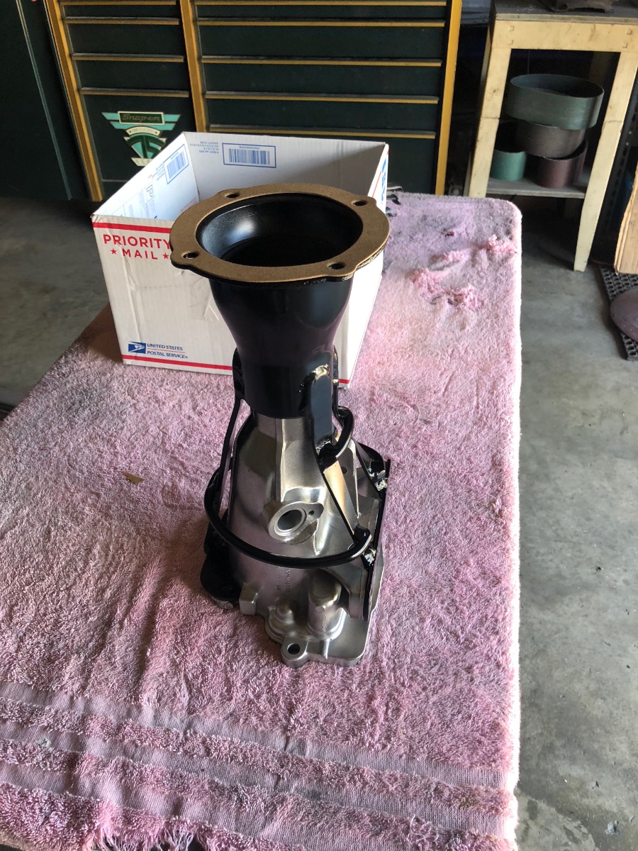

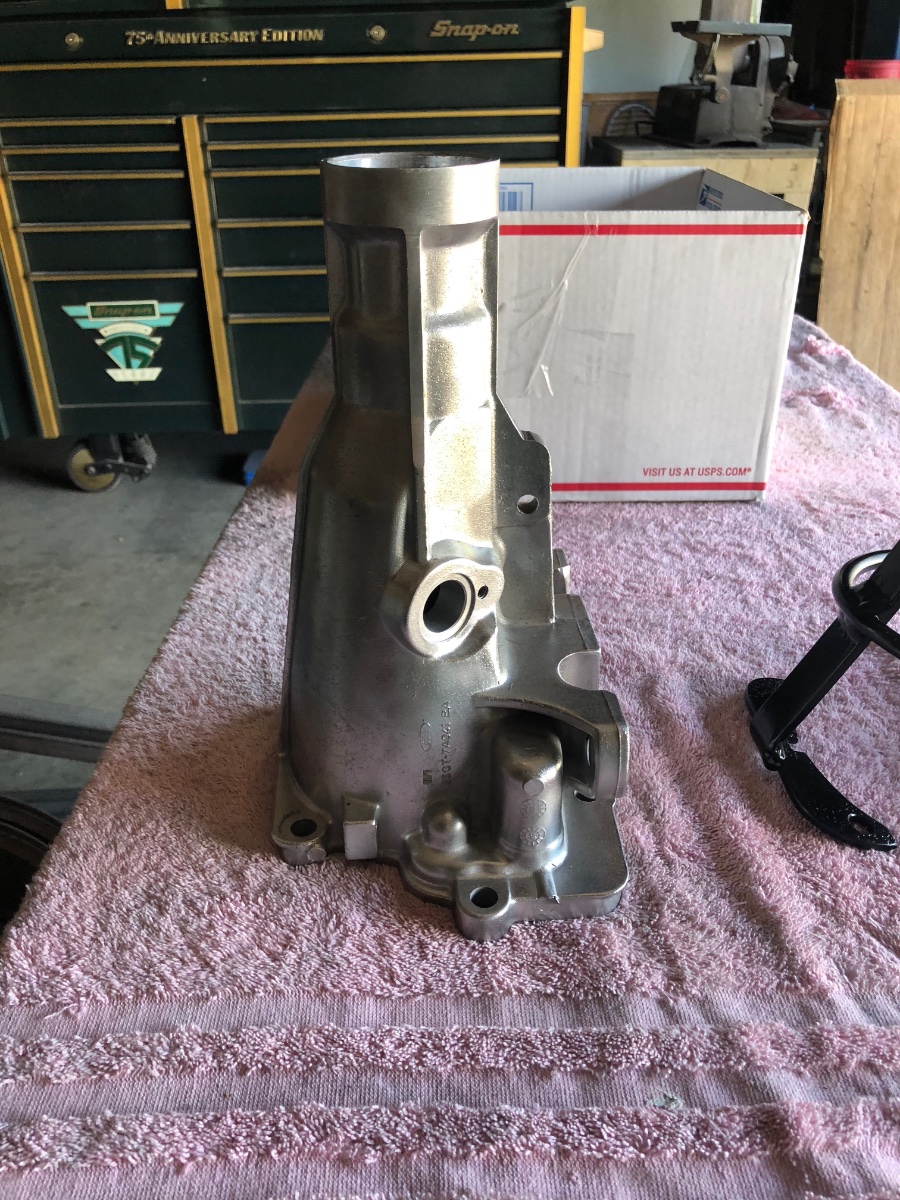

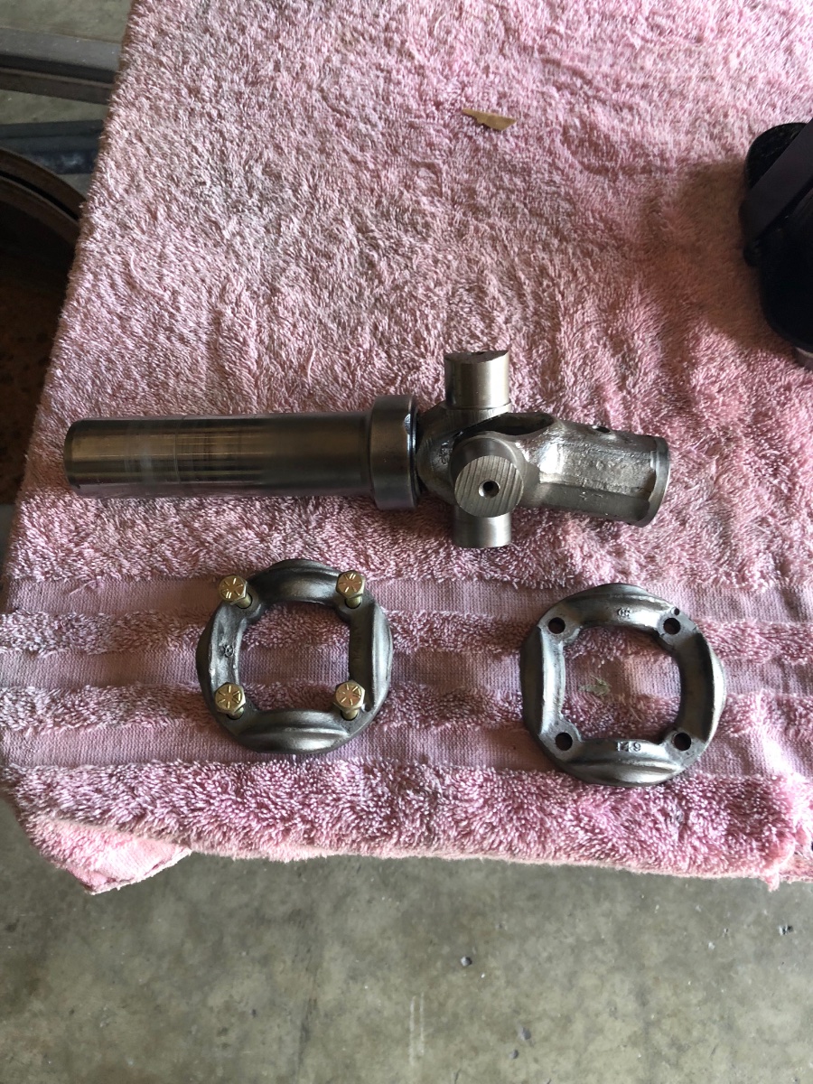

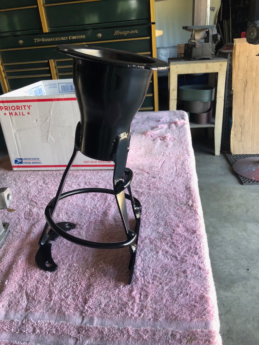

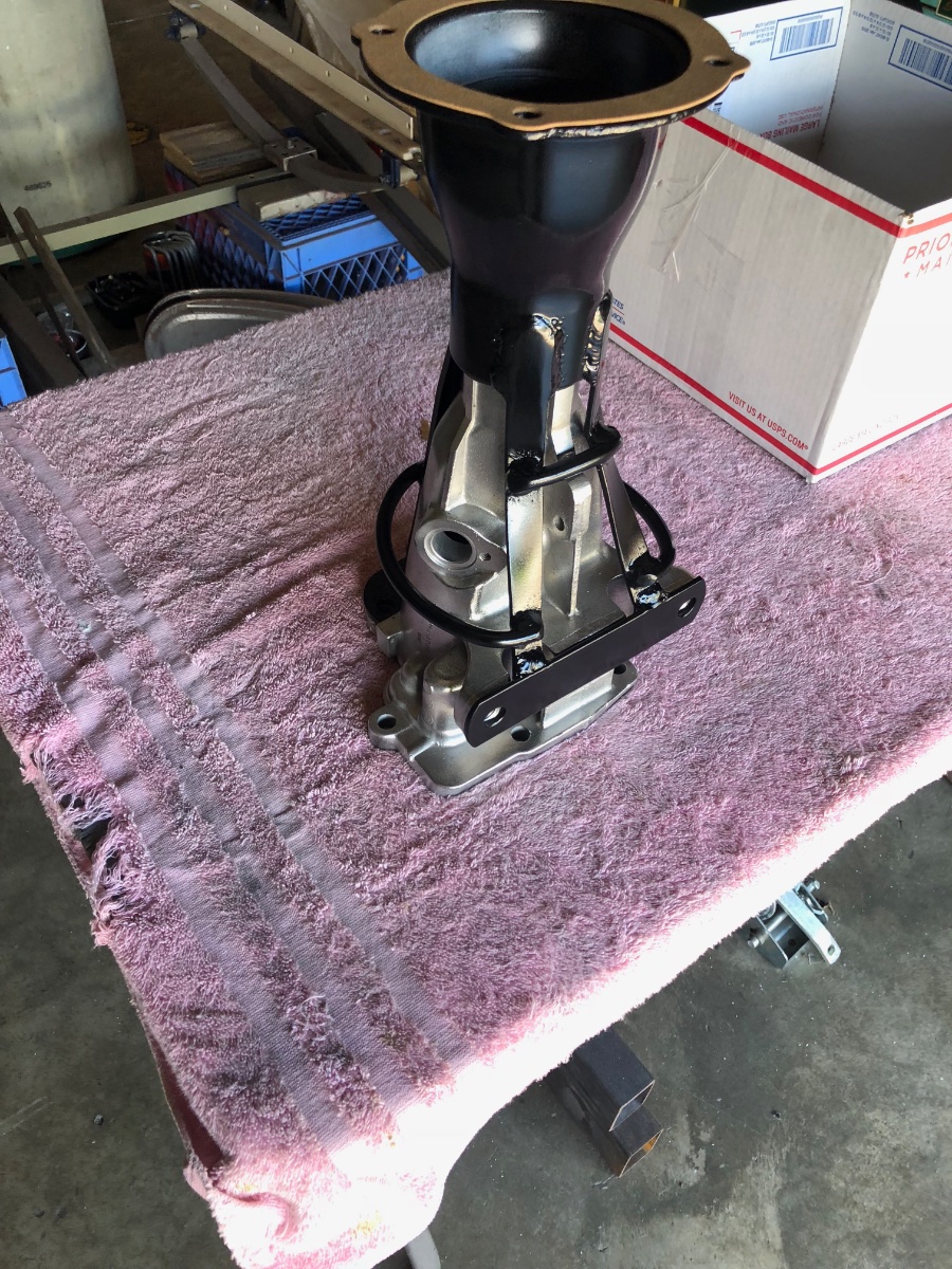

You had some Chevrolet transmissions for sale that were modified to fit the T driveline. Maybe he could use one.
- Posts: 5525
- First Name: Henry
- Last Name: Lee
Re: Best, Easiest standard transmission conversion for 27 T
Ted,
You have to do modifications to the torque tube, install accessory brakes, etc. Works excellent but comes with $$$$ spent and time. Just saying. Thank You though.
Hank
Hank

Nice looking adapter Hank!!
