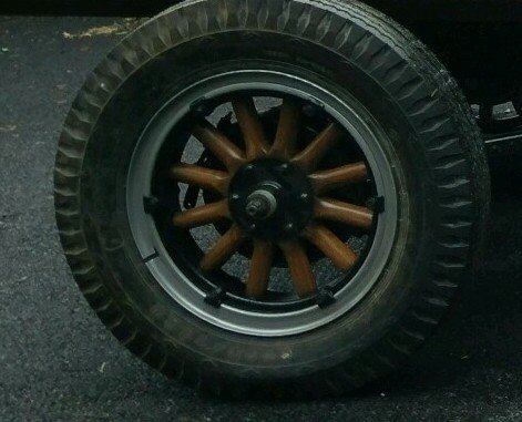

I run Lucas 6.00 x 20's on the rear, and had some hand-me-down skinnies on the
front, that look out of proportion to the rest of the truck (seen below). I recently
put some Fisk 4.40/4.50 x 21's on the front that look much better, much of which
is a more "truck-like" tread.

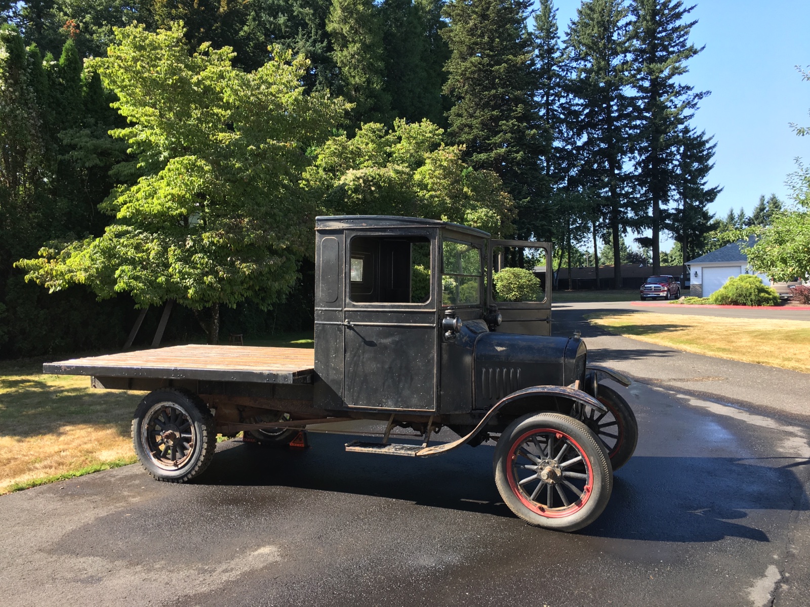

choirsilva
Posts: 11
Joined: Thu Aug 15, 2019 2:58 am
First Name: Christopher
Last Name: Silva
* REQUIRED* Type and Year of Model Ts owned: 1926 Model TT
Location: Oregon
Re: Tire options for 26 Ton Truck
Post by choirsilva » Sun Sep 22, 2019 8:23 pm

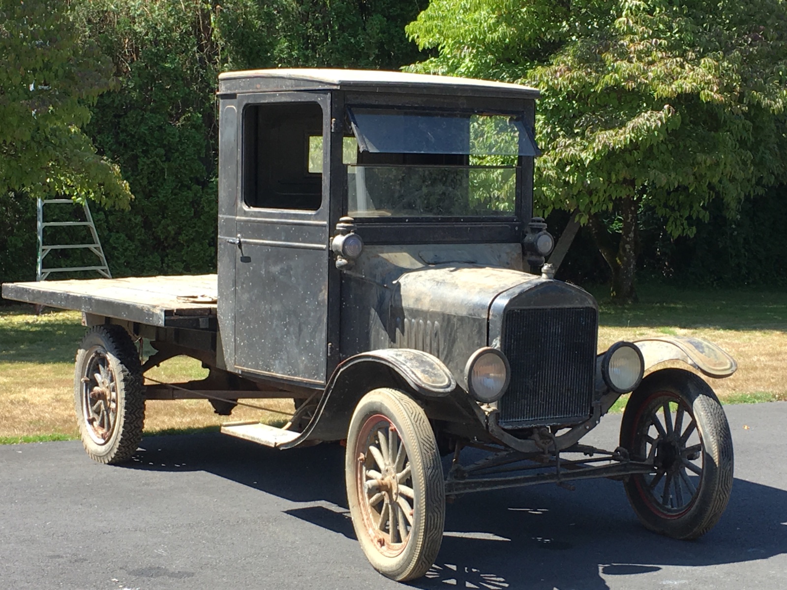

Oh, it happened, i’m In Fairview just east of Portland

Mmmm .... thet thar is a good lookin' truck ! 👍

I recently put some Fisk 4.40/4.50 x 21's on the front...
Fisk?!? Those have to be some seriously old tires. Or is the brand still being used?

I can only assume they are not ancient, as they still look good. Maybe a
current supplier is having this mold and pattern produced ? When my wheels
come back from Stutzman, I will be looking more seriously at what is available
these days. The "skinnies" on my truck are still good, but would look more
appropriate on a car. These Fisks are a little heftier in width and the tread is
more "aggressive", like one might expect for a truck.

You can't go by looks. My NOS New Zealand Firestones looked new when they came out of the wrappers. They were gorgeous. Country roads ate them up in no time.
Tires made in recent decades should have a date code on them.

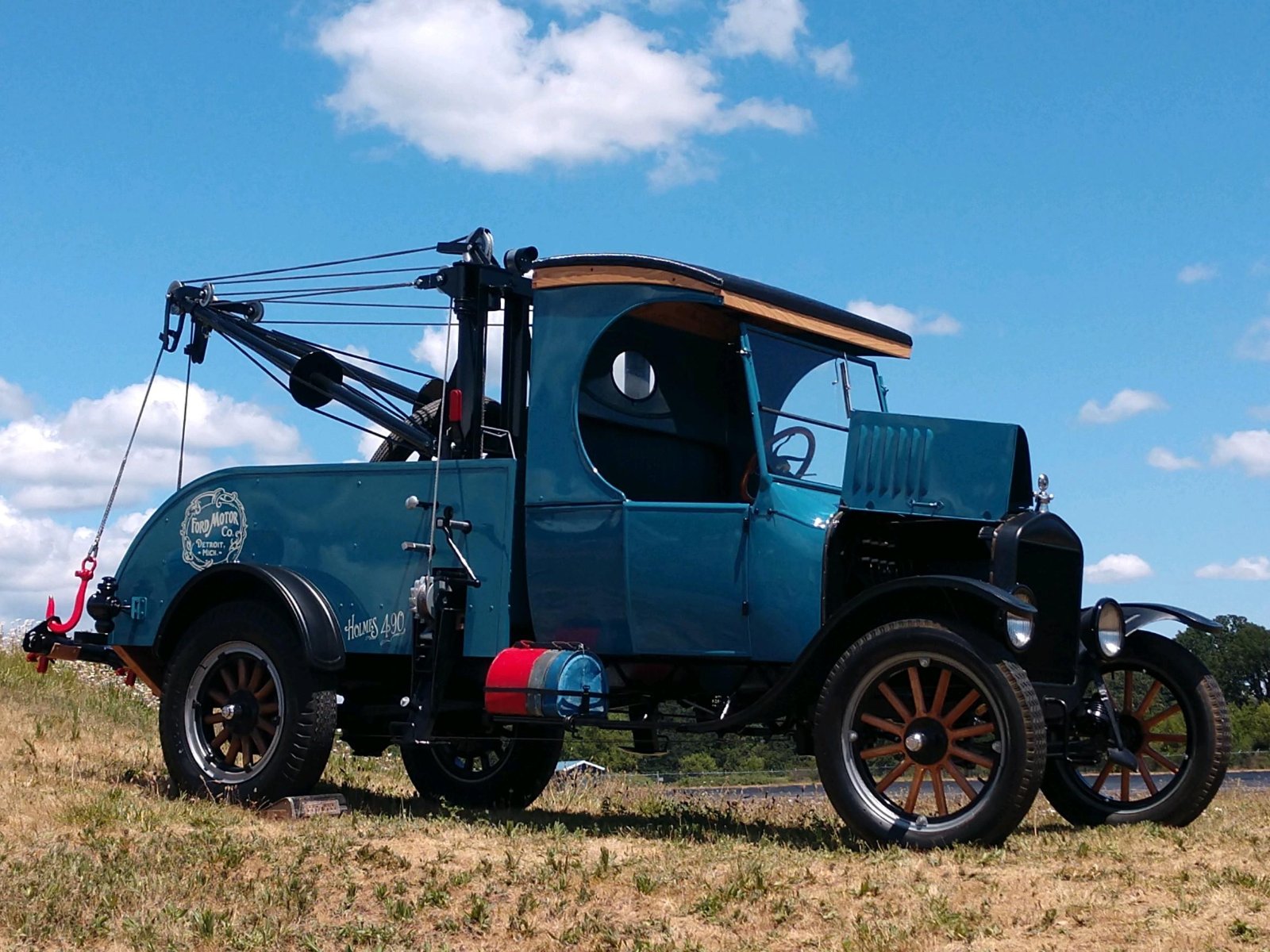

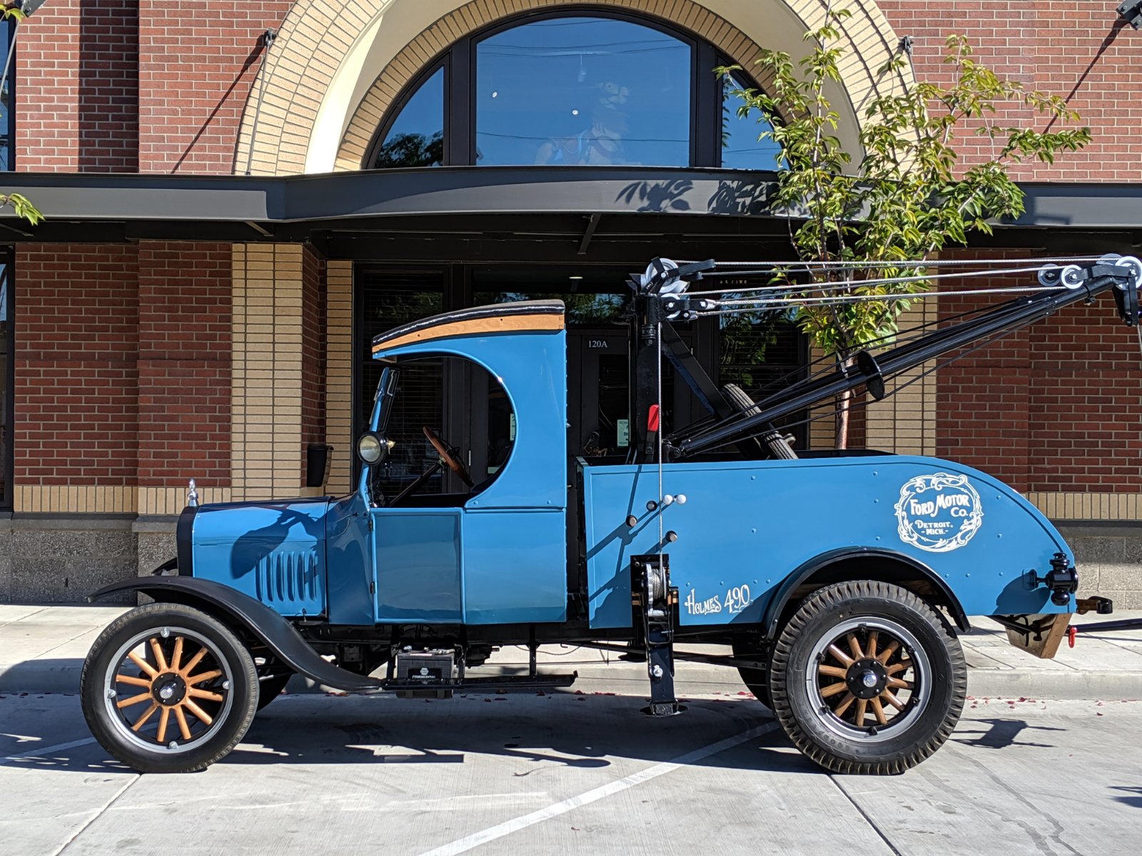

I'm running 700 20's on mine. They have all sorts of options for 700's.
I'm a bit south in Albany Oregon. Nice to hear some other tt's are going to be running around.
1925TT
Posts: 48
Joined: Wed May 15, 2019 10:45 pm
First Name: Forest
Last Name: Ledbetter
* REQUIRED* Type and Year of Model Ts owned: 1925 TT Holmes tow truck
Location: Oregon
Board Member Since: 2014
Post by 1925TT » Mon Sep 23, 2019 11:22 pm
Up close
1925TT
Posts: 48
First Name: Forest
Location: Oregon
Post by 1925TT » Mon Sep 23, 2019 11:24 pm
It gives the truck a slight rake to the front. With 21" front wheels.

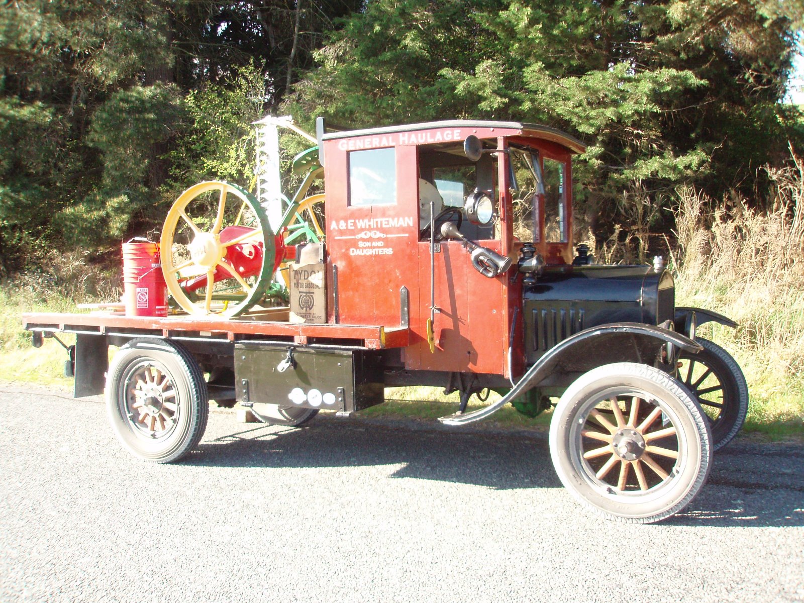

Posts: 1211
First Name: Adrian
Last Name: Whiteman
Post by A Whiteman » Sat Sep 28, 2019 11:28 pm

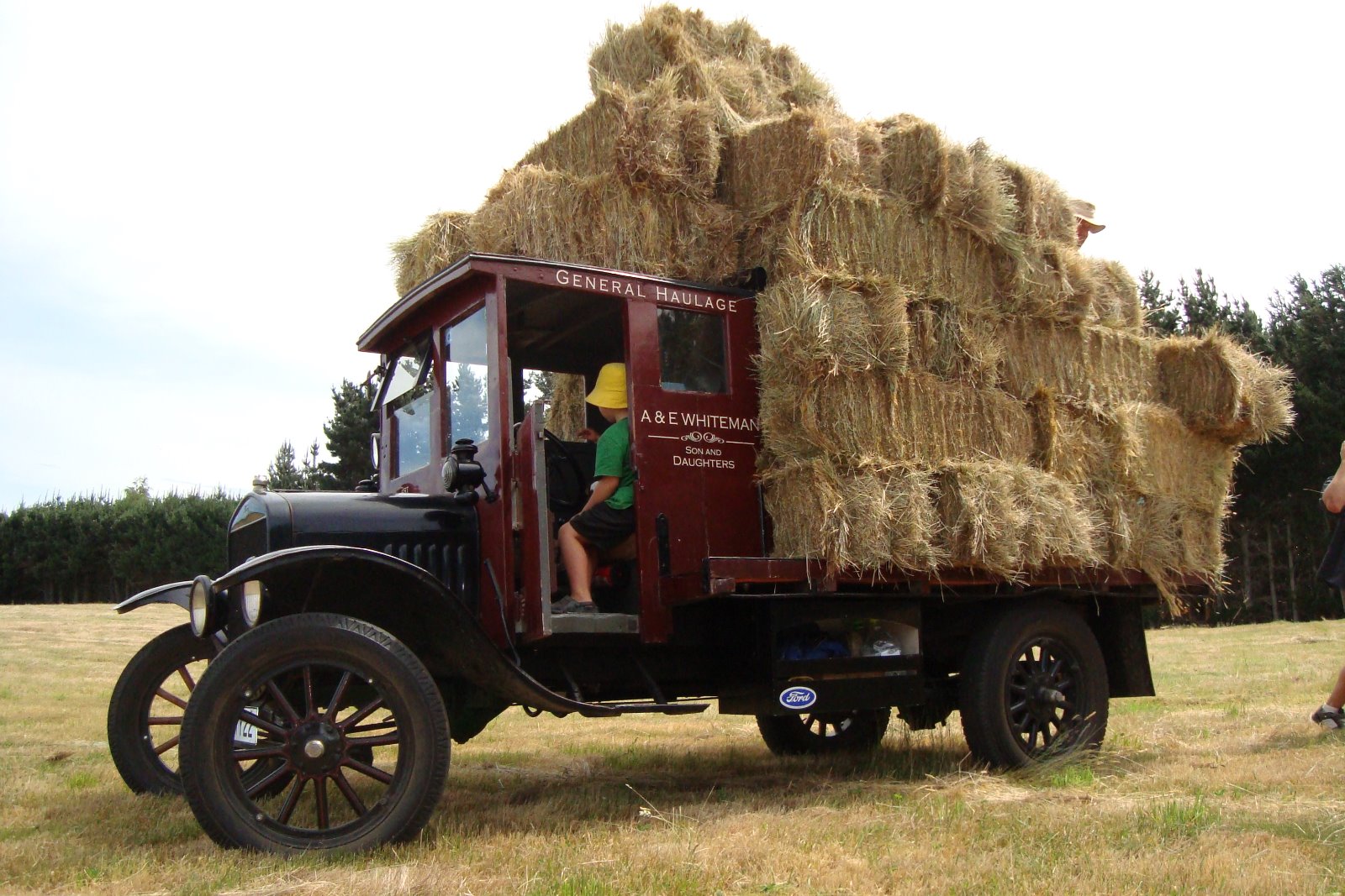

Well Christopher, TTs are FUN, and you can use them for a lot of other things around the home too! So don't be shy to use it :-)
