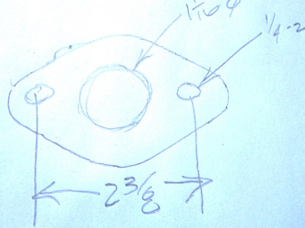

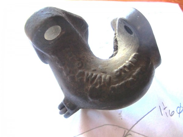

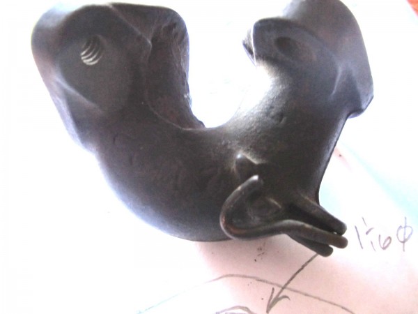

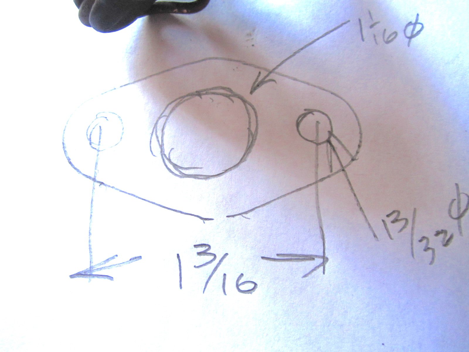

Pictures tell the story, and idea what it's from/for. The curly wire looking thing is actually a hollow tube. Thanks
SWAN Carburetor What is it for?

Re: SWAN Carburetor What is it for?
Its a part of a hokey aftermarket vaporizer carburetor setup.

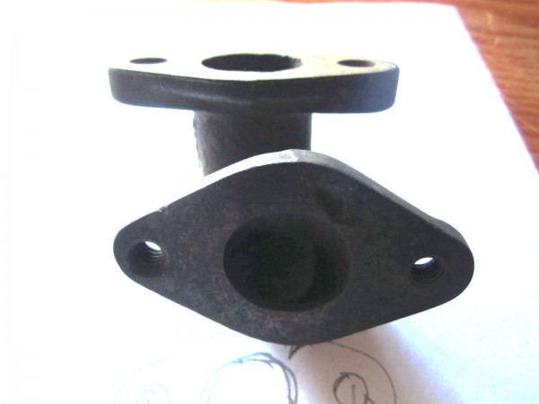

Many years ago I had a Swan intake manifold, less the hot spot parts, the exhaust manifold, and the carb mount part shown in this post. The Swan intake had bigger passages, but mounted like a stock Model T intake, and a stock Model T exhaust worked with it. It was a way to use a bigger 1920's carburetor on a Model T speedster and still look Model T era.
